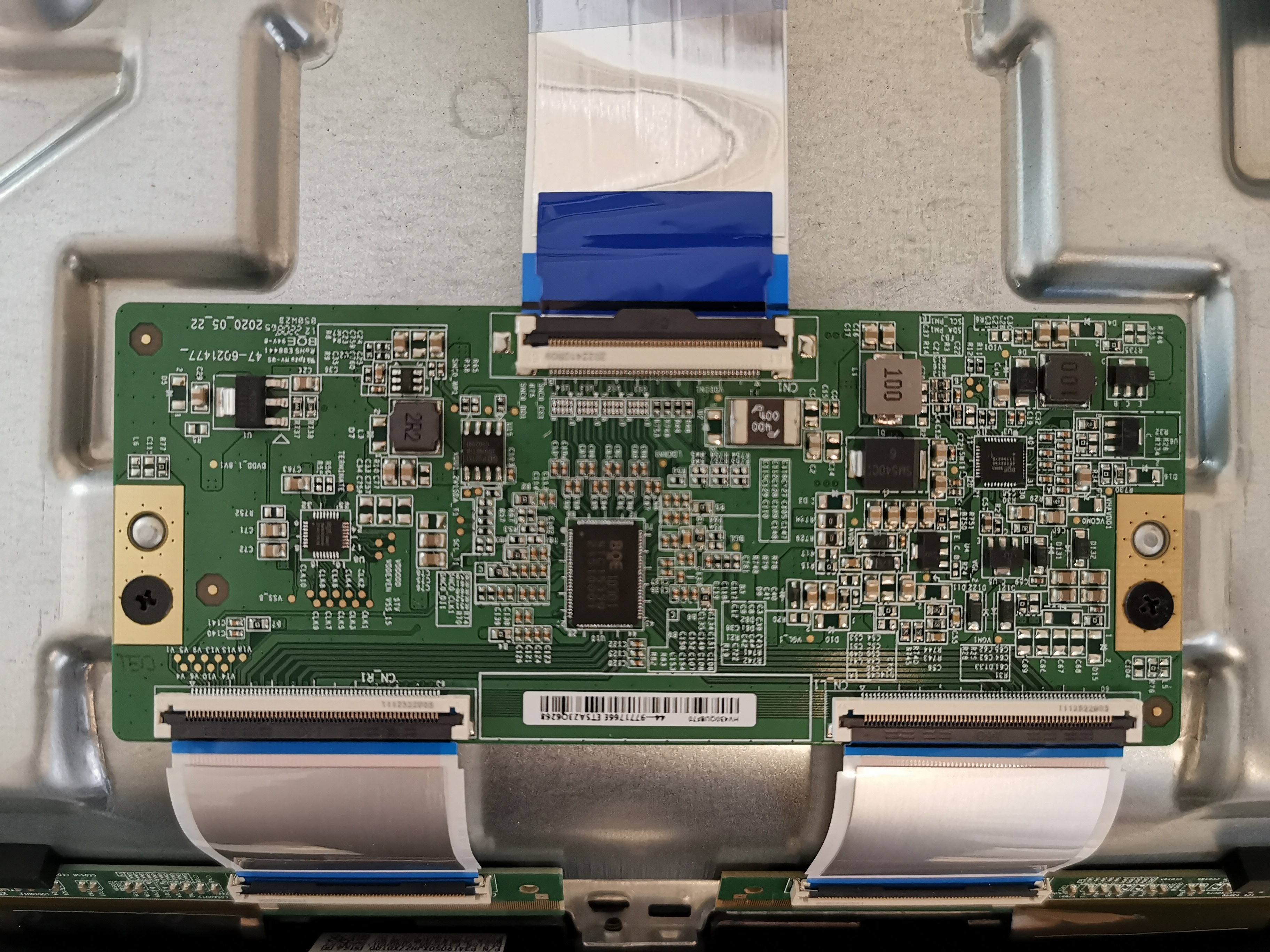

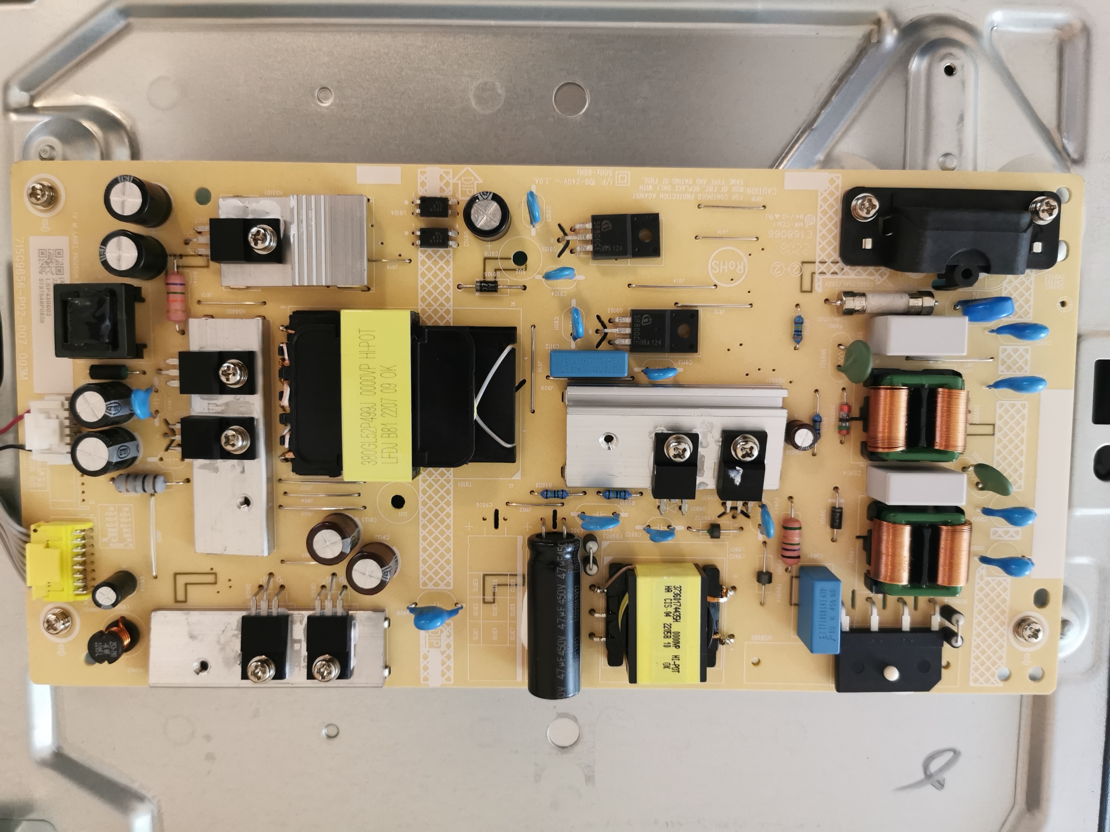

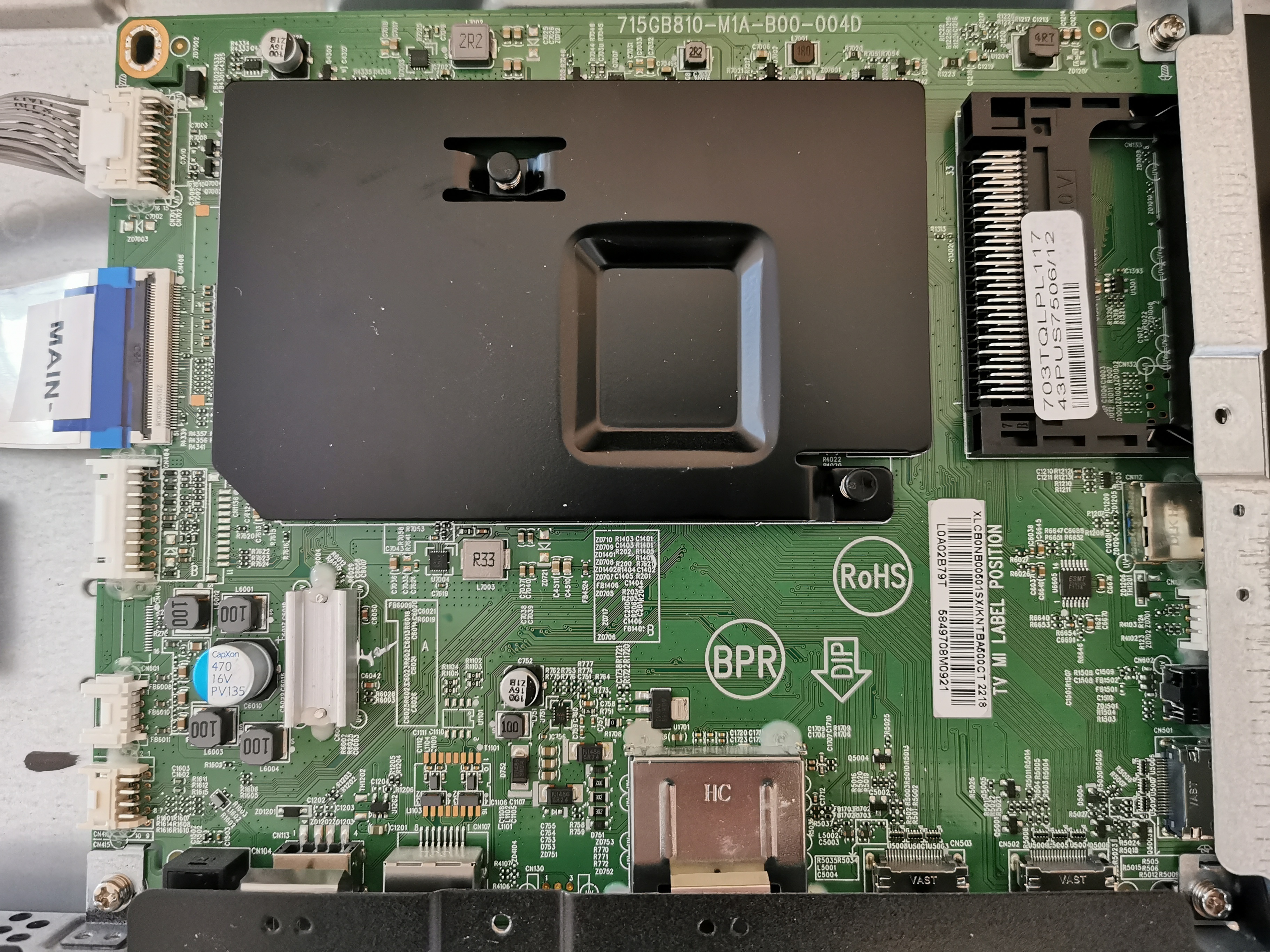

          Screws being too long might make sense yeah - as for the capacitors, not 100% where the sound chip even is? Nothing looks obviously wrong to me, but not sure where I should look. Have attached pics of the inside.
          Is it the CapXon 470? (it's measuring 430 ohm)

            could be hiding under here . Click image for larger version

                I tried to pry that heat sink off to look, but I've not been able to, even after cutting away the glue and applying a fair bit of force.
                Nor does the capactor get hot next to it (at least not quickly anyways).
                & yeah at some point I'll flash it. It's been reset and that didn't make a difference (I went through all the steps with Phillips).

                  Nah, you can’t measure the resistance of 430 ohms in circuit across that capacitor and compare it to the 470uf capacitance rating. I don’t see any board damage from the screws. Weird phenomenon but at least the headphone jack works correctly. . You could try heat (wifeys hair dryer) and freeze spray (can of air upside down) approach and see what that does, if let’s say had a bad solder joint somewhere on the board.

                    The optical port is not managed by the chip under little heatsink (sound amp.) so i suspect the processor got cracked in some joints.. Try to remove big heat sink and press down hard when the defect happens...

                      Pressing down hard will probably just destroy the chip.
