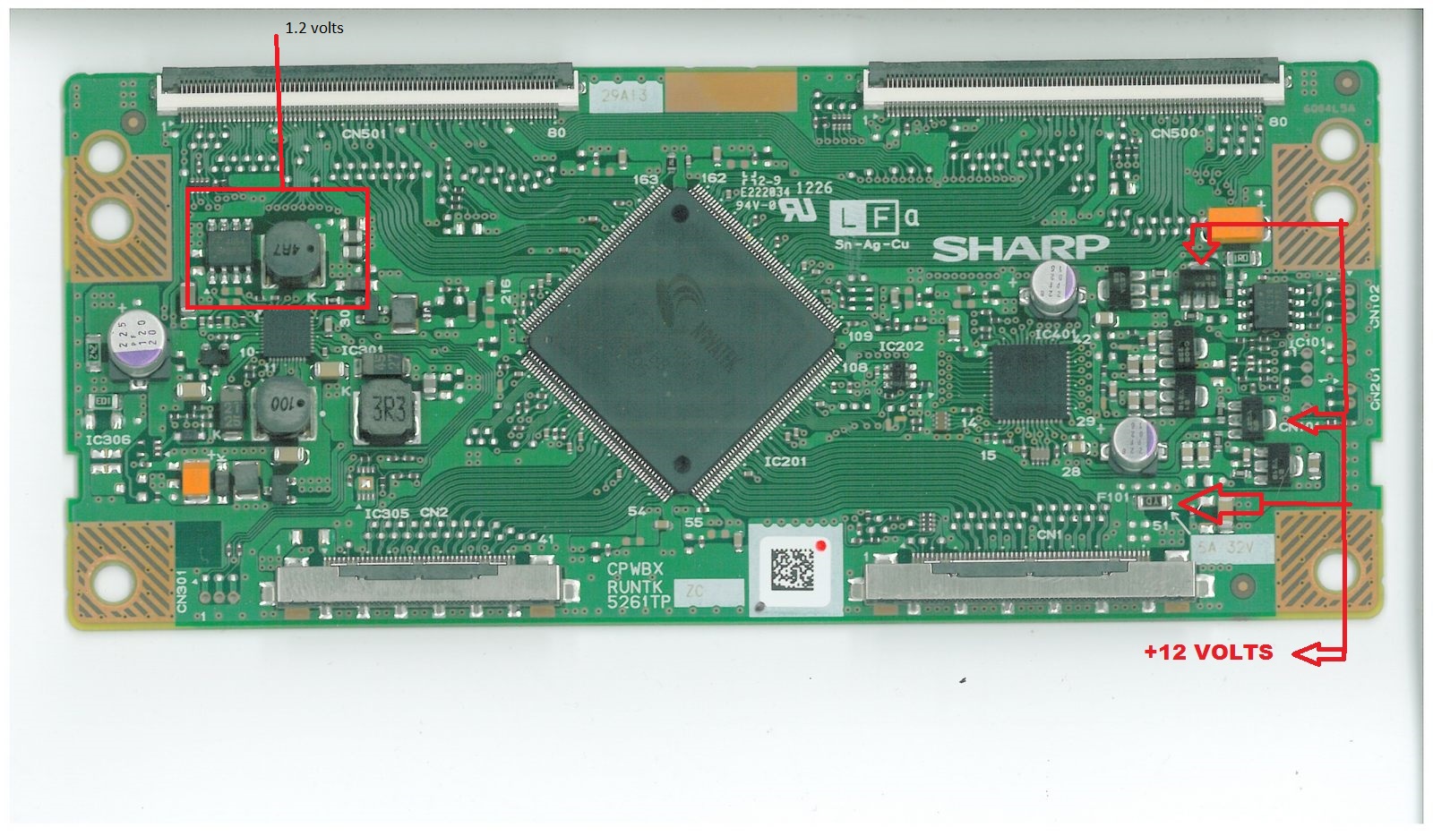

      I had an working T-CON board on my work bench and I concluded those parts wasn't the problem.But I did find on the working board there was 1.2 volts on the AO4854 pins 5-8. The non working board I was getting only 0.2 volts.
      shameem can you confirm this measure on the AO4854?
      I also replace the AO4854 and got the same low voltage.

        I dont get any voltage at all - maybe 0.1v. The AO4854 is wired very similarly to this schematic - https://cdn.badcaps-static.com/pdfs/...436c6584b8.pdf
        What voltage do you get between pin 5 and ground in the working board? Also it seems like pin 8 is connected to 12v supply.
        I think the MAX17140 IC is supposed to provide the 5v supply through the route i marked in the attached picture - can you confirm with the working board. Thanks.

          On the working board pin 7 and 8 there was +12v and on 5 and 6 was +1.2v.
          unfortunately i don't have this Vizio 60" on my work bench. But I have another on on the way with the same problem. I'm not sure on what this 1.2v is supplying power to or which components? I'm started tracing the board and couldn't find continuity to any I.C.s

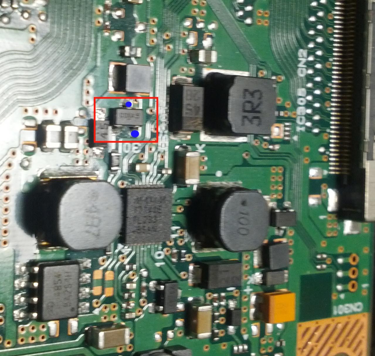

            Based on further exploration and brief comparison with a working board i have narrowed it down to the component outlined in the picture. The points marked in blue have continuity on the bad board and don't have continuity on the good board. The markings for this transistor -
            COXA (16 printed sideways) on the bad board
            CO5A (16 printed sideways) on the good board
            Could anyone please point me to a datasheet for this component? Thanks

              I check the same part on my T-CON, and I concluded that these are MOSFET, and you may have did an in circuit test. When you applied your test lead to the gate you cause the drain and source to closed. check again. I will do more signal tracing today on where this +1.2 volts is going

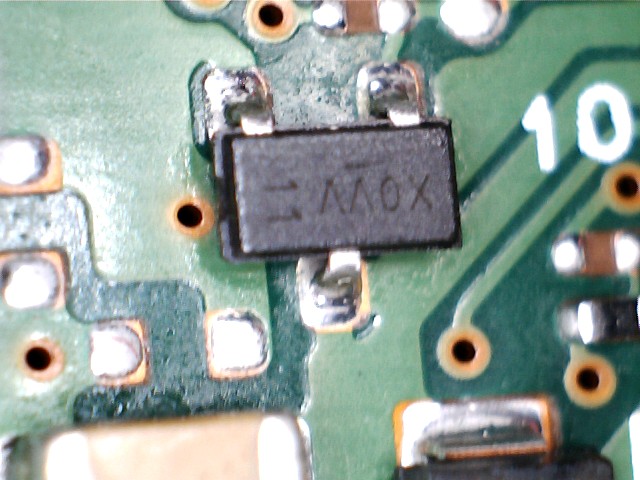

                I thought so too - i removed the transistor from the board and same result. The center tab and another pin is shorted. Do you know an equivalent transistor i can substitute on the board? Thanks
                I think 1.2v is the core voltage for the T Con LVDS chip (Novatek)
                I have attached an image of the transistor - that is as close i could go without macro lens....

                  Could this be the transistor?

                    shameem, I remove them both transistors and only one of the two transistor were shorted. I upload a picture of " X0VV" which seem to be a MOSFET. The "COXA 16" is shorted from the center pin to the right pin. I'm getting a reading in both direction from the center tab and the left pin. I didn't find any datasheet on either.
