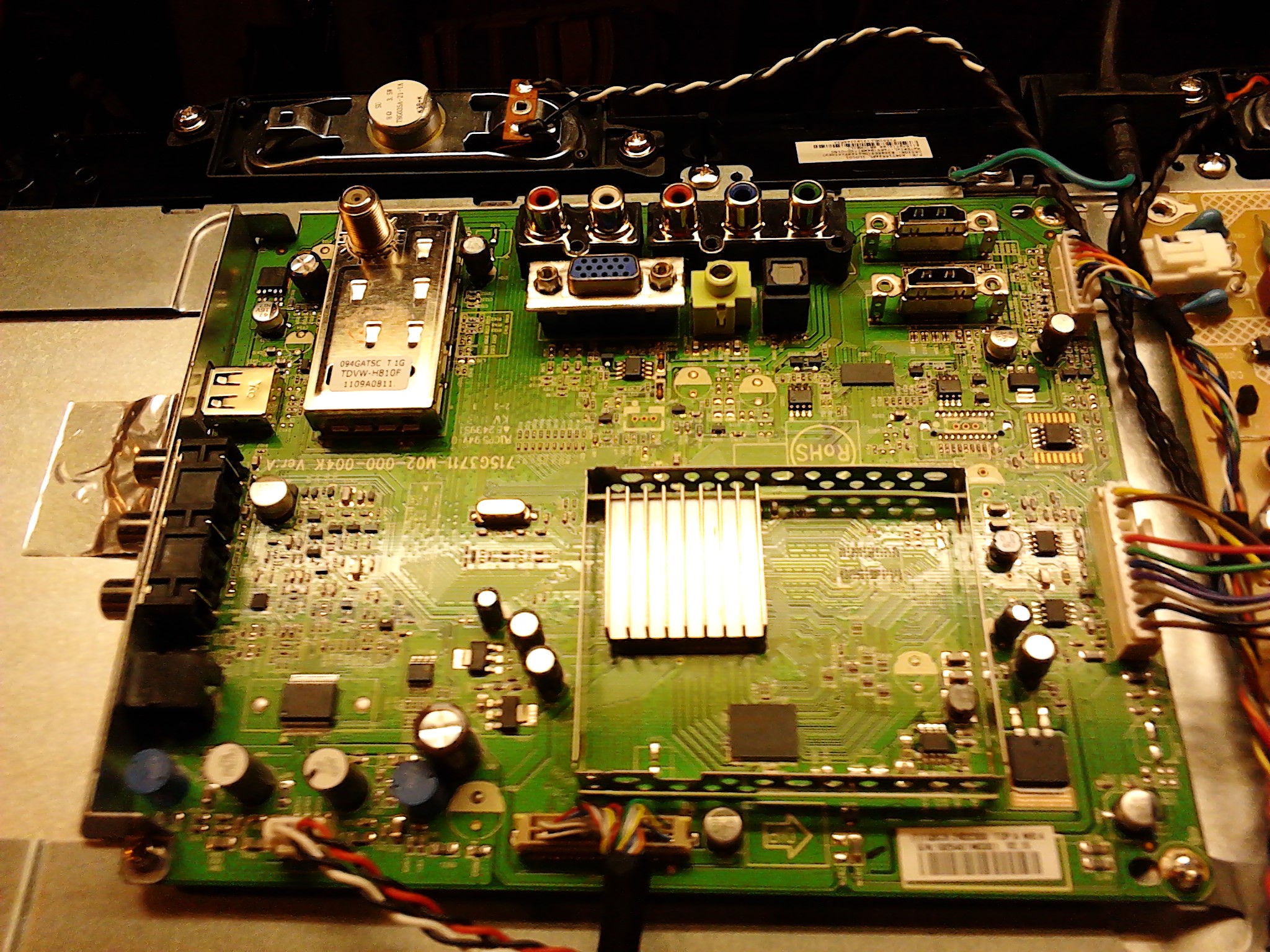

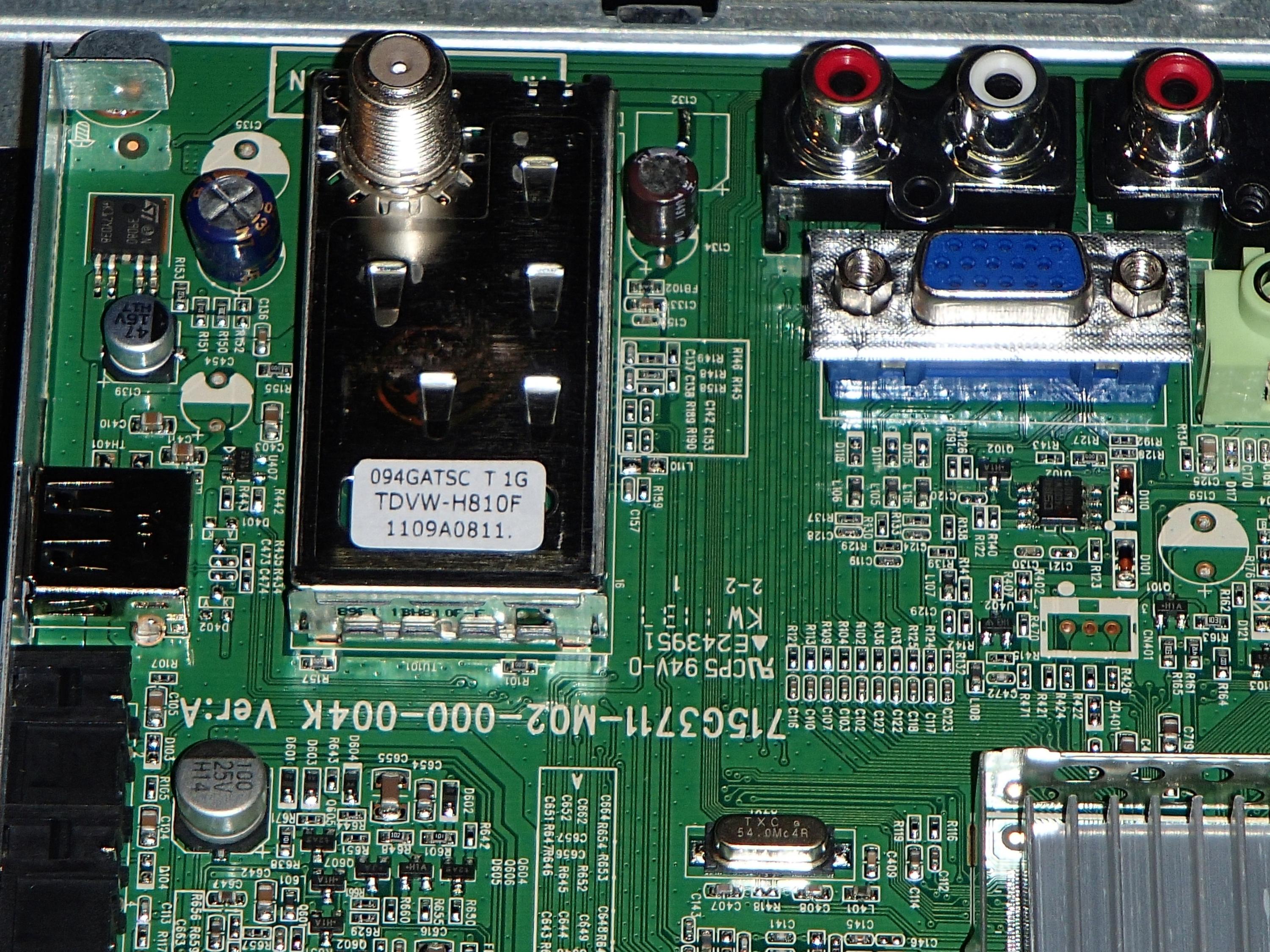

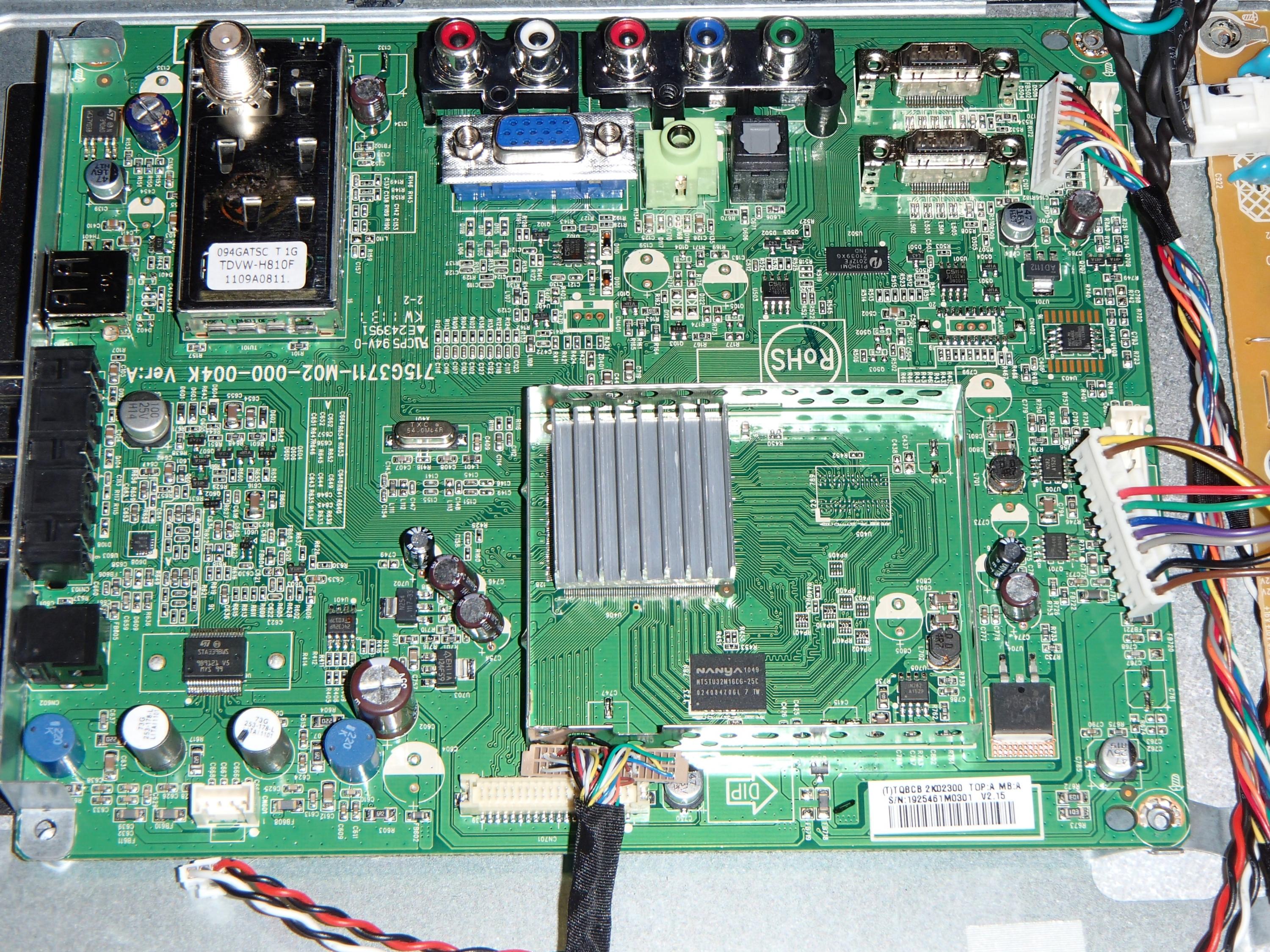

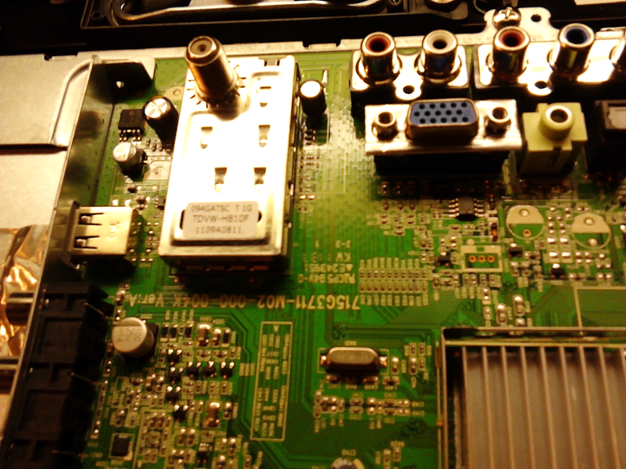

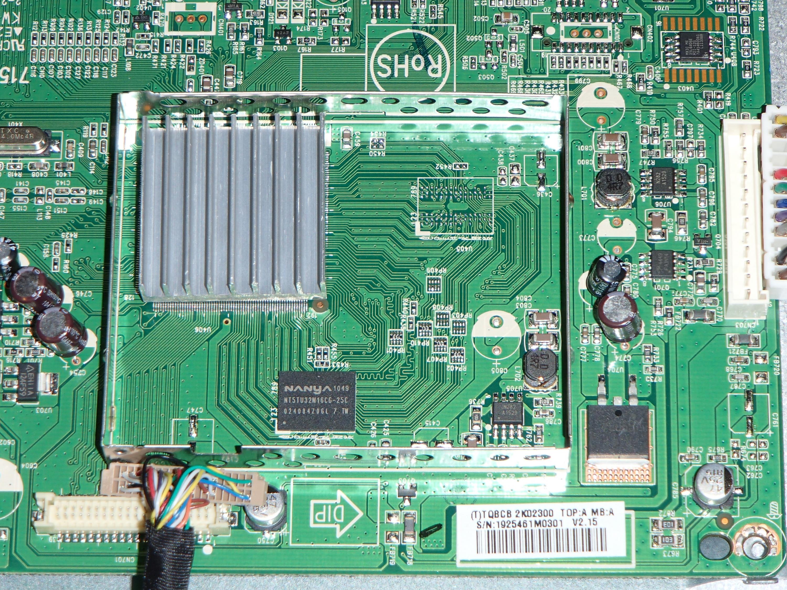

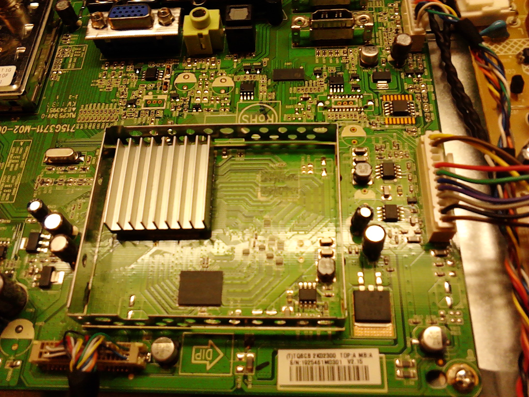

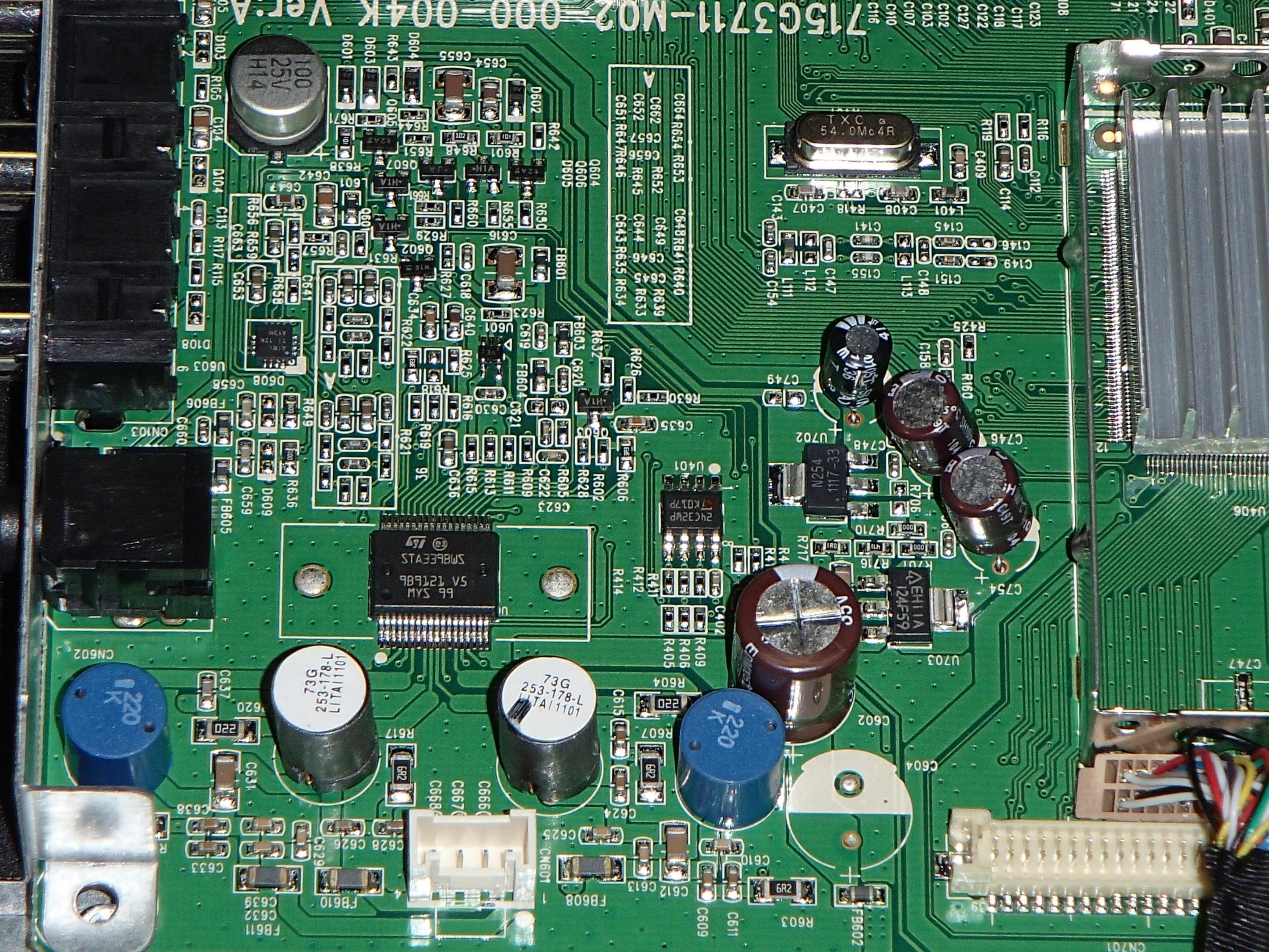

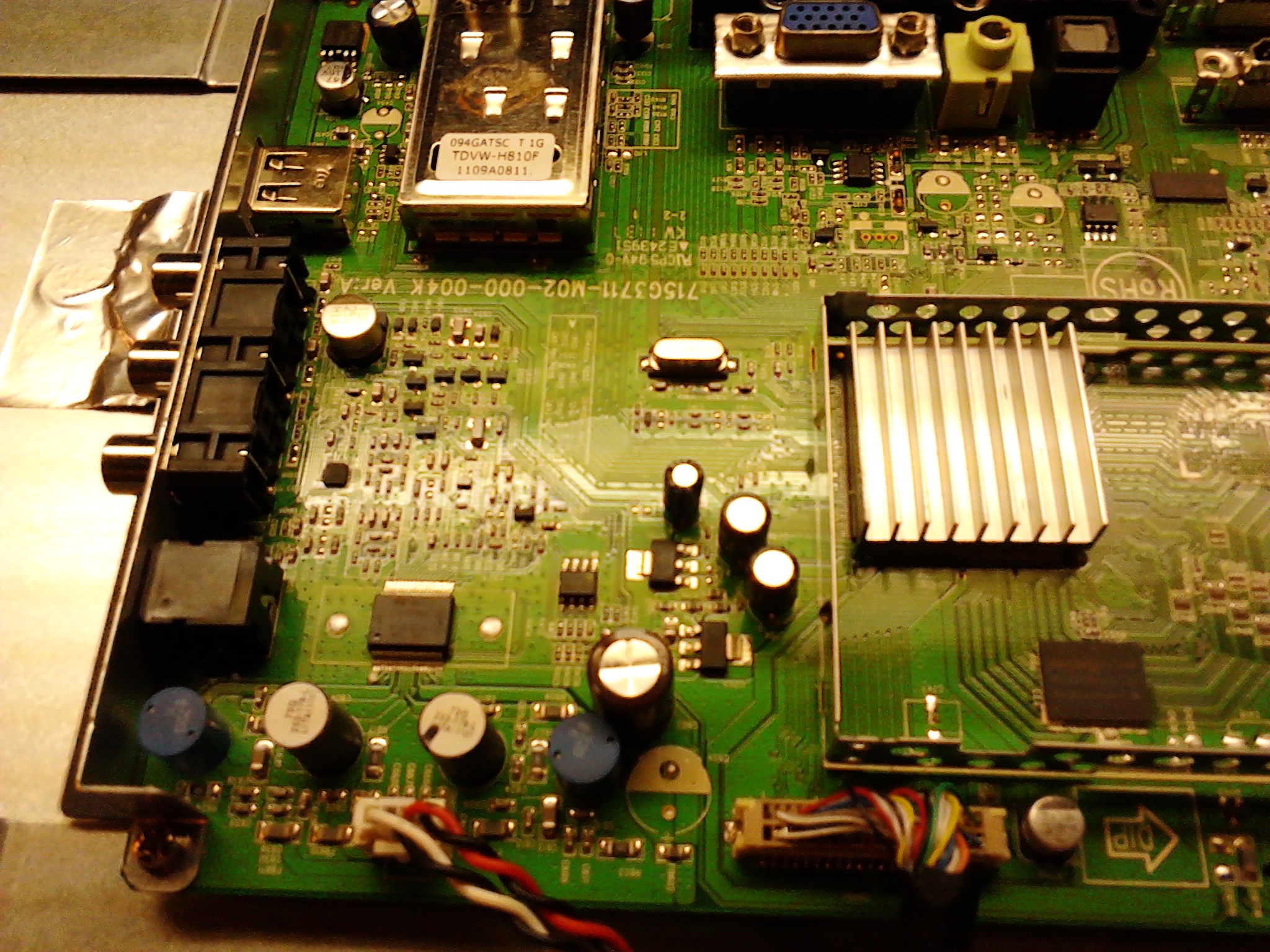

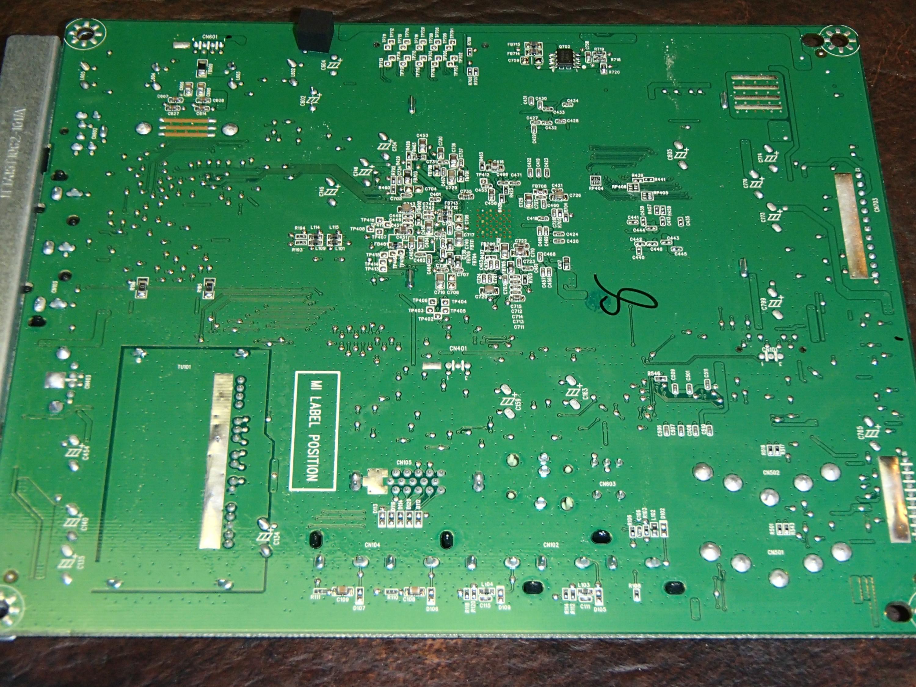

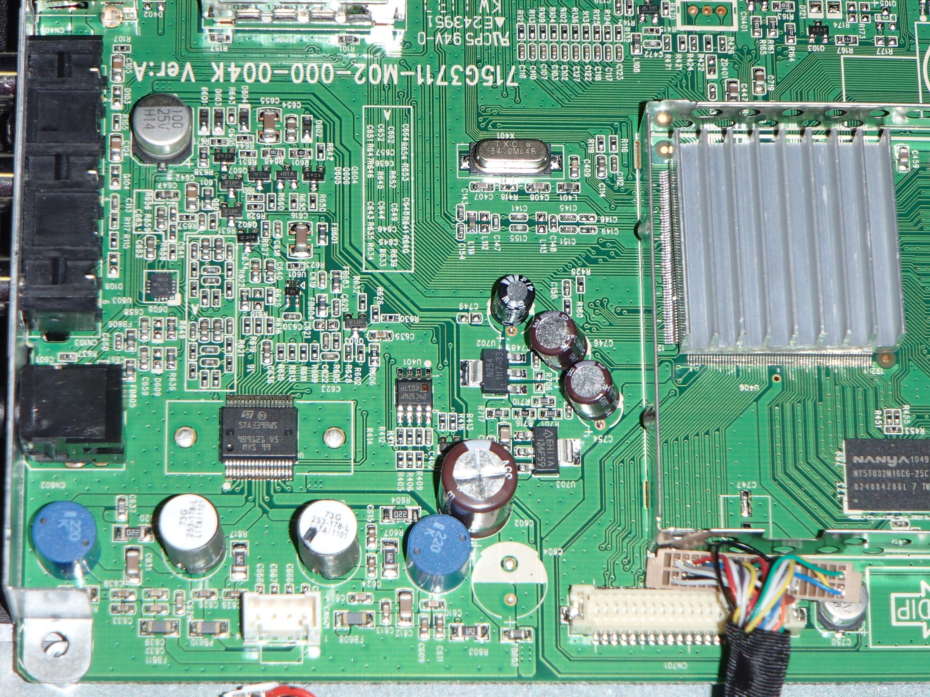

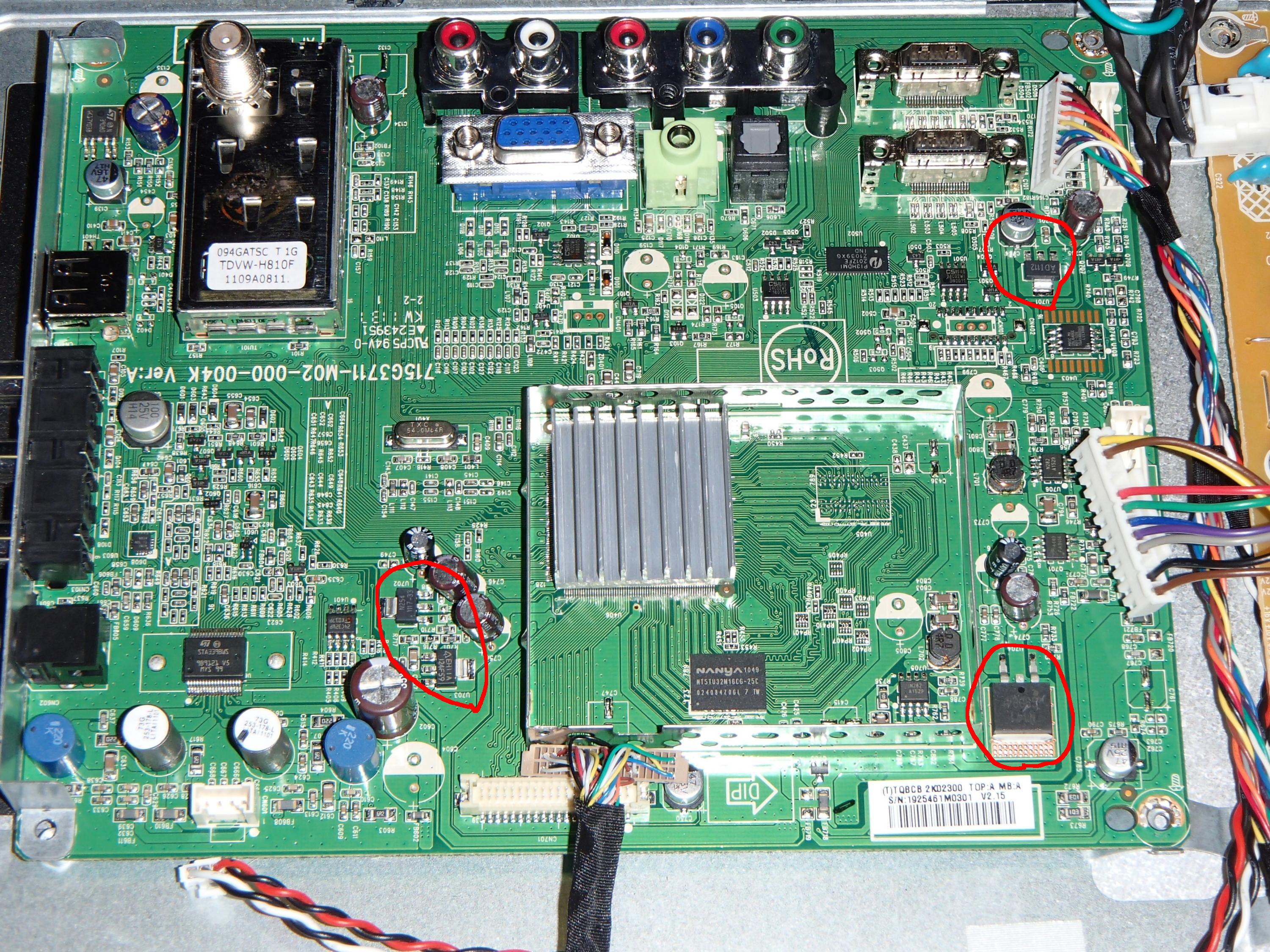

    So how about showing us the picturwes of the board, especially the LDO regulator ICs.

      Re: Vizio E220VA no standby, no power
      Sorry, not the best quality, need more AA batteries for my digital cam, this are pics with my camera phone. If there is a place that needs to be zoomed more and clearer, let me know. looking for some batteries.

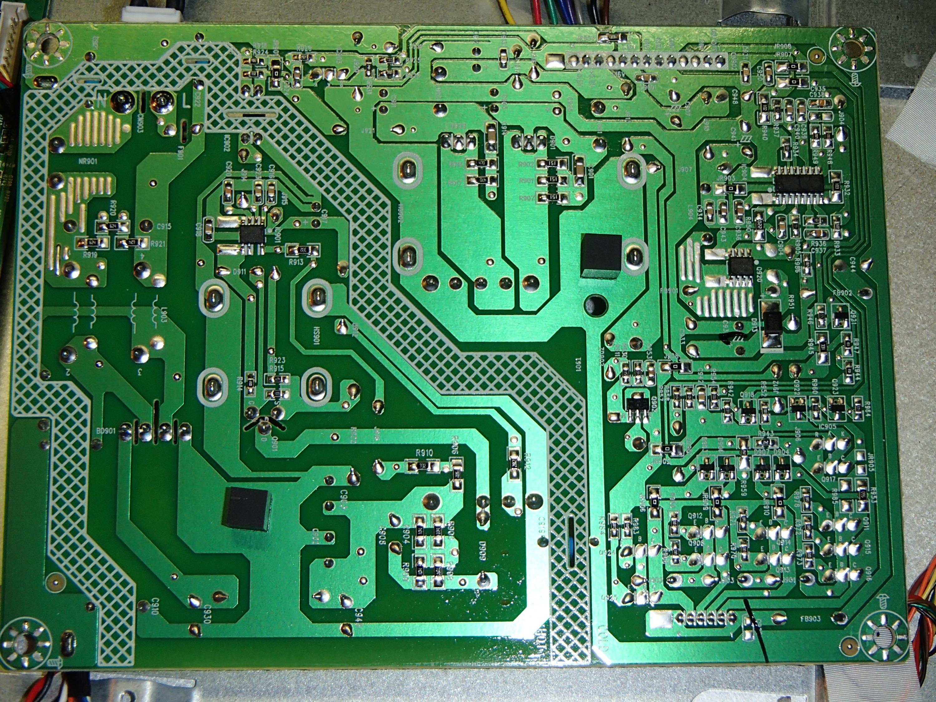

          There should be some surface mount fuses. Look very closely for anything labeled F1, F2 etc...

            haven't been able to find anything with just an f yet, found some labelled fb, but i believe thats ferrite bead. Just checked top and bottom for a second time, all smd components, and cannot find a single fuse on the main board.
              As I am sure you have guessed the pictures are useless for troubleshooting.

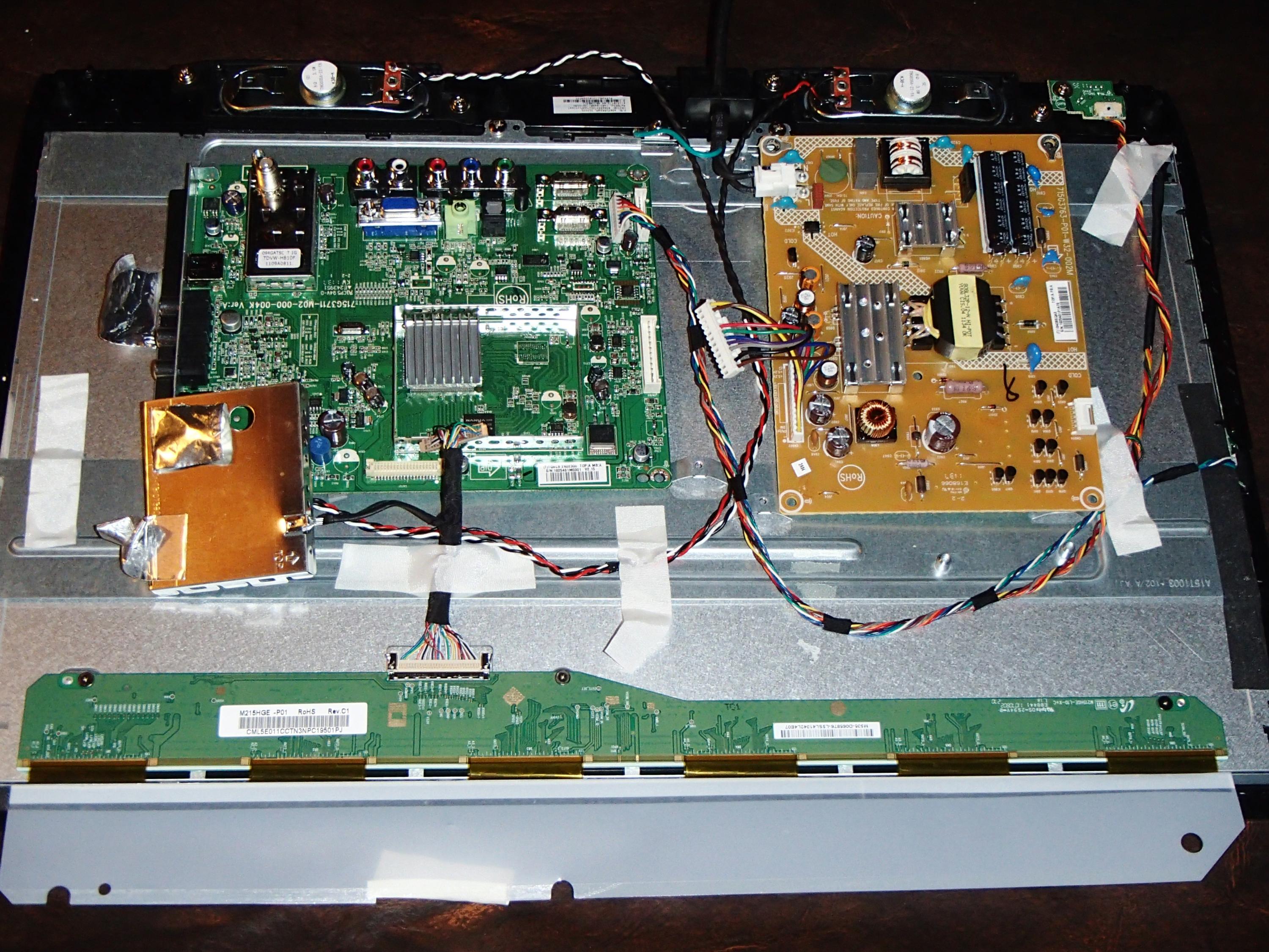

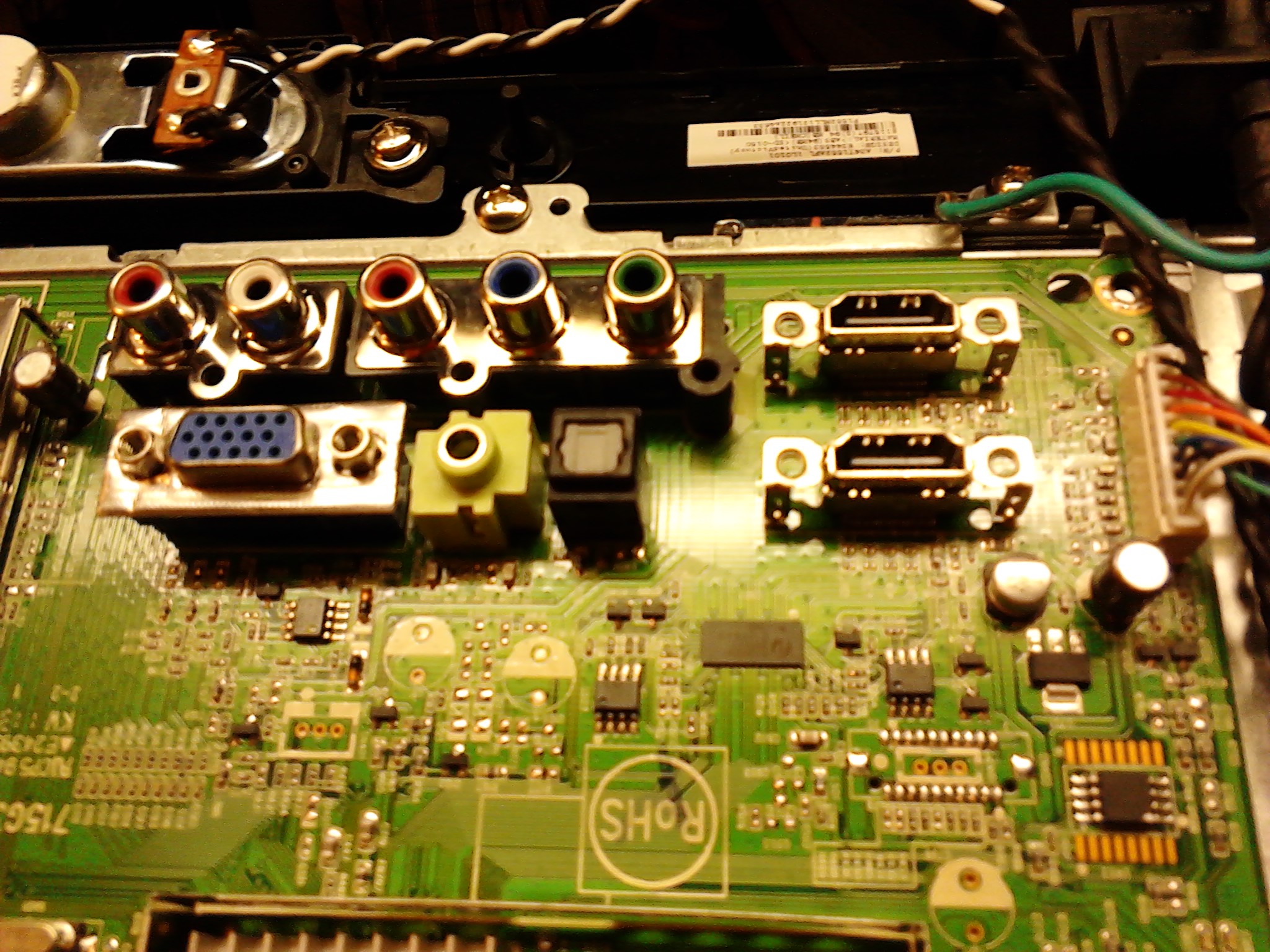

                yes, was pretty sure pictures weren't helpful, but as i said, i needed batteries for my reg camera. figured some pics were better than none. Here are the pictures so you can zoom on each component and see what it is.

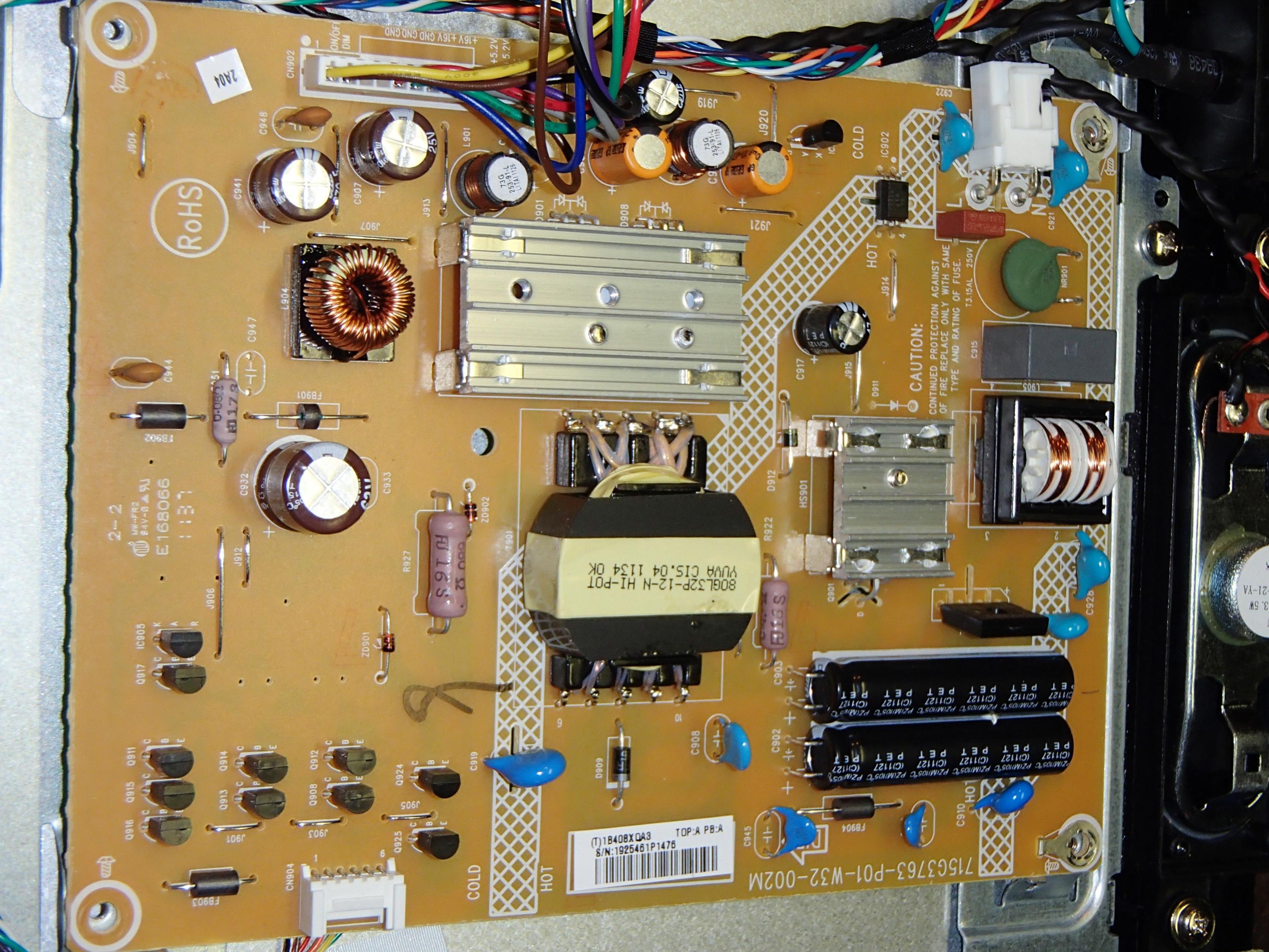

                  Ok Pictures are very good - I cant see any fuses either.
                  Can you do a straight on picture of the power supply top and bottom.
                  and one of the bottom of the main board.

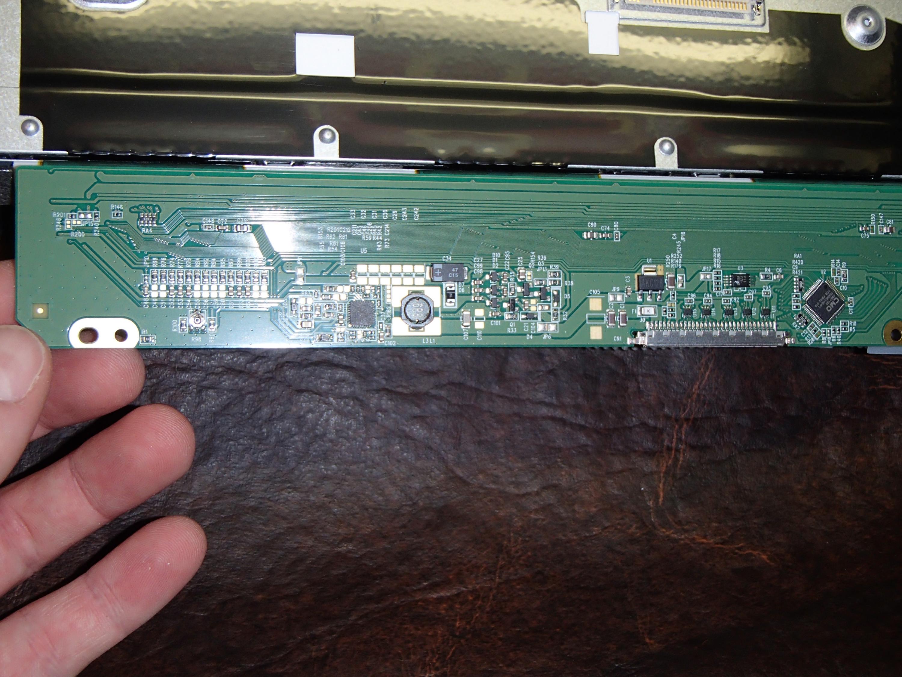

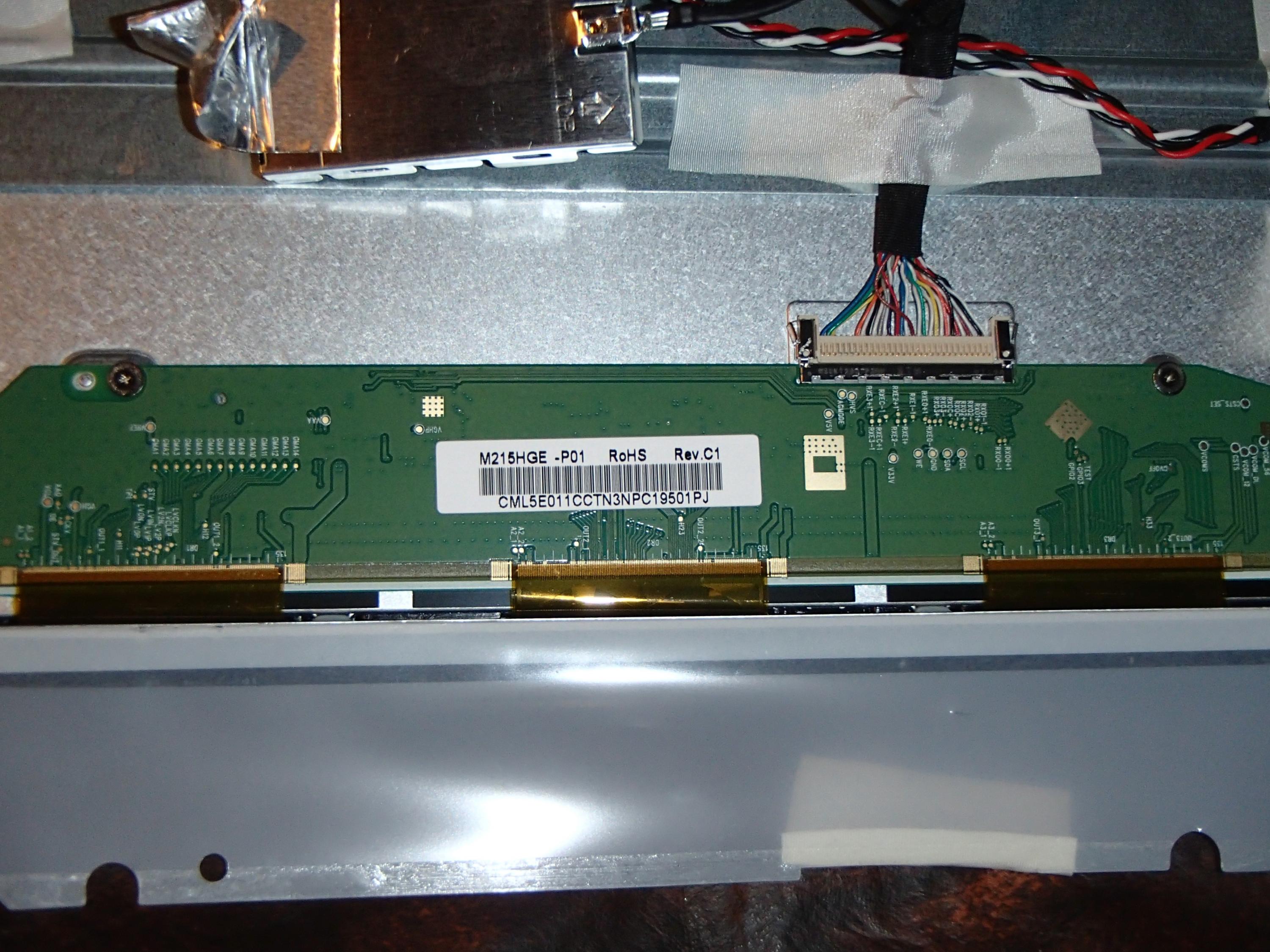

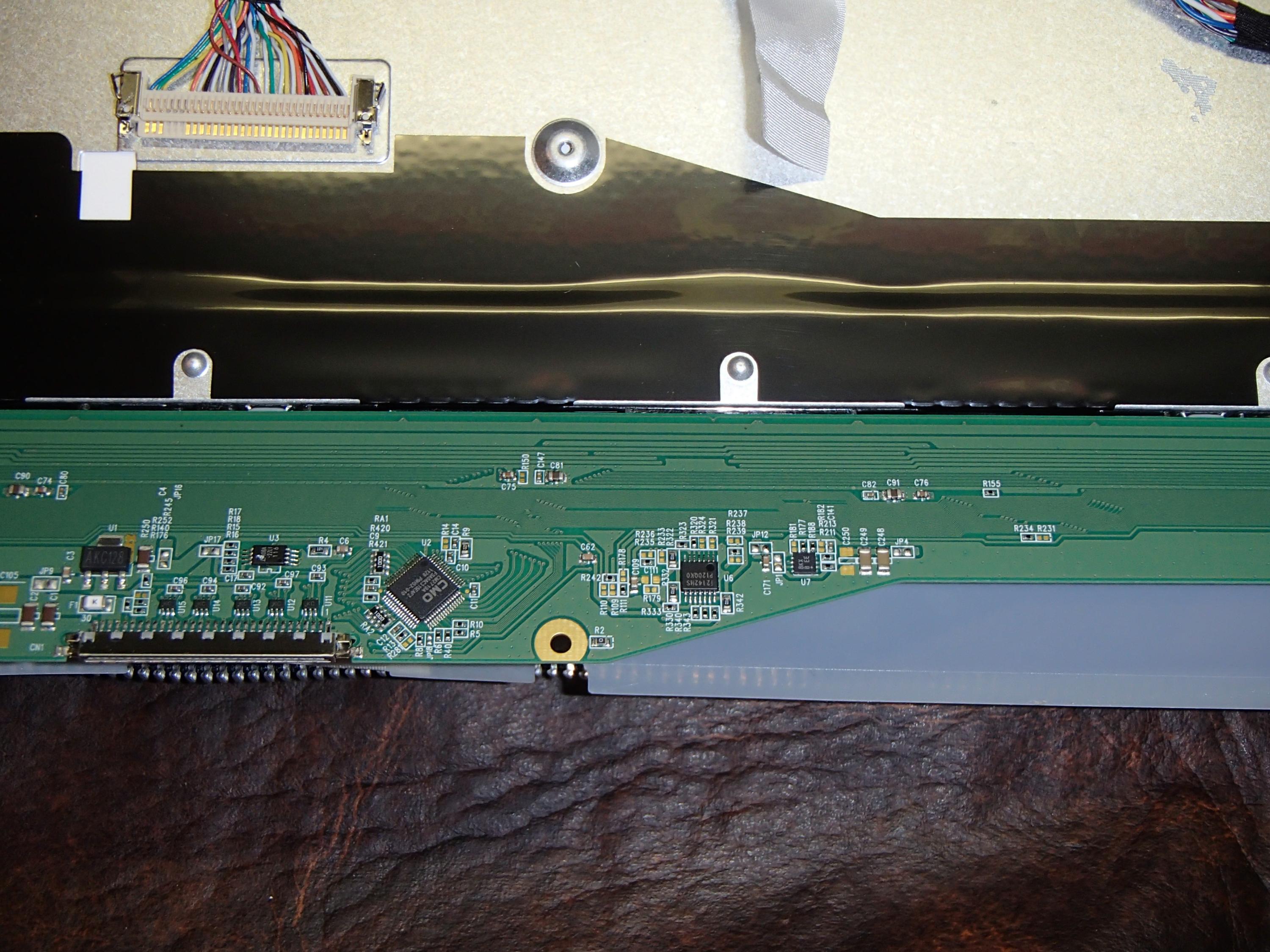

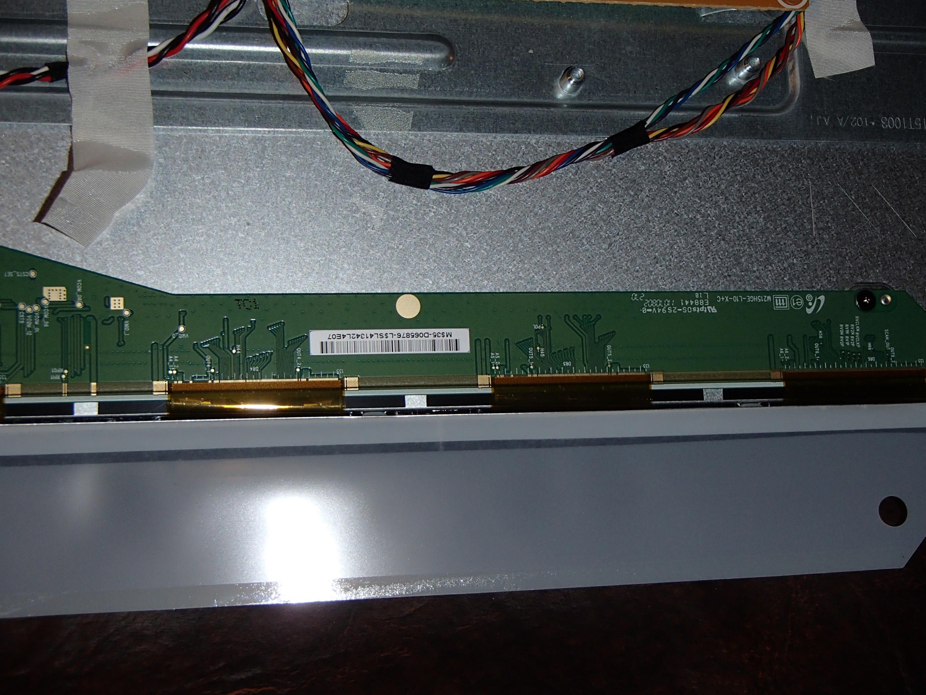

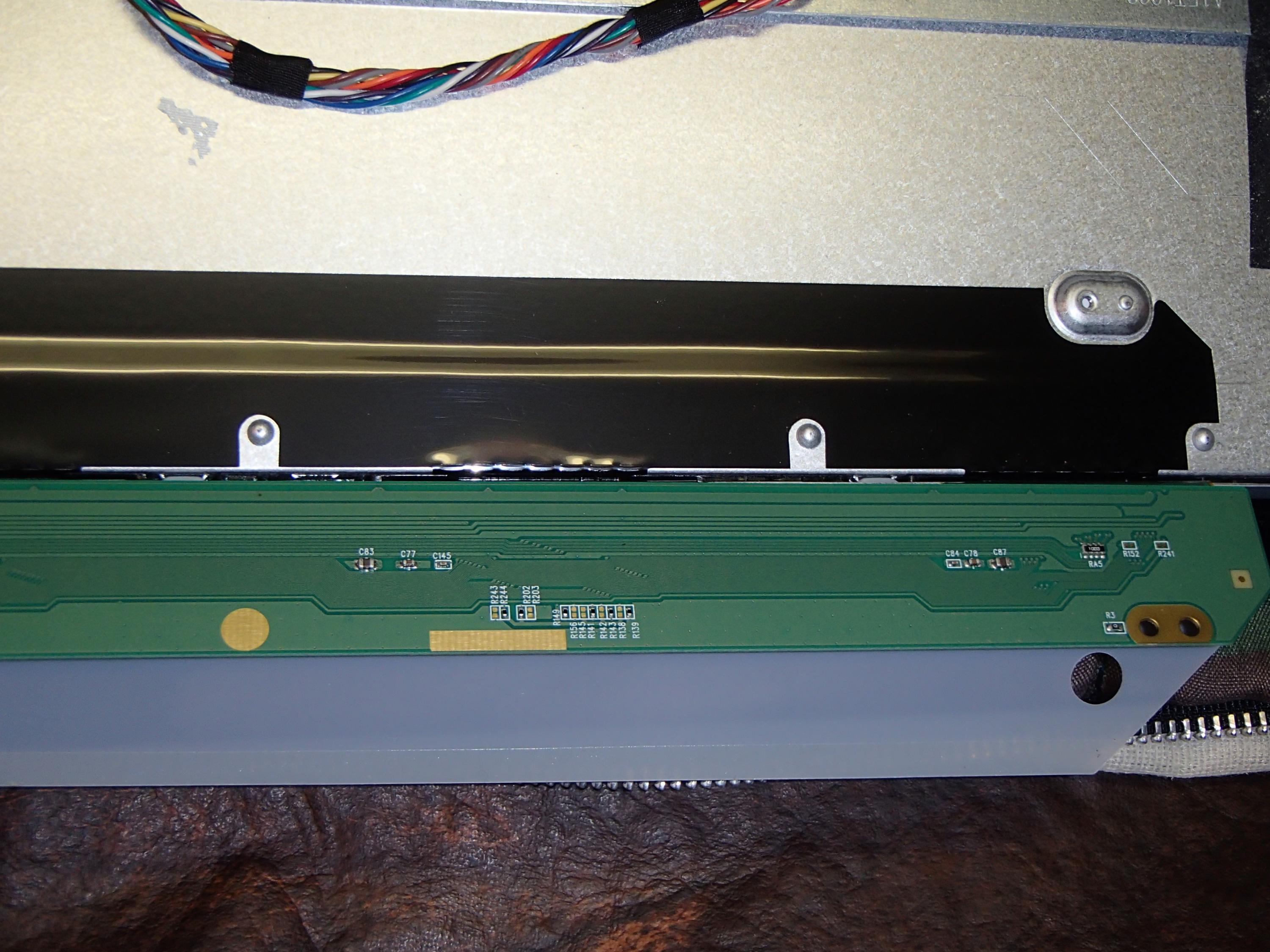

                      OK - There should be more boards with the inverter transformers on and also the TCON or panel board - can you post pictures of those
                      • cguzek
                        • Jan 2010
                        • 57
                        seems like just three boards, and the little one that goes to the standby led and ir sensor. The top board that's connected with ribbons to the lcd panel is getting no voltage at all.

                          heh heh Its a LED lit panel so no inverters - re-think required!!

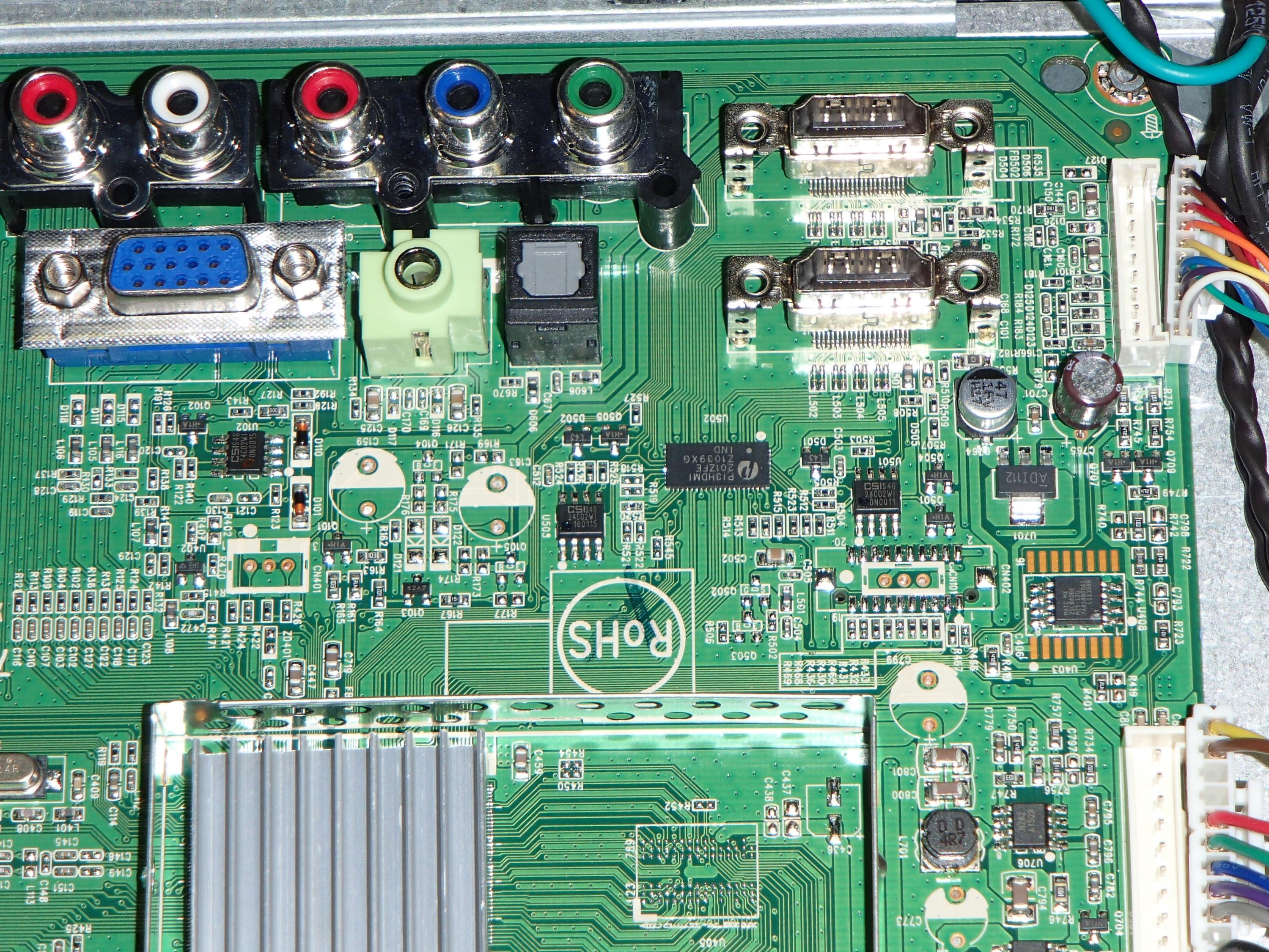

                            At last - in pic 4 and5 there is a small white fuse with a "K" on it - can you test it
                            POWER OFF
                            meter on ohms
                            • cguzek
                                  Fuse marked K, on the panel board is testing good. That board doesn't even get any power when tv is plugged in.

                                    Pity I like a blown fuse - something easy to fix
                                    So need to find where the voltage to the board comes from and why its not there.
                                    Start at the fuse with the k and find which pins the trace goes to. Find which wire/s go to that pin and find the pins on the socket at the other end of the cable. Find where they connect at the main board an trace back from those pins on the main board.
                                      You will not get anything on that fuse since it is fed by switched transistor which is turn on by the main board. I can see some 3-pin regulator IC's. Please take the voltage readings per instructions on the link below my signature.
                                      What voltage do you have on CN902 ON/OFF, DIM PINS?
                                        On DIM pins on CN902, I have 0.00v for both on/off pins.
                                        U701
                                        1-5.09
                                        2-3.30
                                        3-0.00
                                        U702
                                        1-5.06
                                        2-3.32
                                        3-0.00
                                        U703
                                        1-3.32
                                        2-1.25
                                        3-0.00
                                        U704
                                        1-5.08
                                        2-3.30
                                        3-2.05
