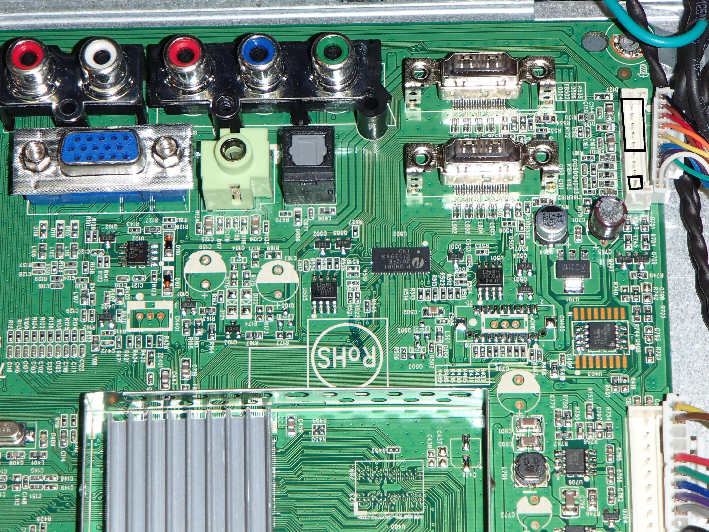

Vizio E220VA no standby, no power

          Found it hard to trace back the K fuse to anywhere on board, such thin traces.
          Included a picture with the wires going to the standby led tiny board.
          Black wire 2.7v
          brown wire 5.0v
          red wire 3.2v
          orange wire 0.0v
          yellow wire 3.2v
          gray wire 0.6v

              Sounds like you have a bad eeprom on the main board.. I found them on ebay for $20 preprogrammed Hope this helps
