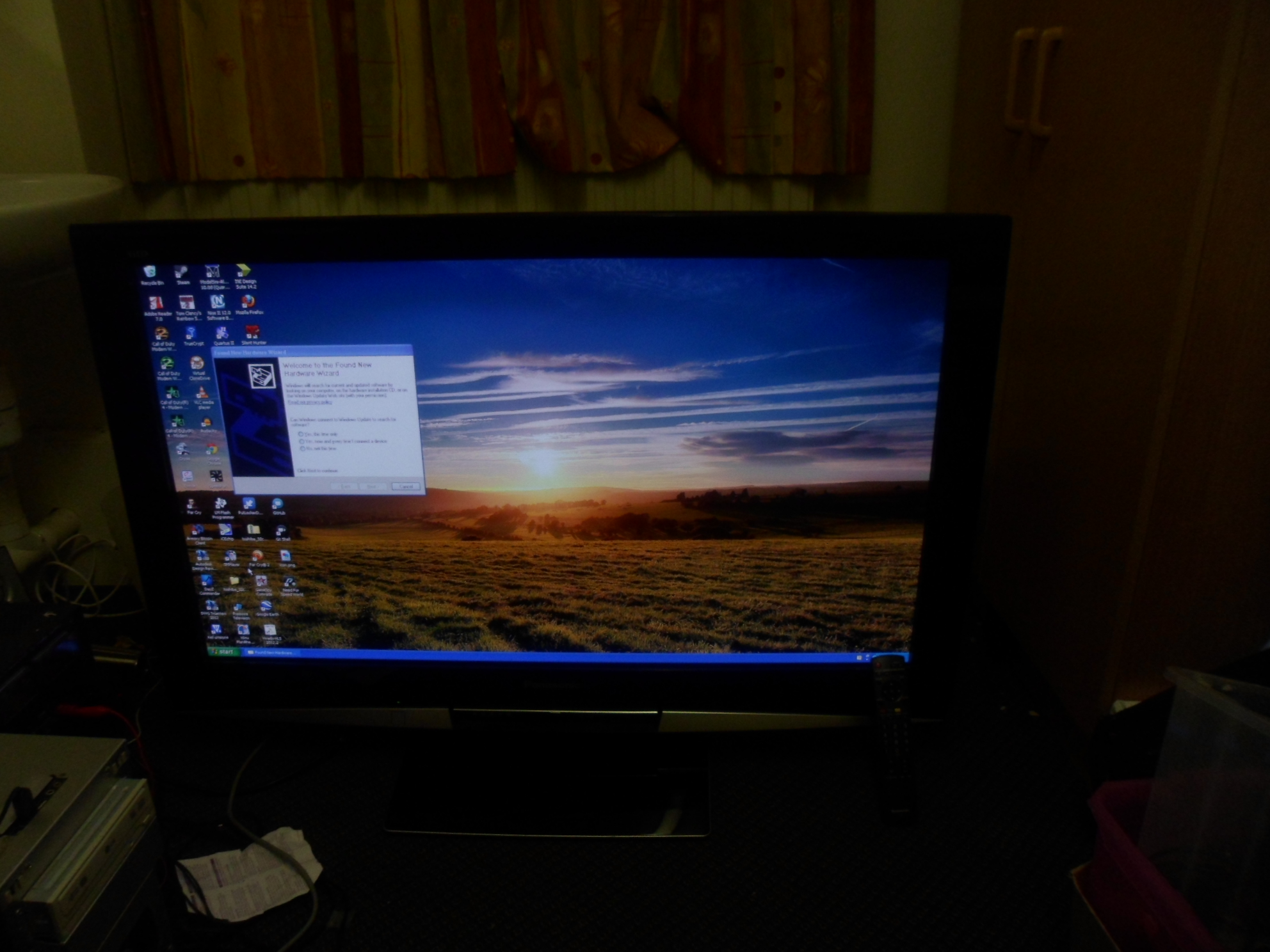

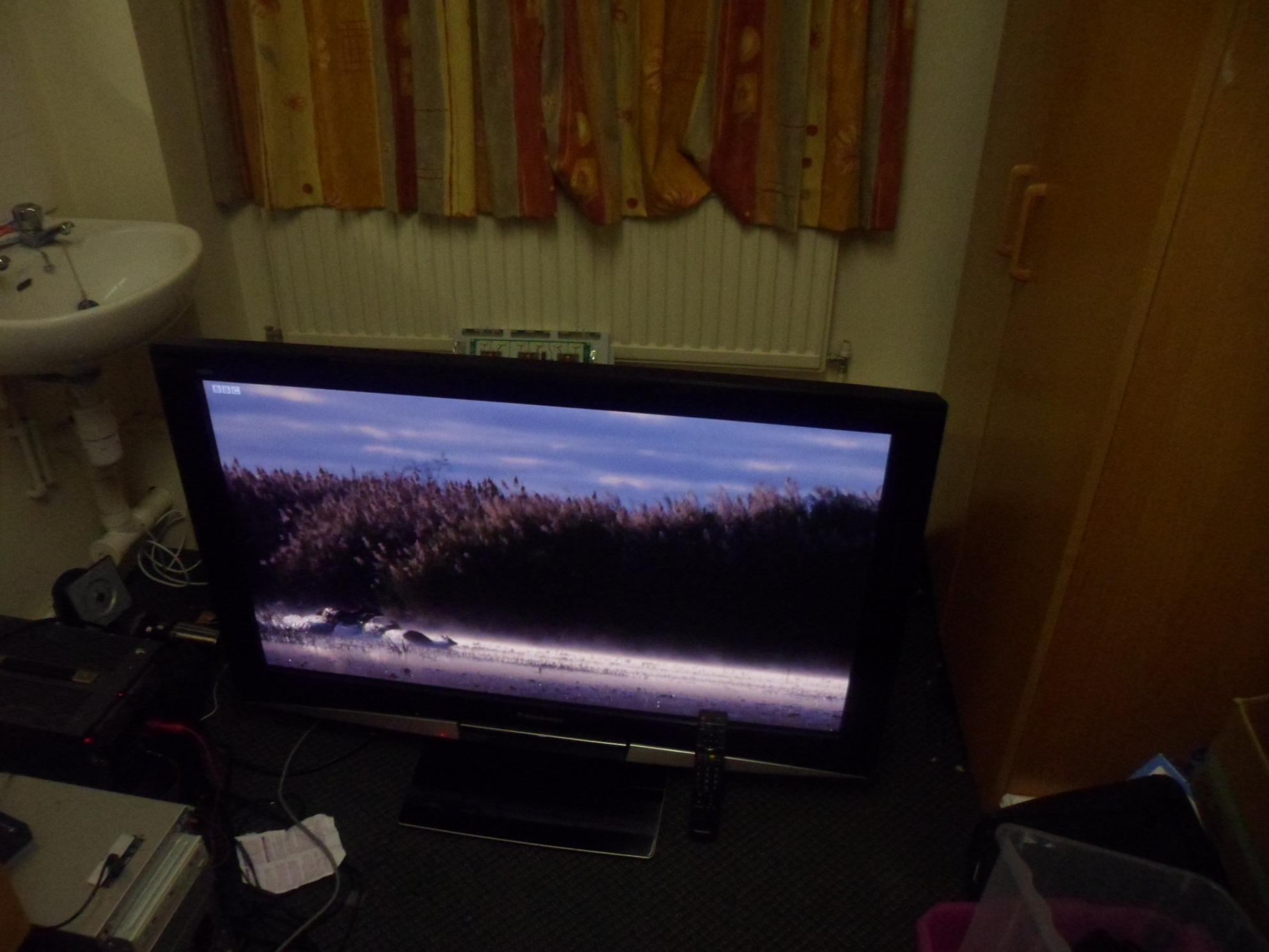

    It's got a picture that works fine for about half an hour, then the picture distorts as attached.
    I'm suspecting the D board myself, as the symptoms look similar in the training manual.
    D boards for these TVs are cheap, so wondering if anyone has seen this before, as it would make for a very nice TV when working. Fits all my requirements: 42" or larger, full HD, Panasonic or LG, and it's a plasma (I'm staying well clear from an LCD or LED TV for now, I've never liked the look of them.)
    Normally I don't pay much for TVs but I'm thinking of paying a little coin since it looks to be a simple £20 board swap.
    Thx

      I would agree with you in the D board being the most likely fix Tom. While I have not seen that specific symptom on a Panasonic, I really can't think of any other board that could make the screen look like that.
        Re: Suspect Panasonic "D" Board - TH-46PZ80B
        I notice the D board has two large processors on it for the plasma panel AI (logic.) If one failed I guess the other might get messed up too. I'm confident it's not the panel, SC, SS, SU or SD. There's the chance it's the A board, but that would be unusual, as it processes the video from top left to bottom right. The A board is around £50, so I'm hoping it's the D board. Hopefully, I will win it.

                          Ah, when I went to plug it in after tearing it down it finally started showing the symptoms.
                          More than likely that loose connector needs reseating as the vibration and movement probably loosened it to the point of failure.
                          I noticed the test patterns, except the A board test (dull grey) all appear unaffected (when using the service menu.)
                          So it MAY be an A board issue. No biggie, that part is available too, a little more pricey but not much more. I'm hoping it's just the LVDS cable between the A and D. As the test patterns for the panel are generated by the D board on command from the A board.

                            This type of symptom is very common on these Panasonic sets. It is usually one of the connectors that go to the D-board. Lightly tapping the connections on the D-board should reveal the loose connector. Once you find it just tape it down with electrical tape and it should be fine. I have fixed a handful of Panasonics with similar issues.

                                Well, got it open... quite the job. I found the LVDS connector on one side to be poorly seated. Pressed it down and heard a satisfying "click". I think this one is fixed. Is it worth taping it, I'd need to remove the A board assembly...

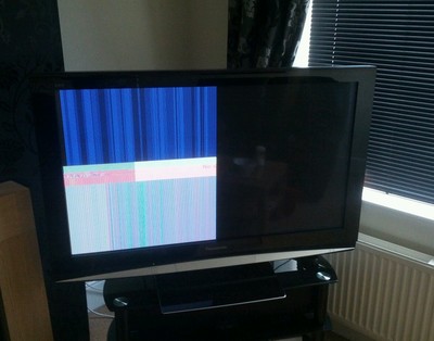

                                          Panasonic th-p50s10d - blinky red, SC board go boom
                                          by dajoker
                                          My old plasma died when one night recently. When I got to it it was giving a 3.3v sos (3 blinks).
                                          I chased my way through the PSU, and a board, with no results.
                                          Replacing a few bulged caps in the PSU, I eventually got to the SC board that had piles of shorts, a quick cheap replacement from china and the tv powers up again, except
                                          I only have the right half of the picture.
                                          Left half is completely blank.
                                          now the c3 board running this side of the screen has its 3.3 and 5v onto the buffer ic and its got the 60v, so that all seems good.
