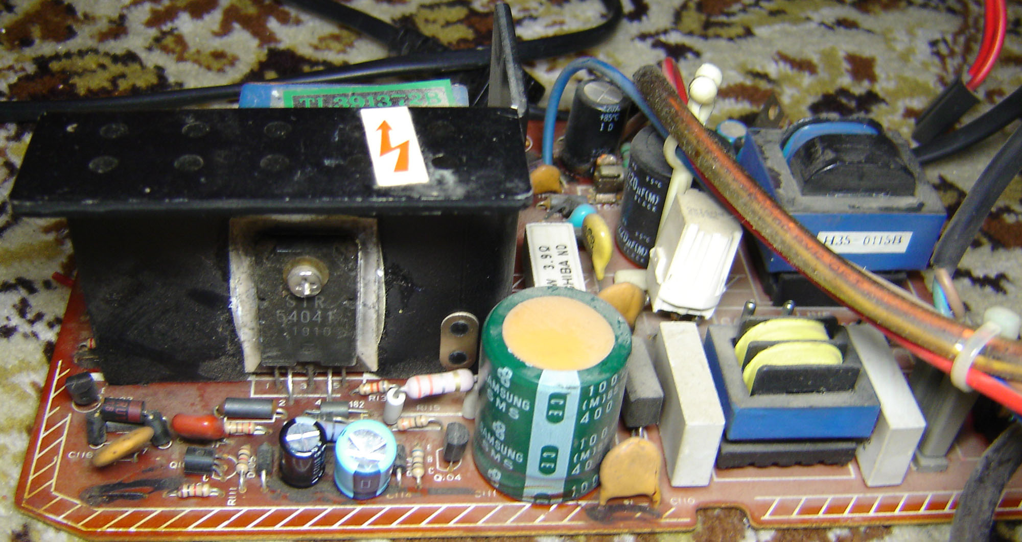

    Lorenz CTV-2101R CRT repaired

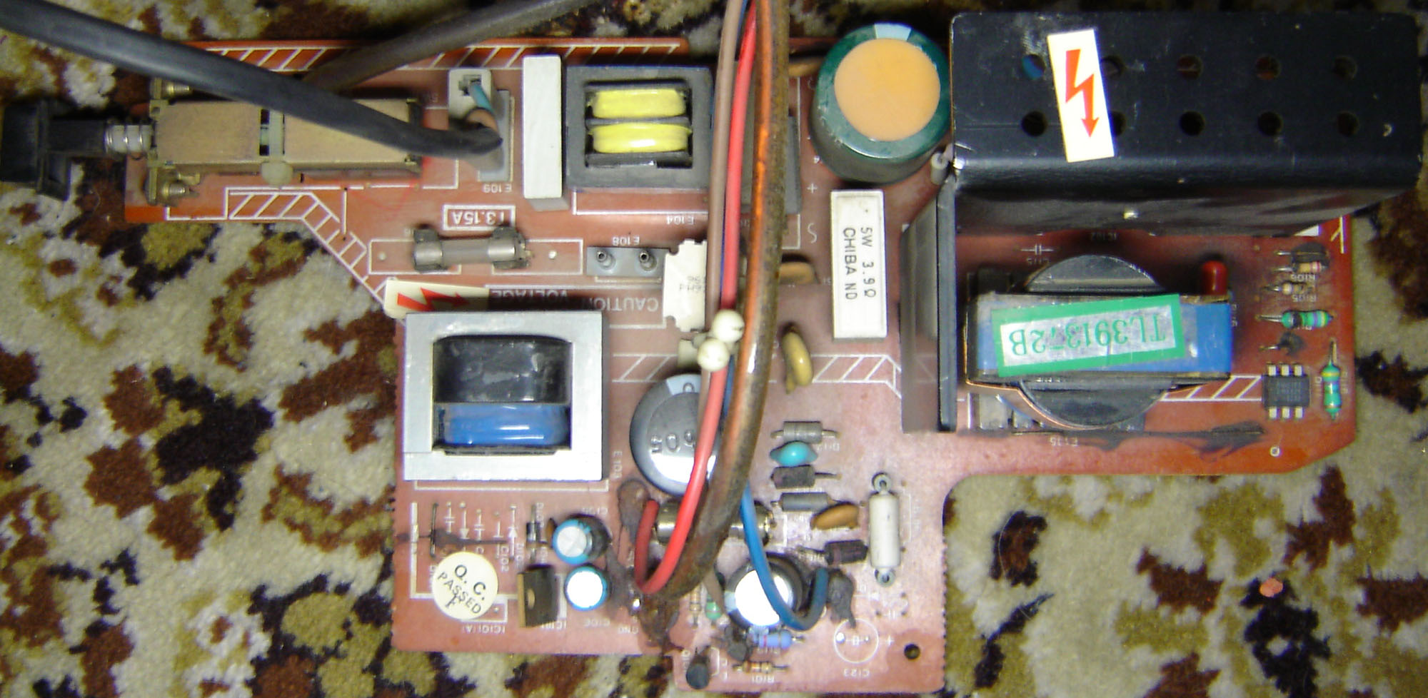

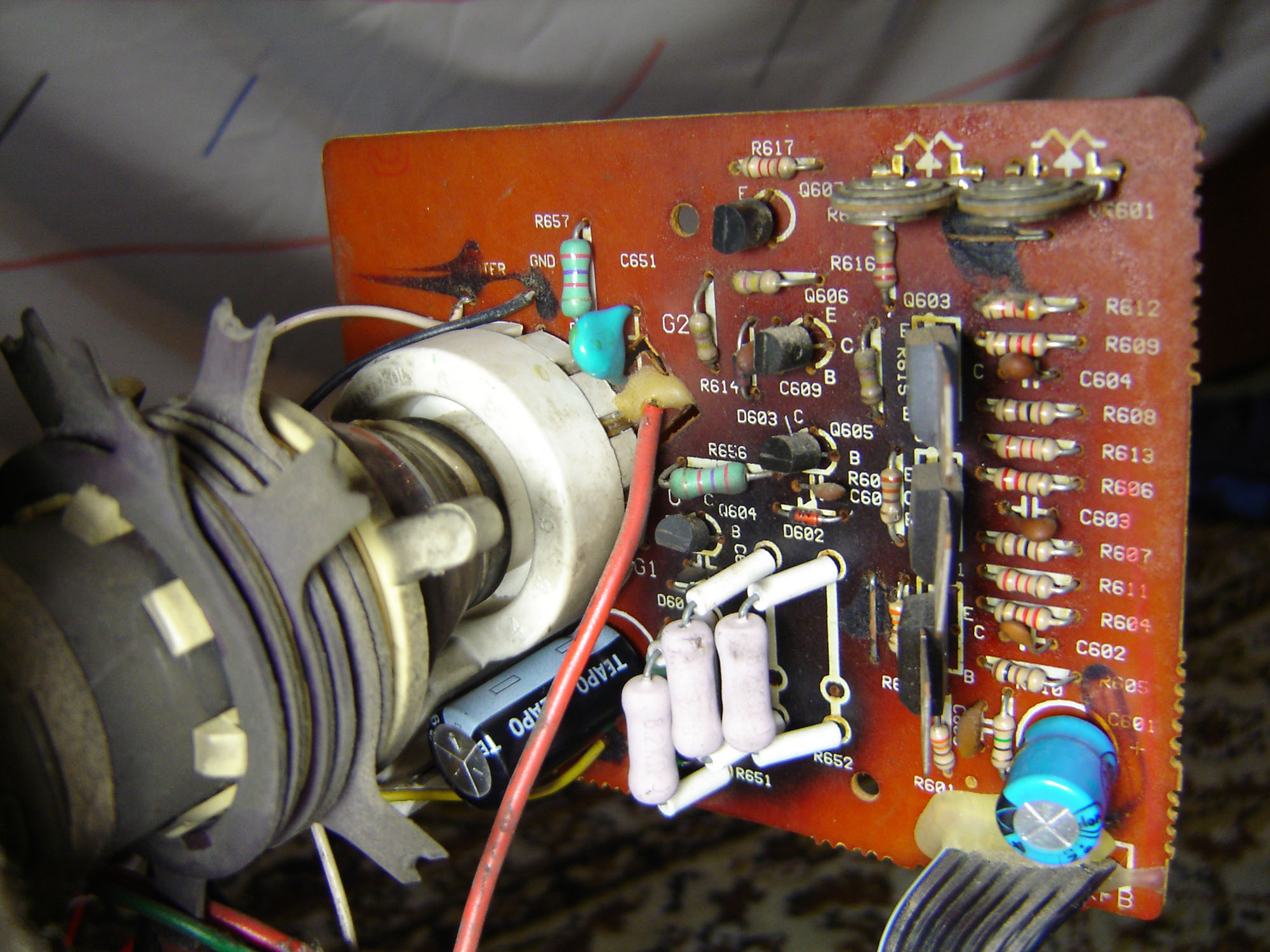

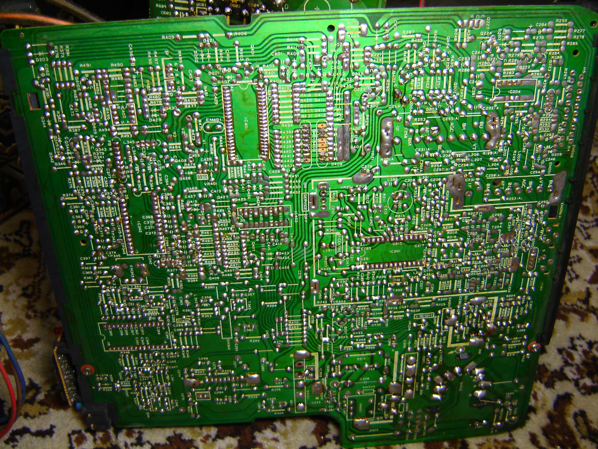

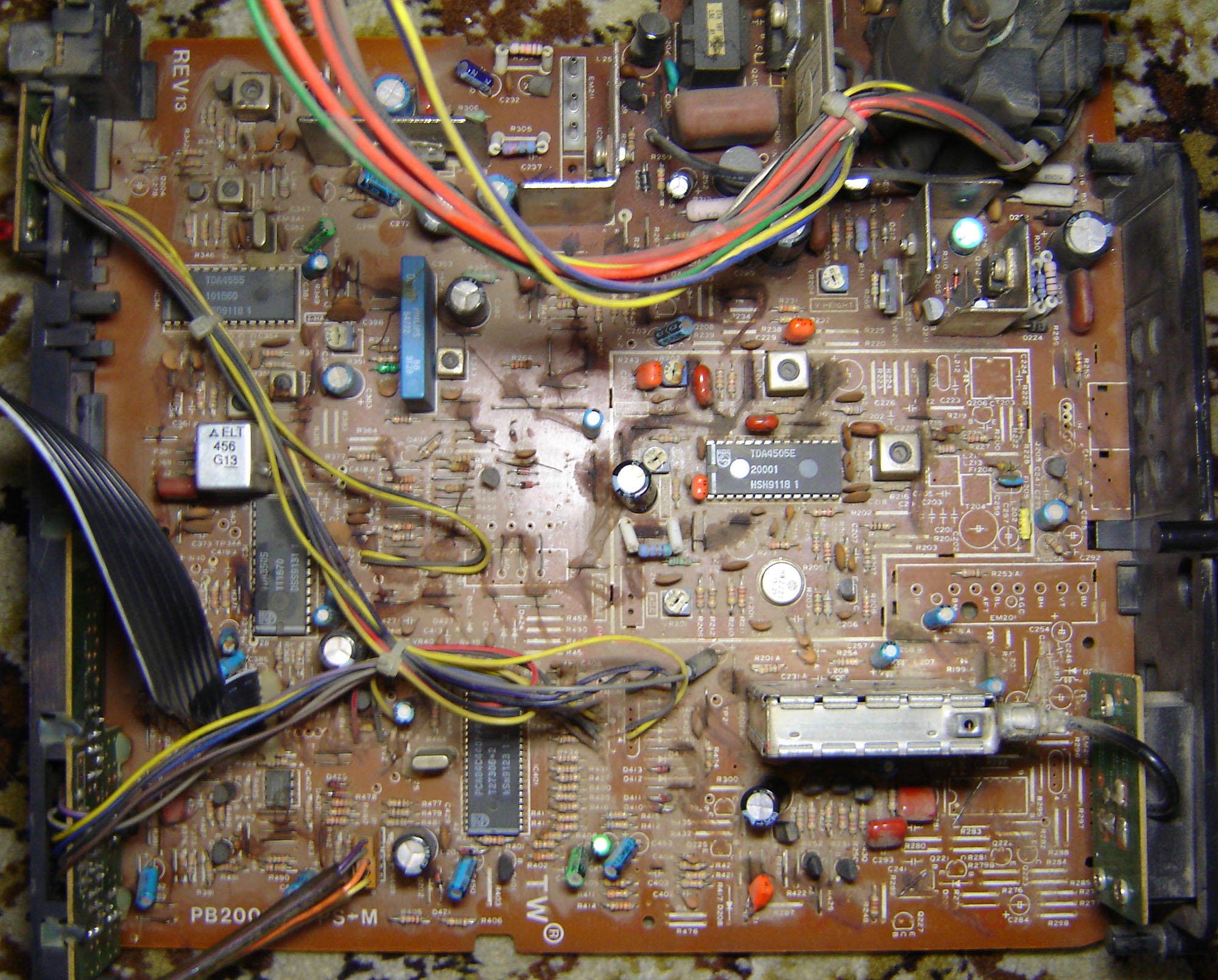

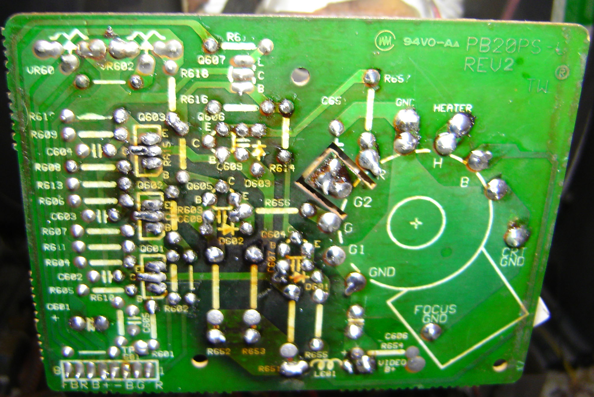

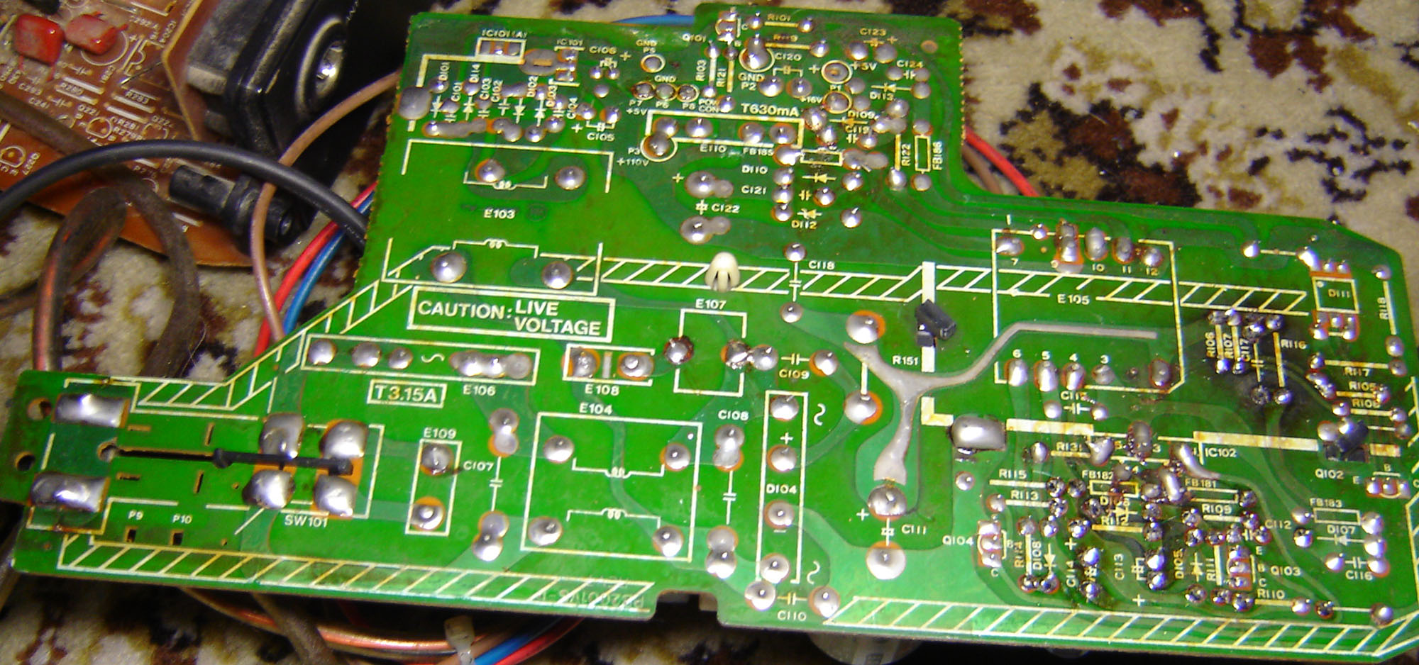

    This was my grandmother's CRT since 1990. We bought 2 at that time, 1 for them and 1 for my parents. The second works without any problem to this day.
    The TV set of that thread on the other hand, started to have some serious convergence problems and 1 month ago suddenly lost its red color.
    I checked all the caps and had to replace 9 that were completely dead or had too high esr.
    The CRT board has turned black from heat and most of its solder joints were in bad condition. I reflowed nearly all of them and several on power supply board.
    Then the colors came back, but the convergence issues remained.
    I noticed that the magnet rings had gone loose and there was no indication of how they were factory configured. I reconfigured them very carefully and patiently and the convergence problems were fixed I was even able to enhance the colors purity. I put some drops of logo to secure them. What type of glue is suitable for this application?

    Wow that is awesome! Great job, I always like to see pics of the inside of CRT's Glad you got it working!

      Did you notice the big Samsung capacitor on the power supply board? I didn't know Samsung made caps. There are some Daewoo caps too, 2 of them were bad.
      Thank you! I wish I knew how to fix the Sony CRT TV too:
      https://www.badcaps.net/forum/showthread.php?t=25426
        Re: Lorenz CTV-2101R CRT repaired
        Samsung's capacitor business was spun off into Samwha.
        Daewoo folded a few years ago, but they made a lot of electronic components, I've seen their caps in an LG LCD TV too.
