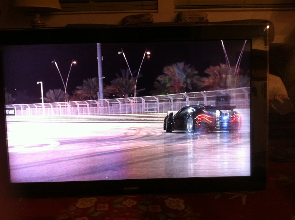

            Just the end ones were a problem on this Samsung 850 series. 2009 model.
            Same deal - 850 in the 46" size; 2009 model; top right hand side. Spooky.
            Starts out pretty bad when cold; gets better when it gets some heat off the TV and after a bit of massaging by me, but I can't clear the last bit (about 3 lines of pixels worth).
            Even so, I reckon my chances are pretty good with this one once I've got it torn down a bit further. Don't you guys?

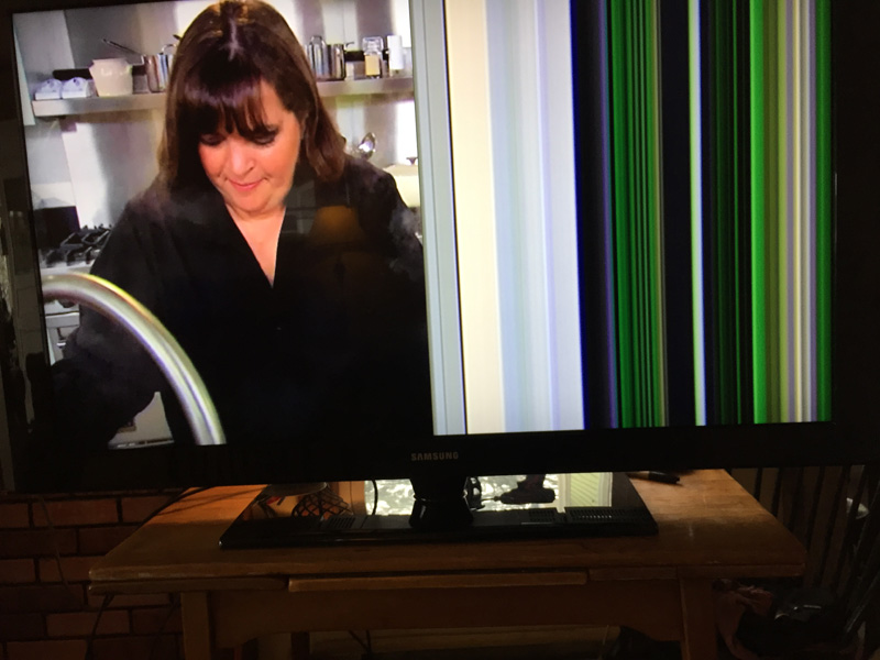

              I didn't mention it earlier, but I went dumpster diving at BB again and found a somewhat neglected looking LN52A750, mostly from the way the Geek Squad guy handled it than anything else. I know they consider these trash, but I do wish they'd quit dragging them around on the ground once they've got them out of their trucks! Of course, it's also missing the stand and remote.
              I was hoping for an easy victory from this one, and am pleased to find what is almost certainly a single bad tab bond. Didn't even need to take it apart to "fix" it - just need to give the top right hand edge of the back cover a thwack with the palm of my hand when it starts acting up. Of course, I'll still need to get in there and try to shim it properly, but I'm more than confident. Not "I'm going to sell it for big bucks" confident, you understand, but certainly "I'm sure one of the grand kids could find a use for it" (with the advisory that it may not last forever) confident.
              I must say that, as I research (and play) with these, I am truly shocked to find the same engineering failures over and over again. OK, fine, we know the bad caps issue was more about skullduggery than bad engineering, but there really are no excuses for the tab bond failures. Over what years was this most pervasive and was it limited to Samsung manufactured panels only? If so, did Samsung sort it out in recent years, or do we not know yet? If not, what about my LG TV's from 2011/2012...I won't have to put up with this stuff when it comes to those, will I?

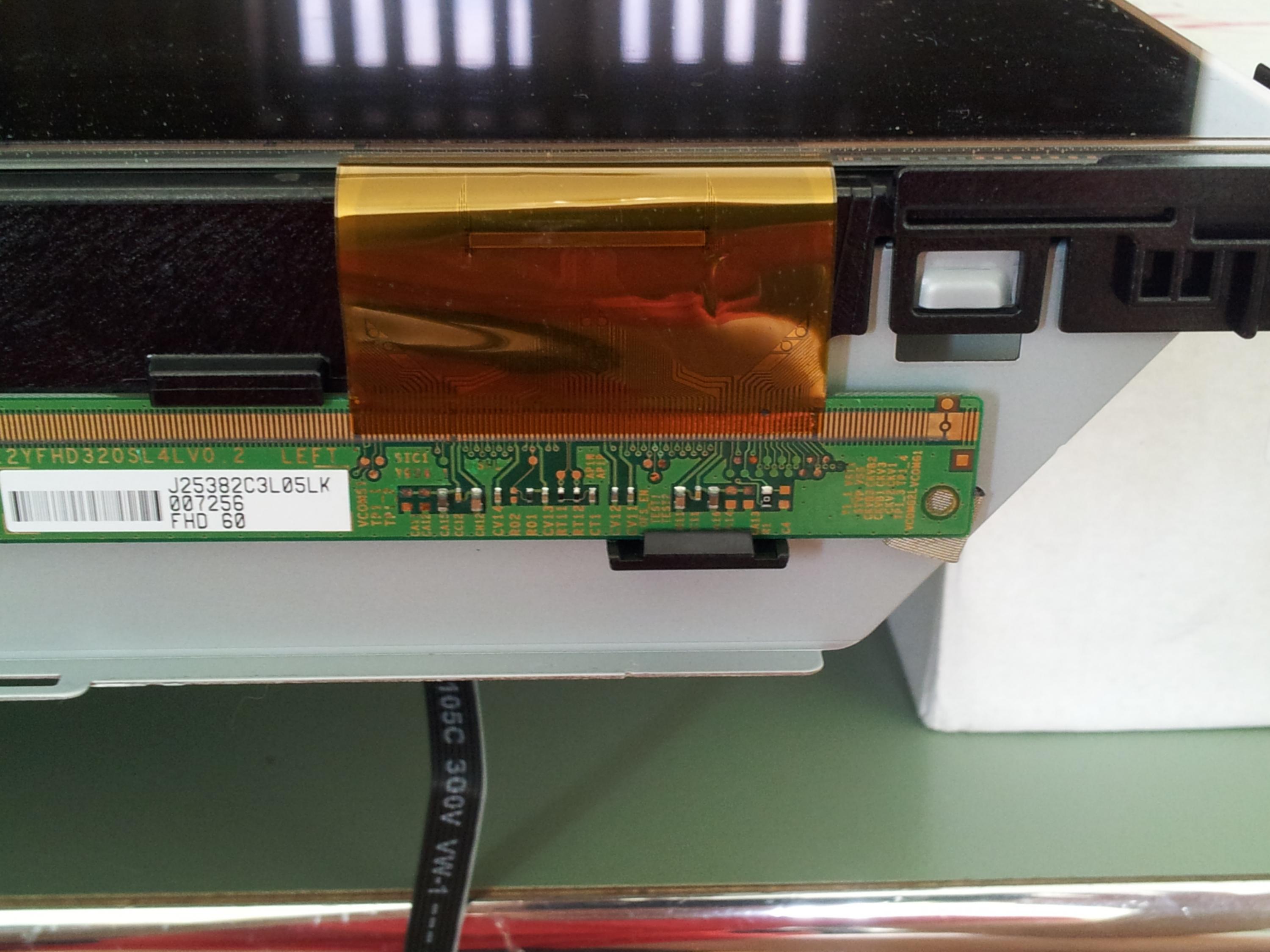

                  I didn't mention it earlier, but I went dumpster diving at BB again and found a somewhat neglected looking LN52A750...I'll still need to get in there and try to shim it properly, but I'm more than confident.

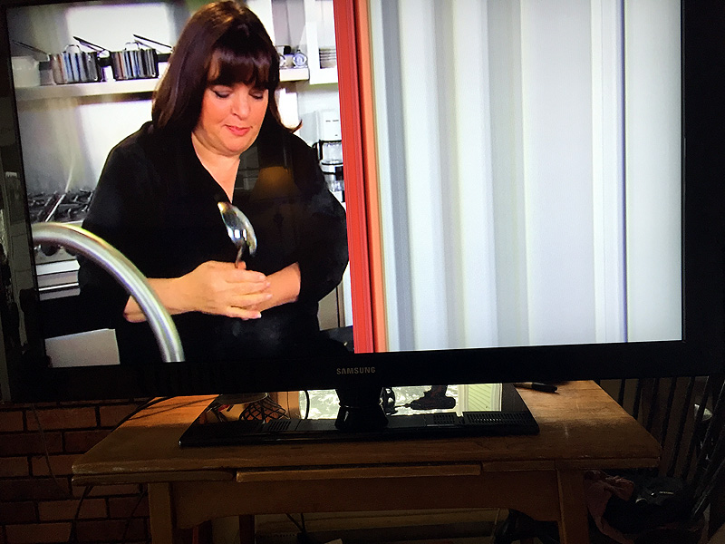

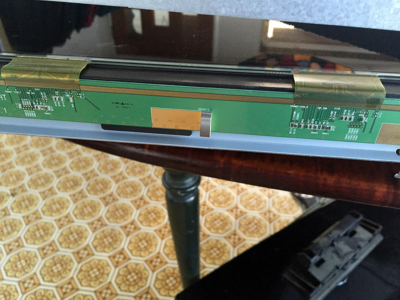

                  Well this one is taken care of. I shimmed both end tabs with a piece of this stuff, triple folded to give it the right girth:
                  http://www.ebay.com/itm/111642792448....M-7840.R6.TR7
                  I can't say I'm all that crazy about the material - it compresses down a lot, and once it gets a bit of heat on it feels a bit more like putty than foam. It did the job though, and the right side tab appears to be completely fixed. I found that I could still get the left side tab to act up occasionally if I squeezed the metal frame just right. It wasn't consistent though - sometimes I could get it to act up, sometimes I couldn't. The answer of course, now it's all back together with the plastic bezel and rear cover, is to just leave it be.
                  The 46A850 I've also been working on was a bit of a different story. No matter how I shimmed it, I couldn't get the picture to stay clear - installing the metal frame and snugging it up would always make a line or two appear on the right hand side of the screen. Even if I left the center screw out of the metal frame, the same lines would still appear once I'd properly installed the plastic bezel. I had that thing apart three or four times...until I somehow managed to crack the LCD. Sigh. So, sadly, that's another one I'll have to salvage for parts. It's a shame, since it was cosmetically much nicer than the 52" and had the stand! Insult to injury is it's also the one I actually spent good money on (to replace the bad PSU).
                  Oh, well. At least I got one good TV out of the three I've rescued and kept so far, and I do have quite a good stash of marketable parts to sell!

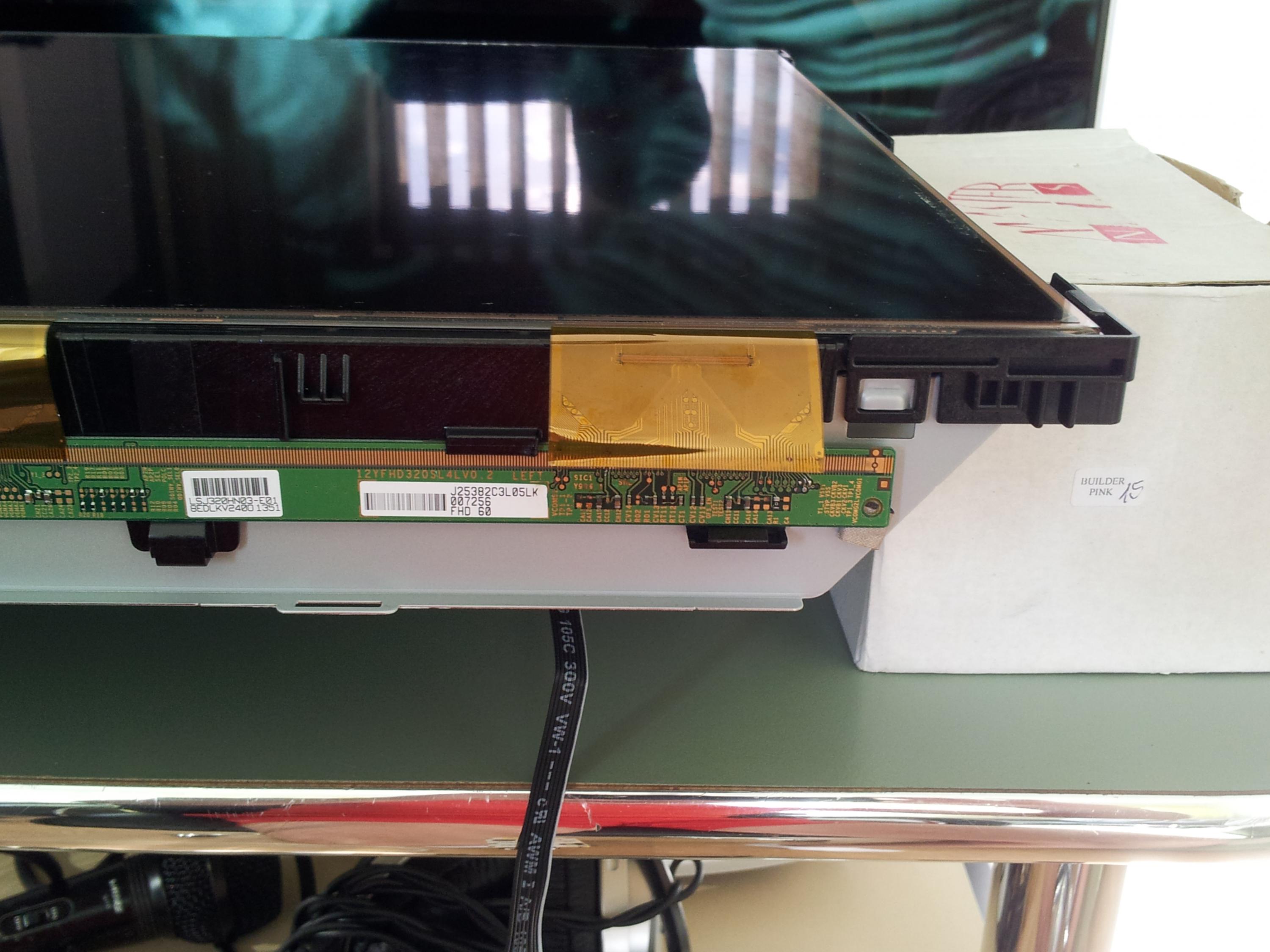

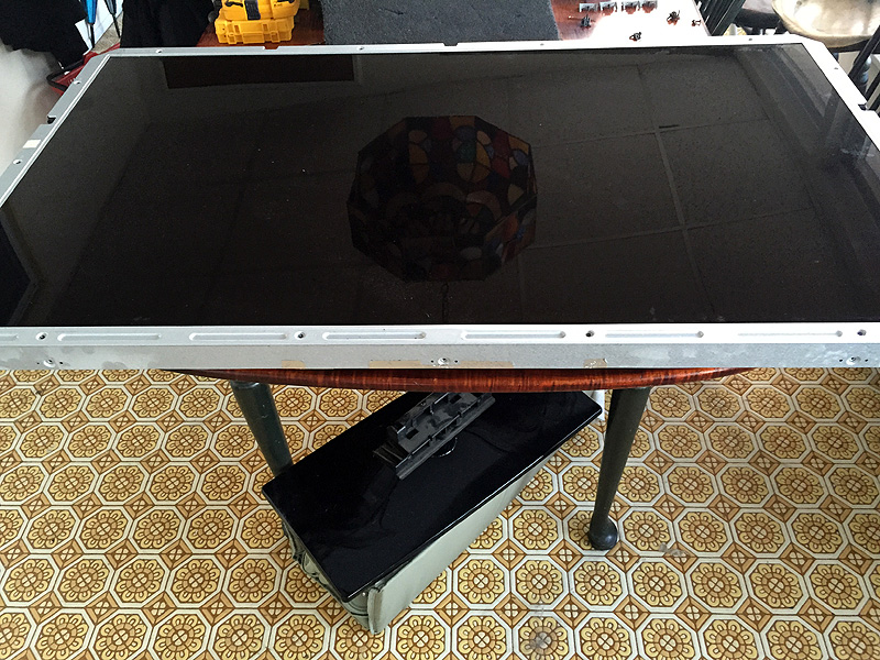

                            A couple weeks ago I was fortunate enough to pick up a free 52" Samsung LCD that had this same "tab bonding" problem. By reading all the posts here I went ahead and ordered the thermal pads from Digikey.
                            Then when I had some spare time I went ahead and opened it up and applied the cut pieces of thermal pad as others had done.
                            I closed it all up and was done. I didn't time myself, but didn't rush it either. I guess I was done in a couple of hours or less.
                            I now have a 52" handing on my living room wall. The 40" is going in the bedroom.
                            Thanks Guys!
