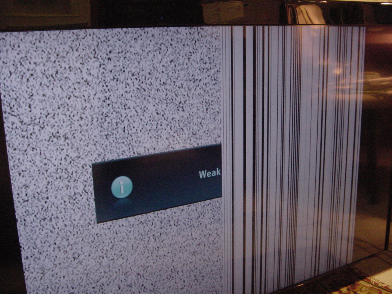

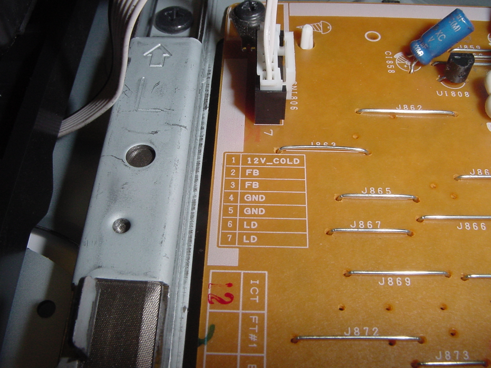

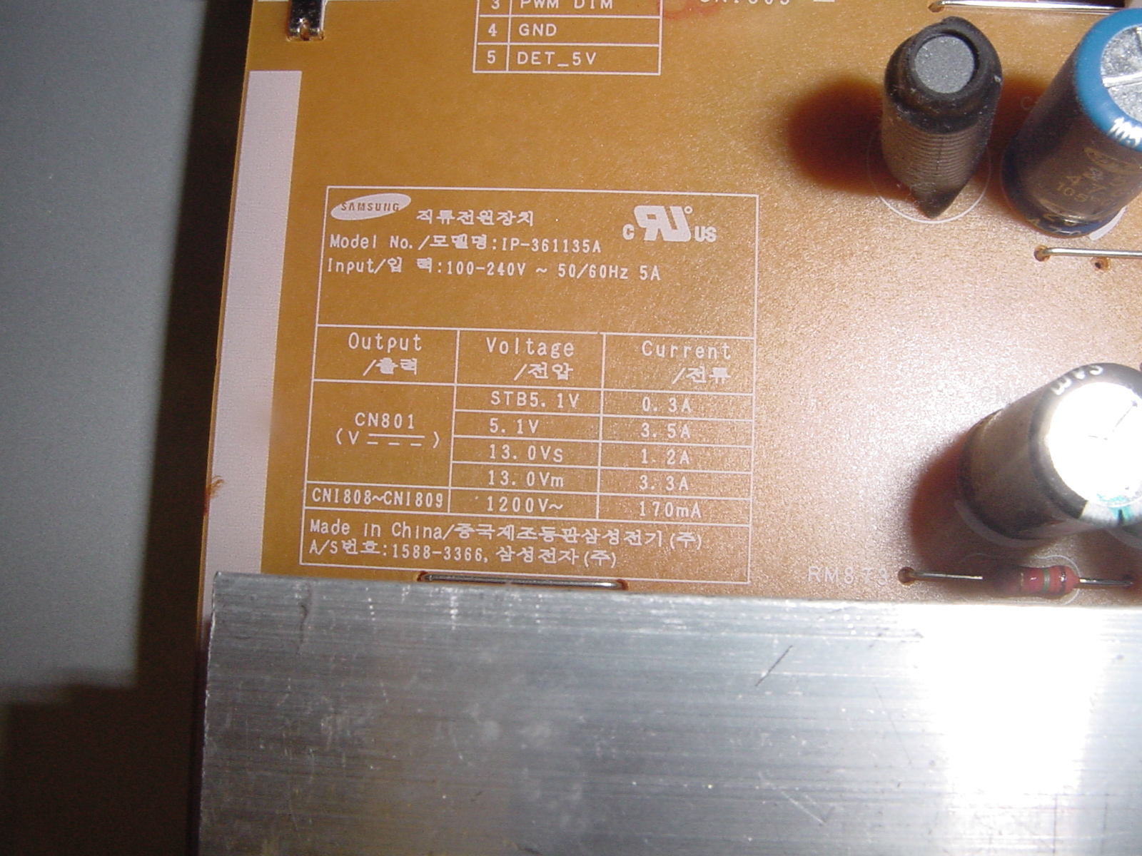

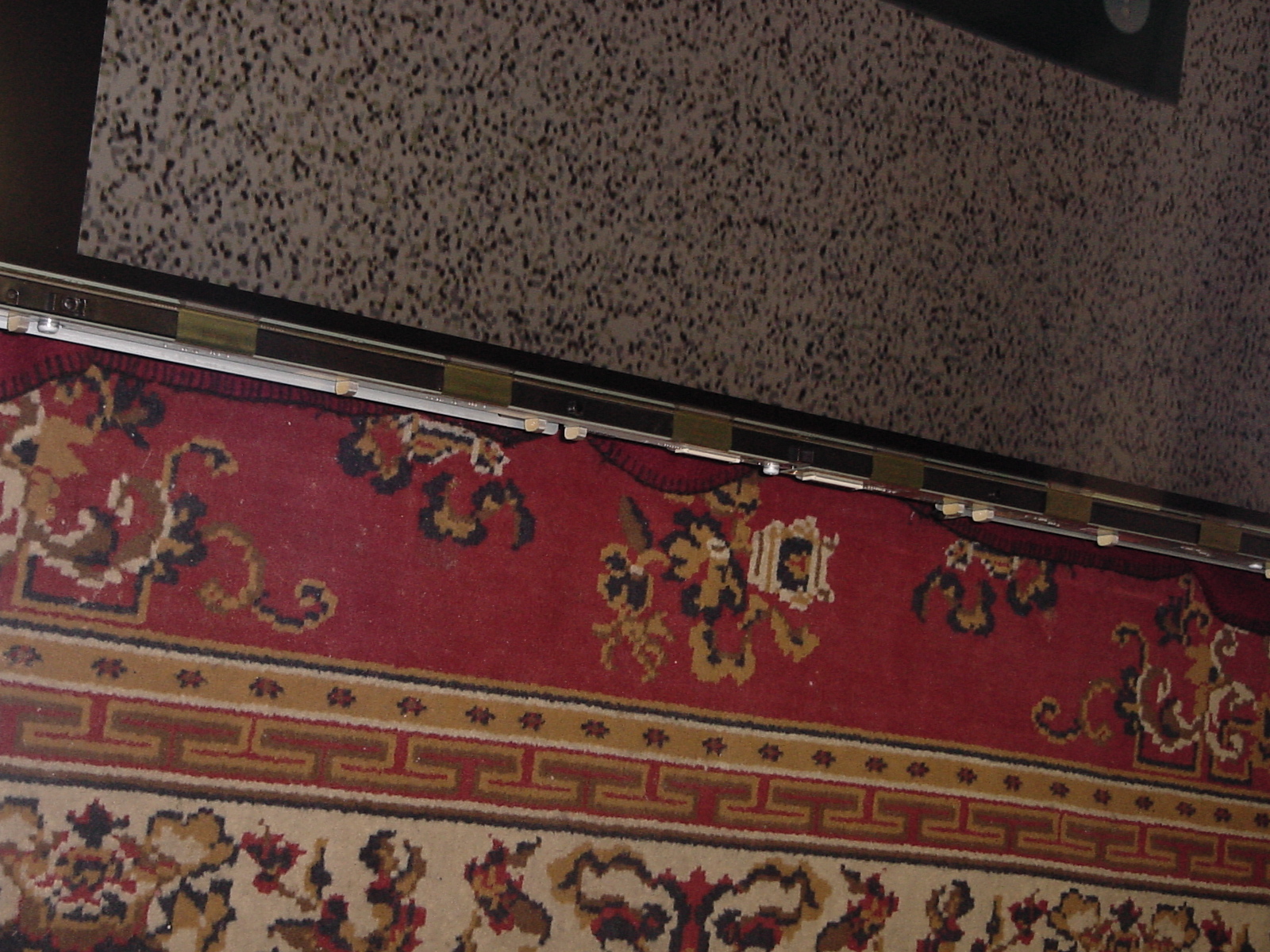

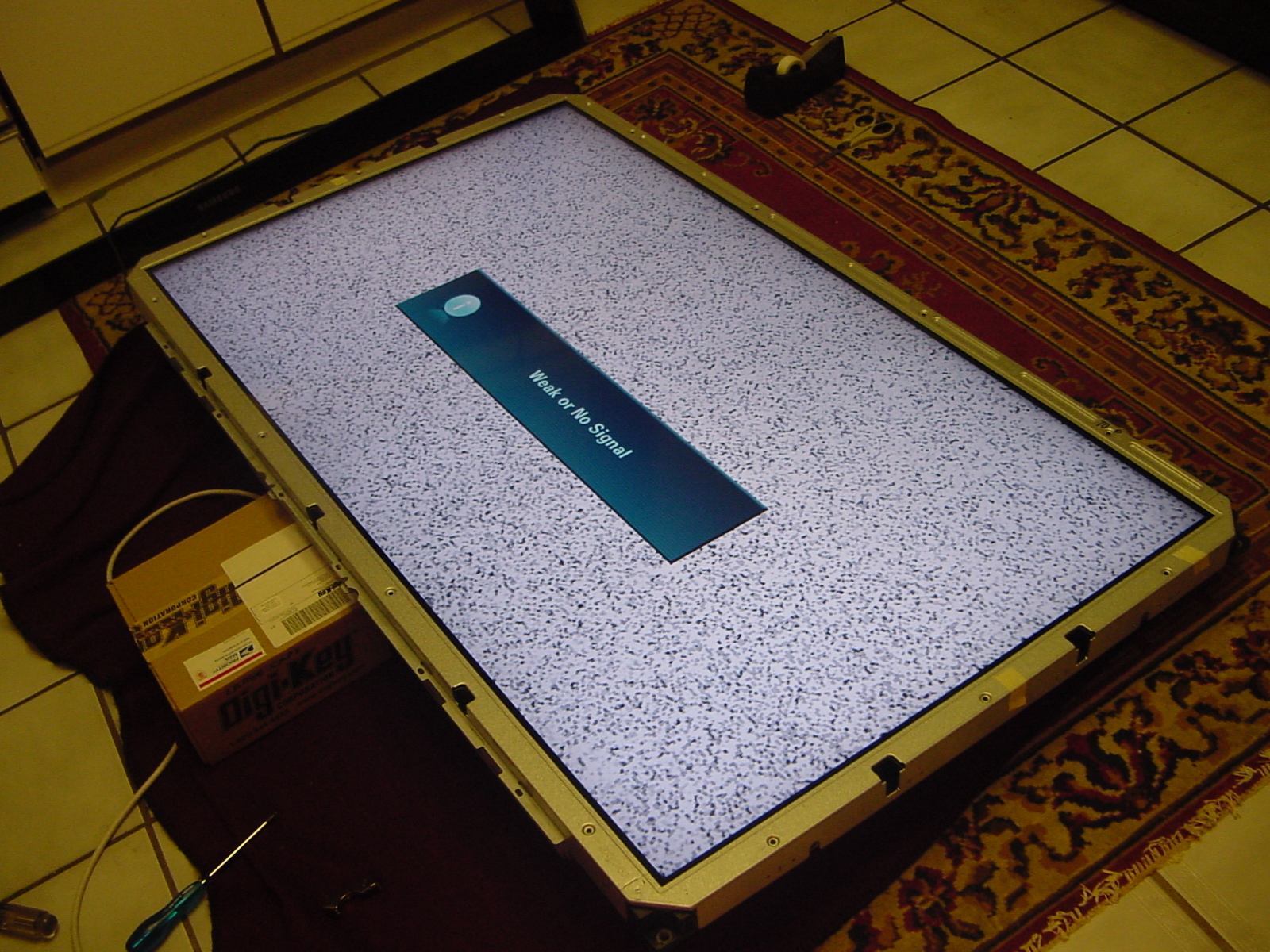

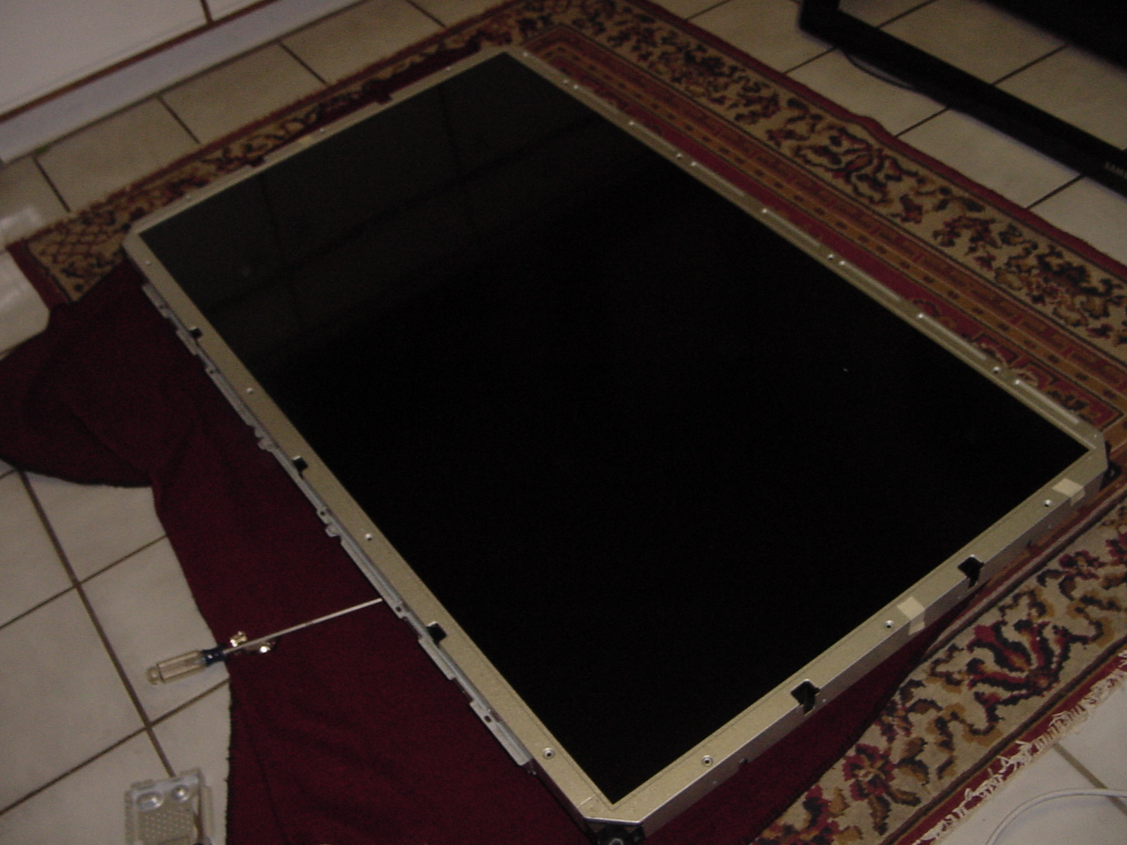

    I got another 52" today, this one is Samsung LN52A530P1FXZA.

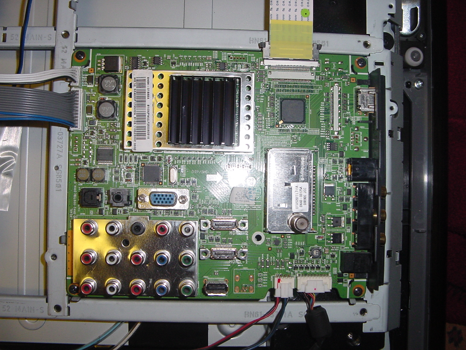

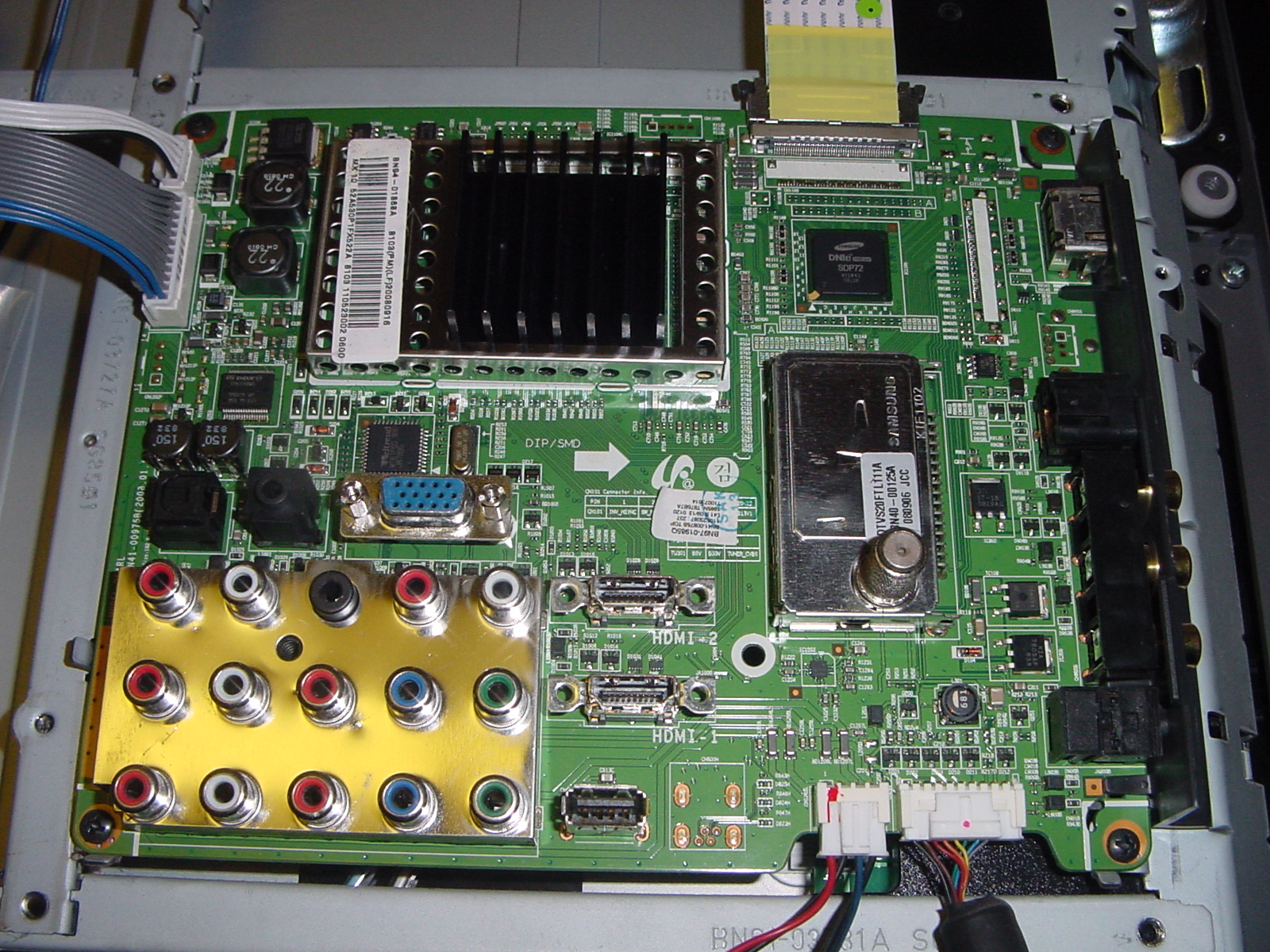

    I checked the T-CON, cleaned and re-seated the cables, heat/cool T-CON with no luck.

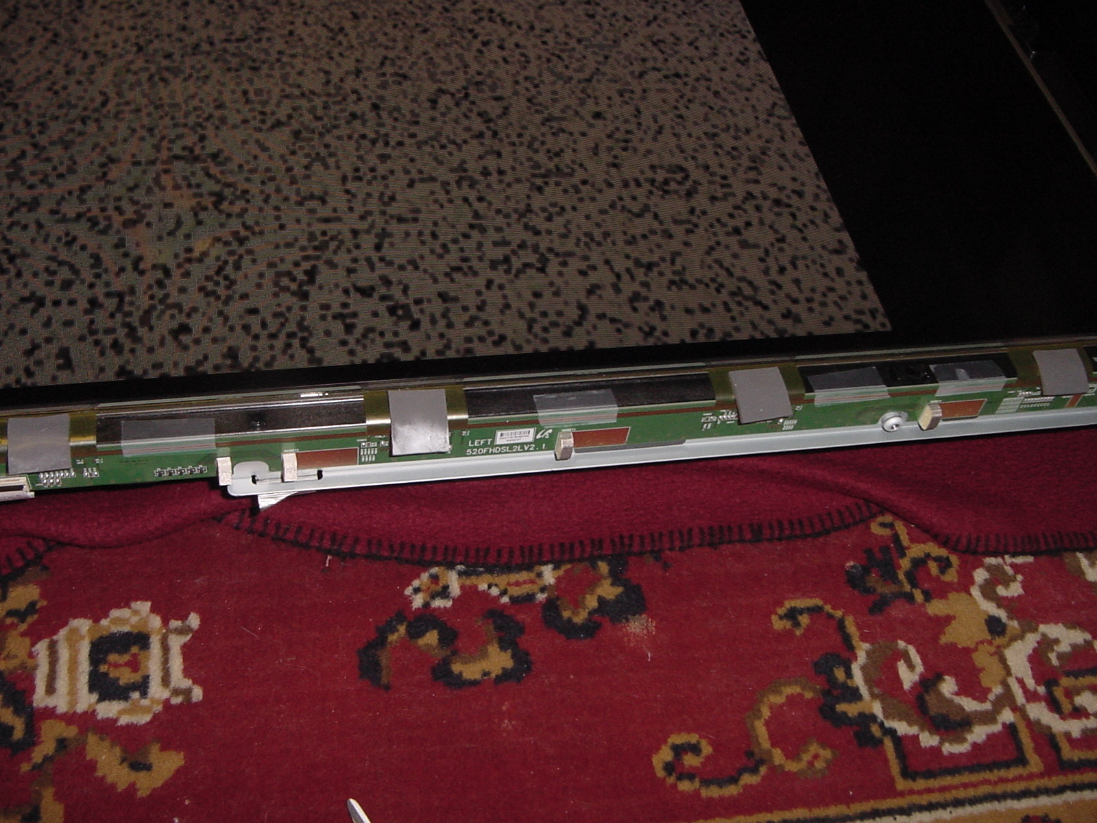

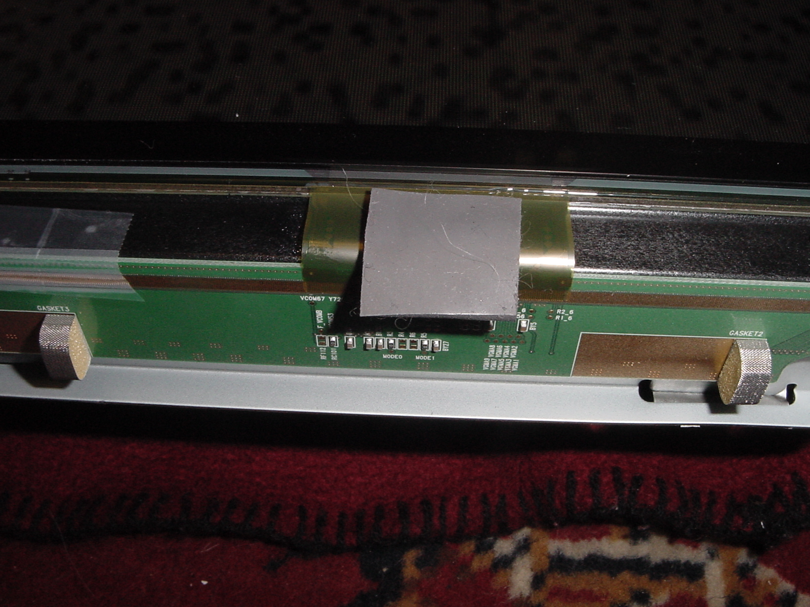

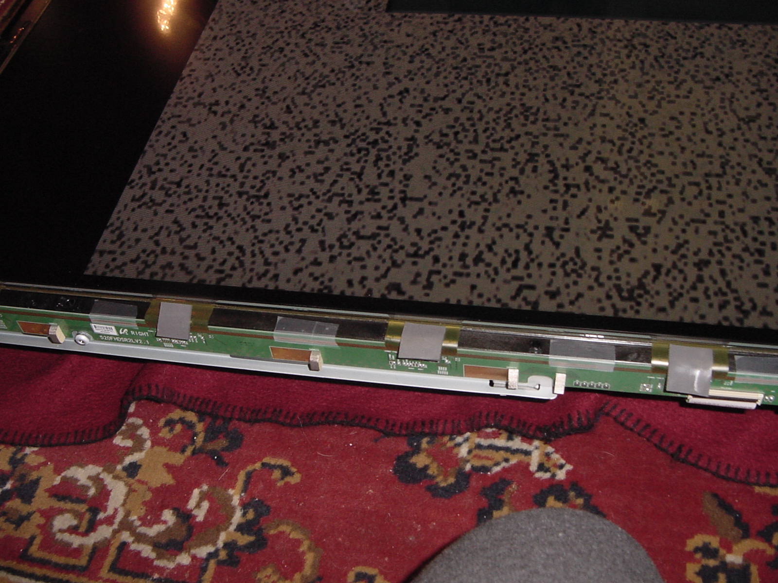

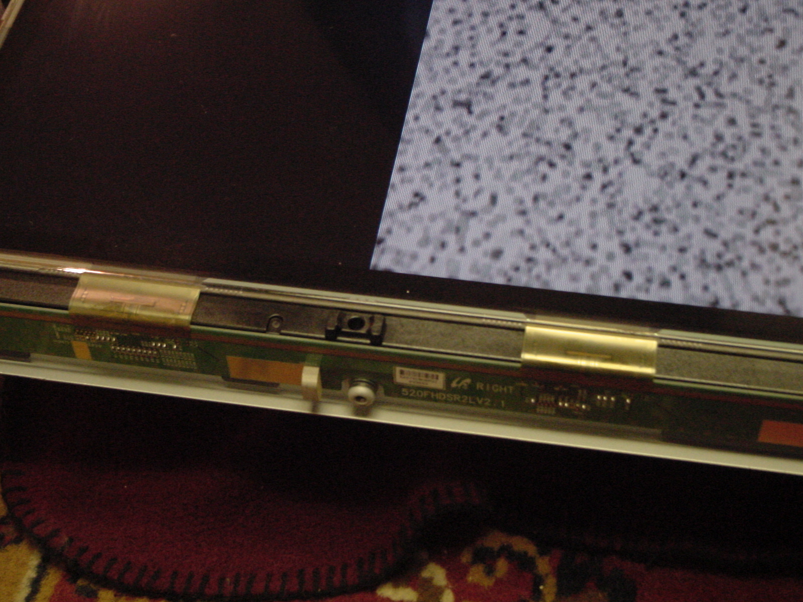

    Take the panel apart, the bonding on the right side are bad. I used the Silicone thermal interface pad (http://www.bergquistcompany.com/ther...ls/gap-pad.htm) on all the tabs and also on the T-CON processing IC so its heat is transferred to the metal shield better.

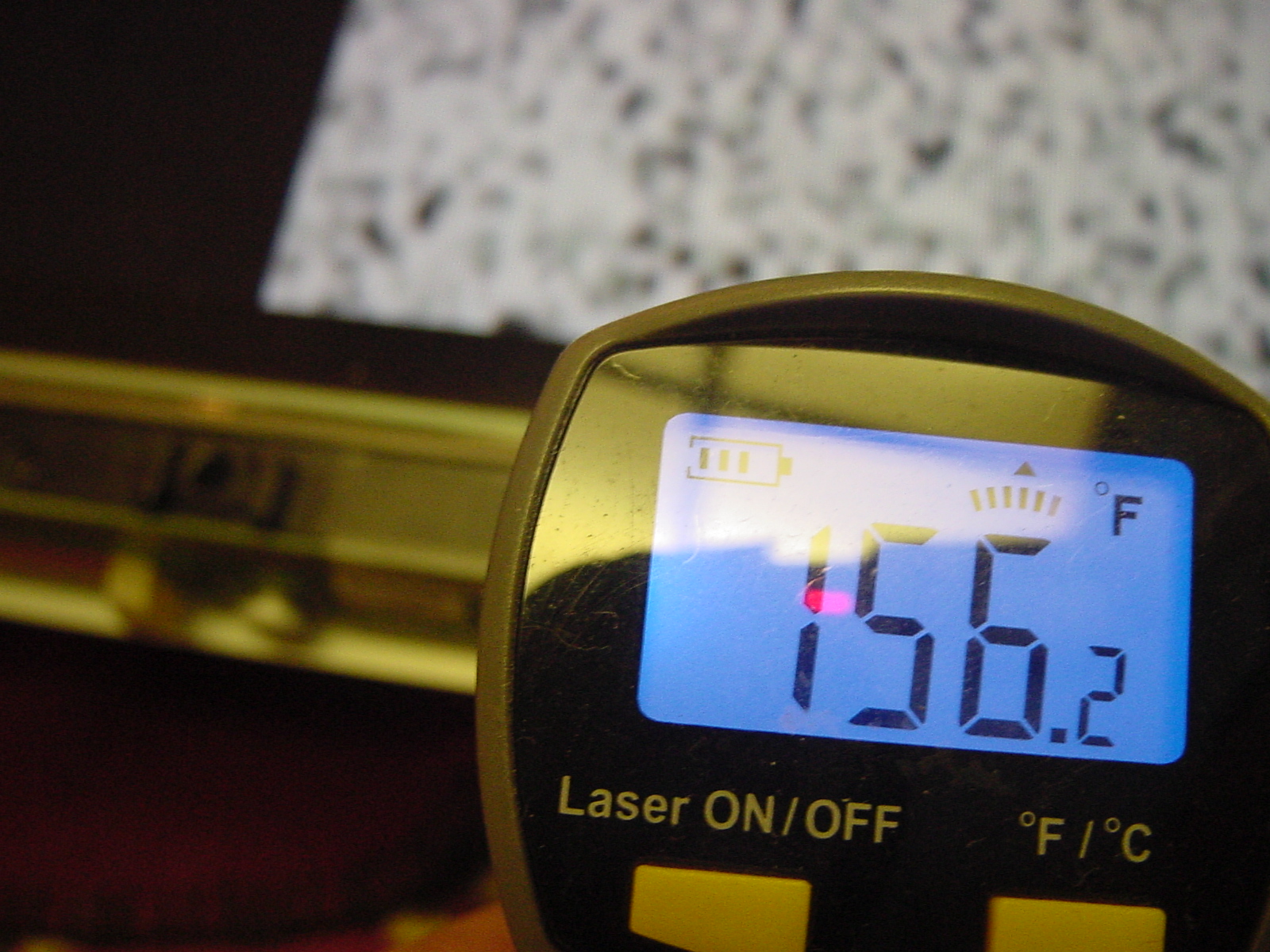

    Before I add the pads to the bonding tab, I checked the temperature of the IC on the flexible PCB, they were too hot too touch, the temp is about 155F (same as the 52" SONY I worked on last month).

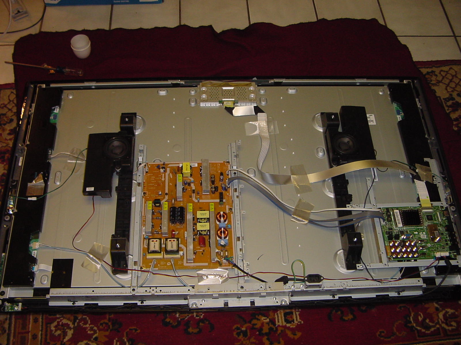

    Hardest part of the repair is to get the assembly off the front bezel by myself and removing the metal frame on the panel.

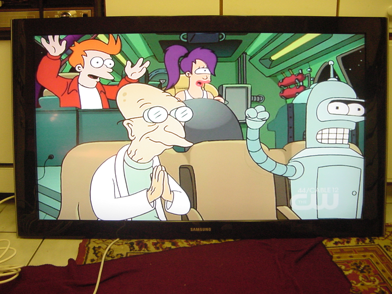

    It has been running for about 2 hours now, so far so good.

      I started at 10 PM and could not stop, too many screws and parts laying around and my cats want to play with the small parts laying on my kitchen floor. That IR gun with Laser is great, got them on sale for HF for $20. It is still running right now.

            have you done a tab bond repair like this before using the pads? i just wondered how long this type of repair may last for? i have read on some posts its only lasted a short while but i presume its its wrong types of pads there are using? i would just be worried if i done this repair for someone and charged them for it and it failed again after a short period of time.i will have a look to see if i can get the pads you use in the uk as i can pick sets up with tab bond issues cheap.thanks for your input cheers vince
              Re: Samsung LN52A530P1FXZA Tab bonding repair
              This is the second time (first one was 52" SONY, now I wish I use them on ALL (like I did on this SAMSUNG) the tabs instead of just on the two bad tabs)) I use this Silicone thermal interface pad (I use them in our products) for fixing tab bonding problem, they are made to transfer the heat from uneven surfaces and easily handle high temperature. They are not cheap. Sony uses them a lot for transfering heat between T-CON processing chip and the heat sink. It contour itself very well between two surfaces.
              I worry about using just rubber sponge or foam since that area gets very hot.
              I am using this one:
              http://www.digikey.com/product-detai...R165-ND/307787
              Spec:
              Time will tell of it will last or not, I believe this will be better than rubber bumper or sponge type material.
              Another reason I like using this pad because it has tacky surfaces so it stays in place while you putting the metal frame back in place.

                            Thinner is better, as long as the parts are in good mechanical contact.
                            And you definitely want to use electronics silpads instead of some other materials -- the silpads are designed to conduct heat, other materials might actually be counterproductive by insulating instead of conducting and/or not holding up to the heat.
                              It has to be thick enough and not too soft to put pressure on the tab bonding and the frame, if it is too thin and does not make contact with the frame then it wil not work. I know the Bergquist works in two TV so far, hate to experiment since it is not easy job to do.

                                Update, the TV is still runing great so far.

                                      Hey when you guys do the "Tab Bond Repair", do you go ahead and place the thermal pads on just the offending tab or all of them?
                                        I did just on two bad tabs on the SONY, but I did all the tabs on the SAMSUNG. I wish I did it on all the tabs on the SONY as well which I think the other bondings may fail later on also, it is a real big pain to do it.
