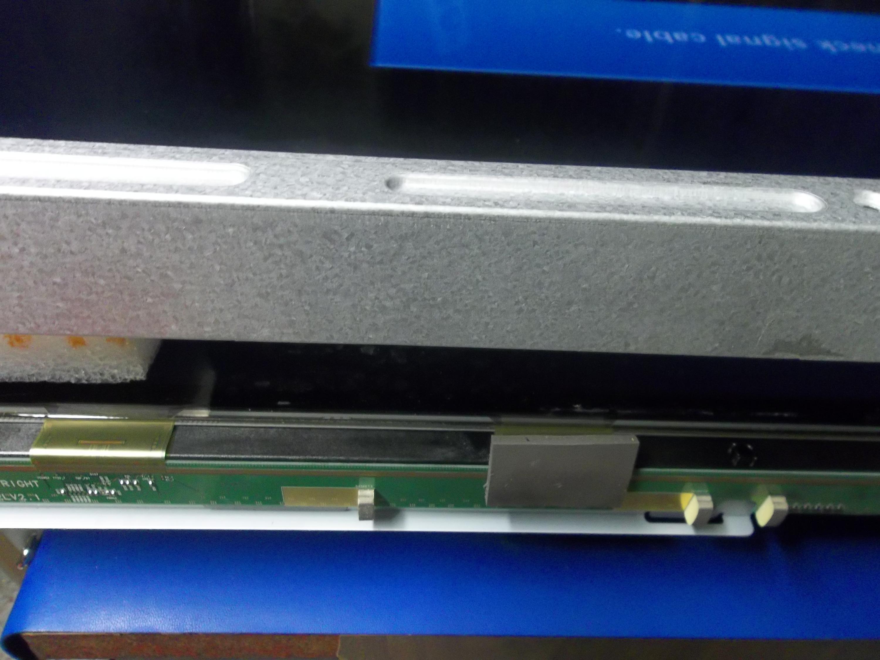

                                    Here is the one I just did today. Very similar but a different model number: LN52A540P2F
                                    It's been working for about an hour now.
                                    I'll also keep this one to see how long this repair lasts.
                                    I only used one thermal pad on the defective ribbon tab since I'm going to keep the tv and since it's also an experiment.
                                    The thermal pad I'm using I got from a scrap tv set. I've been collecting those for other reasons, so, it came handy.
                                    Thanks for the thread @budm.

                                      So you are applying pressure on the board side and not on the panel side?
                                      This is for better heat transfer or to apply pressure to the tab?
                                        #39
                                        Re: Samsung LN52A530P1FXZA Tab bonding repair
                                        The tab-to-panel bonding is usually good, it's the PCB-to-tab bonding or the IC-to-tab bonding that fails most often.
