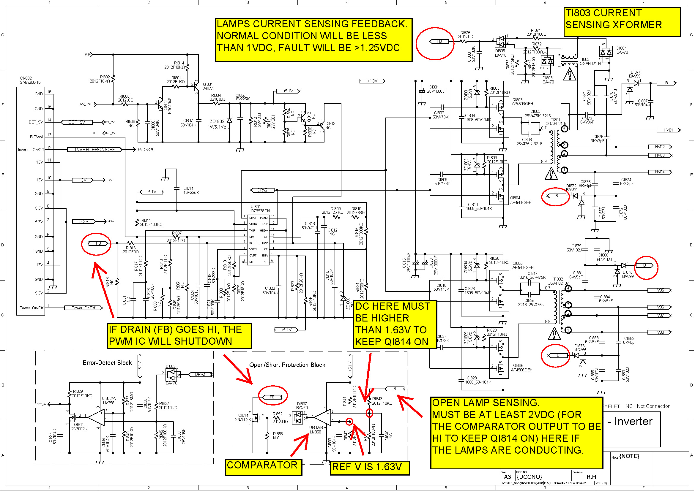

              #106
              Re: Samsung 32" ln32b360c5d
              OK, Please see PDF.
              You can defeat the shutdown circuit by grounding the FB pin then look at the screen real close to see if all the lamps are OK or if they all lit up.
              You can monitor the FB pin to see what you have as I explain how it works in the diagram attach.

                  #108
                  Originally posted by budm
                  OK, Please see PDF.
                  In your diagram you have both "B" and "FB" circled. And, there's more than one of them. Do they all reference the same point, but on different places on the board?
                  I've been trying to figure out where one of the FB points is. For example, I see that one comes off RI875. That seems to go to off and fork, toward QI814 and RI818.
                  I figured I'd check the voltage at pin six of UI802 (ref v should be 1.63V) but since it's on the bottom, how do I check it with it plugged into the lamps? Or, do I not need to have it plugged in to test that?
                    #109
                    'B' are all connected together, 'FB' are all connected together.
                    The easiest way is to locate the left side RI816 as shown in the diagram or the MOSFET QI814 Drain pin, just solder a small wire to it and bring it out so you can attach it to the meter.
                    You have to have the TV plugged in to test the voltages.

                      #110
                      Done. End of a piece of wire soldered to the left side of RI816.
                      Black lead on meter to ground, red lead to wire.
                      Reading -0.01 when power is first applied, 0.00 after the lamp shuts off.
                      If I read what you wanted me to do, above, correctly, I should take the wire and attach it to ground, correct? It didn't do anything new.

                            #113
                            OK, the FB for the Isense shorted to ground and the lamps still do not stay on, at least that eliminate of possible cause of the lamps shutdown on the Isense line. Need to look somewhere else next.
