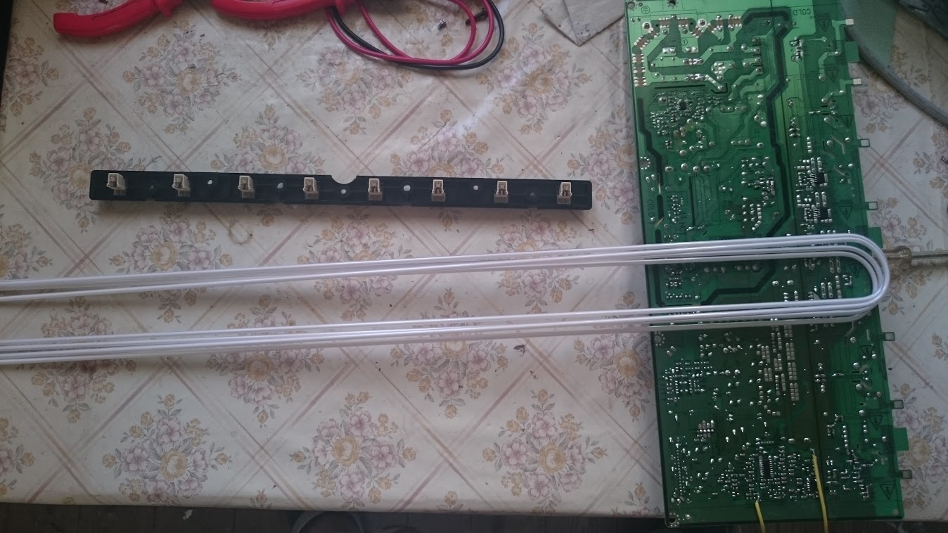

    As I said, the lamps light up for a second and during that period I don't see anything suspicious. But I can't trick the driver to keep them on. FB line stays low all the time, and B line drops from 3,1-3,3 V to 0 when the lamps shut down.

        Re: Samsung 32" ln32b360c5d
        So the PFC Boosted Voltage stays close to 400VDC. We also need to see the pictures of your BN44-00289A since the pictures I have for the 00289A has D805.
        did you also check the resistance of the high Voltage windings of the inverter transformers?
        Is the PWM IC UI801 OZ9938GN?

          Sorry for the delay.
          The pics are on the Drive, here: https://drive.google.com/open?id=0B_...DFLSy14MEh6aG8
          There's no DP805 on the board. It's not present in your 00289A schematics posted a few pages back neither.
          I'll check the resistance and get back with readings.

            Update:
            I measured the resistance across the transformer outputs, 3 read ~1.04 kOhm, one was 2.05 kOhm.
            In addition to that, I played with INV_ONOFF and DET_5V lines again, and suddenly, all lytics started "screaming", transfering the oscilations to the transformers as well, and backlight turned on at about 10%. It was unstable and flickering, and changing "Backlight" setting in the menu made it go crazy, randomly going from 0 to 20%.
            5 minutes of rage later, this was the result:
            I'll get the LED stripe and hack it to power on via INV_ONOFF line and get back with the results.
            If anyone needs 4 working CCFL tubes, just pay the shipping and one beer and they're yours.

              I successfully replaced CCFLs with LED strip and disabled the entire CCFL HV circuit. I made a new thread with description.
