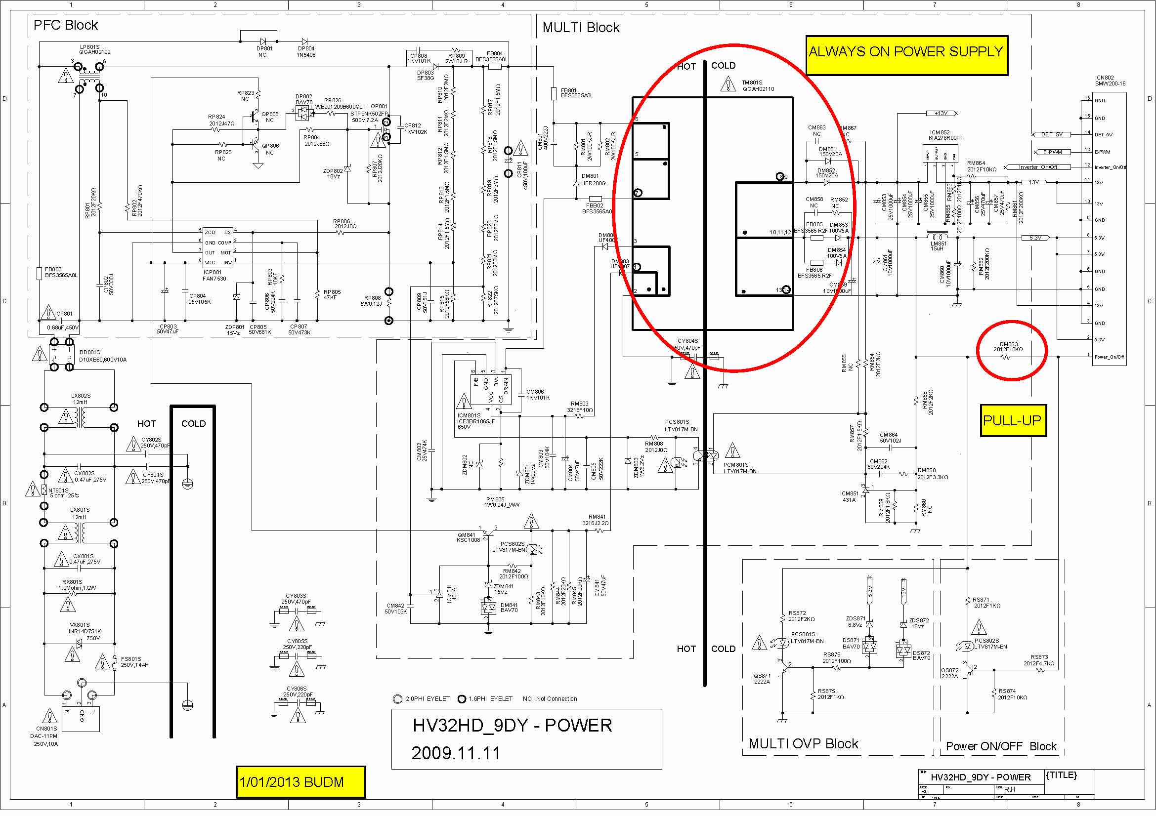

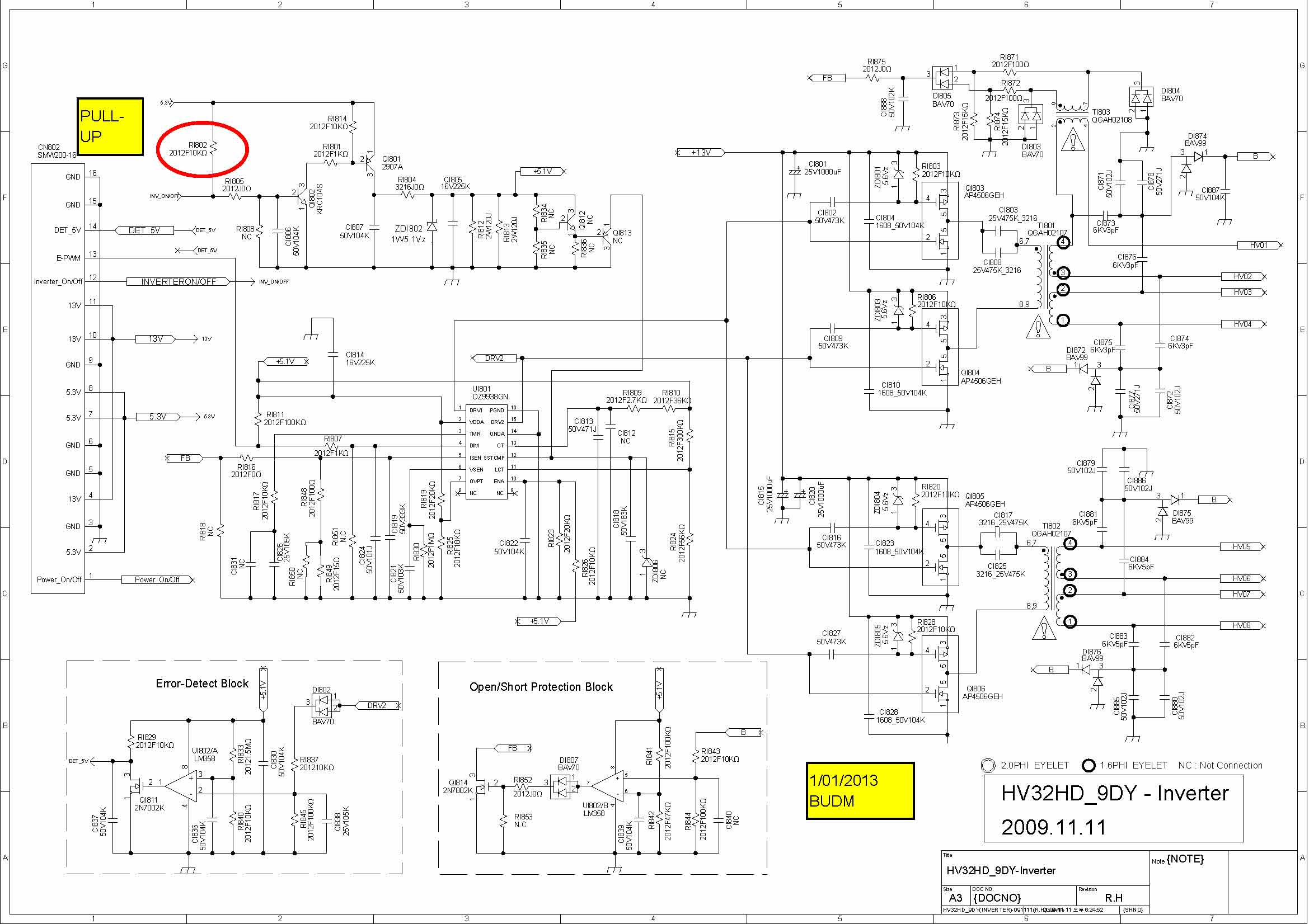

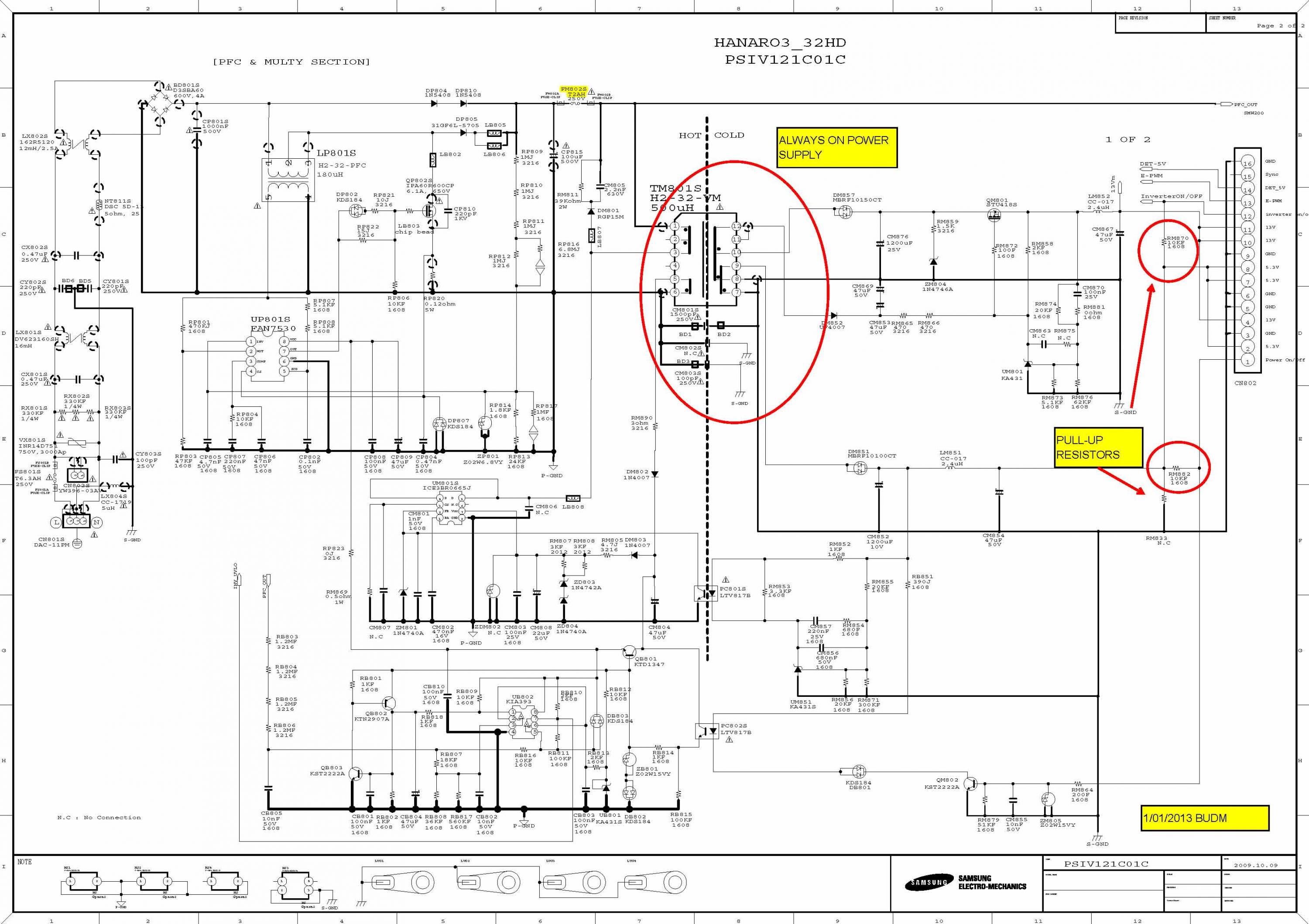

              By the way, this BN44-00289 power supply-inverter board has two pull-up resistors on the board itself, one for the BL_ON (INVERTER ON), and one for the PS_ON signals line.
              All you have to do is to disconnect CN802 that goes to the main board (this will force the PS_ON and BL_ON line to go HI, if the board is OK, the backlights should turns on when you plug the TV into the AC outlet.
              See page 1 of the SCH.

                          Here is the diagram

                              That is the wrong schematic, I think. This model is the BN44-00289A, not 289B. The 289B uses a 400V inverter, the 289A works from 13V.

                                That is how you verify if the power supply-inverter board is good or bad, you do not need the main board for the backlights to be on, if it does not stay on with the CN802 disconnect, then the problem is on the power supply-inverter board.
                                  #76
                                  Re: Samsung 32" ln32b360c5d
                                  If you remove the connector to the main board, then check the BL_ON and ps_on pins on the power supply board, IF it does not have pull-up resistor, the voltage readings on those two pins will be 0V.
                                  This SAMSUNG form factor of this type board uses built-in pull-up resistors. You can see them on the 289A on page 1 for the PS_ON.
                                  Page 2 for the INV ON/OFF.
