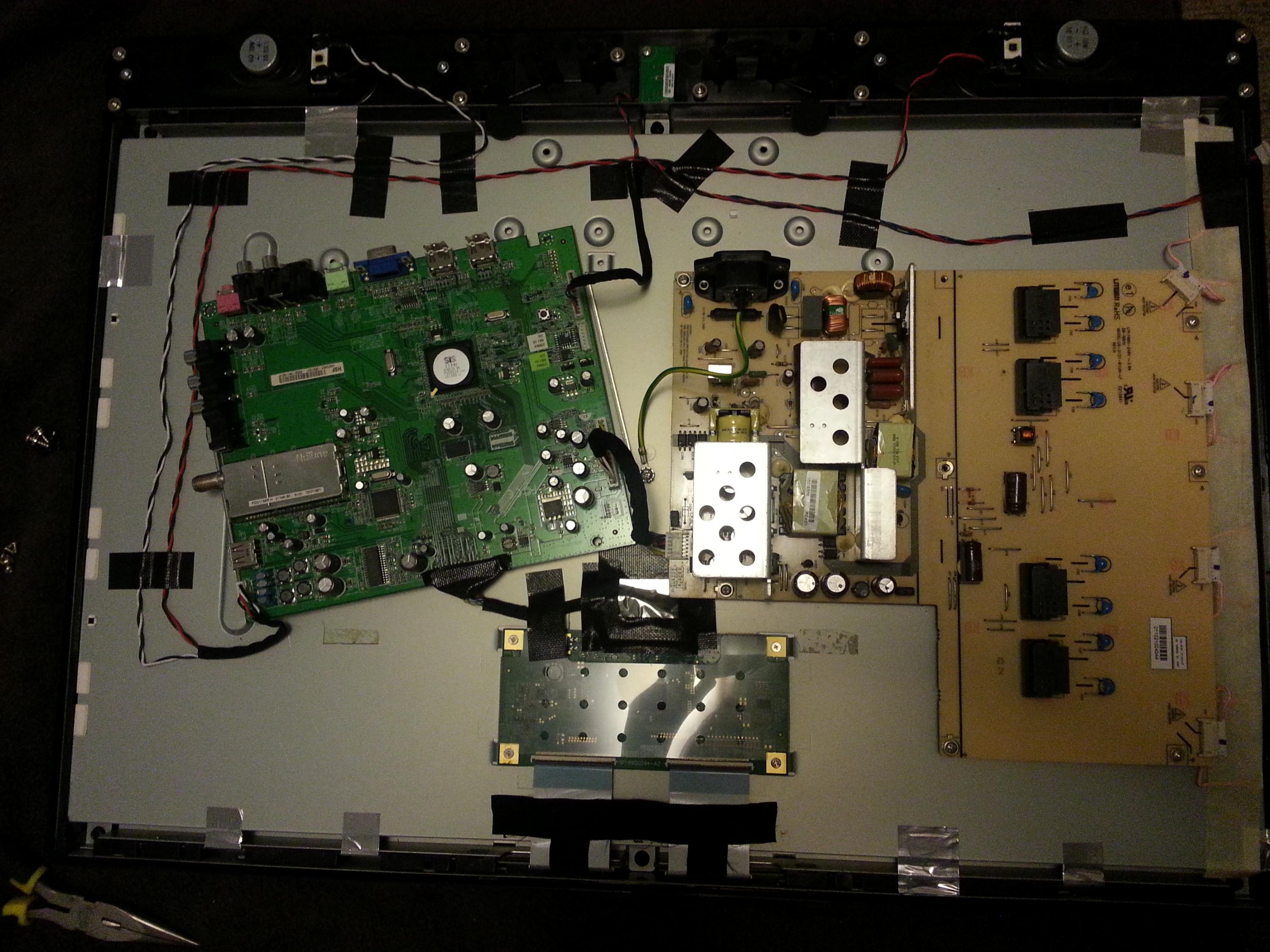

    brothers, what you see in the picture is a dismantled hanspree hsg1075 28inch lcd monitor. As you can see I have removed all covers on the back. This monitor only displays white when powered on, sound works perfectly fine. No splash logo displays, just bright white. Any direction on which board is bad and needs replaced? Somewhat proficient PC tech here (not TV). No apparent damage to any boards, no loose connections.
  • Pentium4
    CapXon Be Gone
    • Sep 2011
    • 3741
    Re: Hanspree HSG1075
    It could have just been a loose ribbon cable going from the main board to the panel. Did you try re-seating it to see if it gets a picture?

        Ok, I removed the black tape that was covering the ribbon cable connectors between the large green board with video inputs and the small green board (tcon I believe), unfortunately after re-connecting the ribbon cable the white screen still occurs.

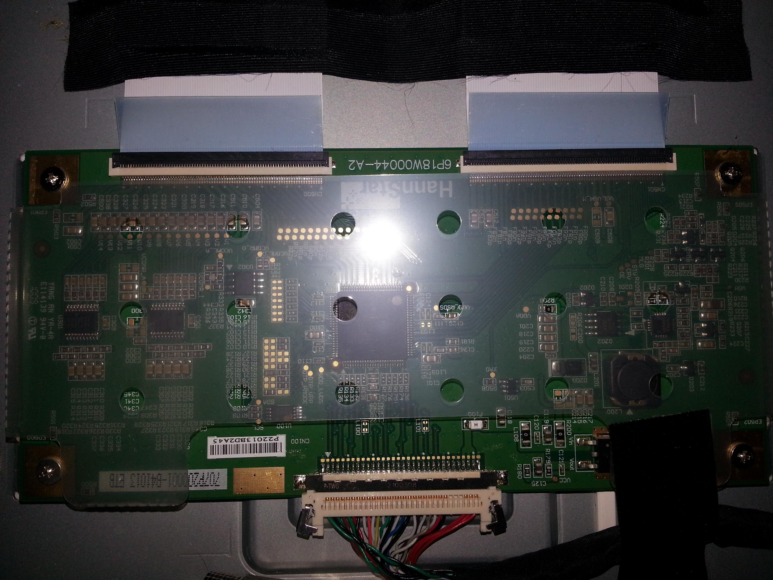

          At the bottom of the [picture there is a metal plate over the Tcon.
          Can you post a really clear picture of the Tcon board.
          • rhodesjo
            • Dec 2012
            • 36
            i hope this is what you mean. There is a thin plastic shield over the board that I didn't tear off, I can, if you can't see the board clear enough.
              Yes, that is the T-con board.
              There is a device marked "M" and nearby "F100". This is the fuse. Measure the voltage on both ends of the device, relative to the chassis.

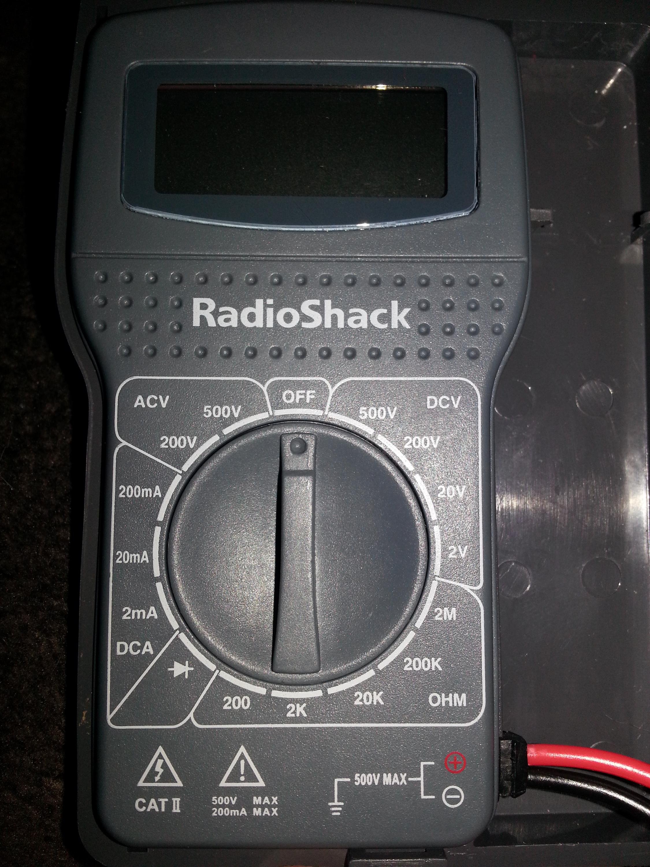

                      So, one final noob question, on this radioshack special voltage meter, (see attached) which setting is appropriate for this very tiny fuse? I am pretty cautious, maybe overly so with electricity I don't understand lol
                        DCV 20V.
                        You are measuring the low voltage side. Shocks are not possible at the low voltages the t-con and video processor uses. The highest voltage on the t-con is 30V DC. The SELV level (safety extra-low voltage) specification is 60V DC. I have a 35V DC power supply. I can touch the output (and regularly do) with sweaty or dry hands and am not electrocuted yet.

                          with the negative tester on the metal chassis, and touching the red tester to each side of the fuse marked F100 (M) I saw no change on my voltage meter. 0.00 each and every time
                            OK, just to be sure, can you find a fresh 1.5V battery and test that? It should show around 1.55~1.6V if good. Just to check if meter is OK.

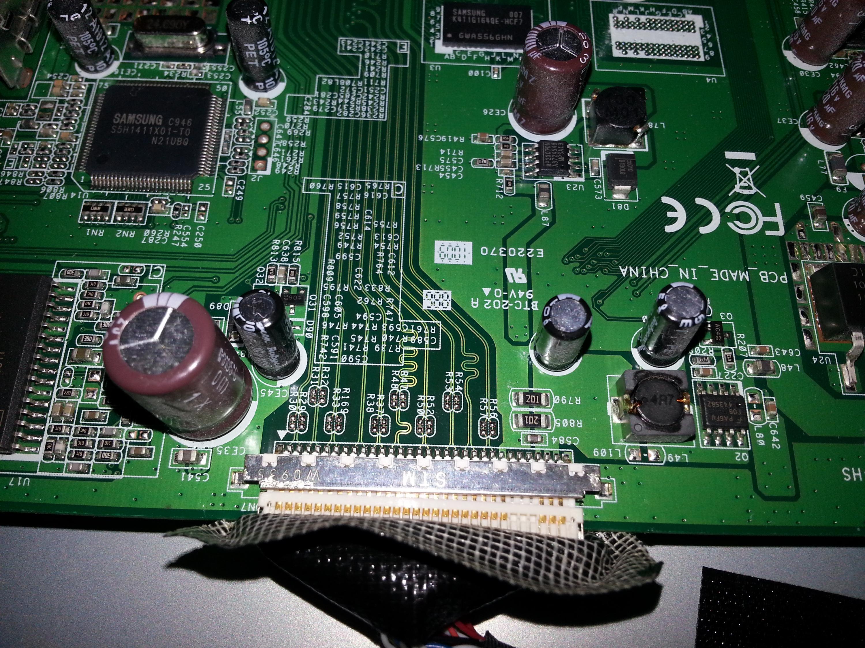

                                  Can we have a closer image around the connector which goes to the T-con but on the main board side?

                                    here is the tcon connection on the "big board" side

                                      In the picture it looks like the connector isn't plugged in all the way, that just happened when I pulled the tape, I pushed it back in and retested just to be sure. Still 0.00 mainly on the fuse
                                        In this picture,
                                        https://www.badcaps.net/forum/attach...0&d=1356560428
                                        Do you see the grey device marked 4R7?
                                        Can you test the output voltage here relative to the chassis of the TV?
                                        Also, let's make sure the chassis test is good; I just have a feeling. Set your meter to 200 ohms. Probe from the metal shield of the connector on the main board to the chassis of the TV -- you should see under 3 ohms.
