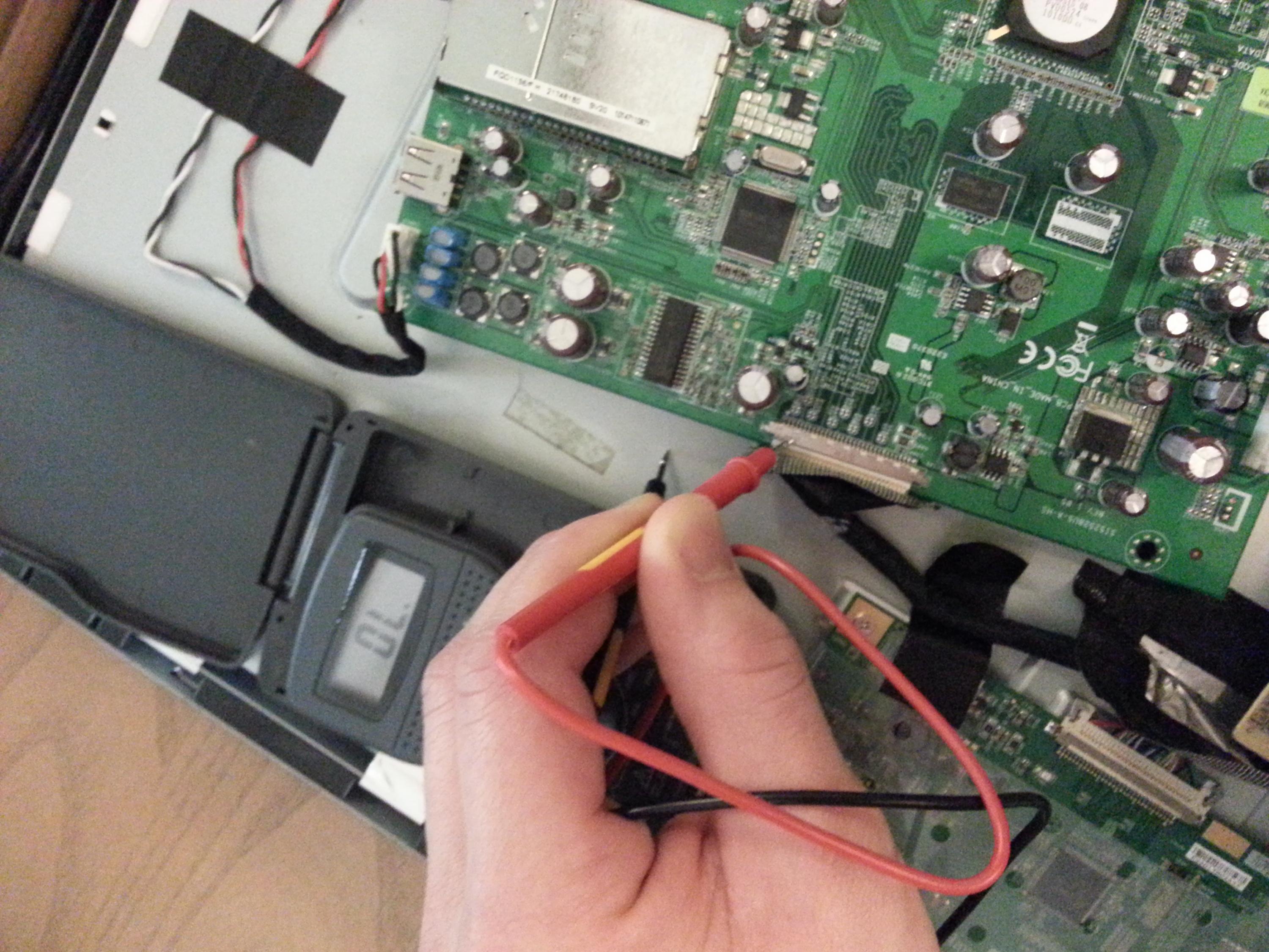

              Re: Hanspree HSG1075
              I did my best to isolate the board from the chassis, with the exception of one screw "grounding the board." In this picture, I am performing the ohm test the way I understood it to be and I was getting 0.00 on my meter.
                Haha - I read Toms post where he said for you to use 200 ohms but it didnt sink in that you used 200,000ohms I thought therefore you were getting 70 ohms so yes it is ok at 0.7.
                  oops, I didnt see the plain 200 there, you guys probably think im a lost cause here lol so basically are we trying to determine at what point power is lost before the tcon board?

                    #29
                    Yes

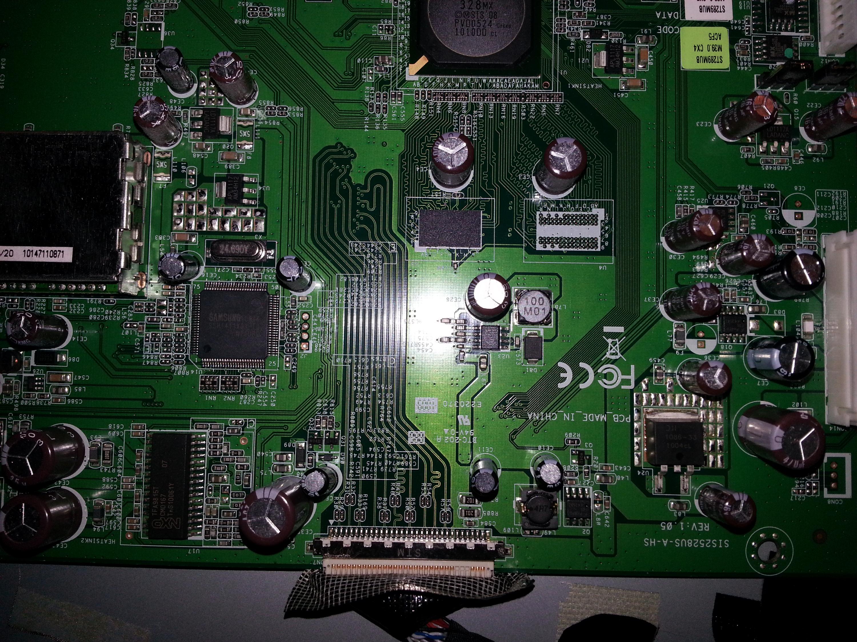

                    On the pic of the connector on the main board on the right hand edge about halfway up is a board mark F9 - is there a fuse there?
                    Can you do a clear straight on picture of the main board it will help trying to trace why there is no voltage on the connector There looks to be mosfet and voltage regulator
                    but havent bottomed out what they are - Badcaps.net keeps vanishing and resetting dns only lasts a few minutes.

                      #30
                      Try using the "200" ohm setting, not "200K".

                        #31
                        Here is the shot of the main board/connector
                        -the test with 200 instead of 200k gave me basically the same result - 0.00, keep in mind that I can't put the board back in its mounts or I wouldn't be able to reach the areas for the test. it sits in upside down. Hopefully I've isolated it for the tests properly.
                        Does a test of 0.00 instead of 3ohm mean that I am not testing it correctly?

                          #32
                          Id have thought it was ok - but Tom will know better.
                          In the meantime that is some weird dual purpose board Can you test F9 or
                          L77 whatever it is ( Inductor?) as a fuse - power off meter on ohms 200
                          and also further across to the right f8 which is a white fuse.
                          As we are on F8/9 perhaps check around the board and check all the F numbered components as fuses.
                          Ill leave that with you as Im off to bed.

                                  #36
                                  OK, zero ohm is OK.
                                  "4R7", or L49, what is the voltage on the end closer to the connector?

                                    #37
                                    4R7 = .25 on the connector side. I had the power ON and the meter set to 20V DCV
                                      #38
                                      OK, can you check the voltage across C642, it's in the same area.

                                        #39
                                        one side of C642 is 12.01-12.15, the other side is 0.00
                                          #40
                                          K, so power is getting to that area, but the switch (MOSFET Q2) isn't letting it through, either because it is failed or because it is not being told to turn it on.
                                          On Q2, there is a small dedent. This marks pin #1. Counting from right to left, you will reach the fourth pin. This is the gate. If it is turned off, it will measure around 12V. If it is turned on, it will measure at least 3V less than 12V, quite possibly 0V.
