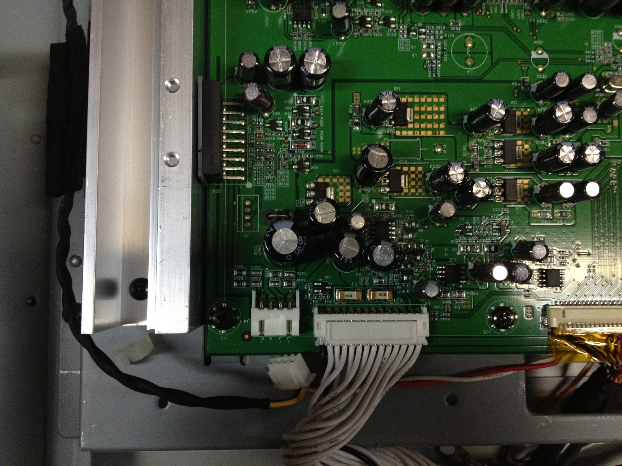

    Just got a Vizio GV42L that has a bad sound problem. When I plug in hdmi, all I hear from the speakers is loud static and noise. I can barely hear the sound coming from a movie because its covered with static.
    Opened up the TV and checked the connection to the speakers. Near it was some capacitors but they checked out with low esr and within specs. I tried connecting my own speakers that I salvaged from another TV but I get the same static noise coming from it, so the connections and speakers can be ruled out.
    So what else can cause this bad static sound from the speaker?

    Photo of where the speaker connection is on the main board.

      Re: 42" Vizio GV42L Speaker Static Noise Overlay Problem
      In the pic, up and to the left on the heatsink, appears to be a chipamp chip. Get the markings off of it to find the datasheet, the pinout, and begin probing with a multimeter to determine if the positive power rail (and negative if/since it appears to be a split rail design, due to it looking like the speaker output doesn't pass through output coupling capacitor(s)) is within the expected range.
      Also probe for audio signal (AC) voltage fluctuations on the L & R audio inputs, as well whether there is any significant (beyond a few mV) DC voltage present, which there shouldn't be. Keep tracing back the circuit until you find a reading that looks wrong, when you come to the next IC, repeat the above pulling the datasheet and taking readings. If the circuit is difficult to follow, look around as one or more of the SMD SOIC8 chips pictured may be opamp(s) handling the audio signal.

            Are you talking about the component on the heatsink?
            The label on it is: TDA8946AJ

                I found the data sheet for that component on the heatsink, (TDA8946AJ)
                I'm measuring 5.96V on the output of the main board where the speakers are plugged in.
                The only thing I see on the datasheet is Vcc has a range: 4.5V - 18V
                So then what are the specs of all the other pins? I have no idea how to read this datasheet..
                I'll probably just take a guess and replace TDA8946AJ. Does anyone know where I can get this part? Theres one on ebay but I rather not wait one month for shipping from china... =/

                    If your measurement of 5.96V is DC, that would explain the blown fuse. There should be under 1V DC, preferably only a few mV (approaching 0mV). Is it 5.96VDC on both the left channel to ground, AND on the right channel to ground?
                    Whichever channel it is, you'll want to measure the signal input on that channel, it'll be either pin 6 (IN1+) or pin 12 (IN2+), might as well measure both. Neither should have more than a few mV of DC voltage. IF either has more than a few mV, then the problem is happening before that power amp chip and it is only amplifying the problem.
                    If neither has more than a few (dozen) mV, suspect the amp chip but measure the power rail voltage at pins 3 (Vcc1) and 16 (Vcc2) as it should be within the spec sheet range of 4.5V to 18VDC, probably this product is set up to use 12VDC or more.
                    I'm not sure what chipamp ICs have a close pinout to the TDA8946, but besides the locations of the pins (the problem/issue), otherwise there should be some equivalent functionality 2 channel / 15W into 8 ohms chips that you could substitute but you'd need to air wire from the chip leads to the PCB, and it would probably be a good ideal to put a 0.1uF capacitor between the Vcc pins and Gnd at the chip. Given the choice I'd rather wait for a month to get the right chip from China, hopefully it's genuine instead of fake.
                      The IC uses bridge direct couple output setup, 2 amp per channel, so the output pin 1 & 4, 14 & 17 will be sitting at 1/2 VCC. If you measure at the both pins of the each speaker connector, it should be 0V, but each output pin and ground should be 1/2 VCC.

                        I'm getting bad sound on all input. I tried to even hook on the DVI to my laptop and test the aux input but every time it reads the DVI signal the TV actually just shuts of...
                          This is one application where tracing with an oscilloscope is almost essential, but you may be able to make do by setting the output volume low and tracing the signal through with an audio jack and computer speakers.
                          One question, is noise level dependent on the volume?
                            But do also you get bad sound at the RCA AUDIO line out? if you also get bad sound at the Audio line out, that will eliminate the TDA IC problem. We need to find out if it is the pre-amp sound processor problem or the audio output problem.
