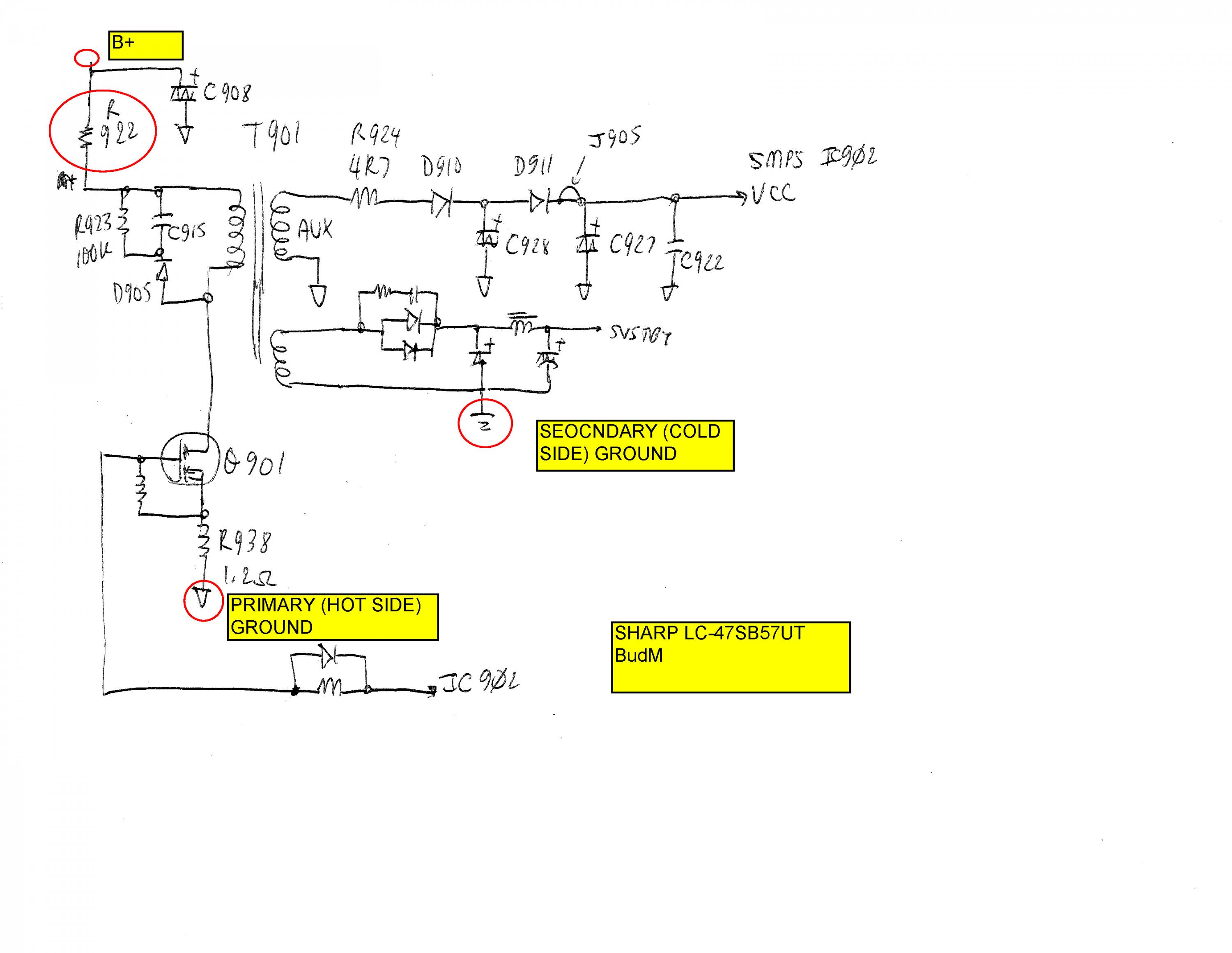

          Check fusible resistor R922, R938, R924 to see if they are open.
            #45
            Re: Sharp LC-47SB57UT will not power on
            None of those three resistors are open.

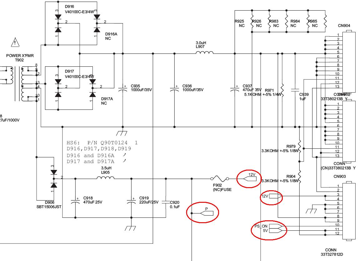

                                    I'm not sure what fluctuating rails are, but no other pins fluctuate. If I knew what was driven from the PSU to the main and from the main to the PSU, I could probably temporarily retrofit a known good PSU with the same outputs/inputs (if one exists and happens to be in my basement) to the chassis, just to confirm/disprove a PSU fault.
                                    I've been looking though the service manual, trying to find the answer but I'm not experienced enough to be able to spot it right away. Any chance one of you could browse these?
                                      #58
                                      In the attached picture called "flags", what do the circled flags represent?
                                        #59
                                        Nets... they indicate connections to each other (with the same name) done to make the schematic a little clearer.
                                          #60
                                          That's what I figured. Thanks
