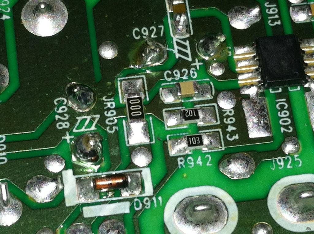

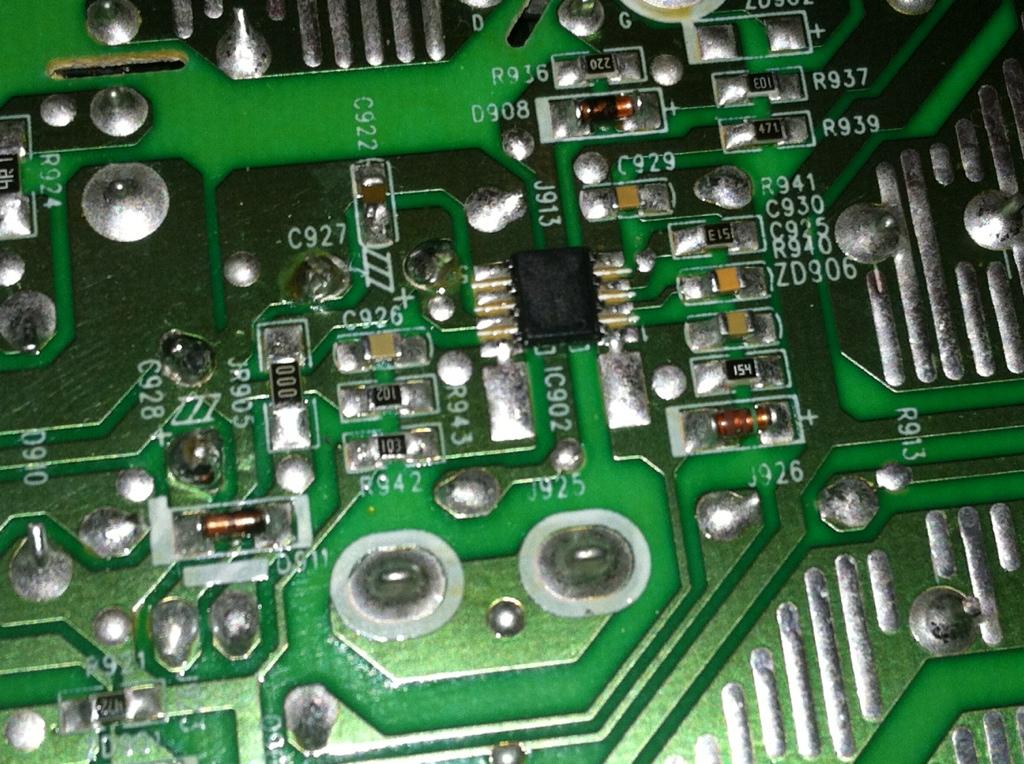

                #67
                Re: Sharp LC-47SB57UT will not power on
                I'm not really sure which resistor is the one you are referencing. The only one that measures less than 100 ohms is JR905 (if that is a resistor) which measures 00.8 ohms when the DMM is set to 200 ohms.
                *Edit* C927 and C928 are the caps I replaced, if you can't tell.
                  #68
                  That should measure zero, it is good.
                  How is D910?
                  I am fairly sure it is the startup section or a shorted output.

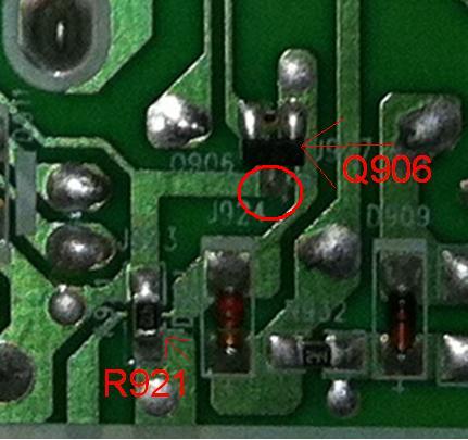

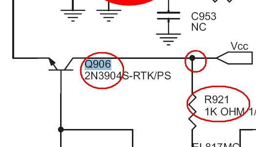

                                  What DC voltage you get at the Collector (VCC) of Q906? This VCC is from what you read earlier in post 63.
                                  • johnboy1313
                                    • Nov 2012
                                    • 1959
                                    #77
                                    I believe I have identified the collector. According to the schematic, R921 and the collector of Q906 are connected, right?
                                      #78
                                      yes.
                                      • johnboy1313
                                        • Nov 2012
                                        • 1959
                                        #79
                                        0.0v at the collector
                                          #80
                                          Measured relative to negative lead of big cap?
