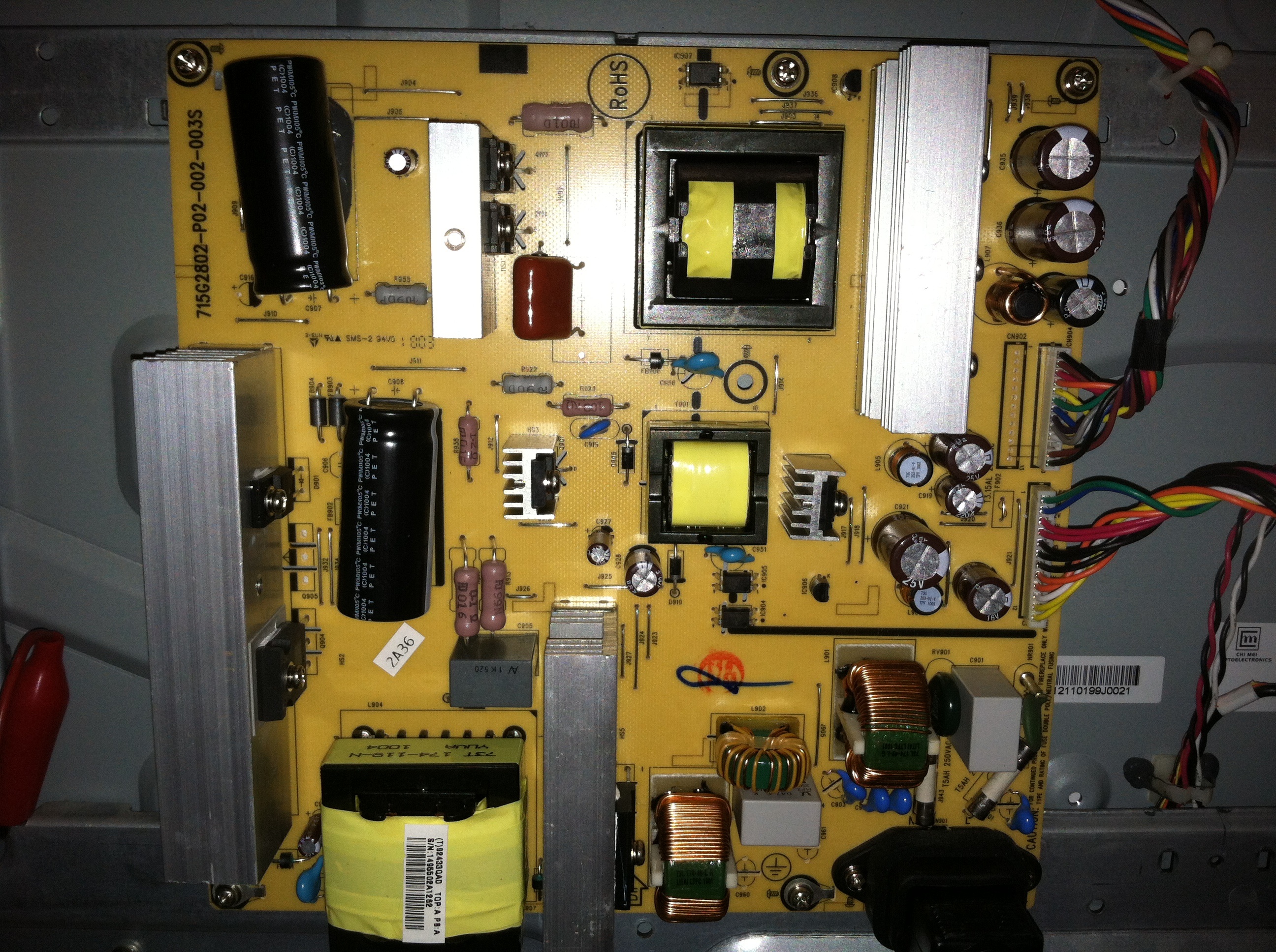

    OK, replace the startup capacitor for 5VSB.
    You may use a generic radioshack capacitor (low esr is not crucial here), though a better manufacturer would last longer.

      Here's where my ignorance comes into play. Which one is the startup cap?
        Re: Sharp LC-47SB57UT will not power on
        It's going to be one of those smaller caps on the primary side.
        A picture from the bottom would enable us to determine which for sure.

            Could you kindly highlight the locations of those caps on the bottom.
            Also, near those caps is an 8-pin SMD IC, what is the part # of this?

              Startup could be the one between the transformer and the heatsink just above the blue cap . There is another 47uf cap straight up from it (in your pic) just below J905 mark that one as well and say what voltage /uf they are
              Hint: It is easier to follow if the fronts and backs are posted in the same orientation that is keep the top at the top on both.

                Startup could be the onebetween the transformer and the heatsink just above the blue cap Mark that one on the back first. There is another 47uf cap straight up from it

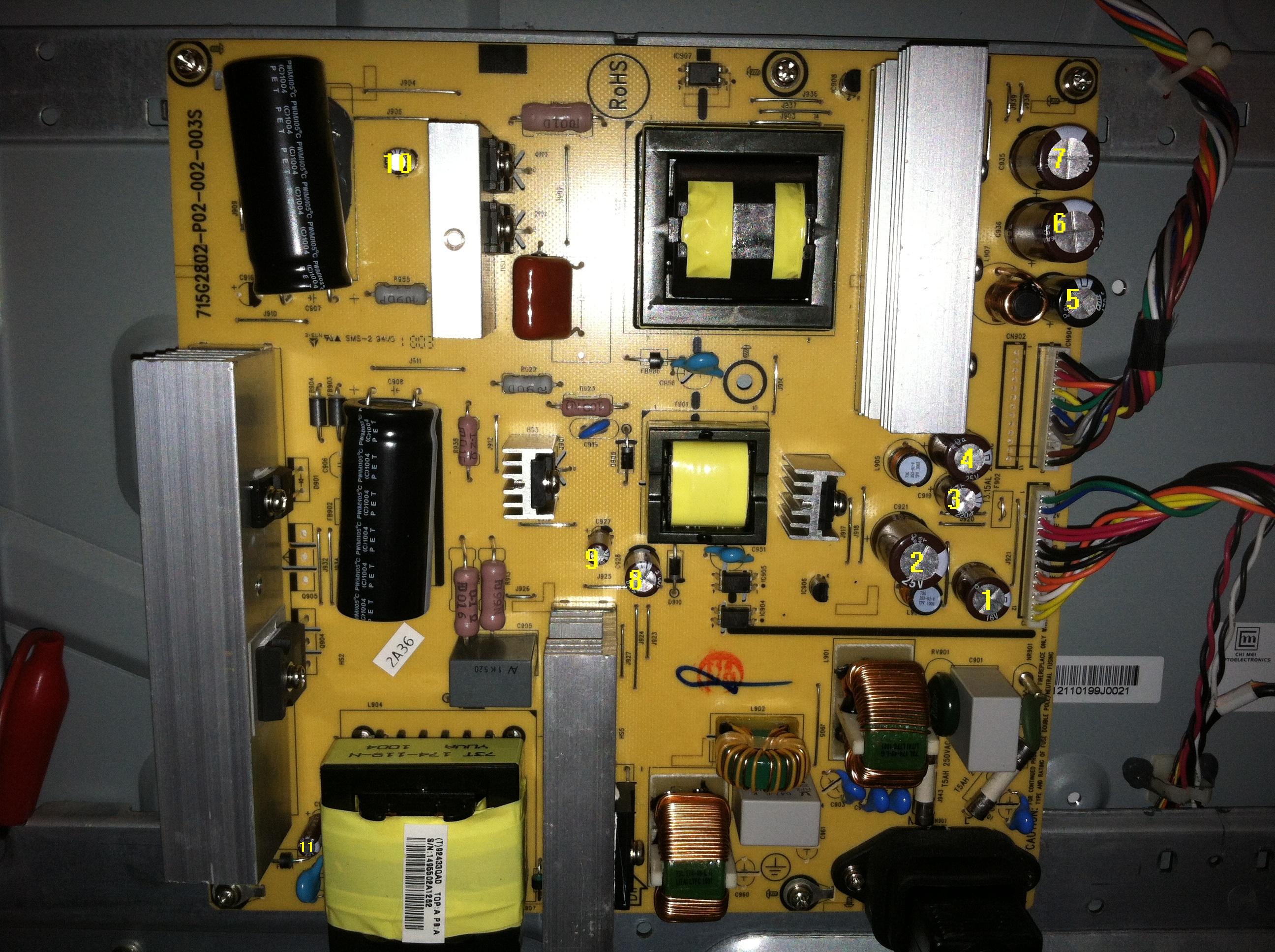

                  Alright, in the pic below,
                  Cap
                  1 = 470uf 16V C923 on back of board
                  2 = 1000uf 25V C921
                  3 = 220uf 25V C919
                  4 = 470uf 25V C918
                  5 = 470uf 35V C937
                  6 = 1000uf 35V C936
                  7 = 1000uf 35V CC935
                  8 = 100uf 50V C928
                  9 = 10uf 50V C927
                  10 = 47uf 25V C946
                  11 = 47uf 25V C909
                    #29
                    Great, but we need the numbers on the bottom to tell for sure which is the startup cap.

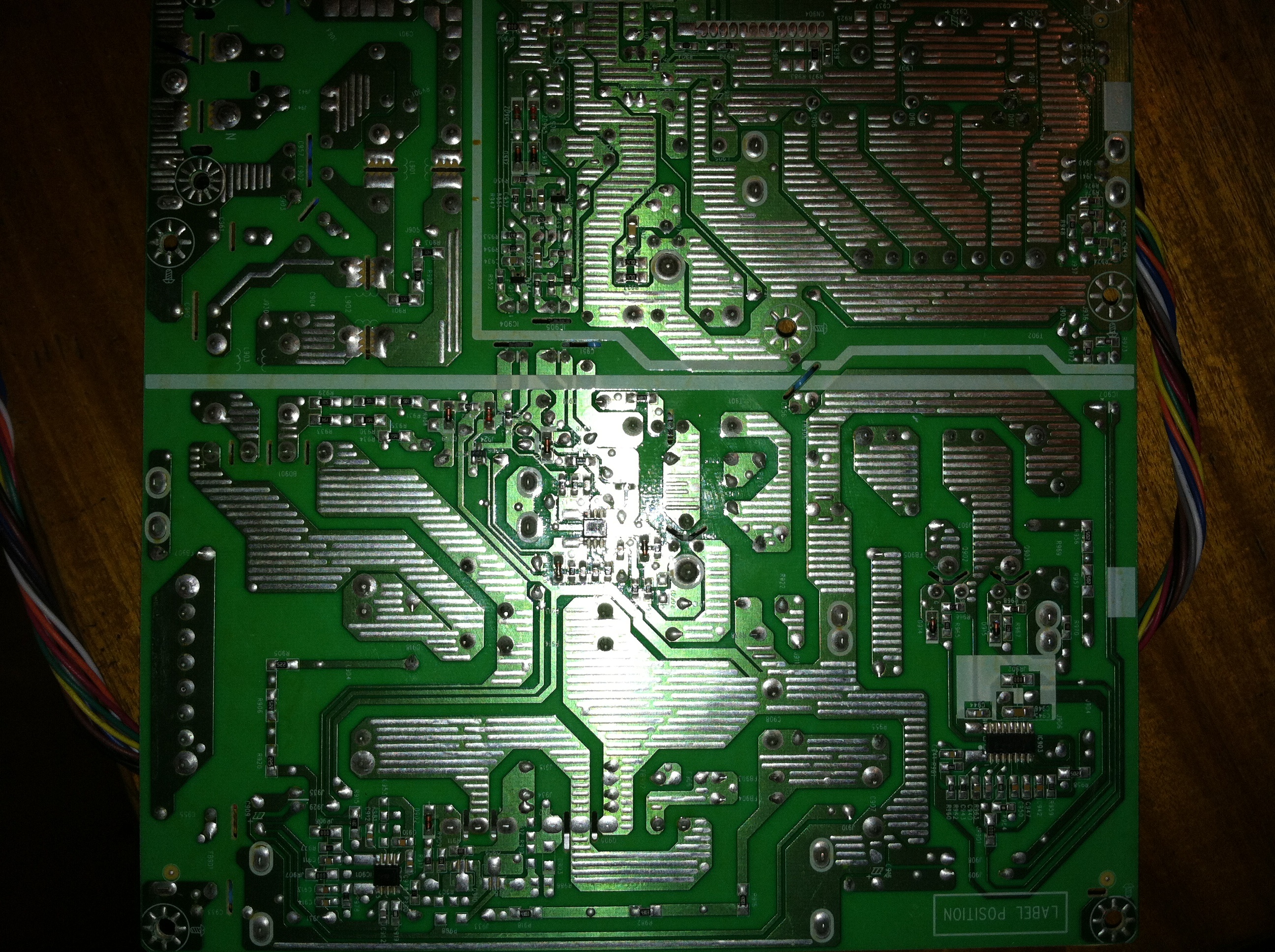

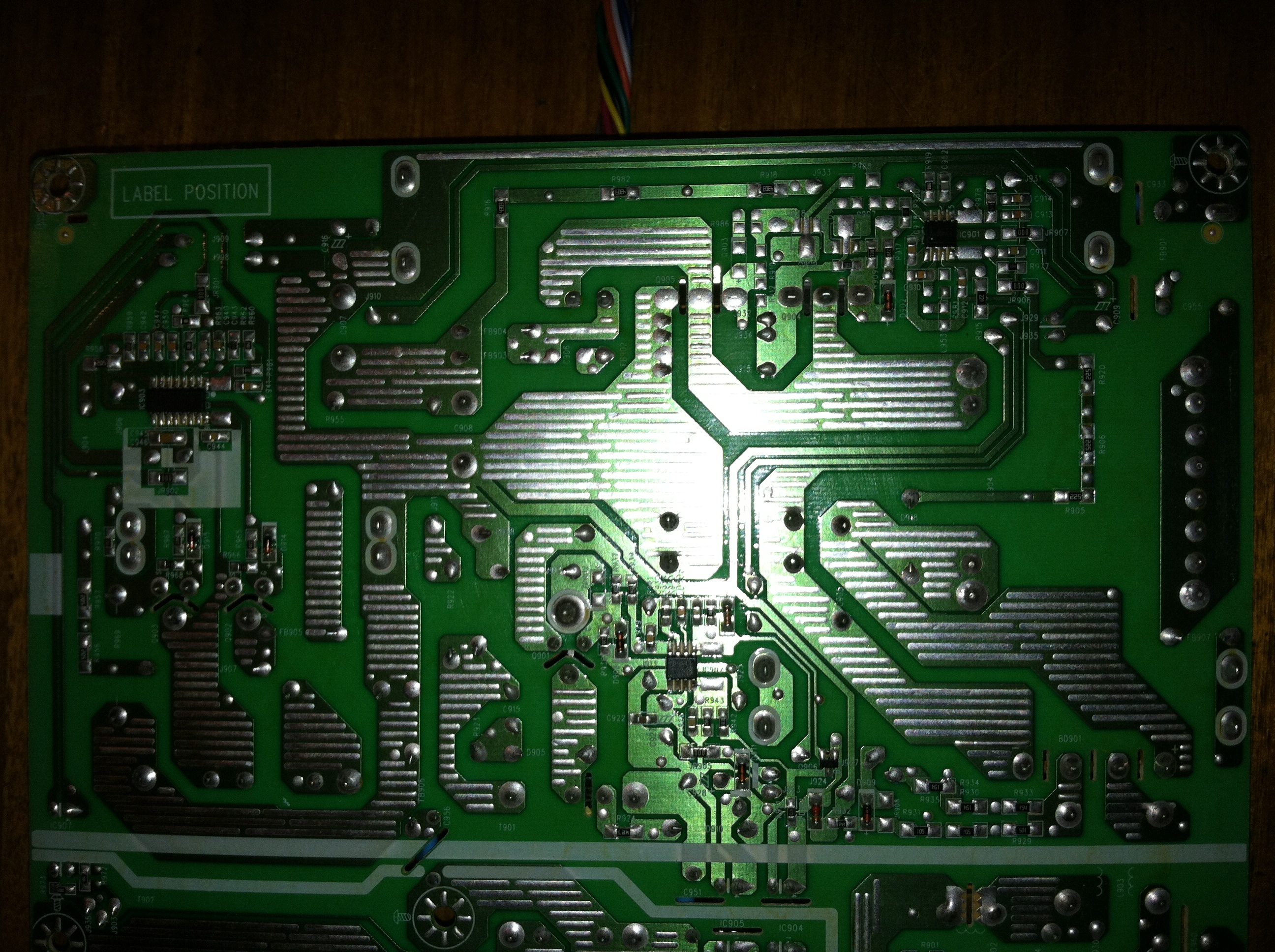

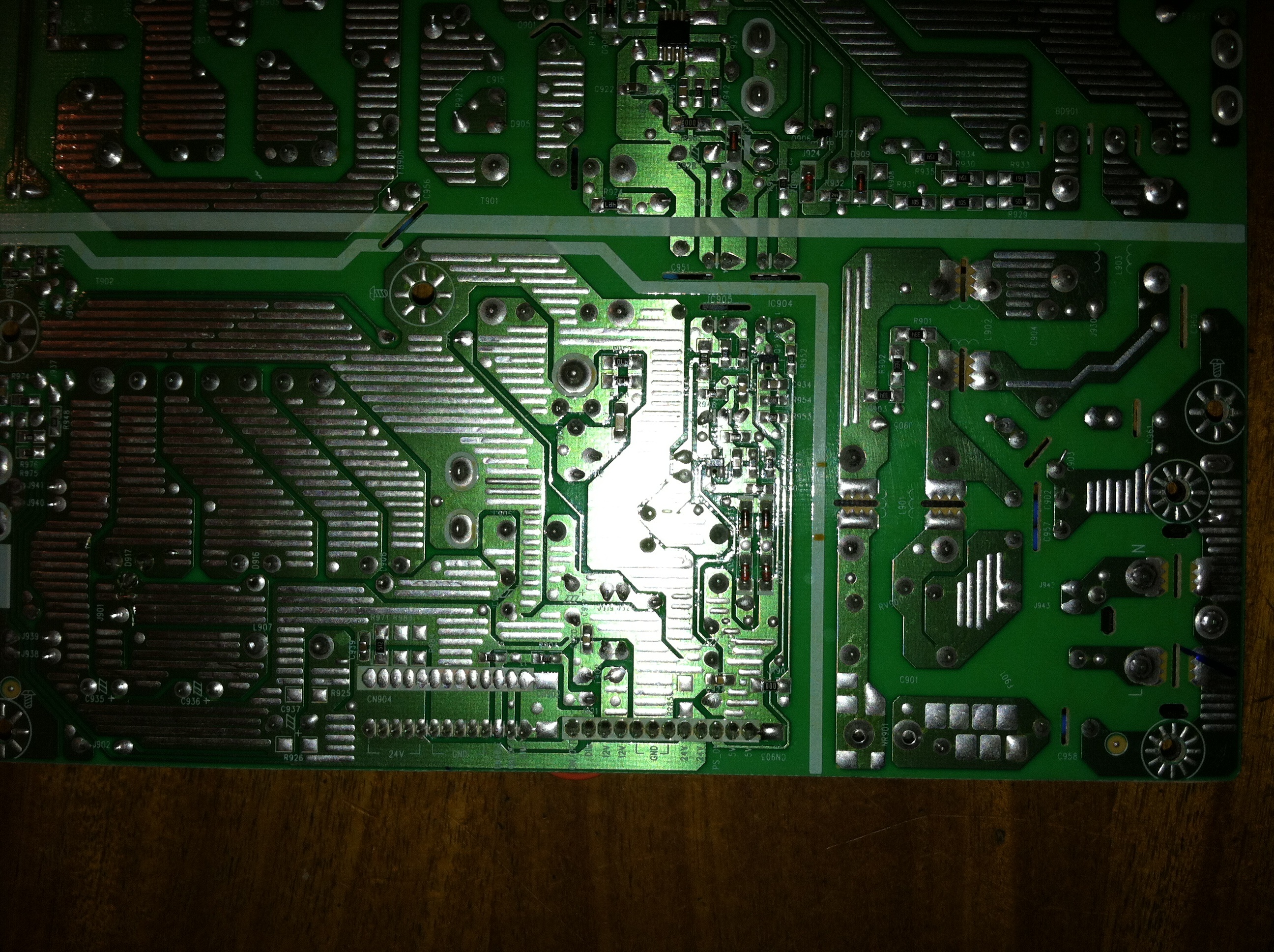

                      #30
                      I'm not sure how to go about labeling these. Here's the side of the board with the connectors. The top in this pic is the same as the pic of the front.
                      • johnboy1313
                        • Nov 2012
                        • 1959
                        #31
                        Here's the other side. Not sure why I can only attach one pic at a time.

                          #32
                          The number on the back is the same as the front C909, c910, etc.

                            OK, I can see the caps clearly now, what is the pin # of that 8-pin SMD next two the two caps on top of board?
                            Most likely it's C926 which is the startup cap.

                              I'm getting the feeling that I'm not very good at this. I can't find a c926 anywhere and I'm not sure what 8 pin SMD even is.

                                Any chance I could get you to circle the components you're talking about?
                                  #36
                                  I would say caps
                                  8 = 100uf 50V C928
                                  9 = 10uf 50V C927
                                  As you post in post#28
                                  You can see the connection on the bottom side of the board, the AUX winding of the transformer feeds R924 (4R7), the out out of the resistor feeds the Anode of D910, the Cathode the D910 feeds the + of C928 and the Anode of D911, the Cathode of D911 feeds the 0 Ohm resistor R905, the output of R905 feeds the+ of C927, C922, and the VCC pin of the 8-PIN SMD SMPS IC.
                                    #37
                                    Sorry, I misread it -- I did mean C928 as budm points out. Both might be startup caps, though I'm thinking one is the softstart cap and not critical, compared to the other. But we NEED the part # of that 8-pin SMD.

                                      I really don't know what an 8 pin smd is. I can bring the board to work with me. Once I know what I'm looking for, I'll get you the number.

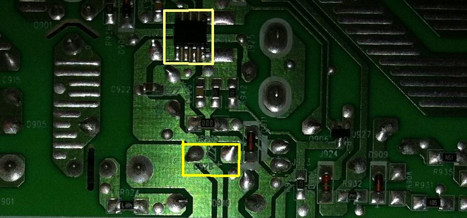

                                        #39
                                        Ok SMD means surface mounted device 8 pins - 8 legs- 8 solder contacts
                                        See pic - what is the part number SMD in the cream square
                                        • johnboy1313
                                          • Nov 2012
                                          • 1959
                                          #40
                                          Thanks, I was looking at the other side. My eyesight isn't what it used to be. Even with my glasses and a magnifier, I can only partially make out one. The other looks like it might have a crater in it. I'm going to pull up the service manual, look at the parts list, and see if I can find it.
