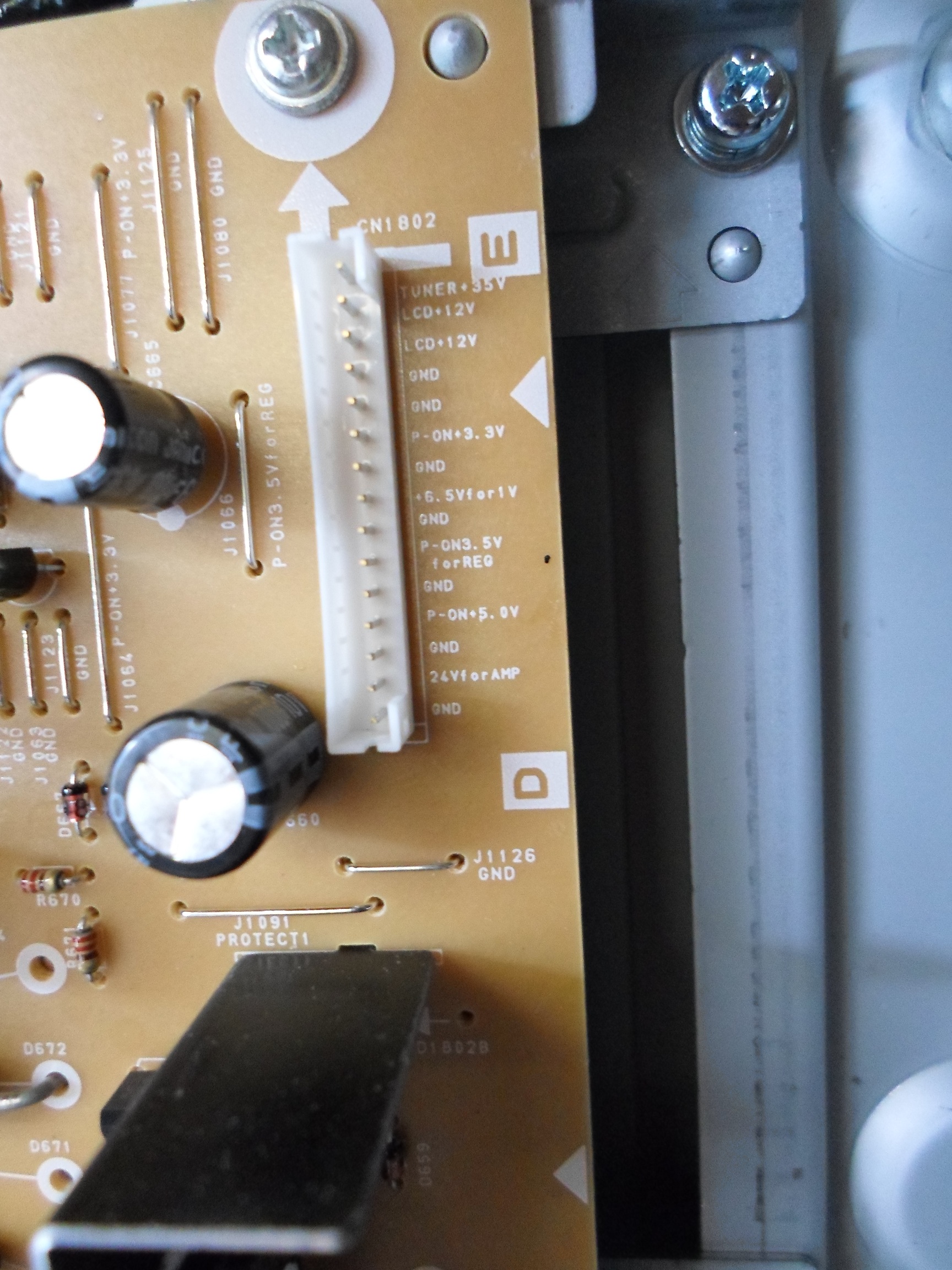

                Here are the readings from the mainboard connector and inverter connector.
                main
                tuner 35v is getting 39v
                lcd 12
                lcd 12
                p+on 3.36v
                +6.5vf or 1v gets 11v
                p-on 3.5v or reg gets 6.70
                p+ on 5v
                24v for amp gets 27.8
                inverter
                power sel 0
                bl adj is not used
                bl 5w gets 3w
                error 0
                gnd
                gnd
                gnd
                gnd
                gnd
                24v
                24v
                24v
                24v
                24v
                not sure how to inturpet these results?

                      I think that bl sw could be the same as bl_on which is at 3v and it seems like that would cause the inverter to fire up the backlights..can you hook your volt meter to this pin again and monitor the voltage? see what the voltage is when you first power on the TV, then leave the meter probe in place and see if this voltage stays constant, report your readings back here.
                      Hopefully budm and tom66 can help with this one. See Post#77, he has replaced the Power Supply Board.
                        #91
                        Re: phillips lcd keeps blowing fuse
                        OK, this TV uses:
                        PWM-SEL pin for lamp brightness control, it is being used by this TV.
                        BL-ADJ is the analog signal control for the lamp brightness, and it is not being used.
                        BL-SW is the same as BL_ON. You need to monitor this test point when the TV is plugged in but the power switch is not activated. Then hit the power switch and see if the voltage at this point changes state.
                        I believe you are getting the correct signal (3V as you had indicated).

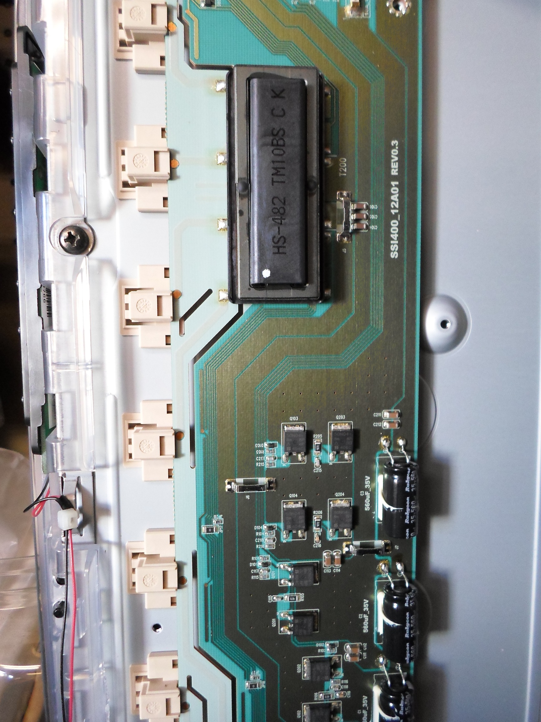

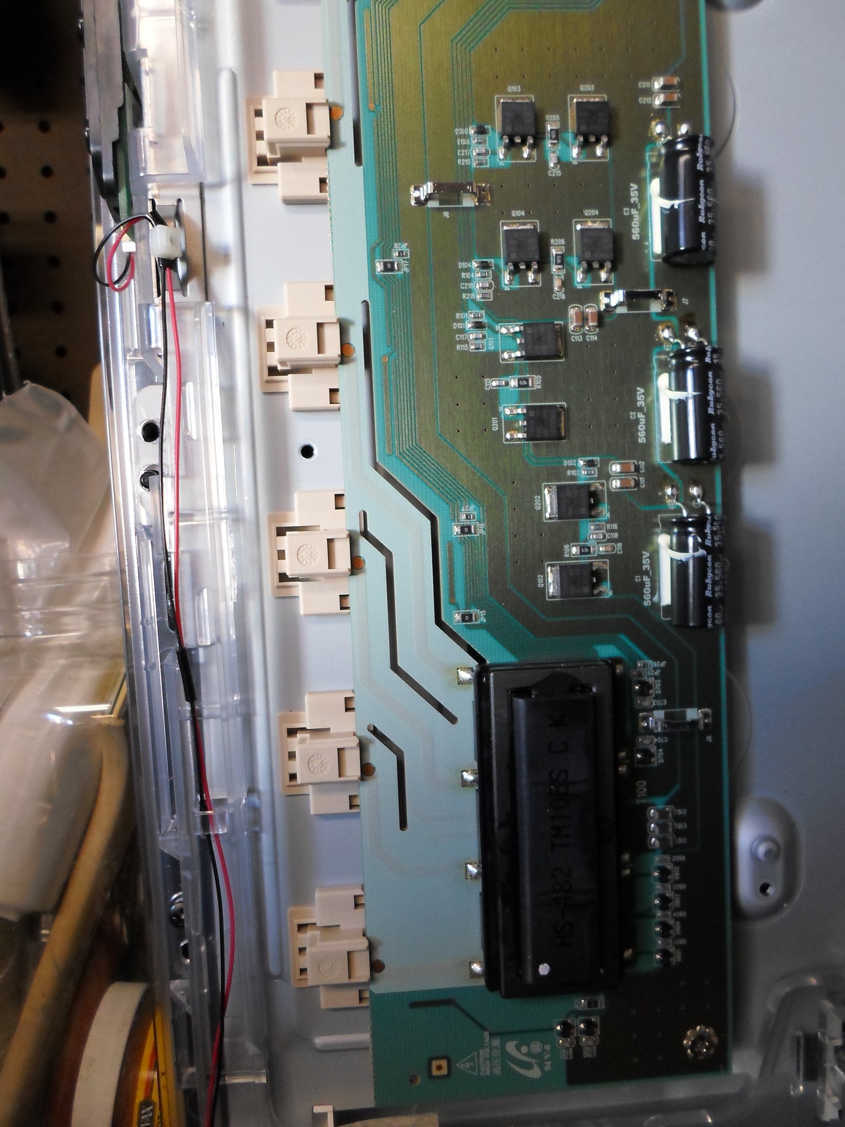

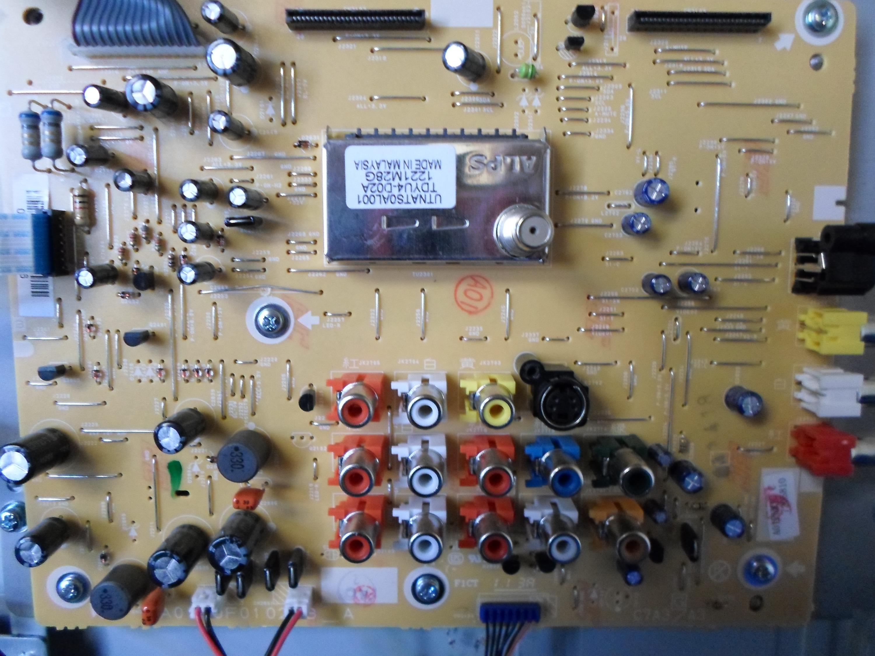

                          When I plug this TV in it automatically starts up..no stand by. not shure if thats normal for this TV. I can turn it off with the power button I think that may put it in stand by?
                          when plugged in I hear the " click " from power board. bl SW is 0 then in about 3 seconds it jumps to 2.99 to 3.00v " this is when the backlight kicks in for a split second " it stays at 3v untill I turn the TV off with power button then bl SW is back to 0. I can turn it pack on with power button with the same results.
                          here are 3 pictures of inverter board. I will post another picture of the other board. and a picture of the way I tested this. Thanks for your help! on the picture labeled connect the connector 4p is getting 1.6v if i remember correctly.

                            I noticed in your pictures of the inverter board that some of the mounting screws are missing, all of the screws must be in place and tightened to ensure a good ground connection from the board to the chassis, this can cause this type of problem. you should make sure all circuit boards have all the mounting screws in place and are snugged down tight. Also it appears that there is something hanging off where the SMF (F1) is mounted to the board, has this fuse been replaced? make sure that is not something shorting to another connection on the board, I believe I saw a previous post about the voltage readings being the same on both sides of this fuse, maybe you should do a continuity check by measuring resistance on this fuse with the meter in both directions. set your meter to ohms on 200 scale. just 200 Not 200k or 200m, just 200 ohms.

                                OK, the 3v is = Backlights on, and that signal is correct. So now we need to find out why the lamps turn off even though you do have the necessary voltage (24vdc) and the BL_ON signals.
                                The problem can be bad caps (black electrolytics caps), transformers, lamps, bad connection on the board fingers that make contact with lamps.
                                I would carefully remove the board and clean the contacts pads real well on the inverter board fingers, also look real close at all the sockets where the board fingers are plugged into, see if there is any sign of heat (plastic housing has brownish color).
                                Can I also see the whole pictures of the inverter board?

                                  I am off to bed he has posted pics of the inverter board but has had to split into 4 in post92
                                  There is one white fuse that I can see in pic 1 That should be tested.
                                  The inverters are HS482 TM10BS I cant see any but the tm series seem to have the secondaries along one side - see pic.
                                  Meter on ohms 2000 test S1>S2 and S3>S4 for each transformer and post results.
                                  There are quite a lot of Mosfets (Might be 50N04 s )on the board - Q designation and they should be tested also.
                                    #97
                                    I saw those pictures in post 92, but I can figure it out a little better if i get to see the whole board also, I can see on small current sensing transformer on the board.
