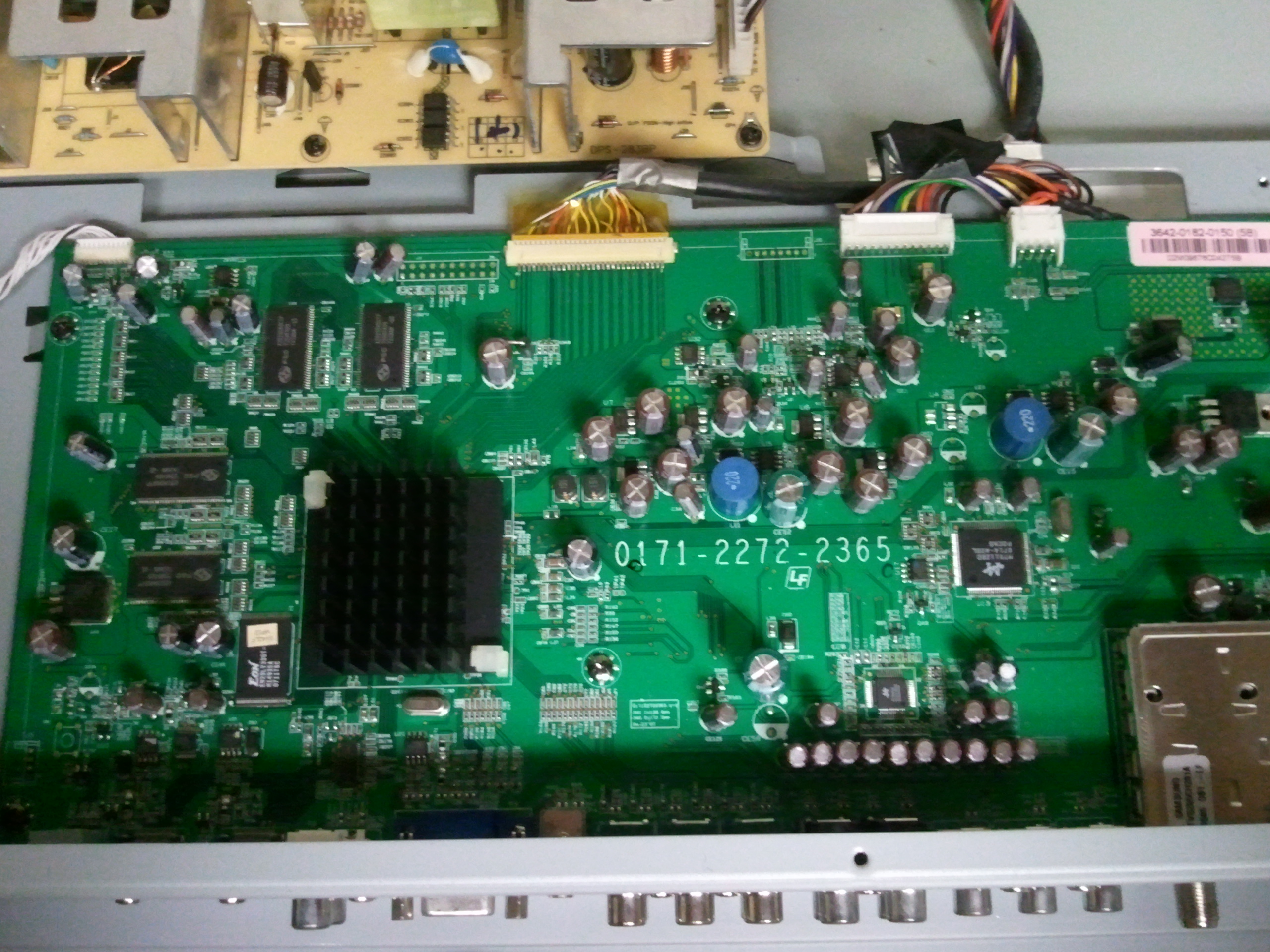

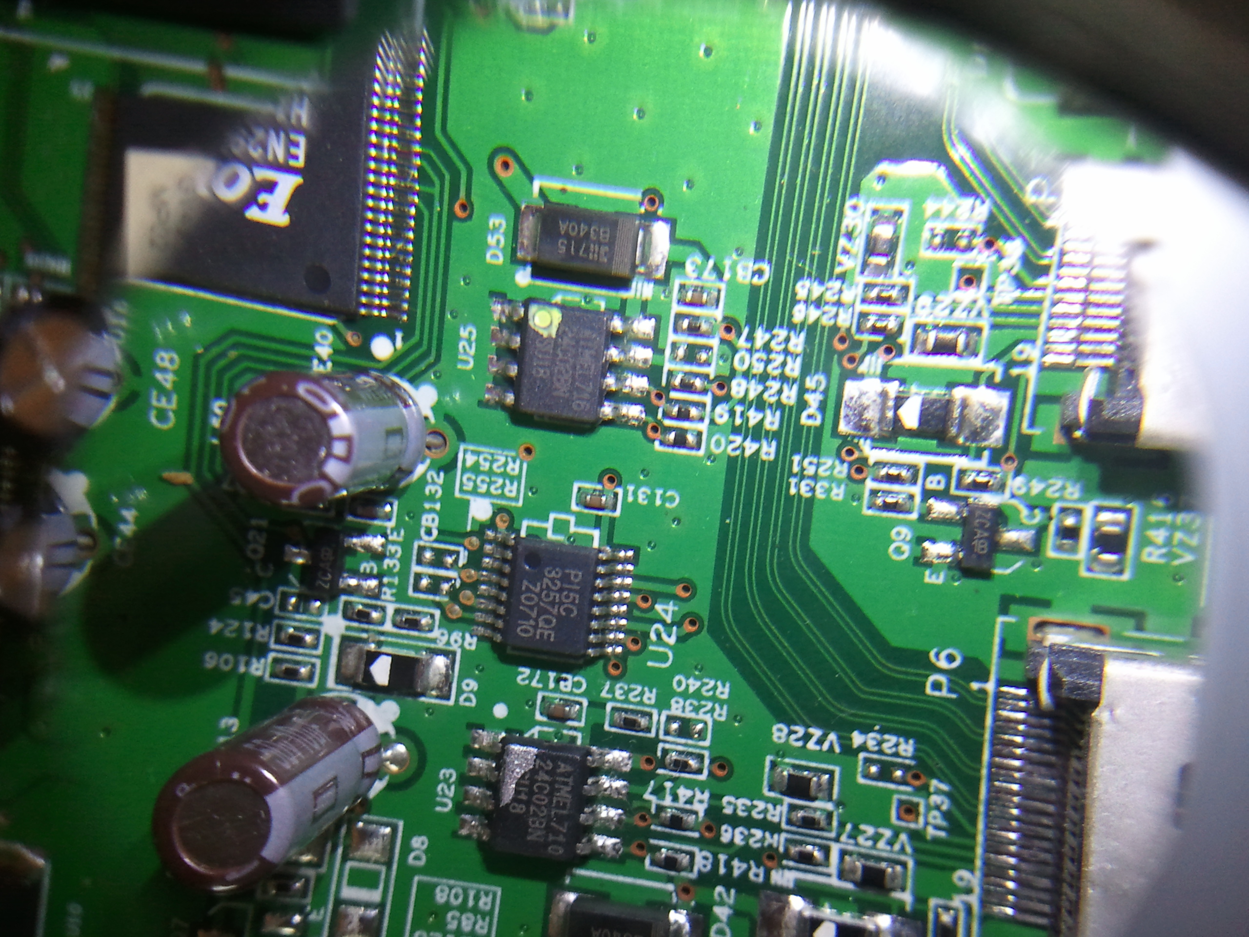

    Tv has no picture or sound. the backlight works. I have to unplug the tv from outlet to turn it off. I have another Tv that does the same thing. is this a common problem? I would like to fix it but not sure were to start.

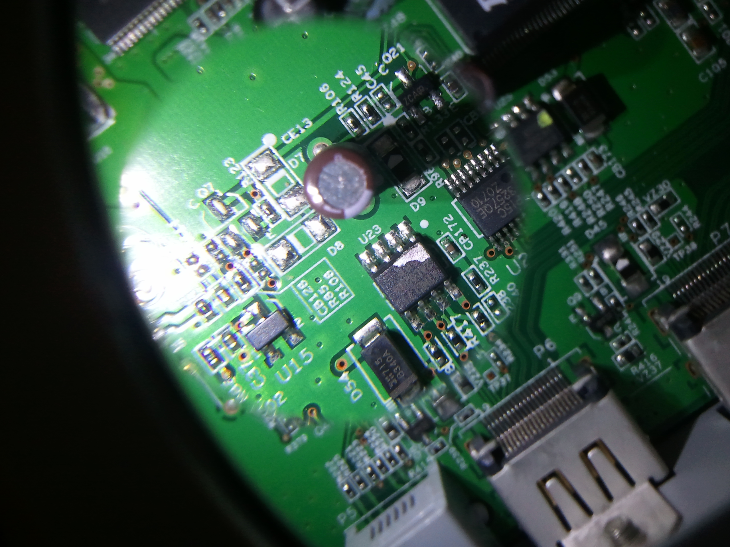

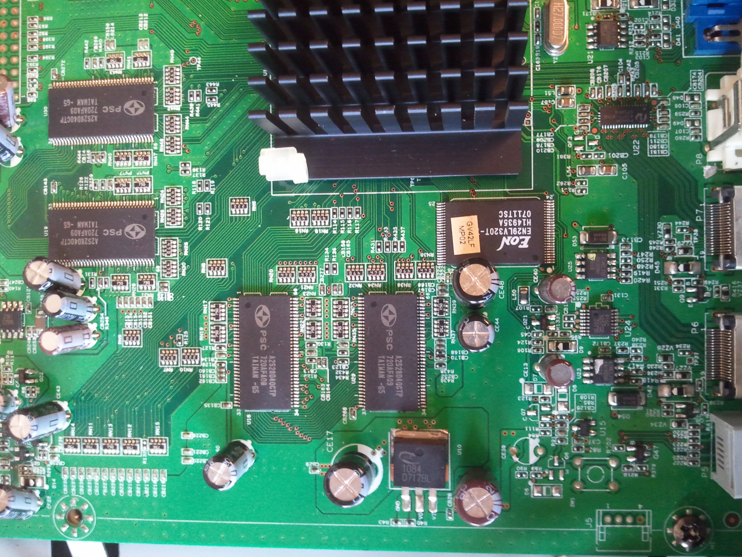

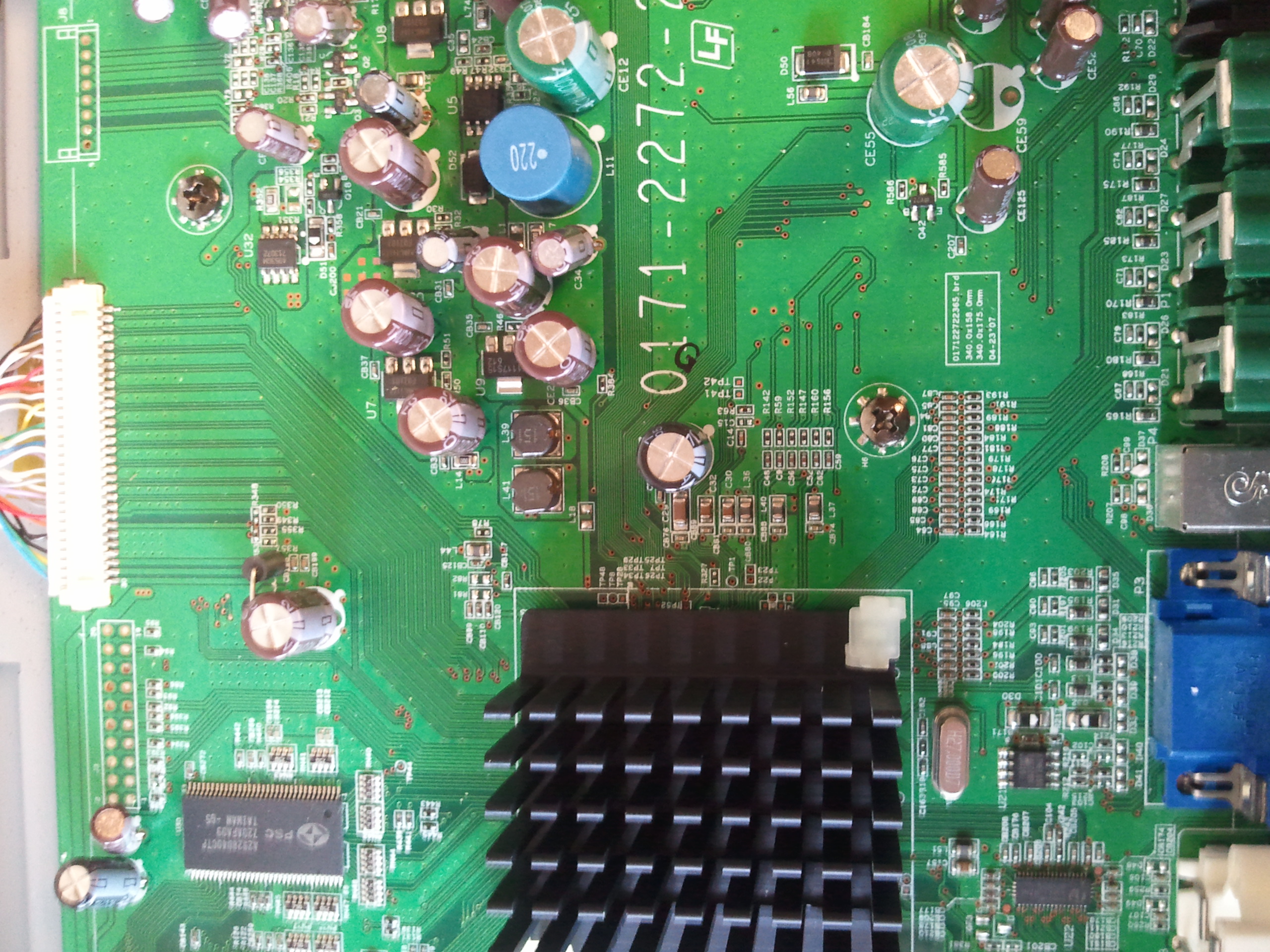

              chip with " green " is that normal? the chips are by Amtel 710 24c028n su18 and Atmel 716 24c028n s018 I cant find any information on these.

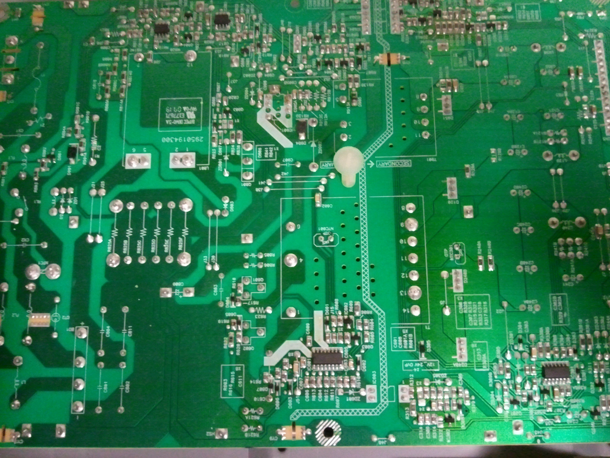

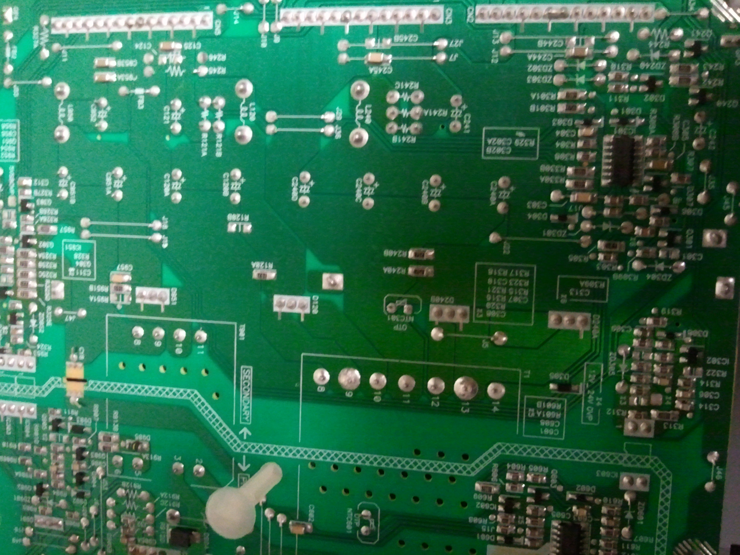

              • Cubone222
                lildinocubone
                • Oct 2012
                • 27
                Re: vizio 42 gv421 no picture/sound

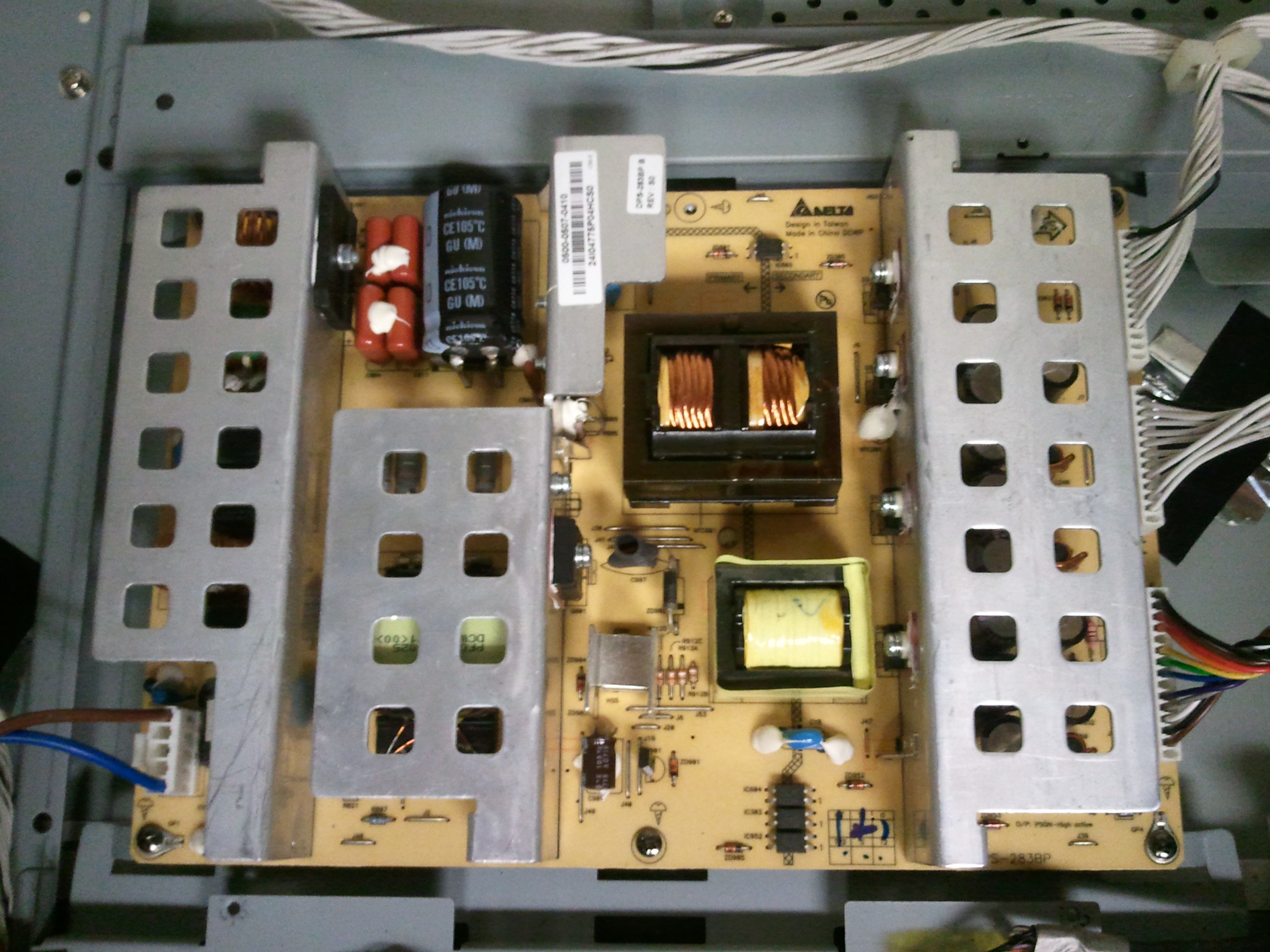

                I think those green and silver spots helped someone to denote pin 1 on the chip. They were replaced, or factory screwOP. You need better focused pictures. Front and back of the power supply board if possible. The whole main board. And a good picture of the whole back side of the TV so that the regular members can see how everything hooks up. I to had a bad voltage regulator on a 42" vizio. It sounds like a main board problem. But could be ccfls. Good luck.

                  The Atmel chips are eeprom chips, Don't mess with them!

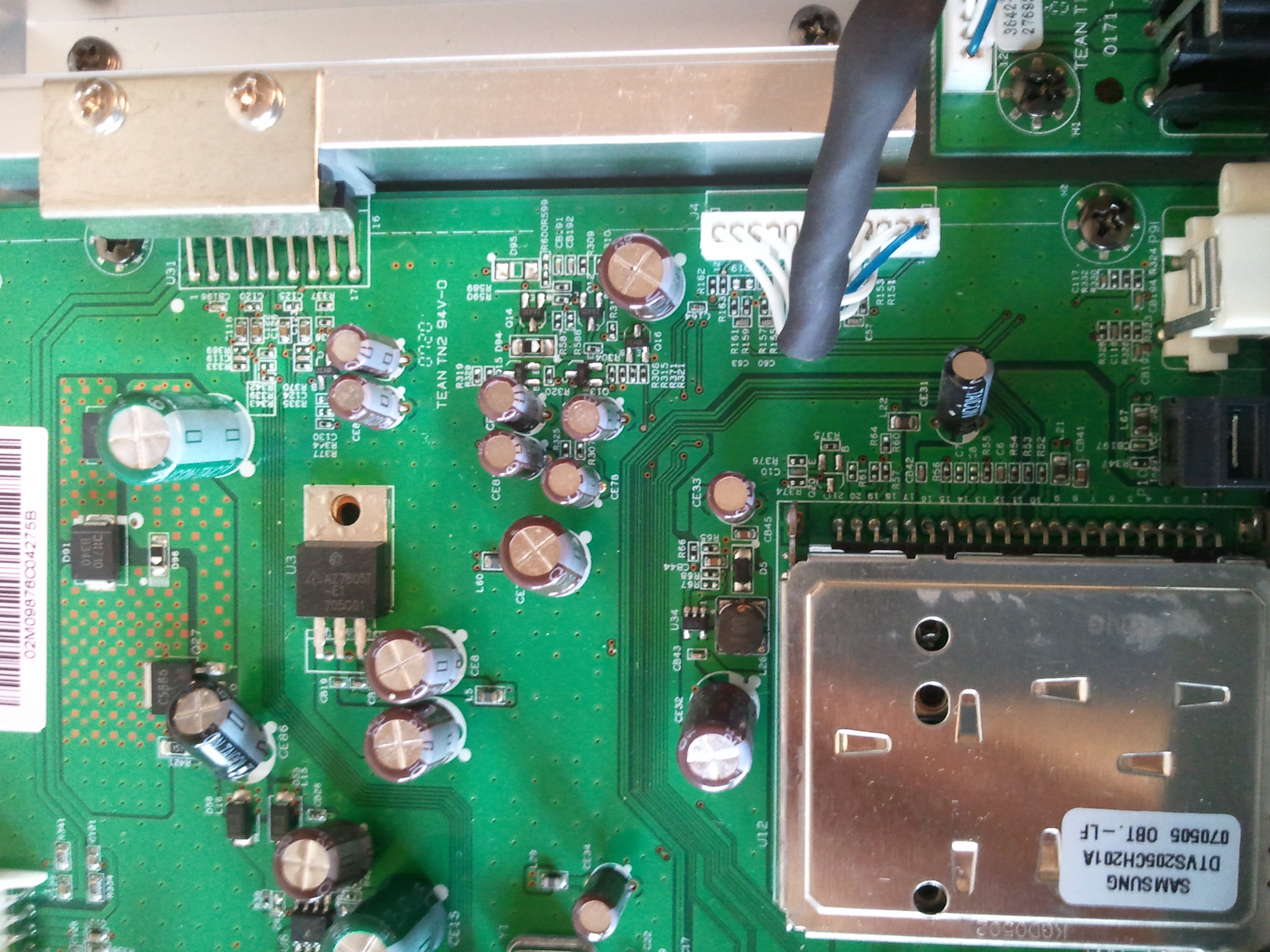

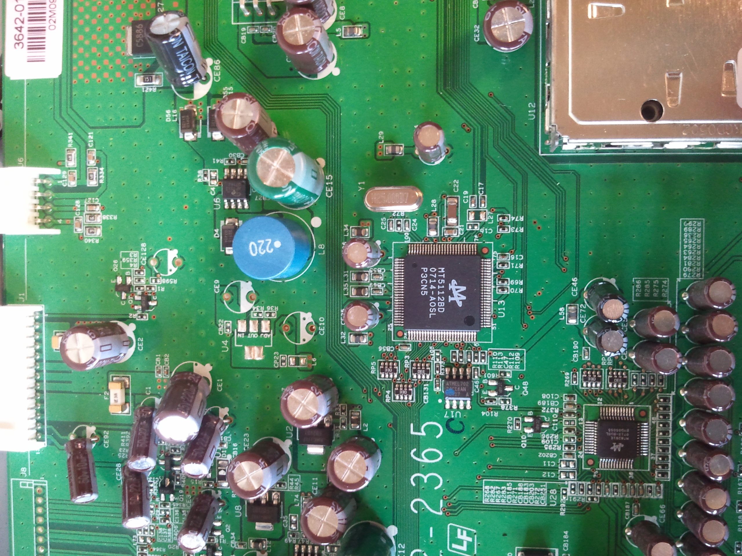

                    I wont mess with the chips! as i don't know what im doing I cant see anything wrong.. the caps " look " fine. here are more pictures.. I am having a hard time with my camera. so excuse the pictures.

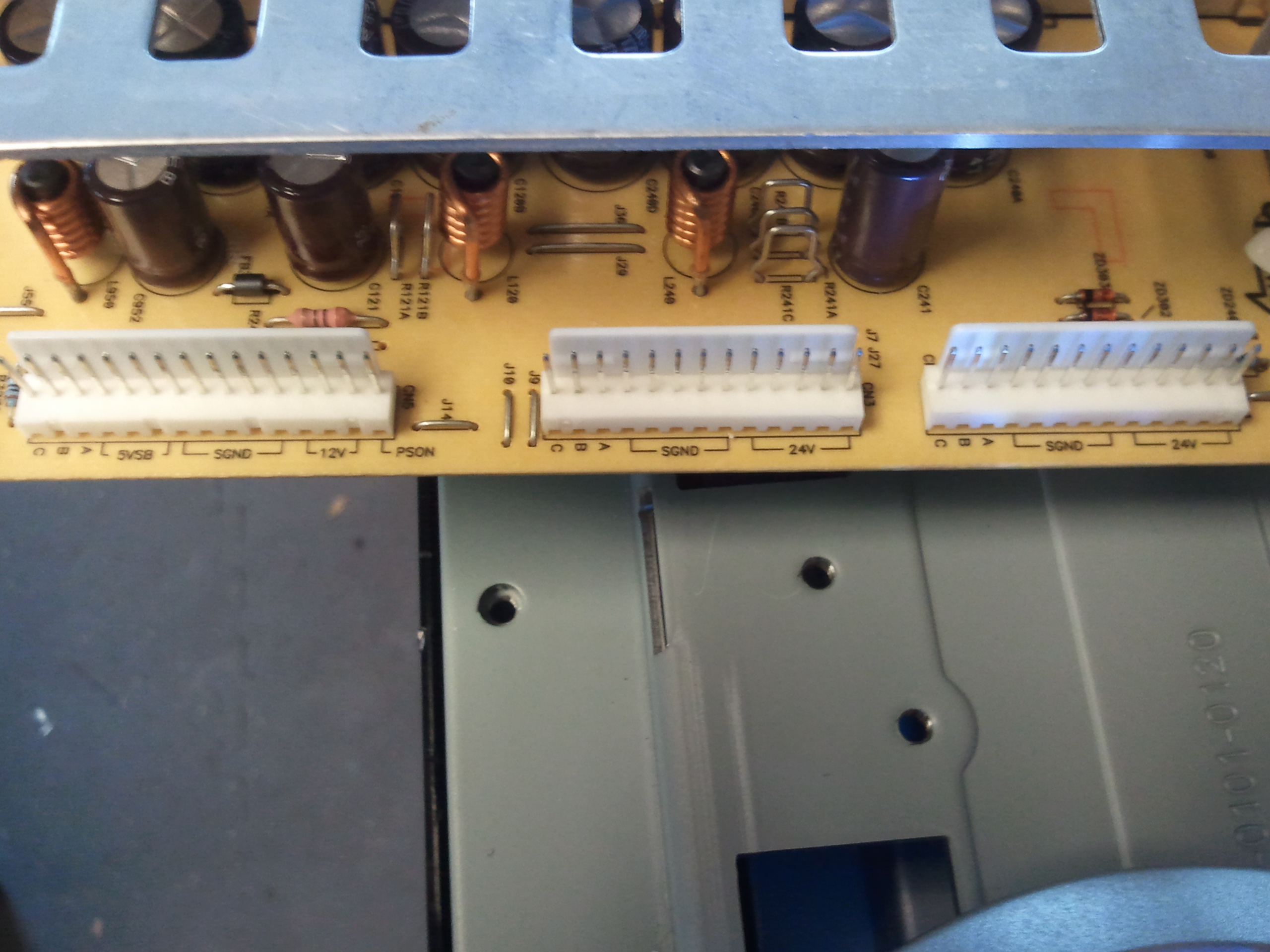

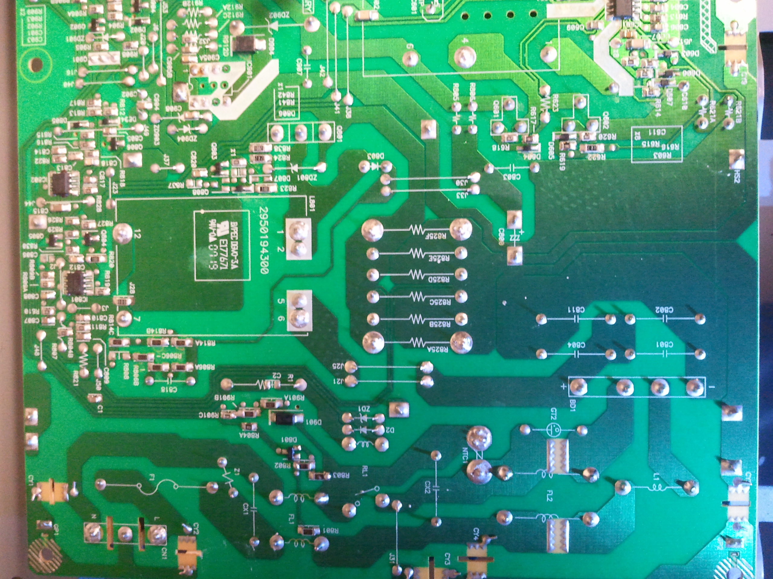

                      On those connectors on the power supply, do you see a pin marked 5V (or 5VS, or 5VSTBY), and a pin marked ON/OFF, PSON or STBY?
                      • TimT
                        • Nov 2012
                        • 268
                        • us
                        I found 5vsb and pson see image. thank you
                          OK, what is the voltage at 5VSB and PSON when the TV is showing the ORANGE (standby) logo?
                          Then press the power button. Do the voltages change?
                          The main board and inverters should be plugged in for this test.

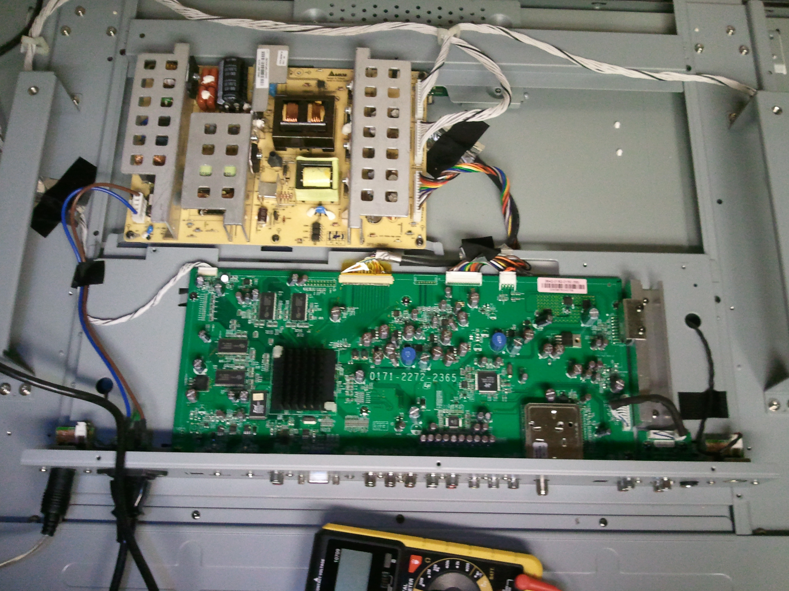

                            there 3.5.. funny i removed the ribbon cable to check then they were 3.0 then i put the cable back they were still 3.0 hopefully i am using the multimeter correctly. no change when i turen the tv off & on. better pictures of mainboard. is the powerboard ac and mainboard dc?
                              5VSB is just 3V? This is a problem. Can you just test a fresh AA battery just in case your meter isn't working right, you should get around 1.5-1.6V.
