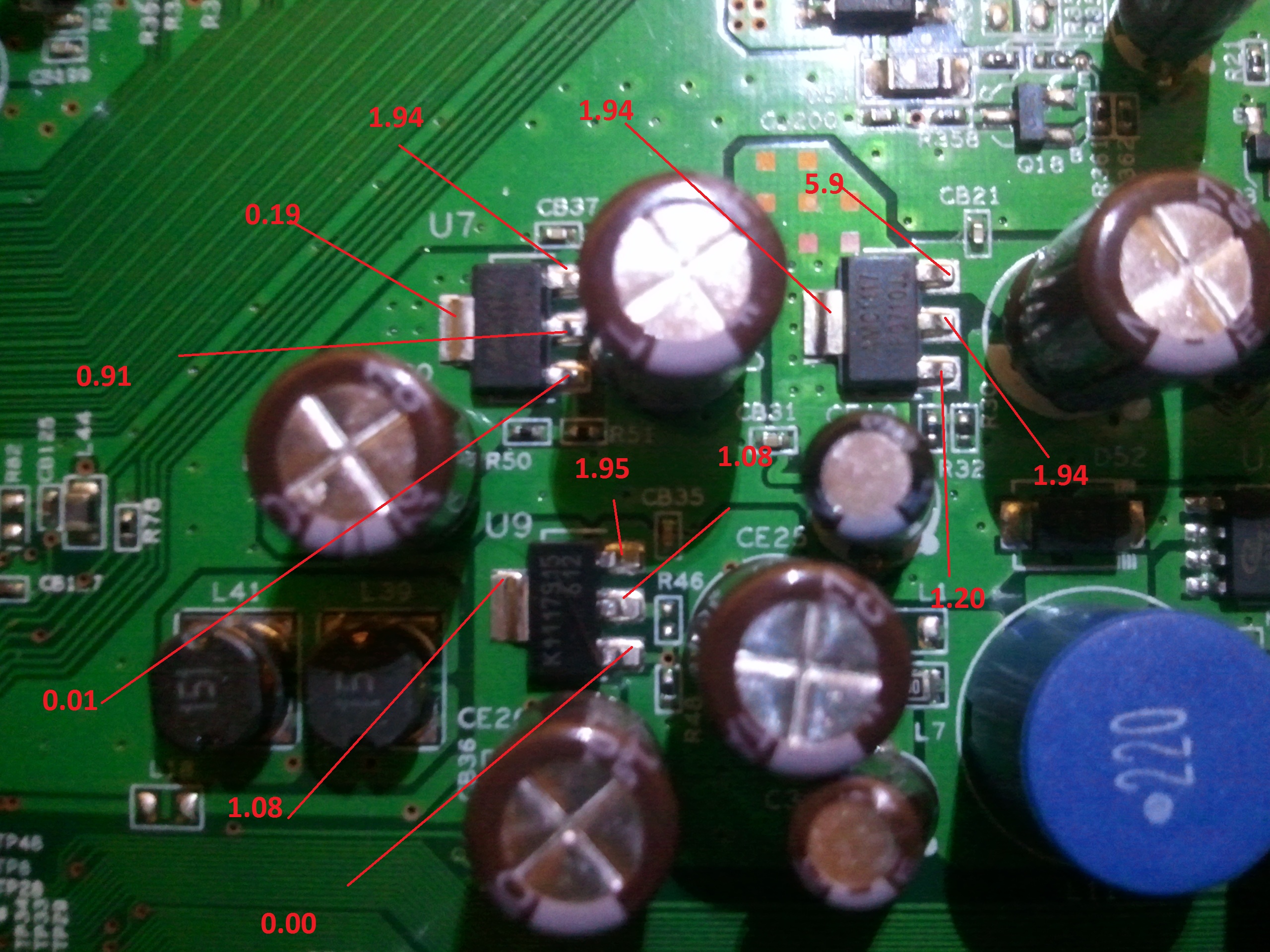

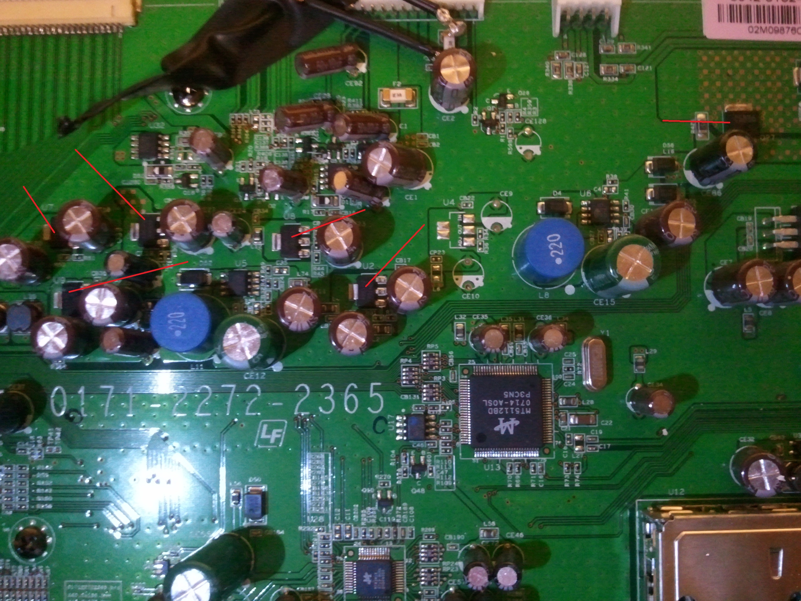

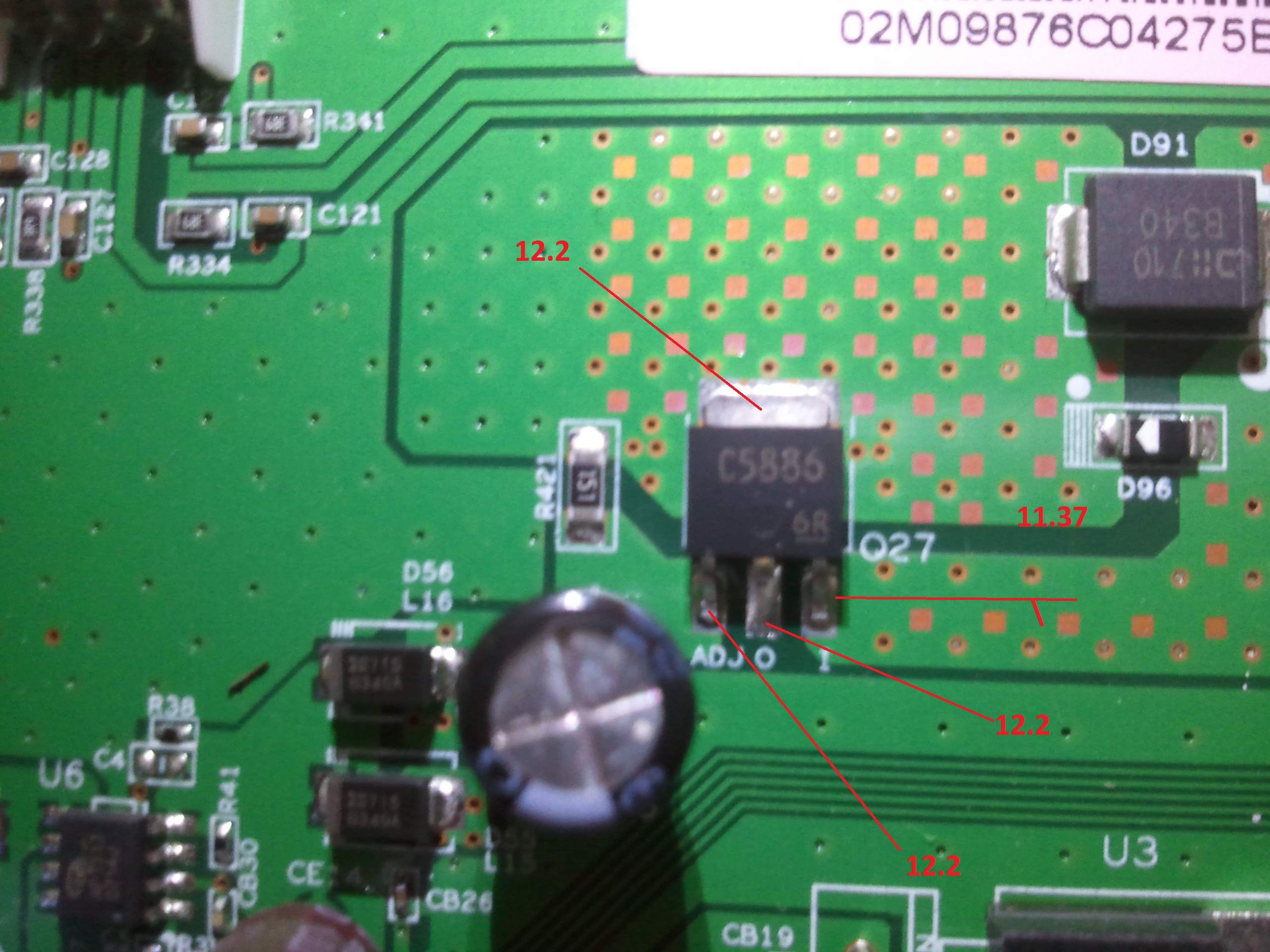

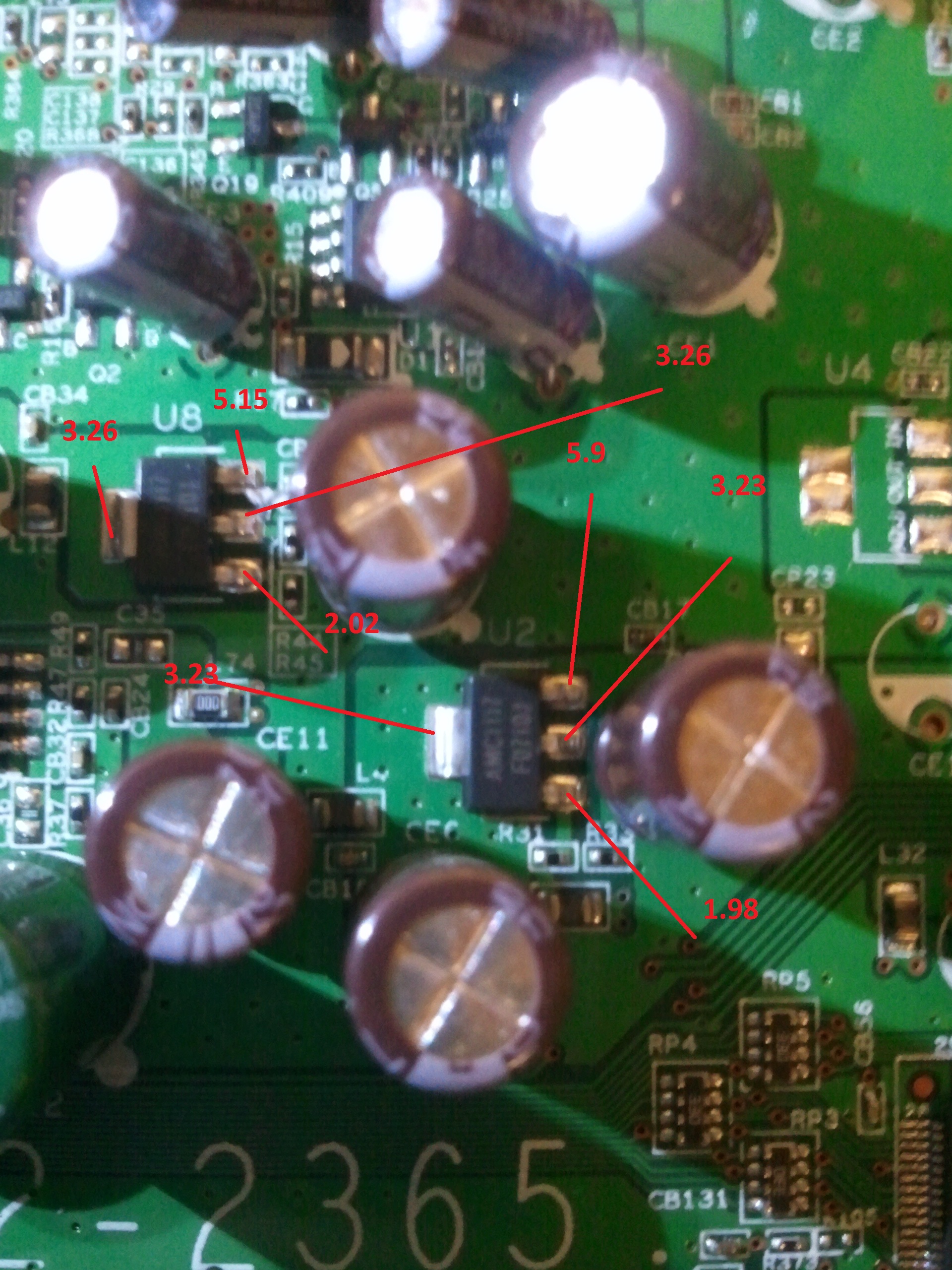

        I tested the regulators. the values are in the pictures. still taking this all in
          #44
          Re: vizio 42 gv421 no picture/sound
          OK, something is not right with all regulators in the 3rd pic.
          U7 output should be at least 1.25V more than adjust, but is 0.91V with adjust at 0.01V. Input is 1.95V.
          U9 has a low input of just 1.95V (may be OK). It is 1.5V type, for some reason different from the rest. It's only got 1.08V on the output, so something is wrong, but there's no way it can manage that output with just 0.45V input-output drop (it's typically minimum 1V for these regulators.)
          Other "U" (unknown) is taking the 5.91V and regulating it down to 1.95V... which powers the other two regulators. This is where the fault must be; the adjust-output difference is just 0.7V. I'll bet that other U is U33? It should be 3.3V, I think.
          Note -- you don't need to test both the centre pin and tab pin as they are electrically common (i.e. the same.)

              The bad regulator is giving 1.95V out instead of 3.3V. Funny, on Vizios, the 3.3V regulator always seems to drop to about 2V. I have no idea why, but it is a common defect. The part code is AMC1117 but you should replace it with one of these Budm linked to:

                so the regulator U9 is bad? or U9 and U7?. THE unknown /CE19 has 1.20 on bottom pin. should this be around 2.0?
                  #48
                  The unknown "U" regulator is bad - the rightmost one in 3rd image.
                  The middle (OUTPUT) pin measures 1.95V, it should measure about 3.3V.
                  The ADJUST pin, when working, is 1.25V below the OUTPUT, so about 2V when working.
                  The other two regulators are OK. They are not working because the input voltage is 1.95V, instead of 3.3V. The same 1.95V supply is generated by the unknown regulator and fed into the other two to generate two other voltages.
