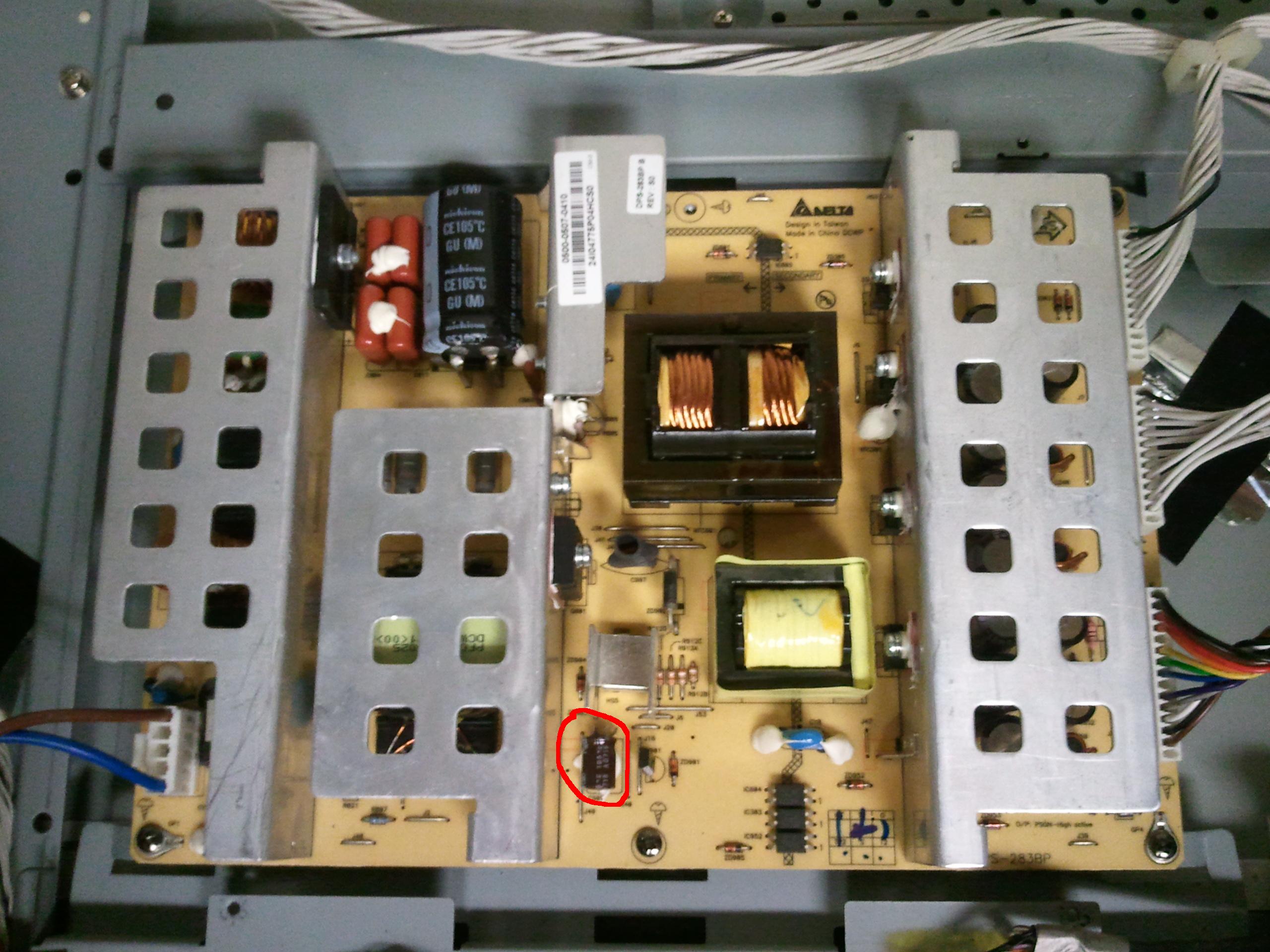

    Yes, the PSU converts 115V AC mains into DC 5V, 12V and 24V through several complex stages.

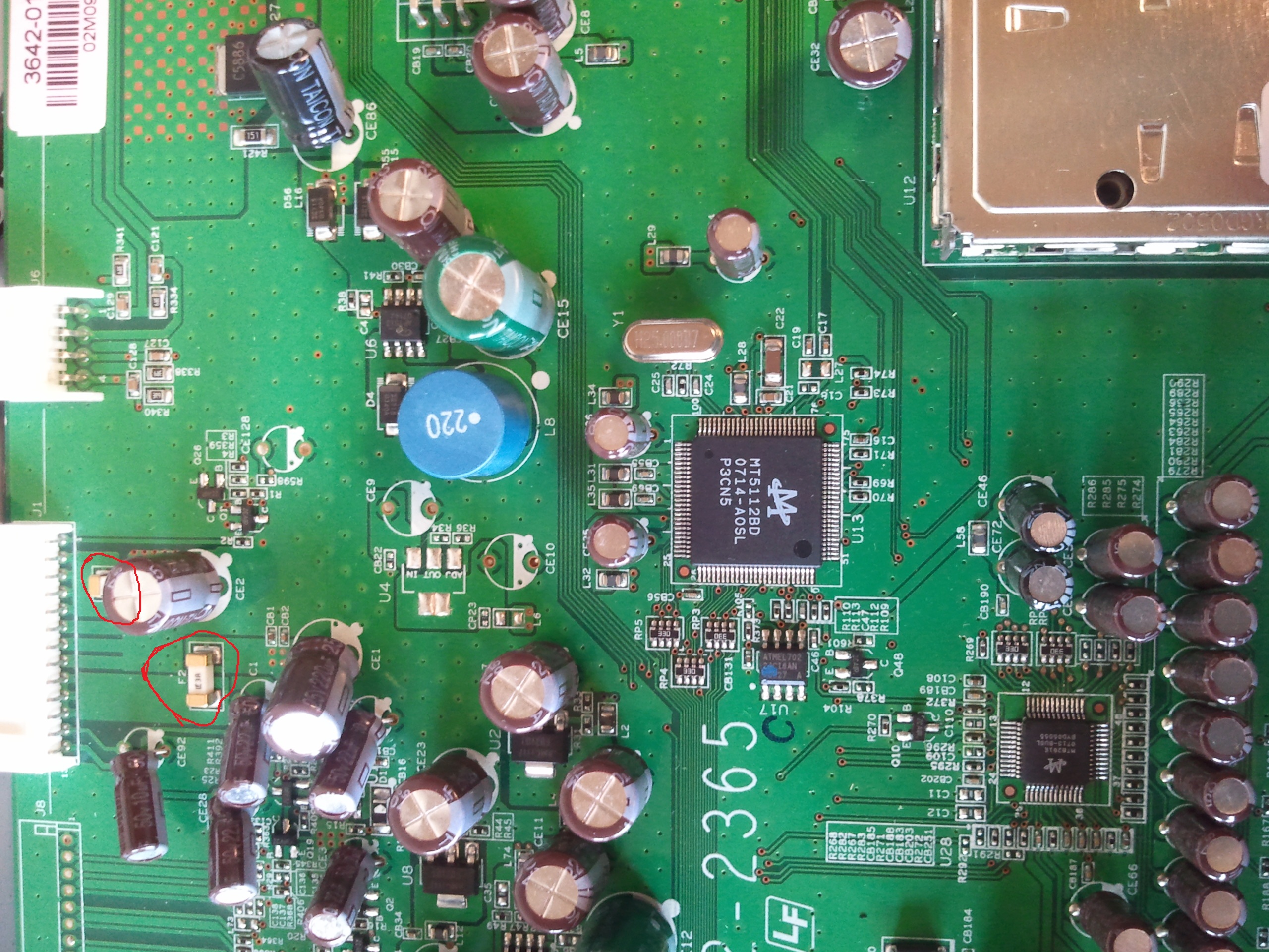

                    Re: vizio 42 gv421 no picture/sound
                    not sure were it's located on my board. are there any markings i should look for? I see F1 and F2 im assuming F= fuse.. marked on the picture
                      That is the main board picture, you need to look at the T-CON board as I indicate in post 28.

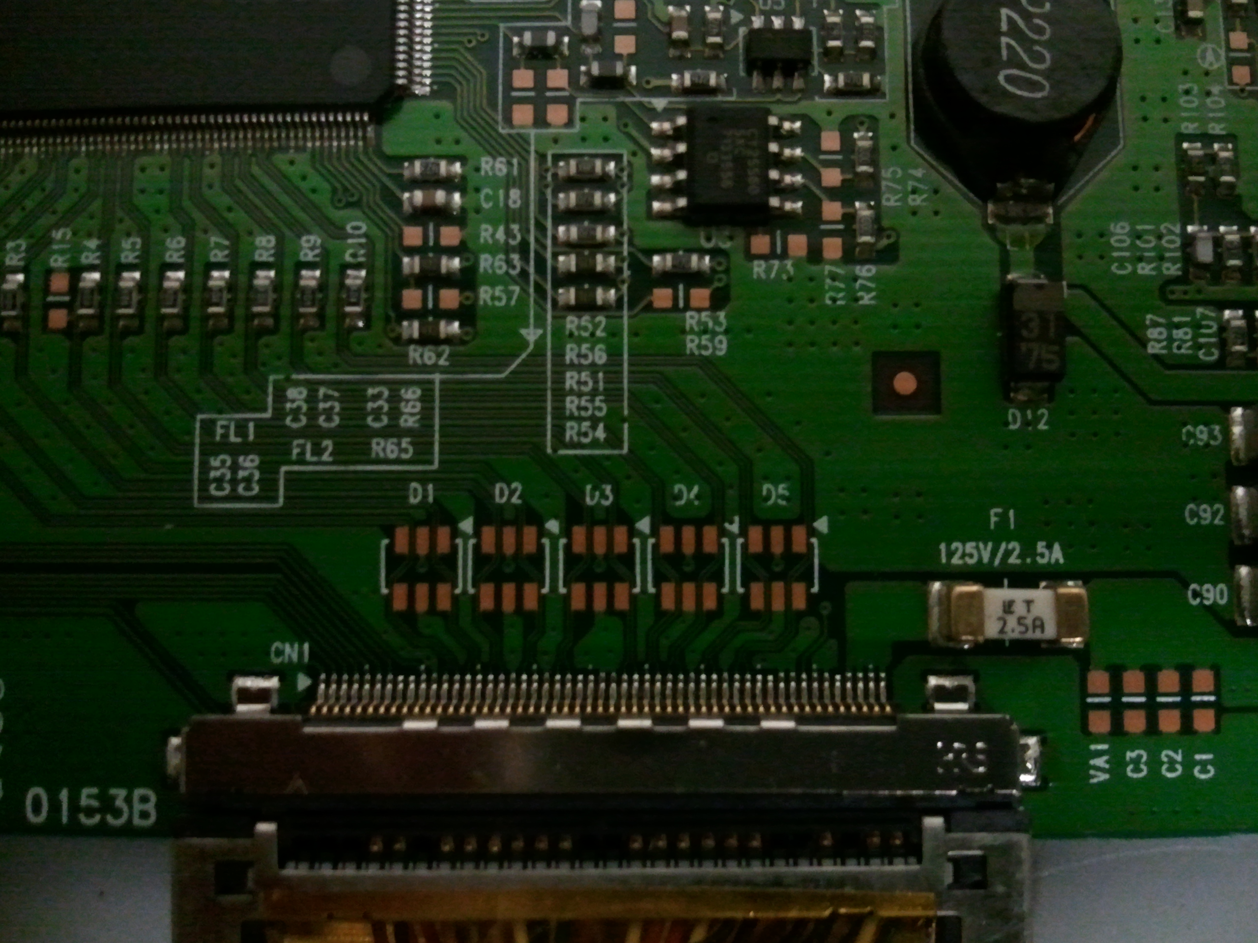

                        I opened the T-CON cover.. I tested fuse F1 @ 0.14 but I noticed another fuse??? see picture it stands out! looks bad?? tested 0.60 on one side 0 on the other
                          The other device isn't a fuse, it looks like it might be a ceramic capacitor of some sort, it is normal for them to come in lots of different shades.
                          Since you have 0.16V at T-con fuse, it's not receiving the correct supply (5V or 12V.)

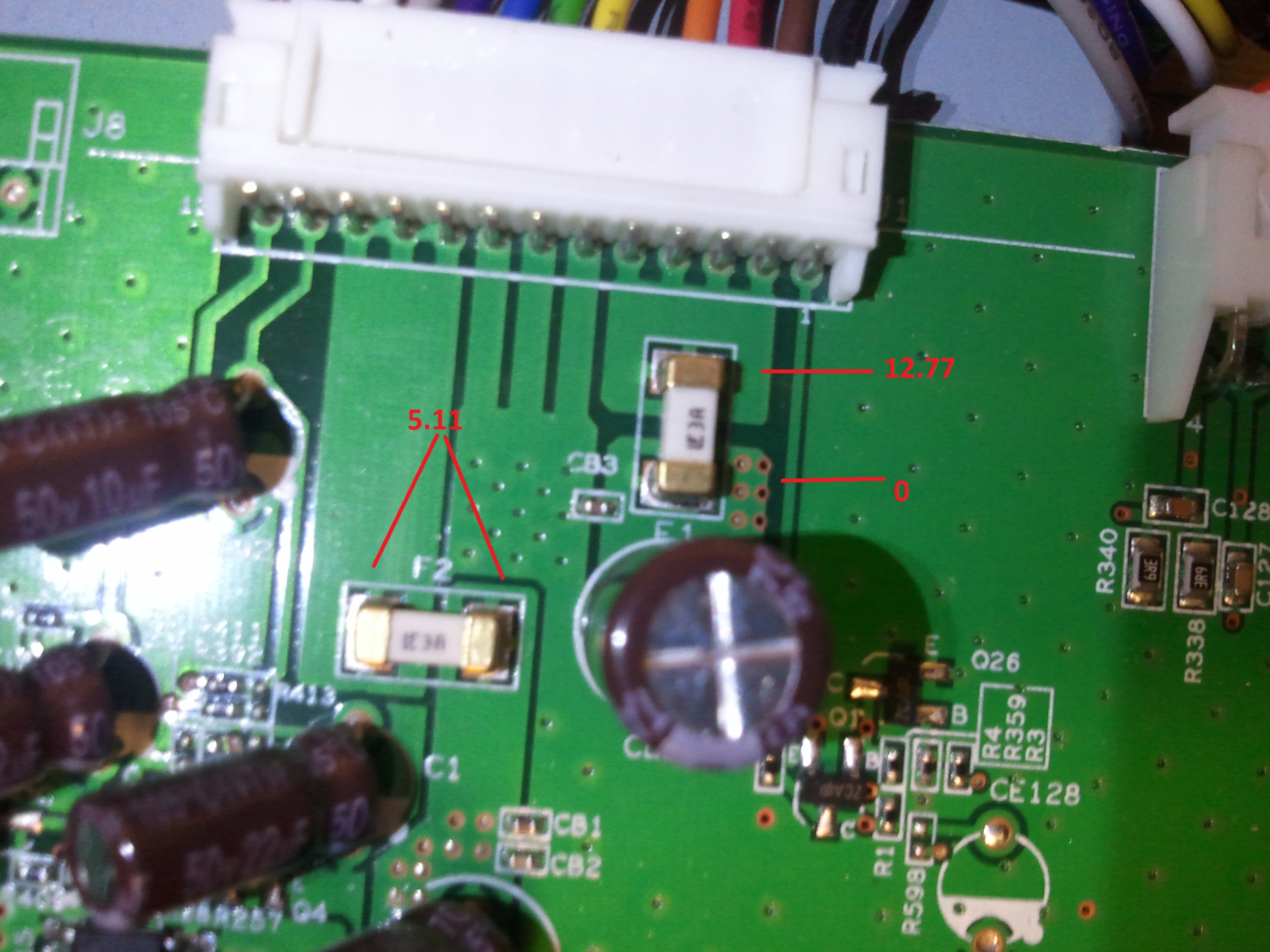

                            So there is no voltage at the fuse? There is a switched transistor/MOSFET on the main board that turns on when TV is power up to supply the power to the T-CON board.
                            Need good closed up picture of the main board where the cable to the T-CON board is connected.
                              I will take a close up of that connection. I just noticed there are two " fuses " on the mainboard were the cable from power board connects. this cable comes from the same pins i tested yesterday POSN and 5VSB. the fuse F1 reads 12.77 on one side 0 on other powerd on. see picture
                                #35
                                Great! You found the fault. That 12V fuse is blown. Can you get hold of a 3 or 5A small-blade automotive fuse? You can use that very temporarily in place of the existing blown fuse. If the blade fuse blows again, something else is wrong on the main board.

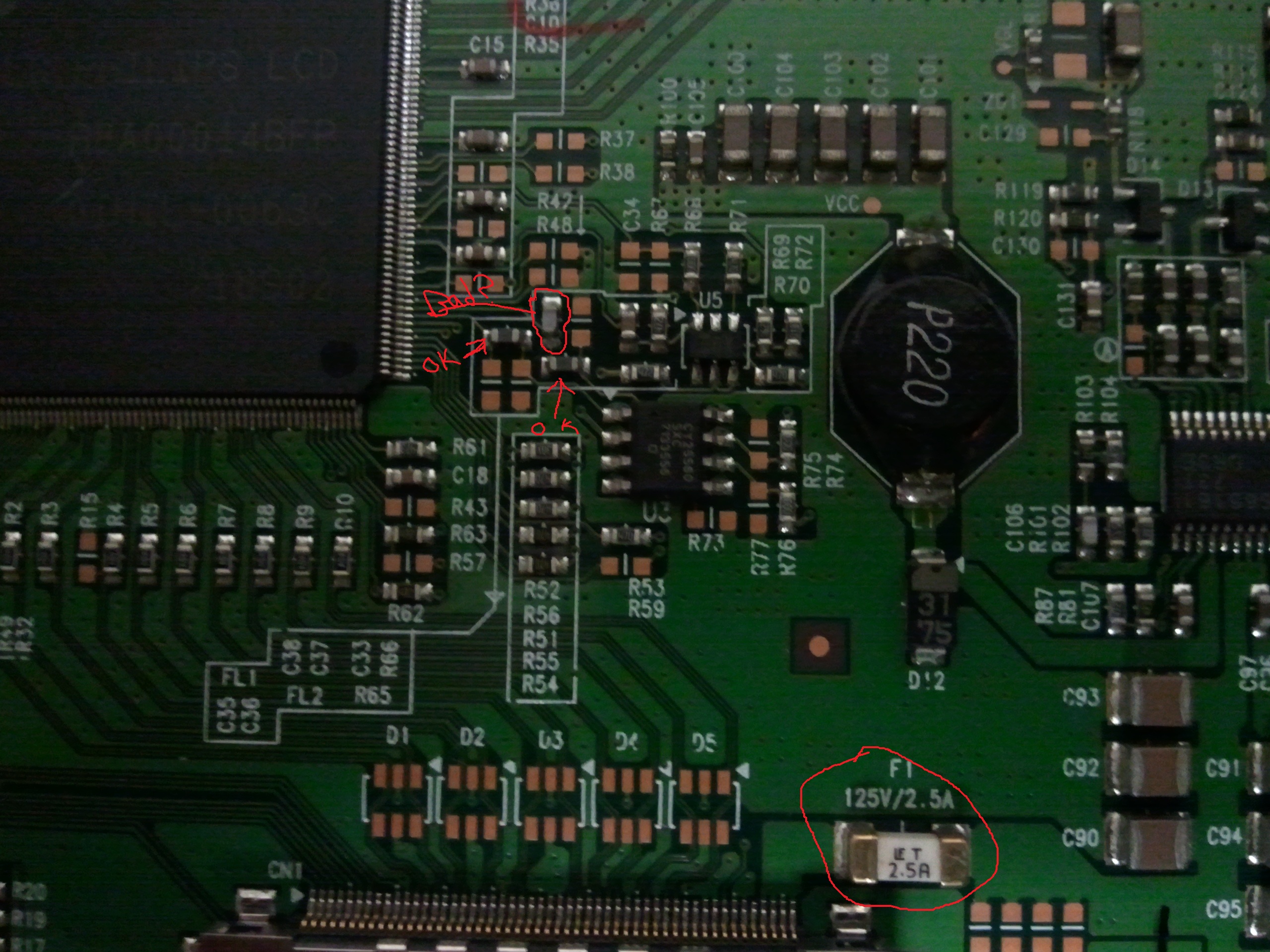

                                      #38
                                      ok got that working! 12v on both ends.. used 5A fuse. have no head lights now.. just kidding.. now on the T-CON board i was getting 0.04 on fuse f1 im now getting 12v on both ends. i attached picture but still not working.

                                        #39
                                        I gotta get up early for lectures tomorrow, but I'll leave you with a test to make (not my video):
                                        https://www.youtube.com/watch?v=cNFzBJELFoU
                                        Different problem, but the voltage regulator failure causes lots of odd issues.
                                          #40
                                          thanks for your help! that video helped alot. looks like the same part is bad on mine. regulator amc117 reads 1.95 on tap then 5.9 0 1.2 then i checked more they seem to drop down the last one i tested was 1.7 on tab 1.9 1.08 0 so looks like i need to order some parts.
