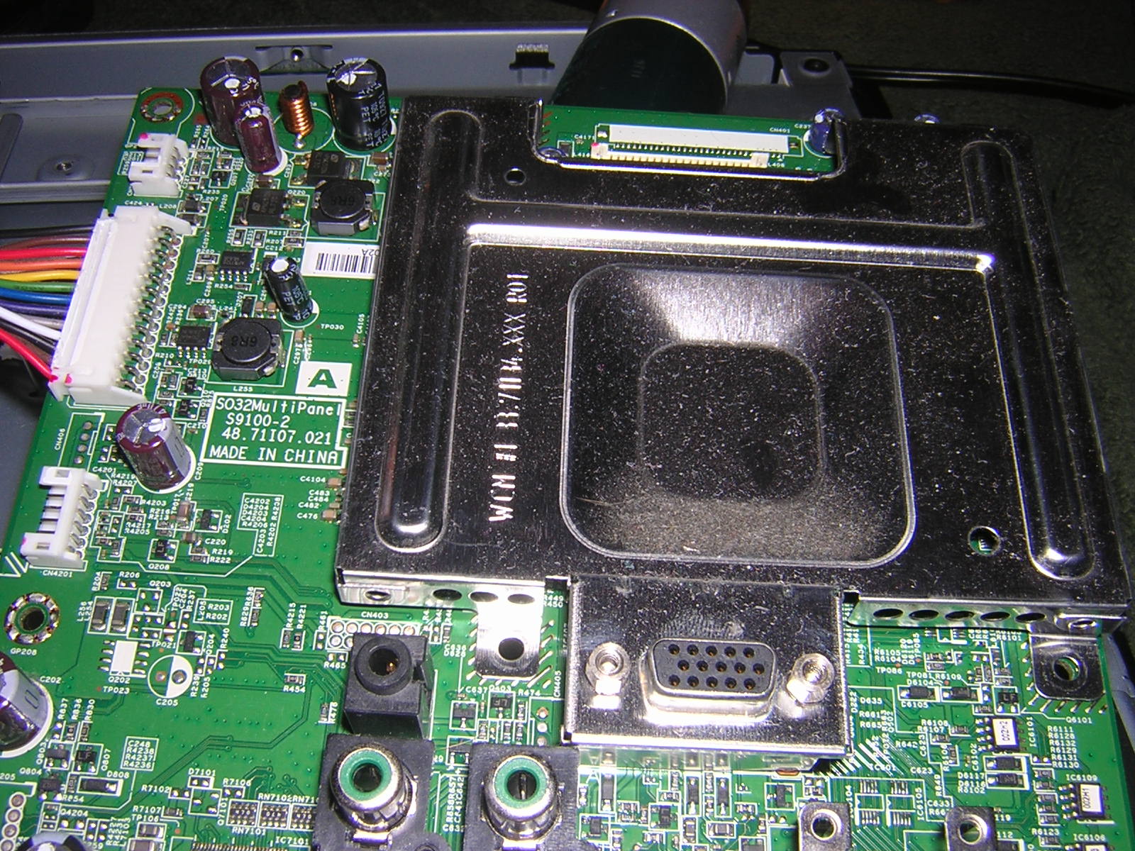

              #66
              Re: Sony KDL-32L504 No Power ....Dead
              Perhaps post good clear straight on pictures of the main board front and back (do not rotate it keep the top at the top - perhaps we can spot something.

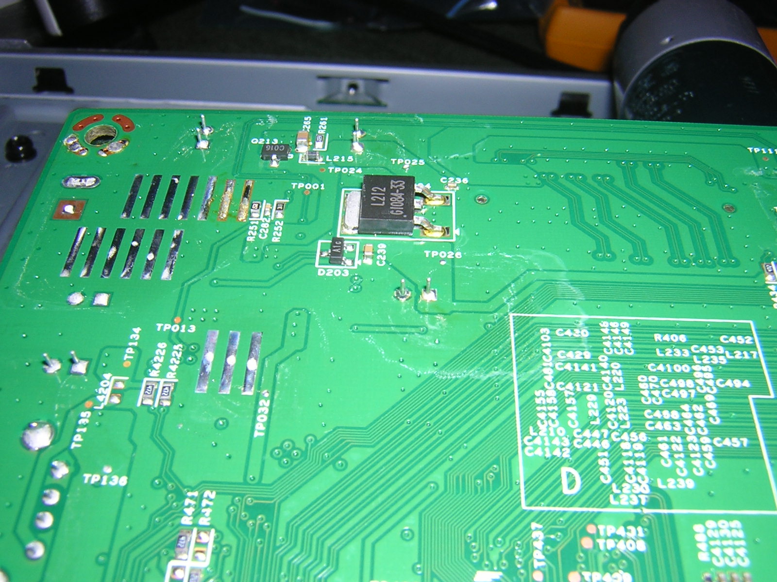

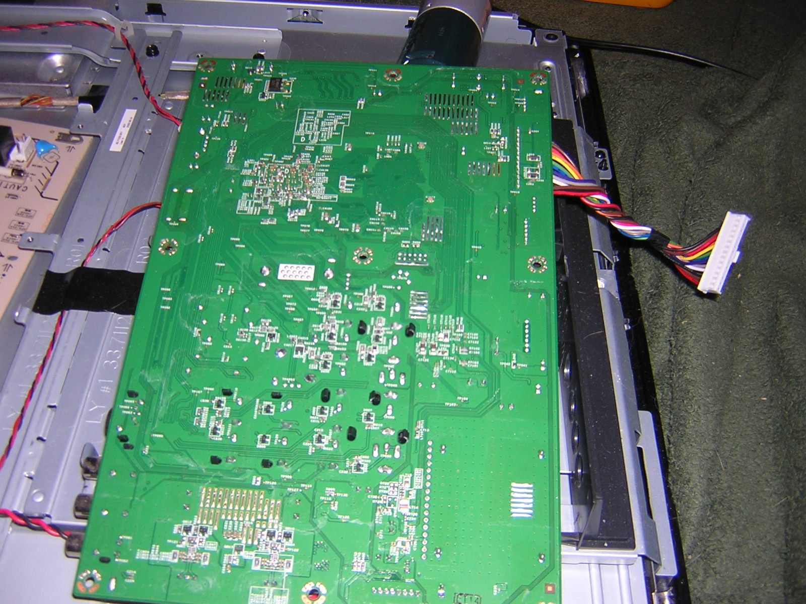

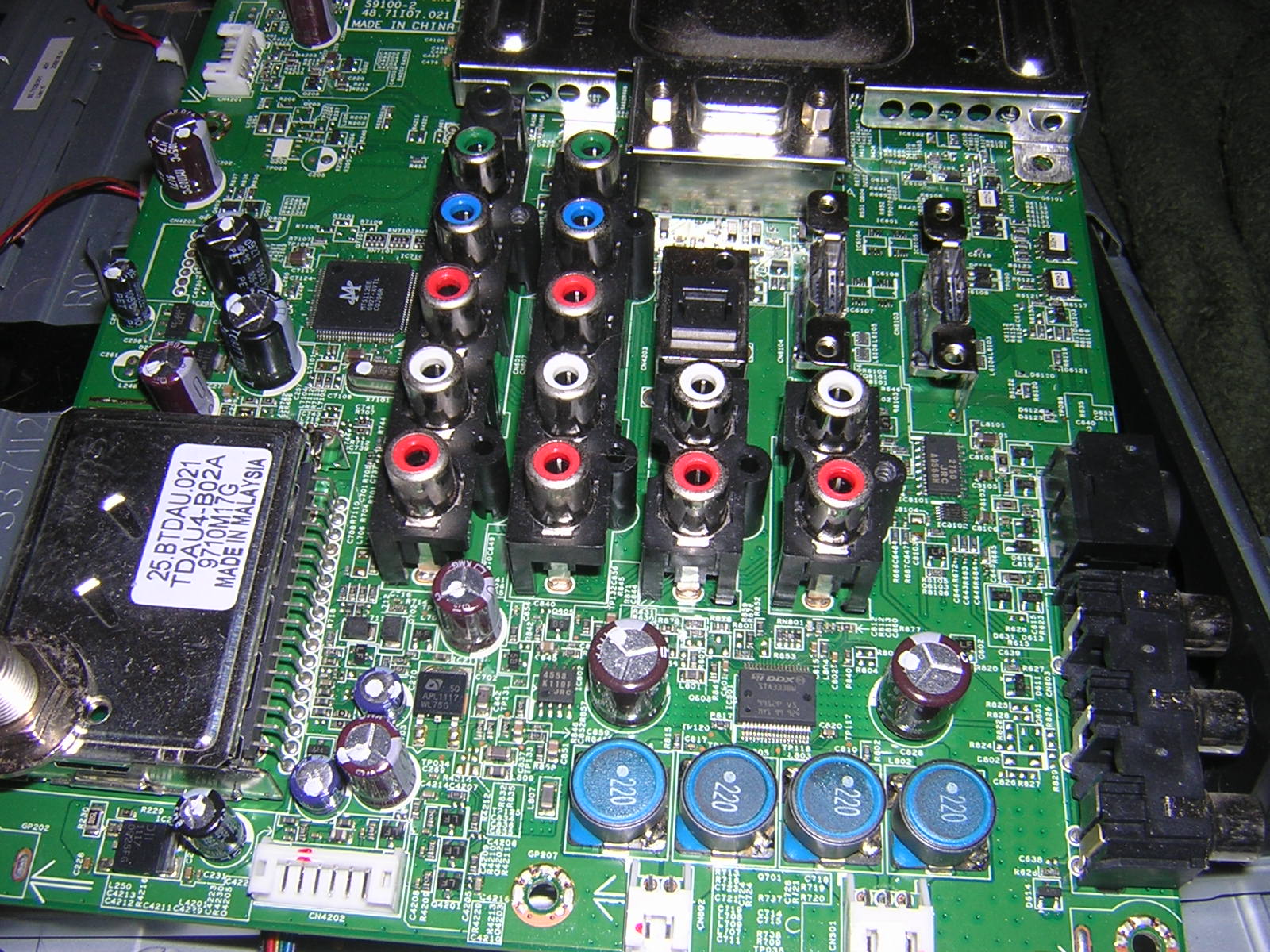

                  #68
                  I am enclosing pics of the front and back of the logic/video board
                  any additional ideas on how to find this short would be appreciated.

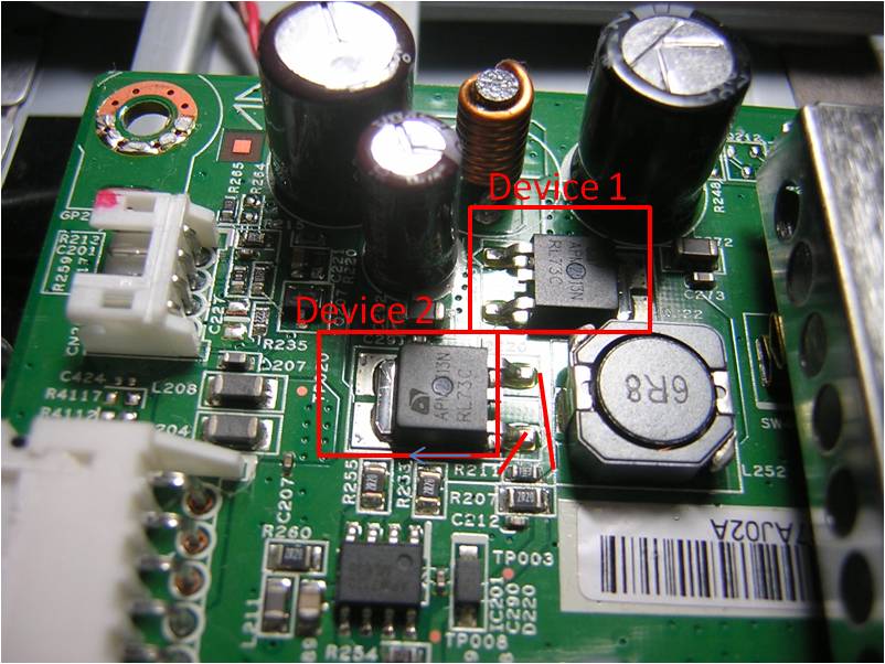

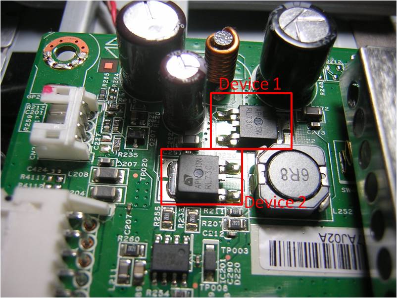

                    #69
                    see enclosed pic.
                    Device1 and Device2 are N-channel enhancement mode devices
                    Link to datasheet is here
                    http://www.anpec.com.tw/searchProduc...&keyword=2513n
                    When i measure device 2 from Source to Drain ......using ohms measurement i get a reading of ~ 18Kilo-ohms. When i make the same measurement on device 1 i get a reading of ~ 4.5Meg-ohm.
                    is this a sign of anything?

                      #70
                      ok...i found that i think that 18k measurement is valid.
                      See enclosed pic.....i have tried to show that there is an 18k resistor ......one lead of resistor goes to source node and one lead goes to drain node thus the reason for me measureing 18K across source to drain......
                      any other ideas on how to find the problem? or should i just tell neighbor cant fix it.
                        #71
                        That is a DC-DC converter -- what does the output measure? If the output is shorted, the power supply might see a short too.
