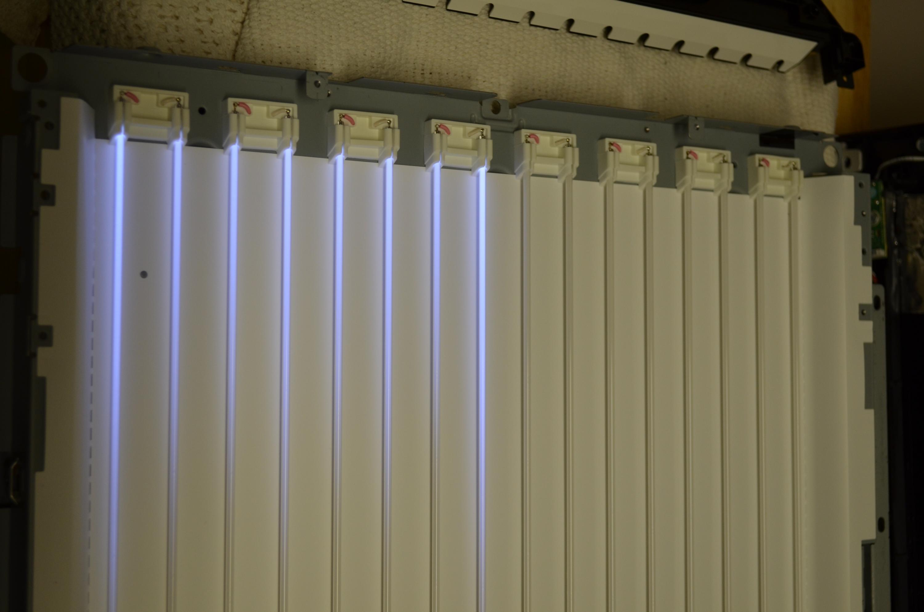

    When looking inside the panel with the lights on, it seemed like two or so light halfway. I'll work on getting some more images of behind the lcd panel today. I was also thinking maybe a shortage of power. The 24 volts might be good but at what wattage or current draw. .not sure i have the instruments to measure that.
    • stith
      • Oct 2012
      • 24
      • usa
      Re: Samsung LN32A550 Backlight Issue

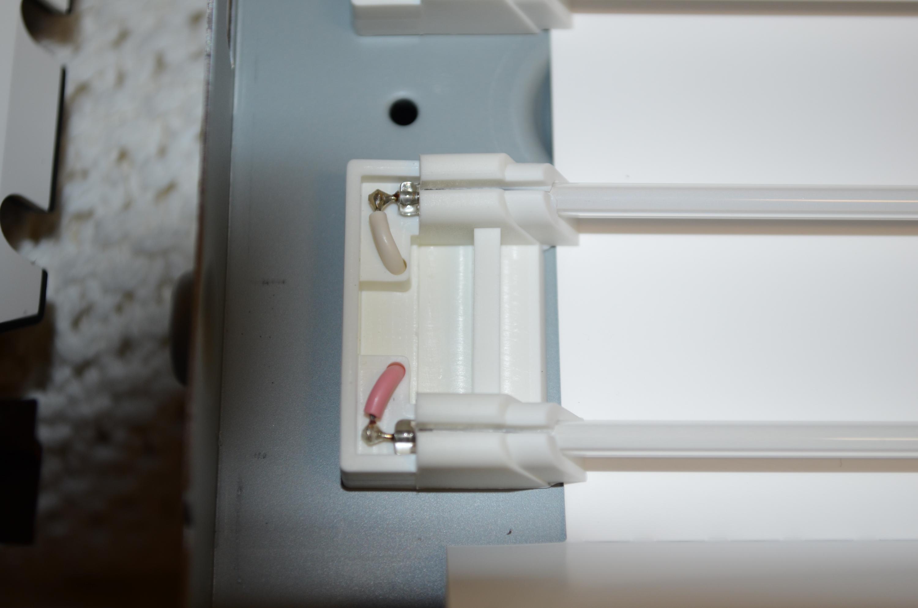

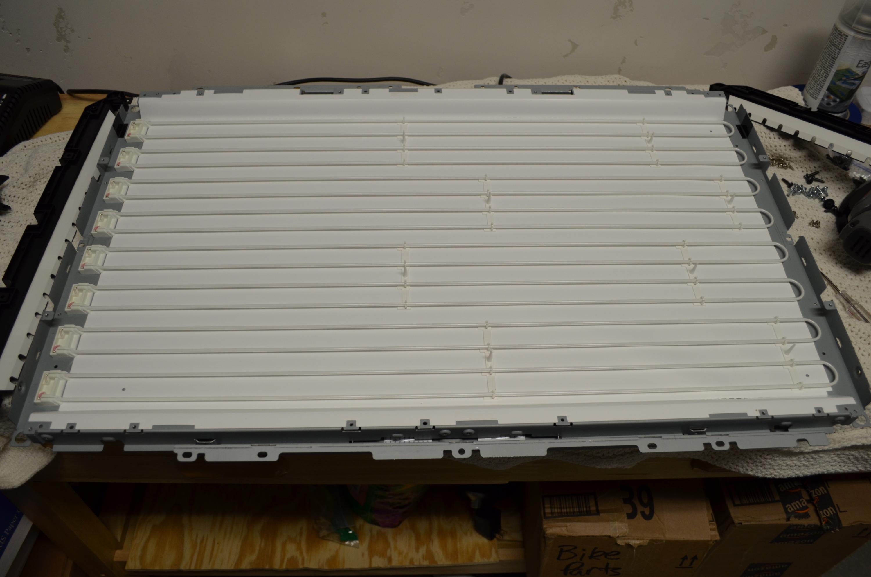

      More information! In the form of pictures...
      Also, no capacitors between lamps?

        just wondering, did you try to connect 1 at a time the ccfls on the inverter, do the ccfls light up this way ? it might be 1 ccfl that is bad that the inverter is struggling with..
        like, connect first, then try just the second one, then third.. check each of them
        • stith
          • Oct 2012
          • 24
          • usa
          This is what I just tried. Only the top 4 lamps would light. I also tried it with no lamps and the inverter board still made a static noise from near the middle top of the board.
            You could have a loose connection near there then - try reseating all lamp connectors, make sure they are secure, etc.
                  So what resistance reading on each pair of the Pink and White wires are you getting, I am expecting it to be around 3K or more since U-shape lamp will need really high voltage to drive than the straight lamp. And by the way, the lamps stay half way lit like that without going into shutdown?
                  • stith
                    • Oct 2012
                    • 24
                    • usa
                    #29
                    I have a basic meter for testing resistance. I was getting about 2.5k ohms on the connectors. Also the tv stays on as is with half the lamps half way on. I did a sniff test for burnt components and it checks out fine.

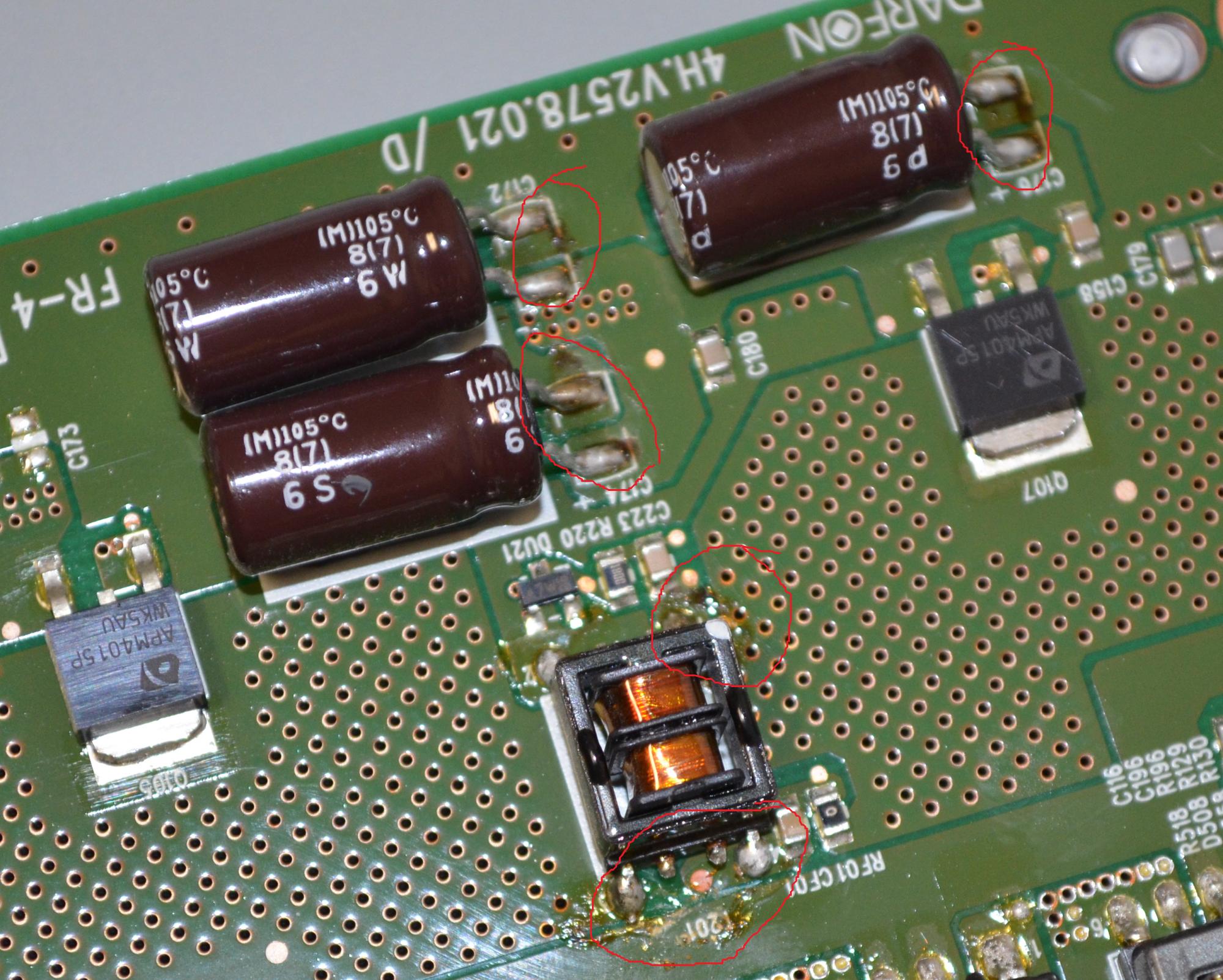

                                Sorry for the short hiatus. I tried the factory reset (the MUTE - 1 - 8 - 2 - PWR worked) but came back the same way it was already.
                                I can try measuring the FETs...
                                I don't have replacement capacitors to replace the 6 that are on top of the board so I don't think I'll do that just yet.
                                I just noticed these marks on my board. I circled them with red on the picture. Could this mean some of those components failed and damaged the board? Or is it just bad manufacturing...I'm really suspecting the inverter board to be the culprit here and I think I might just need to replace the whole thing.
                                  #36
                                  It looks like someone had replaced the transformer and the caps, they are solder flux.

                                    #37
                                    I had gotten this TV from newegg.com a few years ago. It wasn't a refurbished TV.
                                      #38
                                      More than likely, those caps and transformers are hand-retouched as they are not designed to be surface mounted by machine. But it makes me wonder how much additional cost that brings to say using SMD caps and transformers.

                                        #39
                                        darfon inverter.
                                        bad transformers.
                                        at least most are cheap and availible.

                                          #40
                                          I order a new board of the exact same manufacturer and number for $15.99. Should be here mid next week. See you all then.
