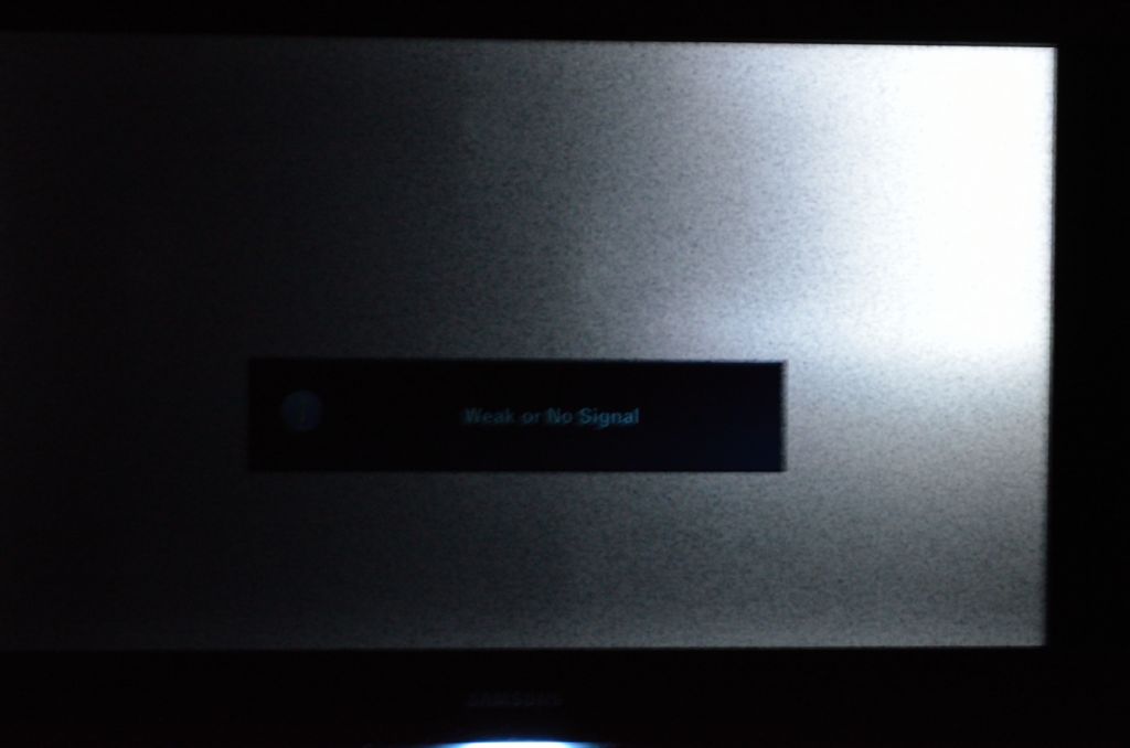

    Hello and first of all thanks for reading this post. My LN32A550 P3F Samsung TV is having a backlighting issue.
    I was getting ready to watch a movie through HDMI. Everything was good and so I left the room. I come back about 5 minutes later, the screen is nearly completely faded out. There was nothing I could do to get the backlights to come on (as if power save had came on) through the remote or turning the TV off and on again.
    What I noticed was, only the top right corner was being slightly lit by the backlights. Everything else was black but there was still a picture on the LCD (static when I selected antenna input).

      Re: Samsung LN32A550 Backlight Issue
      Here is an image of the screen. The camera takes a really long exposure and captures more light but the screen is not this bright. I can adjust the image to resemble how dark it really is. Also, I notice a high pitch squeal near that same corner on the back of the TV.
        Could you take a long exposure of just the CCFl tubes?
        If the tubes are blackened significantly more than others, that can be a sign of bad tubes.
        The picture makes it seem only the top portion are lighting half way. When bulbs light half way that usually means not enough power is there. (Im also assuming the exposure setting made it really bright at the edge or side too).

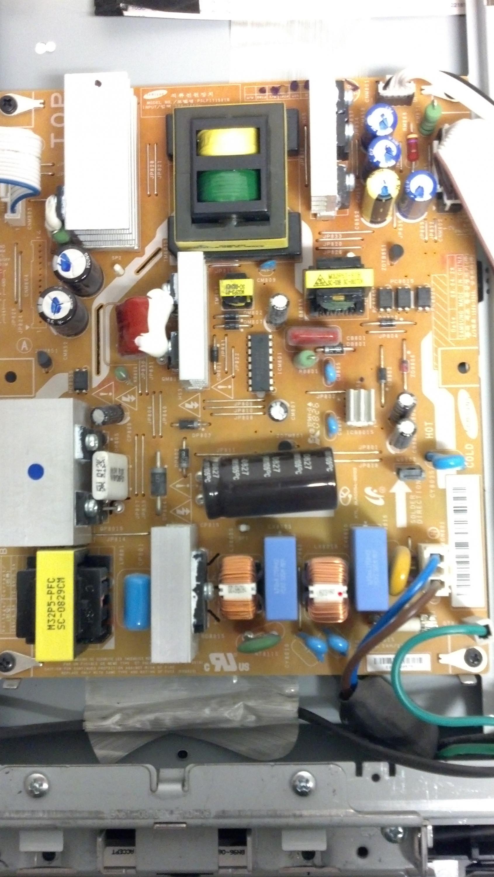

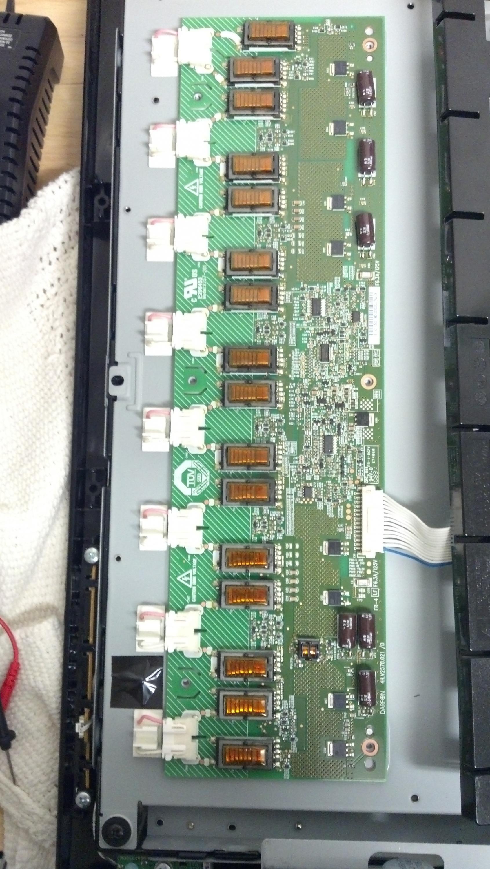

          Can you post good clear pictures of the boards? There are more than one version/manufacturer of the same model.
          drpj23 may be correct about the power supply may not be supplying full voltage to the inverter board.
          The power supply has PFC Voltage booster, it may not be working.
            Here are pictures of the two boards. If you need better pictures or zooms of portions of the board let me know and I can do that. I can work on getting a shot of the CCFLs only but it's a bit harder to get all the screens off and not damage them (that's more of a personal defect of mine that I like to destroy objects when taking them apart).
            If it could be the power supply, what should I test? I tested the volt at the connector to the inverter board and it came out to 24volts. Let me know what you think. Oddly, I might believe its either one of the two boards if anything.
            Thanks for the quick help guys!

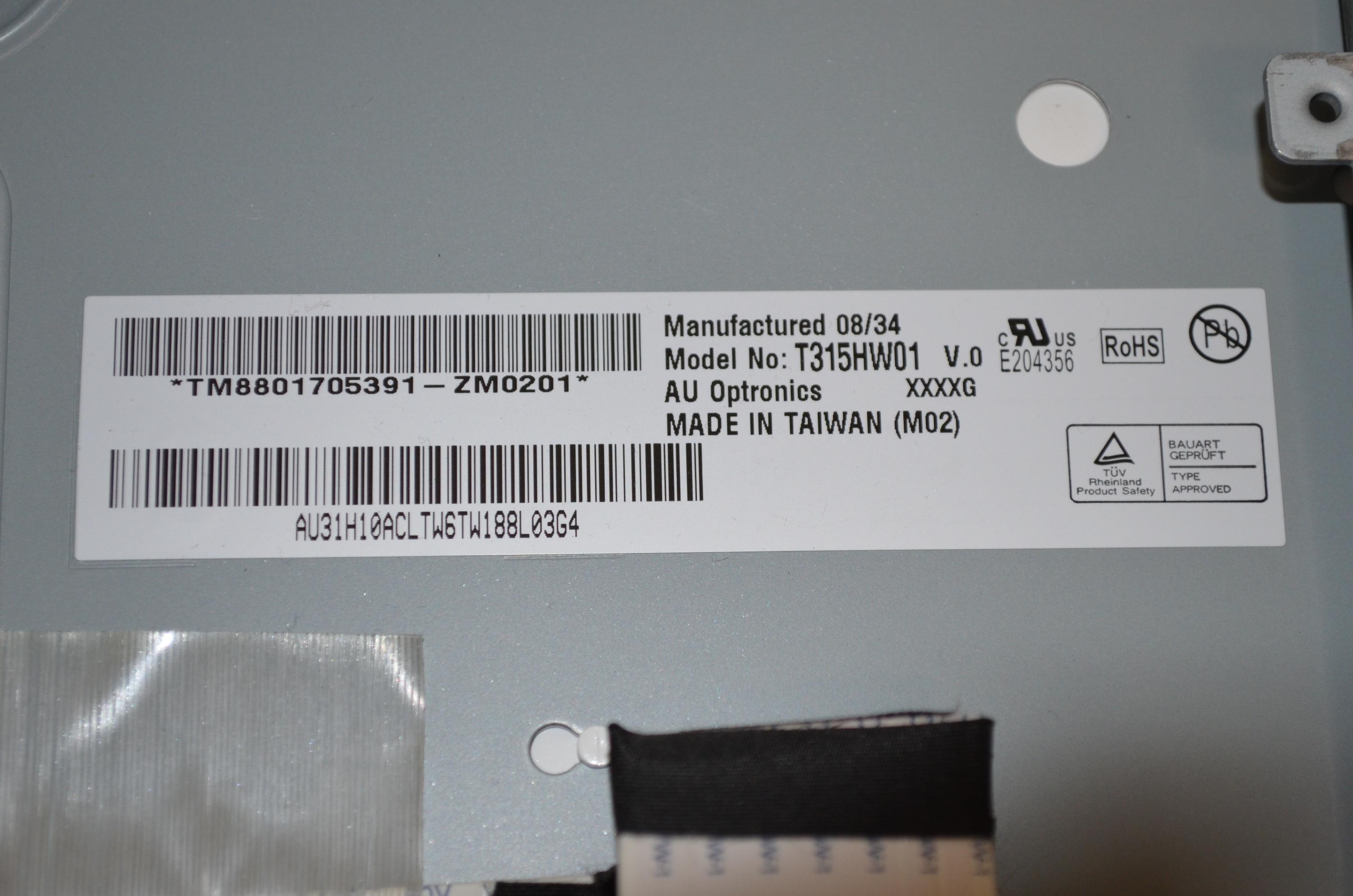

              OK, the 24V is OK then. Can I get the LCD panel number so I can look up the spec to see if the lamps inside are U shape or straight type since I do not see any lamp return wires back to the inverter board. I also do not see any ballast caps on the inverter board, that mean they are inside the panel assembly.
                  I am not so sure how your lamps are setup inside your panel yet, that is why I need the spec to see, as you can see in the attached PDF of the two type of lamp setup: Straight and U-Shape setup. I still do not see any ballast caps any where on the inverter board or they may inside the PCB connected to the lamps.
                  http://s807.photobucket.com/albums/y...nt%20FLX-3210/
                  I need the panel number as printed on the sticker on the panel itself.

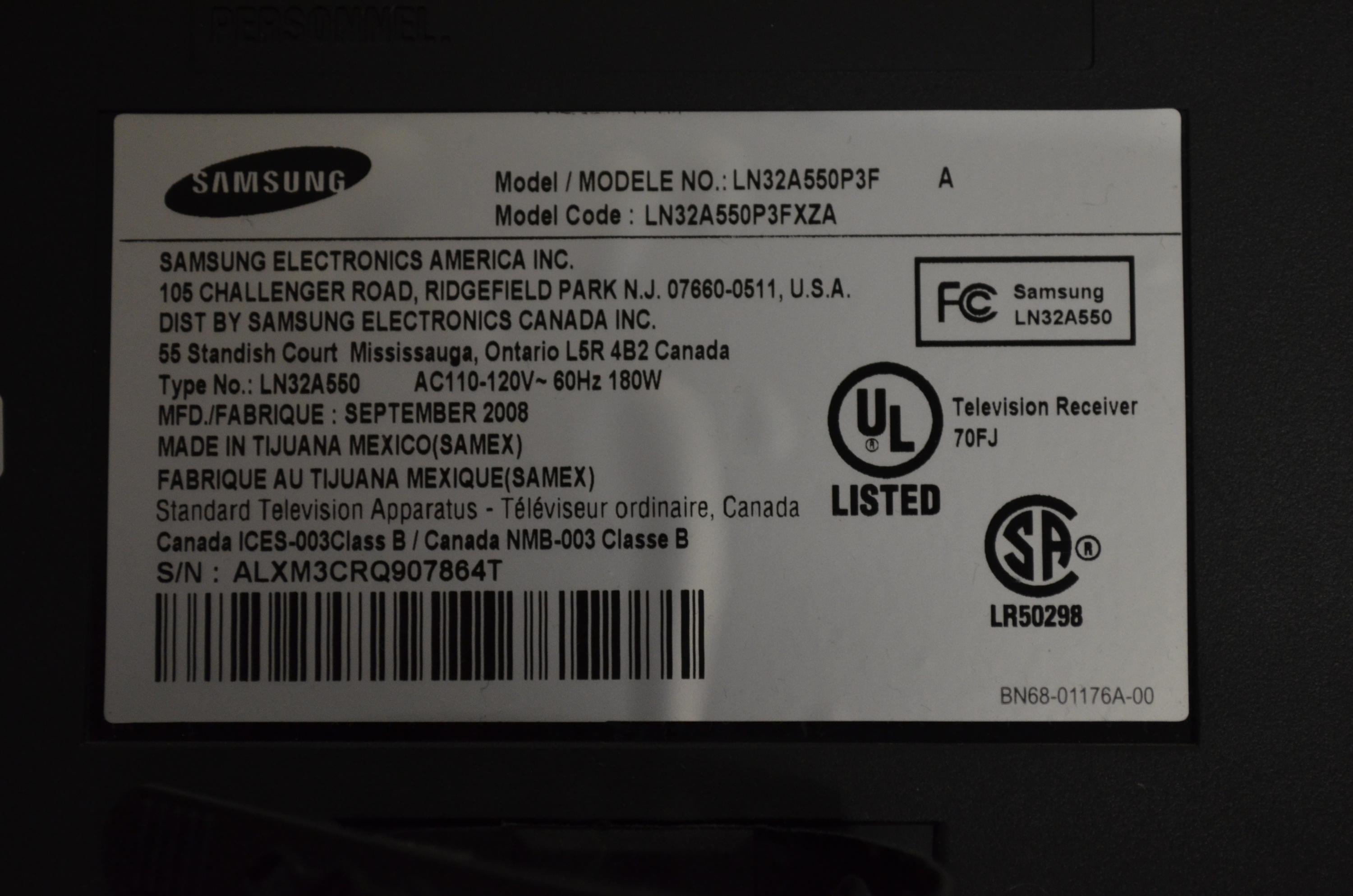

                    I understand now. Here is a pic of the label.
                      Sorry, we need the sticker on the LCD panel, not the sticker for the model of the TV.

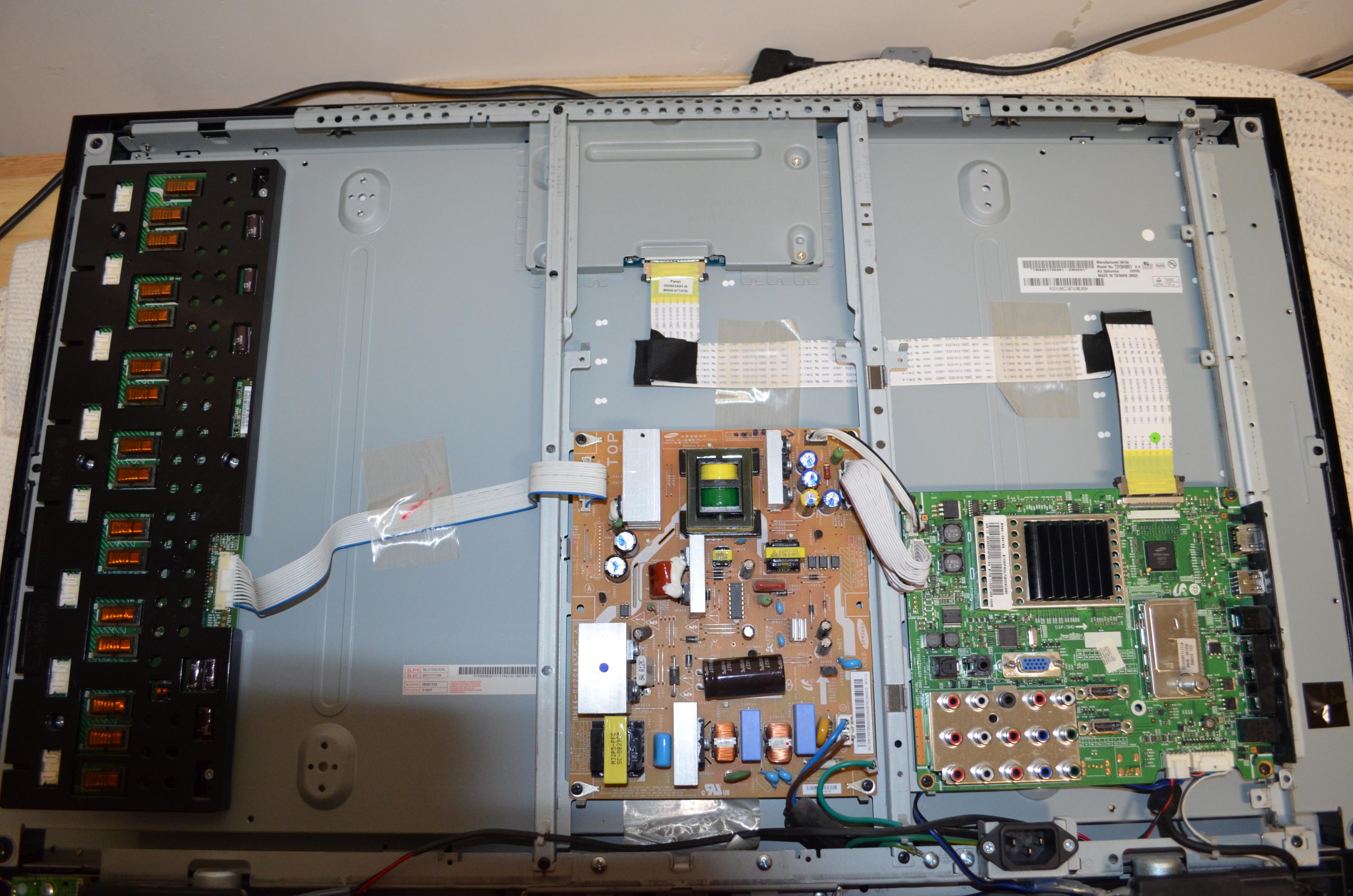

                          On the back of the LCD panel. Can you post the pictures of the whole backside of the TV so we can see all the board.
                          Example: http://s807.photobucket.com/albums/y...t=DSC02776.jpg
                            OK I think this will help. Thanks again for your quick help!
                              OK, let me Google it and see if the info is out there for this panel.
                              AU Opto T315HW01 Version 0.
                              Funny how Samsung does not use its own panel in its TV, but use the cheaper one by other manufacturer instead in their low end model.
                                Interesting information. But I'm not 100% sure what I should do with this or the next step of testing to do.
                                  Well, it does not show the lamps info.
