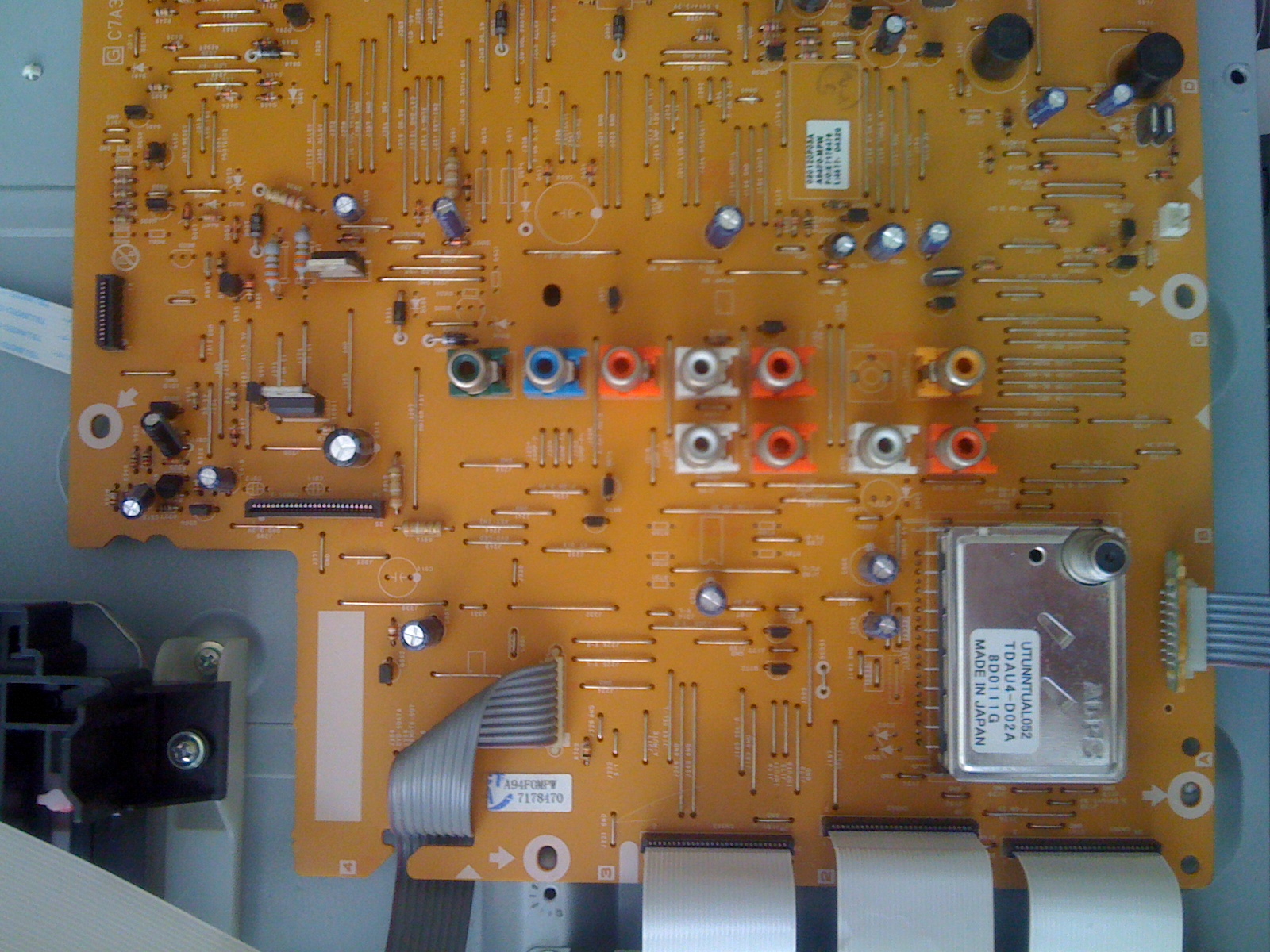

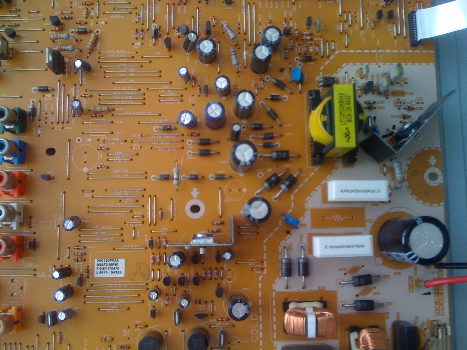

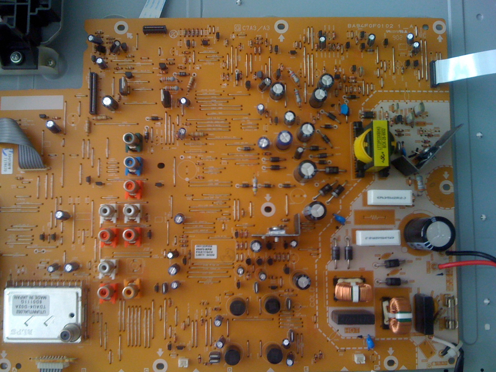

    Re: Magnavox 32md359b/f7 White Screen and with sound only

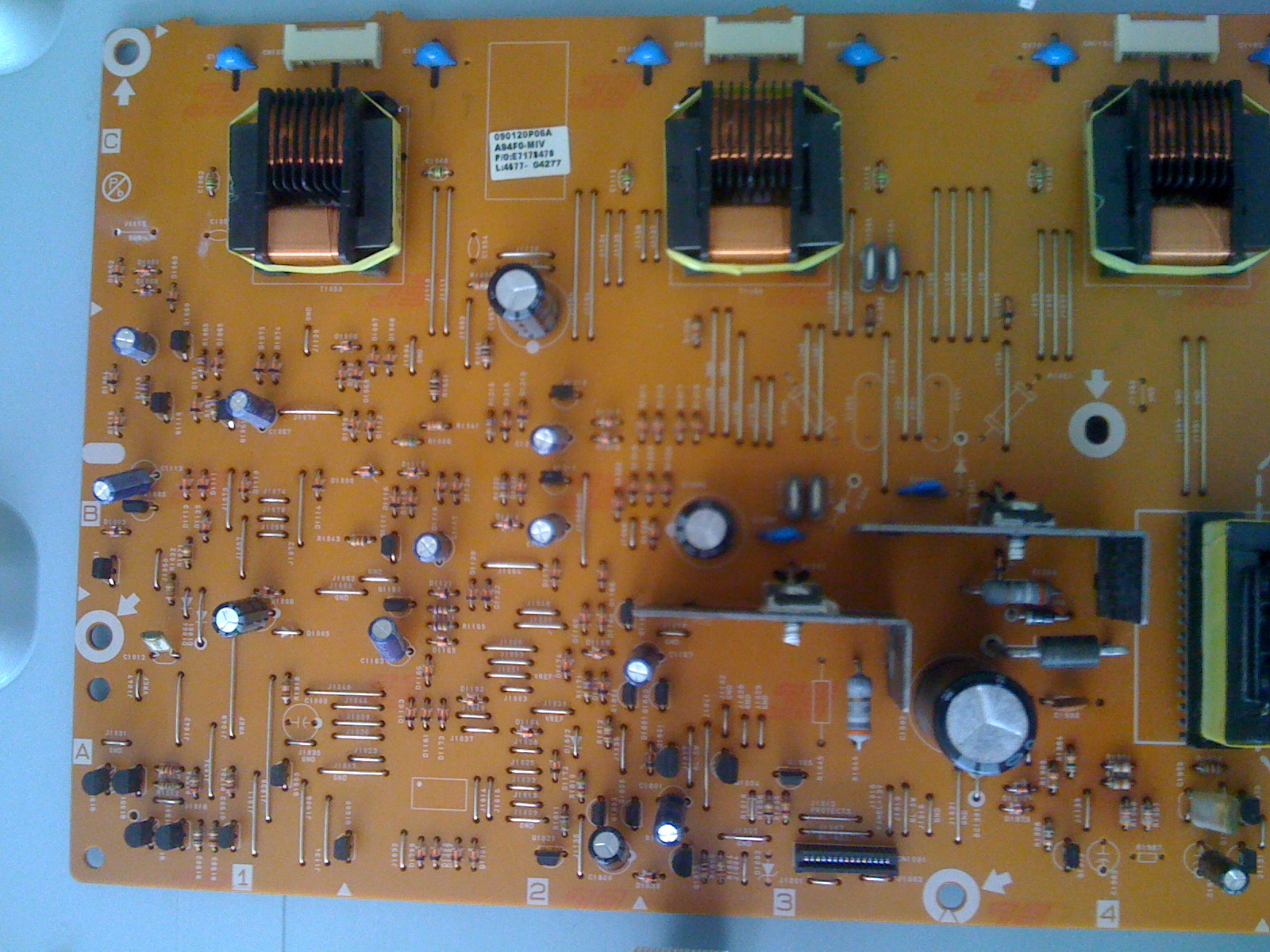

    Have you checked all the connectors to make sure nothing became loose? Can you post a picture of the entire back of the tv so we can see what boards are in your set?
      Here are the pictures that I have taken, Thanks very much for your reply Mr. Bill

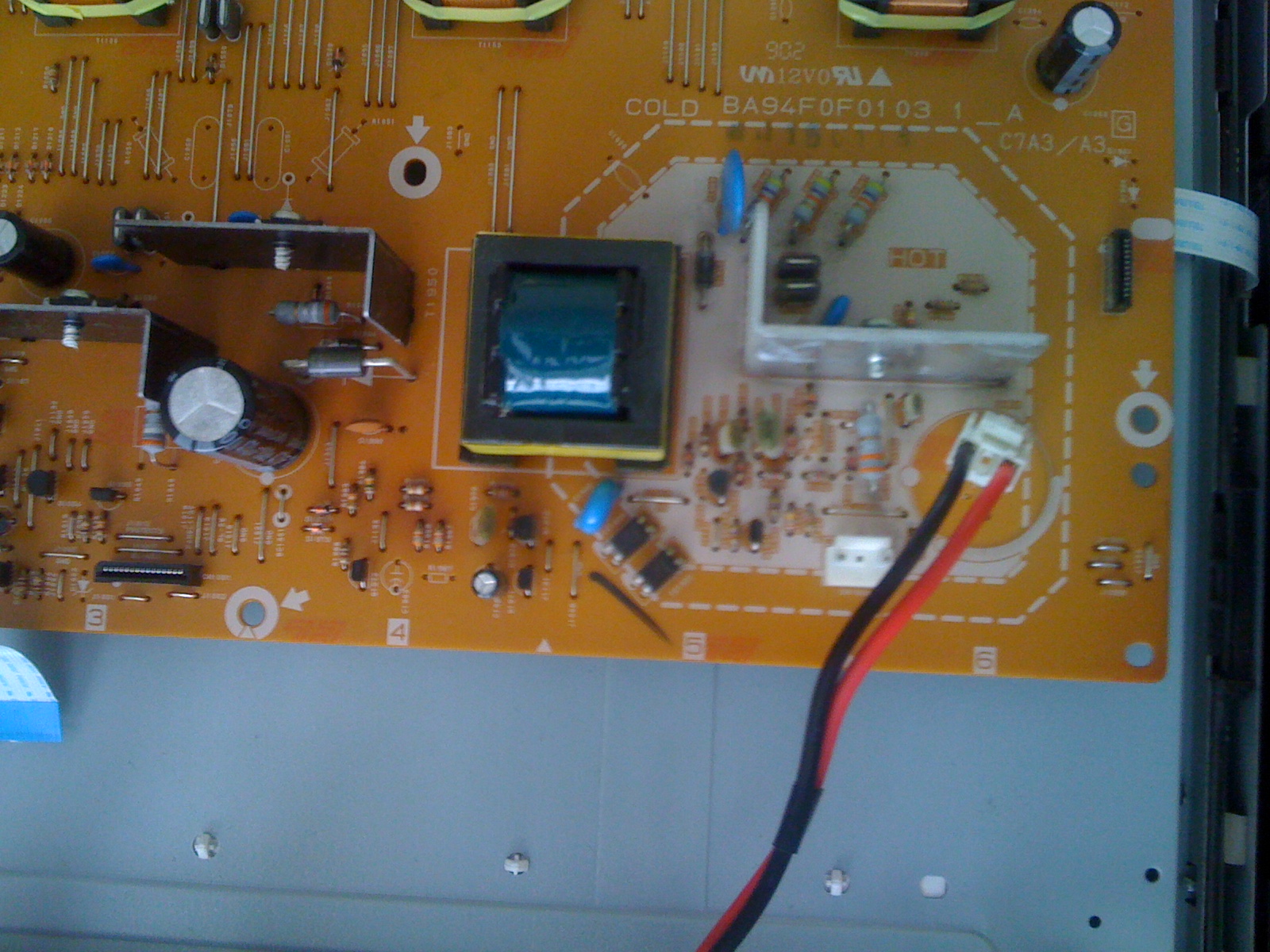

        On Jpg 049 I have taken the Capacitor off to test it but reading is ok, but kind of weird question even when I took it off the television still did the same thing. You can see where the cap is missing under the pos/neg wire on middle pic
                OK, this means the T-con board, main board and most of the PSU is working. Your inverter, or the part of the PSU which powers the inverter, is the likely culprit.
                Try this - Close the curtains, or take the TV into a very dark room. Turn it on. Do you see a brief flicker or flash from the screen, or does it remain dark? It could be VERY brief...

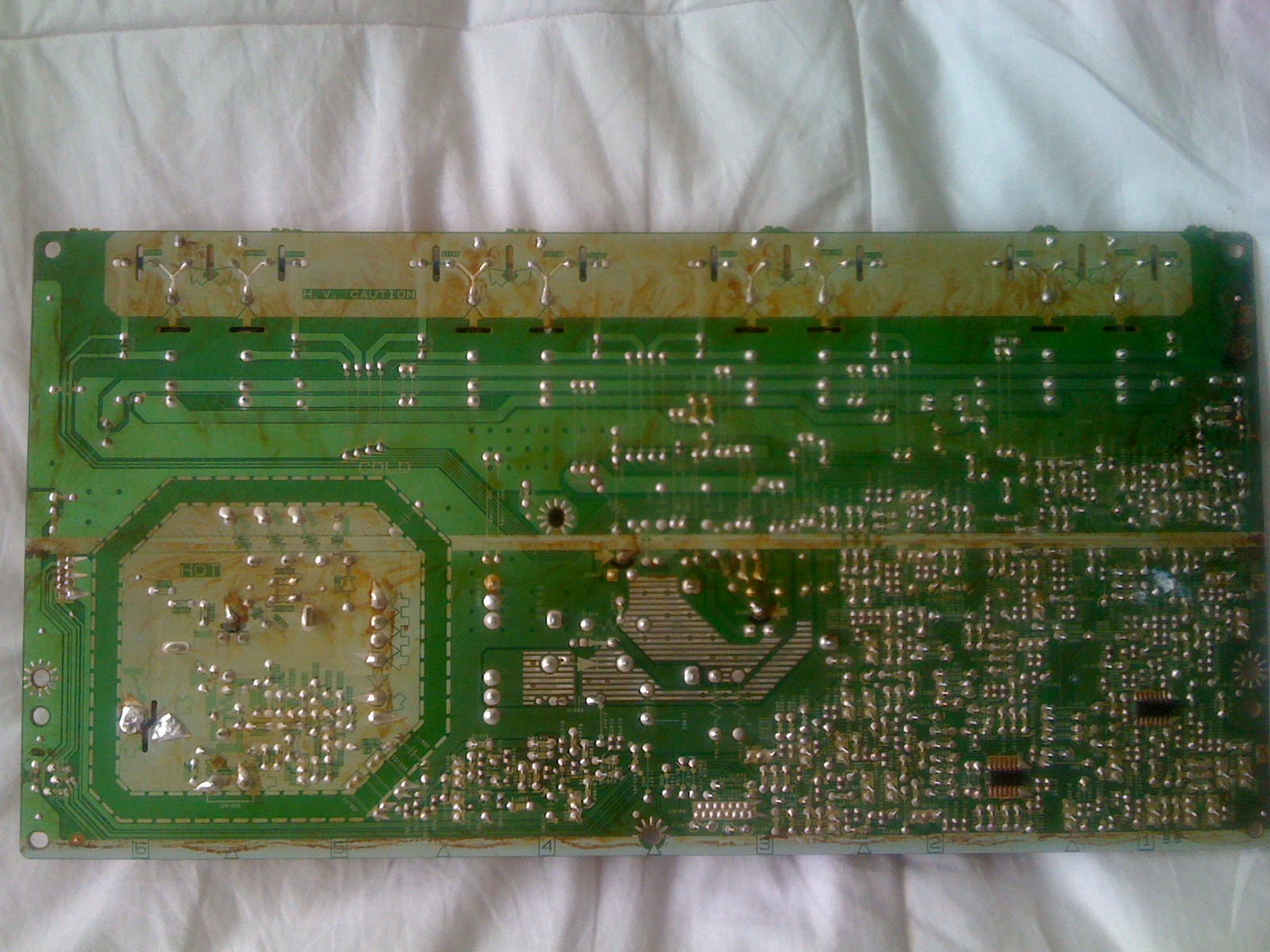

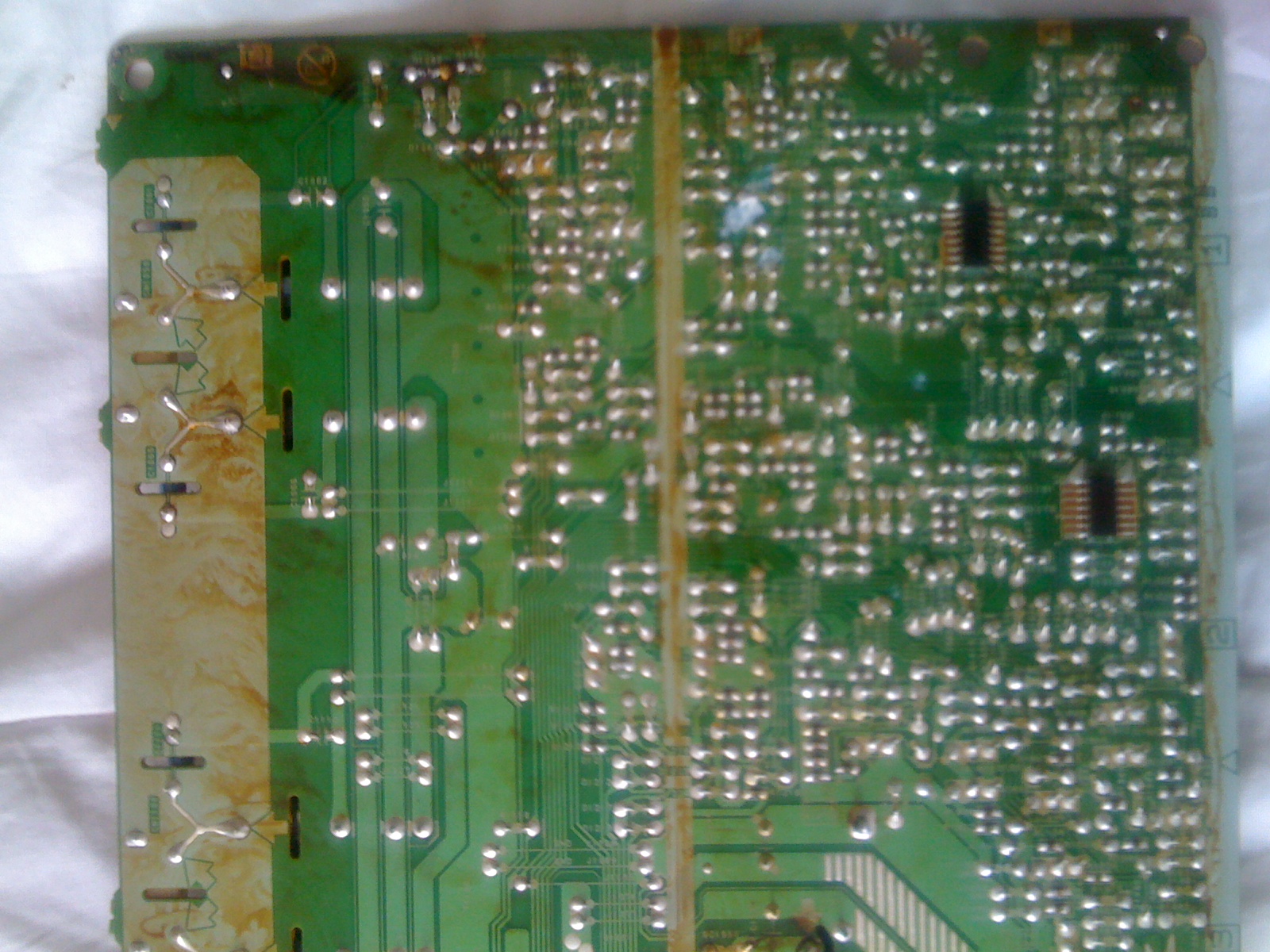

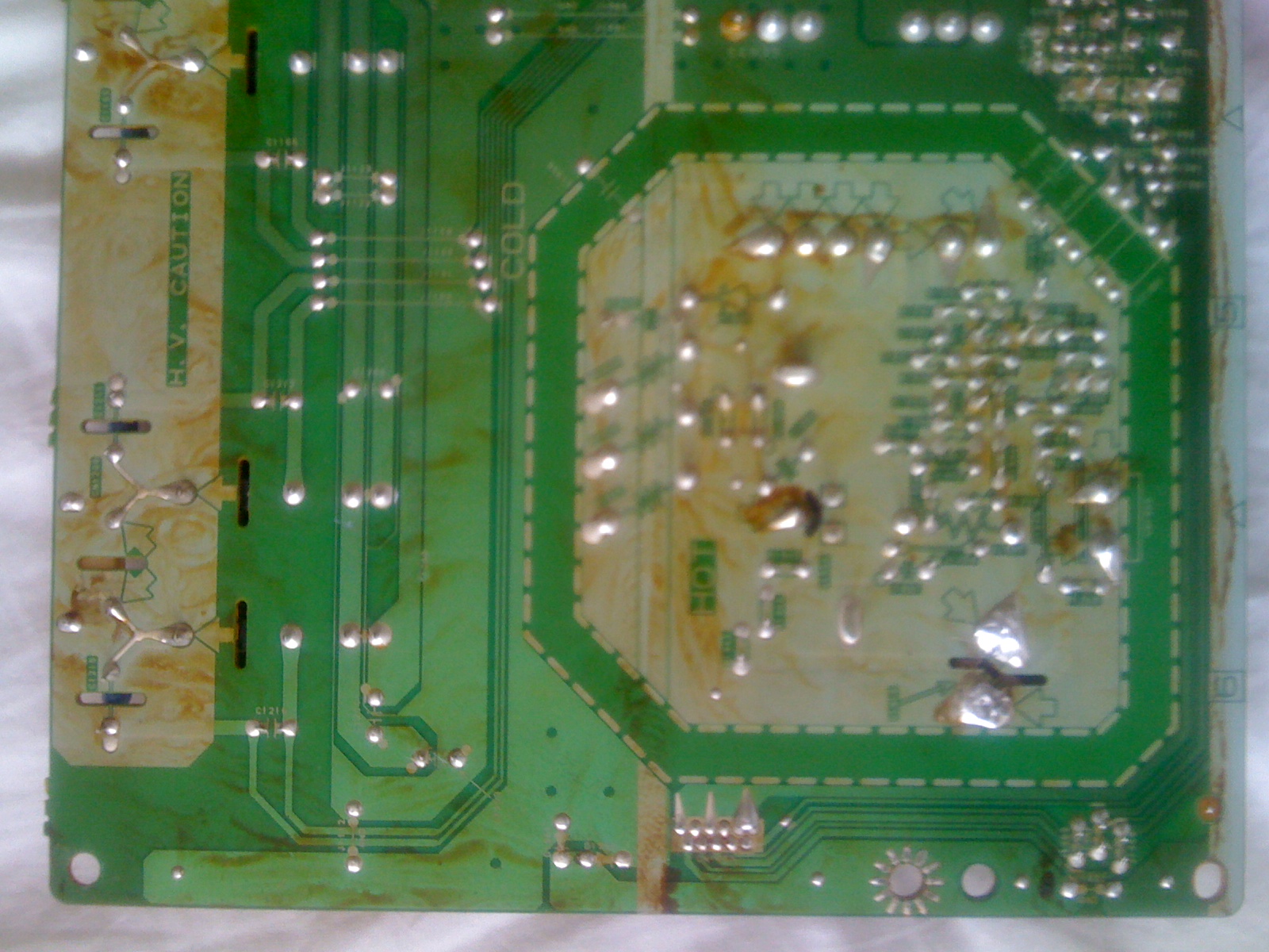

                        OK, so it is known as "2 seconds to black". This points usually to an inverter transformer failing, or bad CCFL, or bad coupling caps.
                        Can we have a picture of the back of this board.
                        https://www.badcaps.net/forum/attach...7&d=1348160962
                          I posted pictures above, are those what you need or do you mean other side of board without resistors, caps etc...
                          • YEROC37
                            • Sep 2012
                            • 119
                            oh I see what you mean LOL>..duh my bad lol
                            • YEROC37
                              • Sep 2012
                              • 119
                              Here are the pictures of the back...
                                If you have a multimeter check the resistance at the ccfl connector on that board. If one is bad the reading will be different than the other 4. Post your results and post a part number thats printed on the side of the transformers.
                                        Set your meter to 20000 ohms or 20 kohms. The ohms symbol looks like a horse shoe.
                                        Remove the board from the TV.
                                        Test across the marked points, using the numbers in the image.
                                        You should get four measurements that are within +/-3% of each other. For example 1030, 1000, 970, 1000, if all transformers are OK.
                                        But if one is bad, it will measure significantly higher or lower than the rest. It could even measure infinite, which will appear the same as holding the probes on your meter apart (usually a single "1".)
