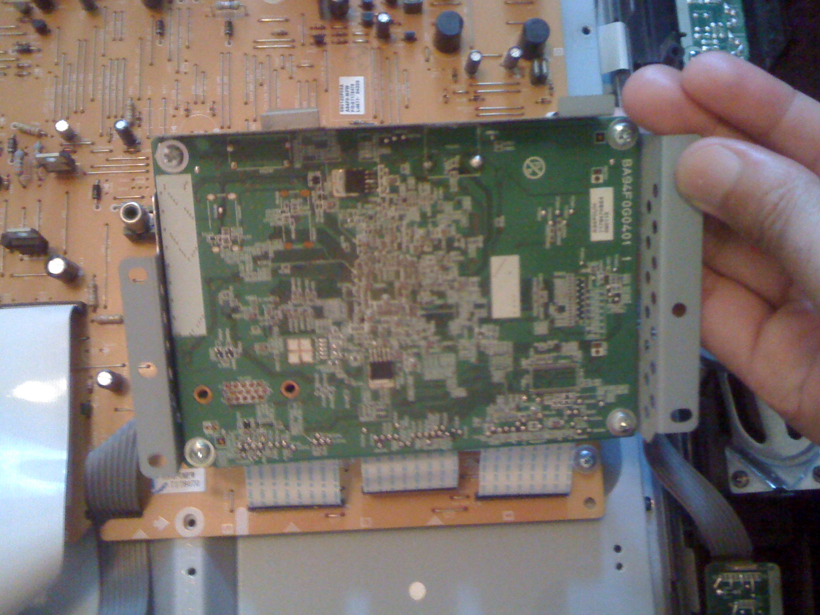

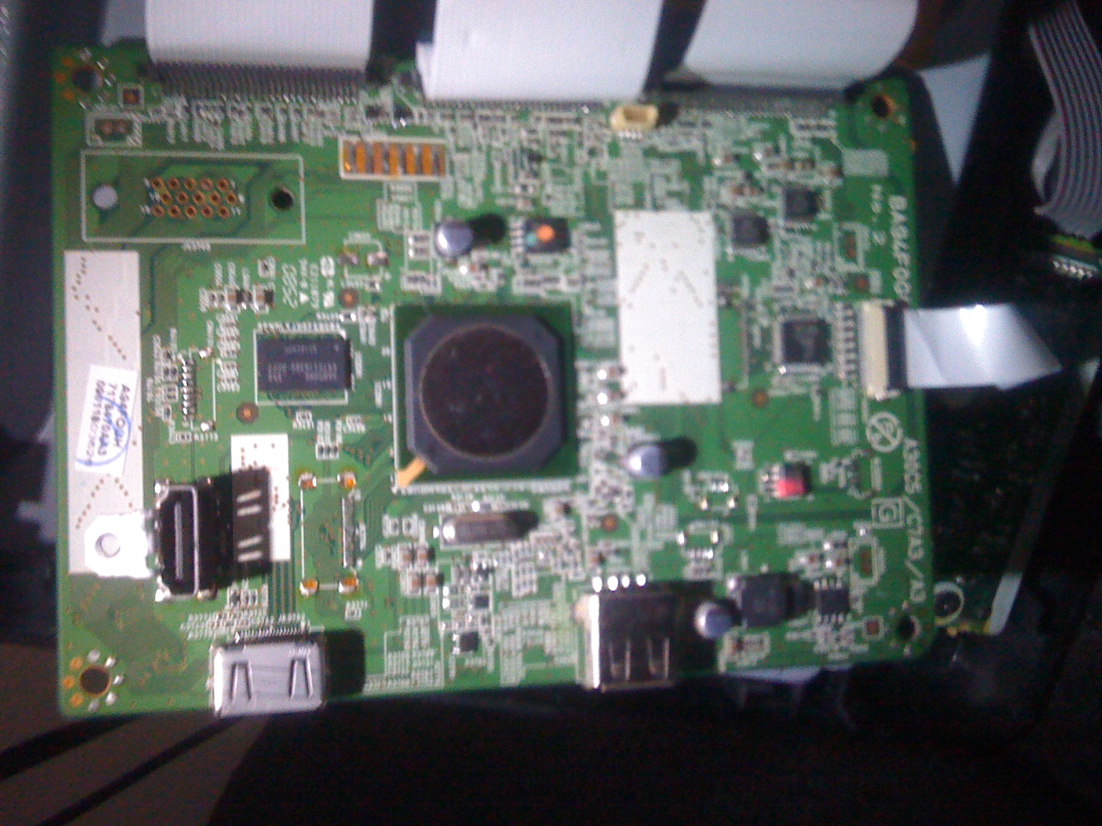

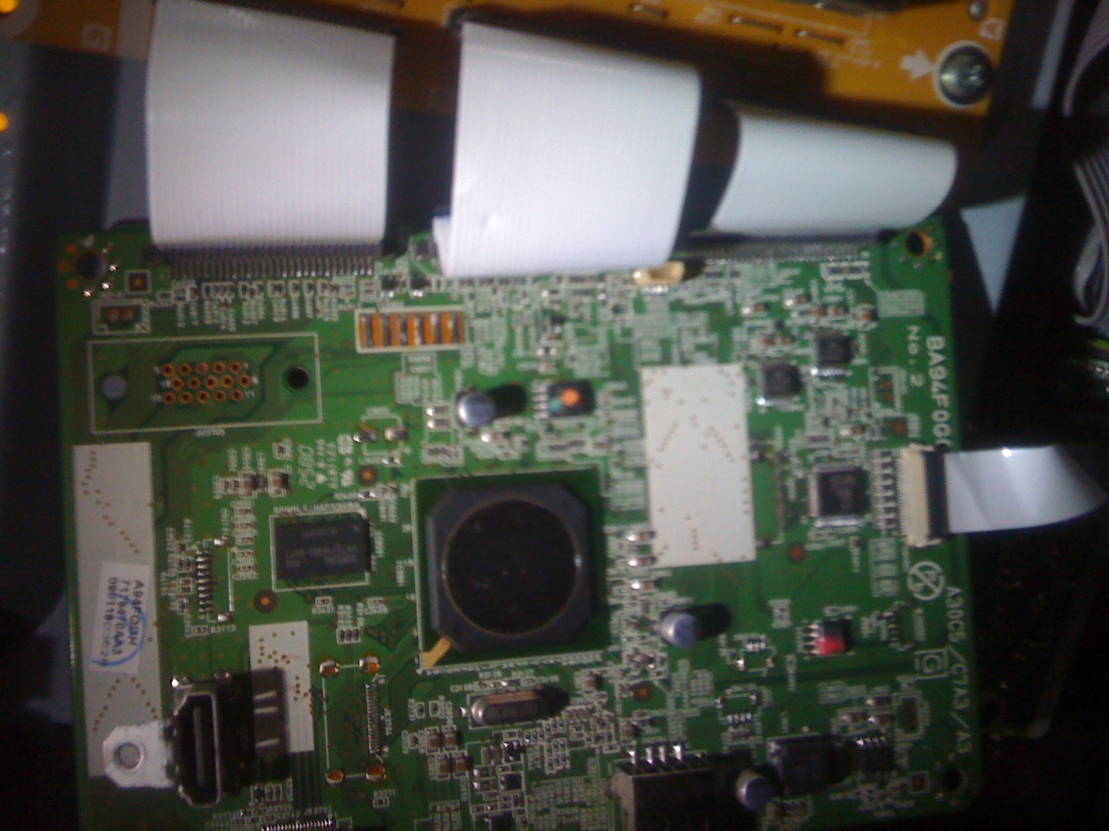

                  Can you post a picture of your small signal board. It'll be the one with HDMI on it, usually green in colour.
                  • YEROC37
                    • Sep 2012
                    • 119

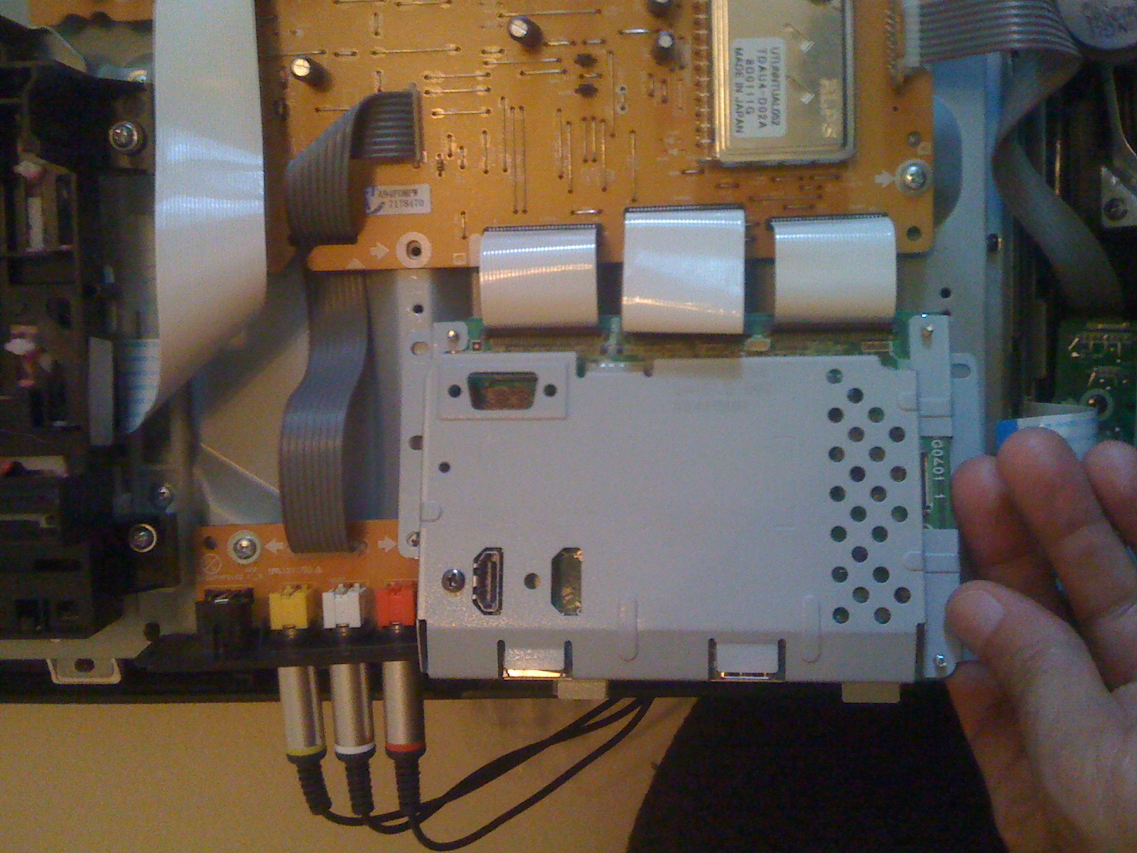

                    #109
                    Re: Magnavox 32md359b/f7 White Screen and with sound only
                    Pictures of HDMI board
                      #110

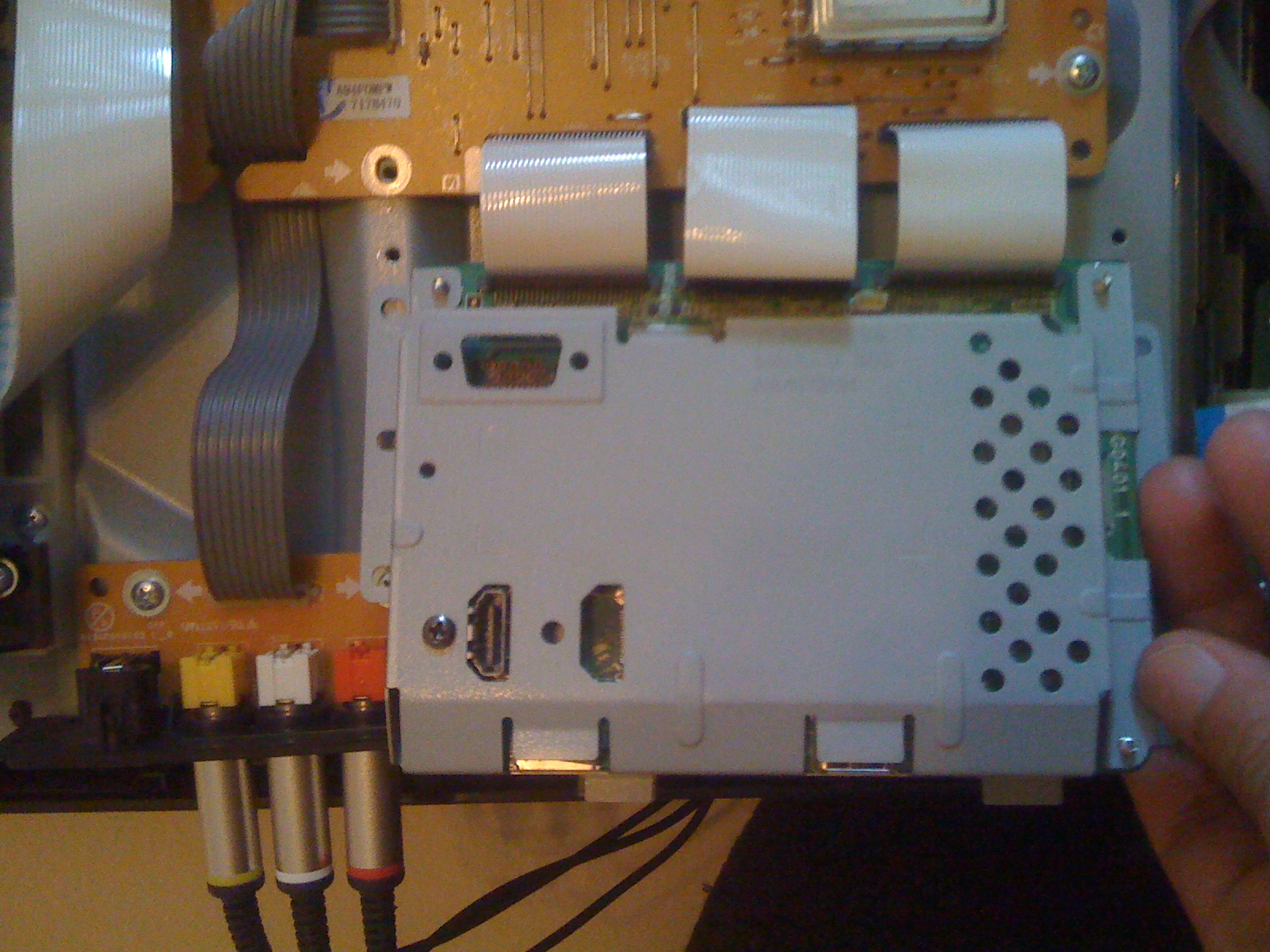

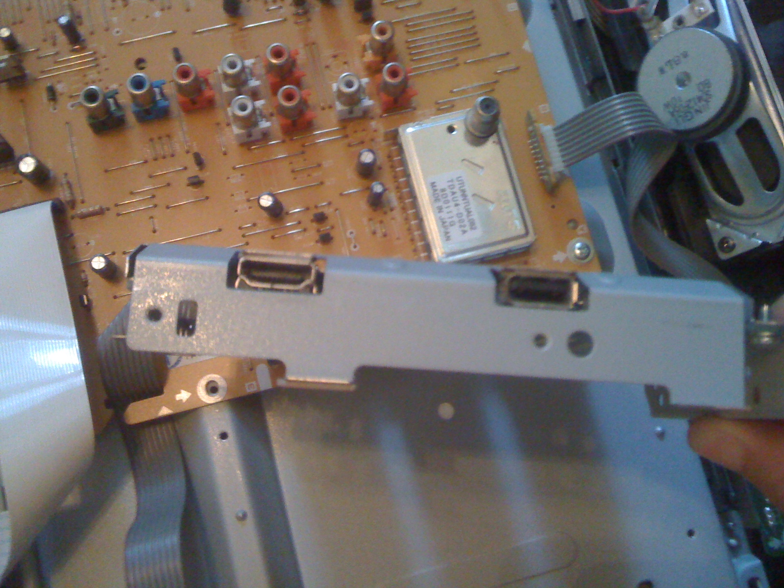

                      Is there an obvious way to remove that metal shield without damaging the signal board?
                      • YEROC37
                        • Sep 2012
                        • 119
                        #111
                        Yes moving now
                        • YEROC37
                          • Sep 2012
                          • 119
                          #112
                          Here ya go tom
                          • YEROC37
                            • Sep 2012
                            • 119
                            #113
                            so this board could eliminate the picture from showing?
                              #114

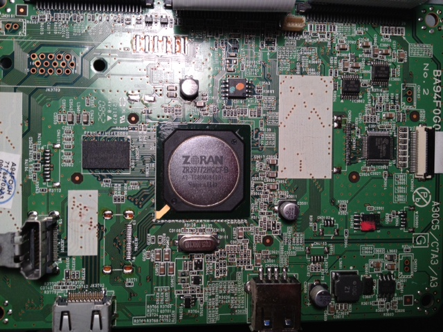

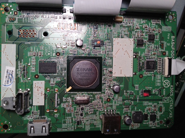

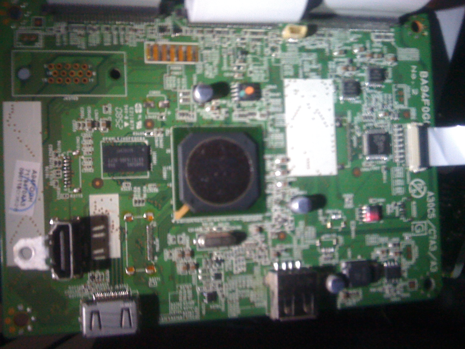

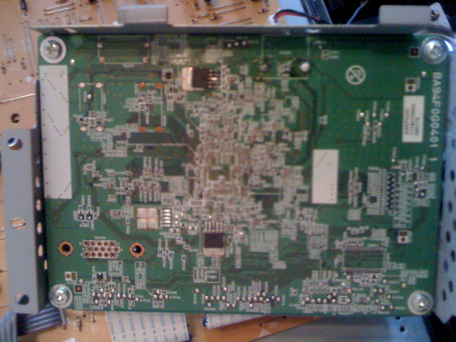

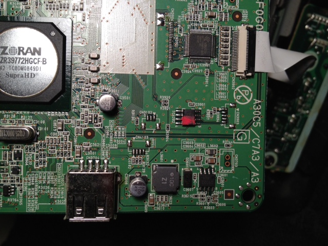

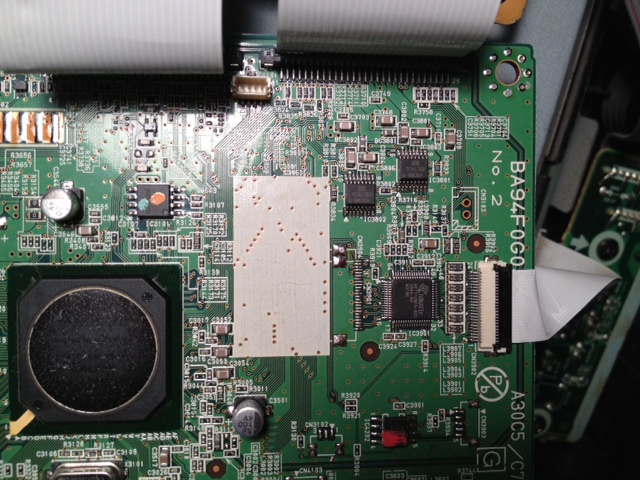

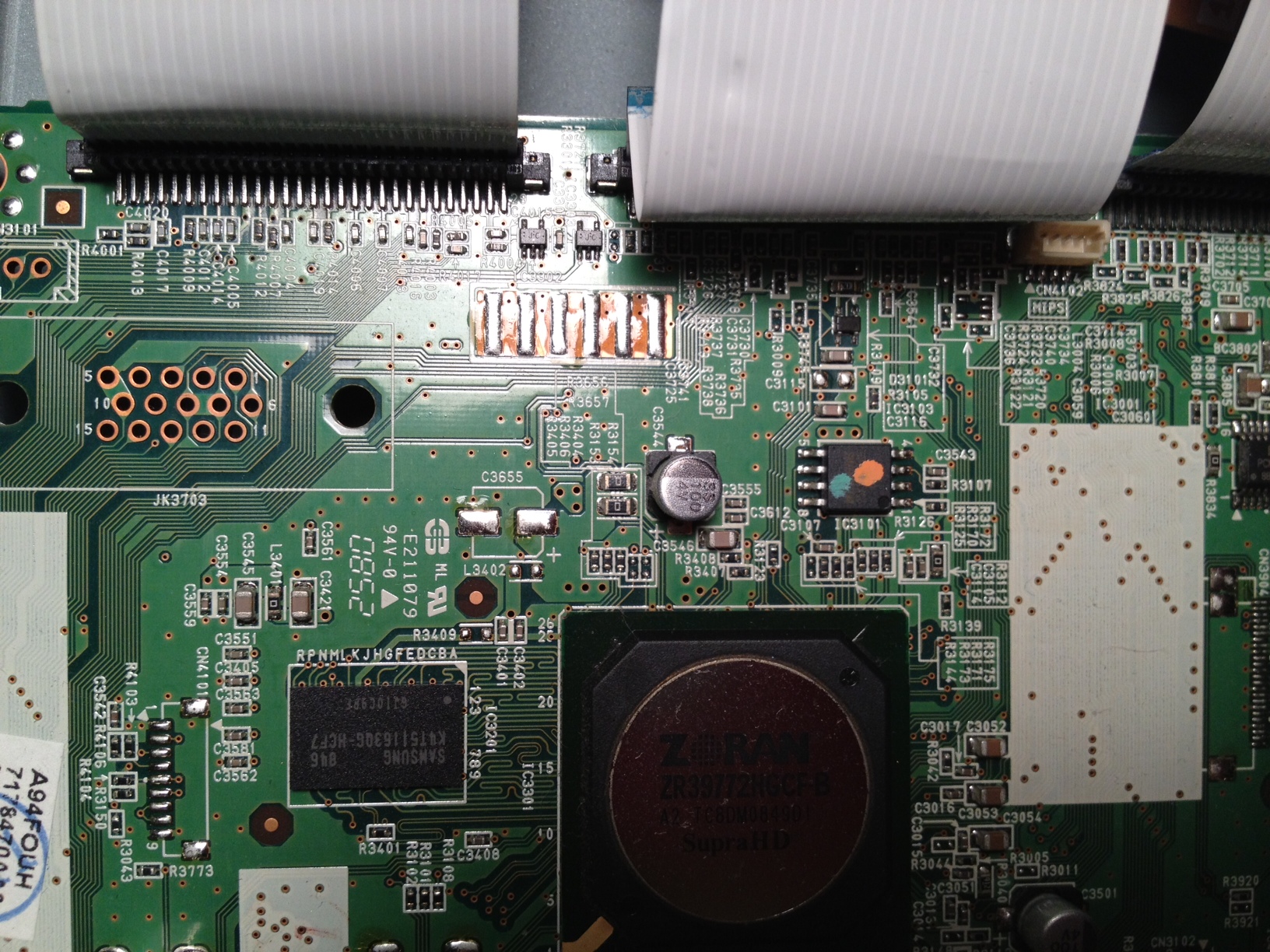

                              I'm sorry those pictures are really too blurry for me to highlight much. Is there any way to make them a little better? Perhaps using sunlight would work. I'm trying to see tiny things like SMD fuses and marked test points.
                              The white or black screen, with lit backlights, is a common issue with all TVs. Generally that board would attach to a separate t-con board and the t-con board commonly fails. Looks like they have integrated the two on this chassis making it a little harder to diagnose but it's either there, or in the power supply feeding that... the inverter is fine, I was totally heading down the wrong direction, I'm still suspicious of your meter though.

                                #115
                                I heard somethings about using a heat gun or adding heat to certain system boards because solder or sometimes just getting joints to resit, I've done this trick on game systems that overheat...Am I way off
                                  #116
                                  It could be a good test. We have seen several TVs here with similar issues to the Xbox 360 and PS3 regarding main chip BGA solder joints, mostly Samsung TVs though. And I don't like Samsung TVs for a good reason...
                                      sending clearer pictures now
                                      • YEROC37
                                        • Sep 2012
                                        • 119
                                        #119
                                        We have no sunlight here, you must be on west coast, let me know if this is ok
                                          #120
                                          Much better. Thank you. Is there any way to get them a little bigger? Aside from that, they are great. The size of the 4th pic is a good size.
