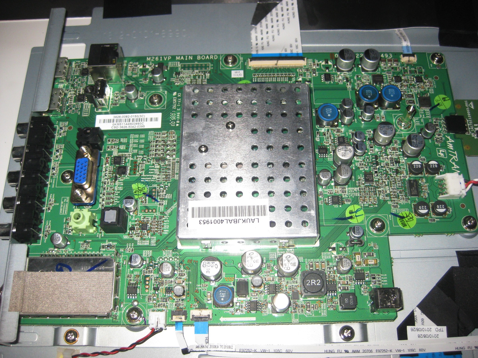

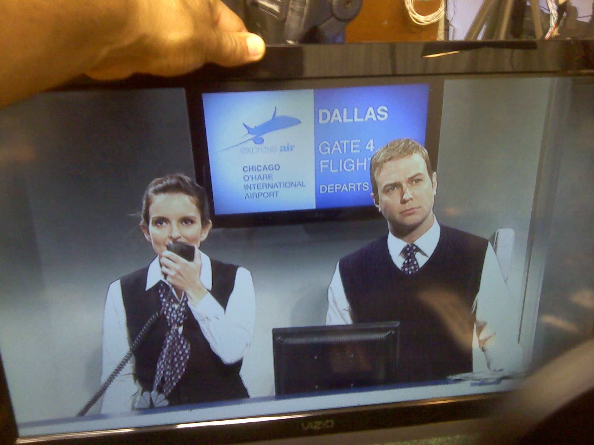

    A friend of mine brought me this TV, saying it wont display anything on the screen. Rightly enough, when i turn it on, i get nothing, no flash of light, no OSD menus. The only thing i did notice is that the power light blinks on and off for around 30 seconds and then stays off. Does anyone have access to a service manual for this model ? Before i look deeper into the PCB im just wondering if this is a known defect, firmware update etc. might save me some time.
    I took a quick look inside for any obvious visual flaws on the PCB, but nothing stands out, all caps are flush, no residue or marks around the base of any components.
    This is the PCB part. Seems as though everything is combined into this one board.
    http://www.shopjimmy.com/vizo-3626-0...for-m261vp.htm
    Thanks in advance, any help is appreciated.

    Re: Vizio M261VP blinking power light.
    Well, that's the main board. There should be a power board as well. You want to check the caps and the output voltages of that power board. Posting a picture here would help others help you with this problem as well.
      This is the mainboard and the power board. The DC input is visible at the bottom right section of the PCB. :/
        If you connect a source and flick through inputs can you hear audio?
          There should be another small board for the LED backlights (it may be part of T-CON). Can we see the pictures of the whole back side of the TV?
            Is the power supply working ok giving correct voltage under load?
              We really need a good clear picture of YOUR boards
              please post good clear pictures of the whole chassis, and then pictures of each board, front and back and close up of connectors, (max resolution 2000x2000 and 2MB) using the manage attachments button, which is found by clicking "go advanced" under quick reply.
                    I emailed tech support at Vizio. they suggested I unplug it and hold the power button for 30 seconds. Doing this, it came back to life - sort of.
                    the sound is back, the controls work, change channels, adjust volume, etc. It has no picture. At a sharp angle, you can see the image is there but has no back lighting.
                    That's where I am so far.
