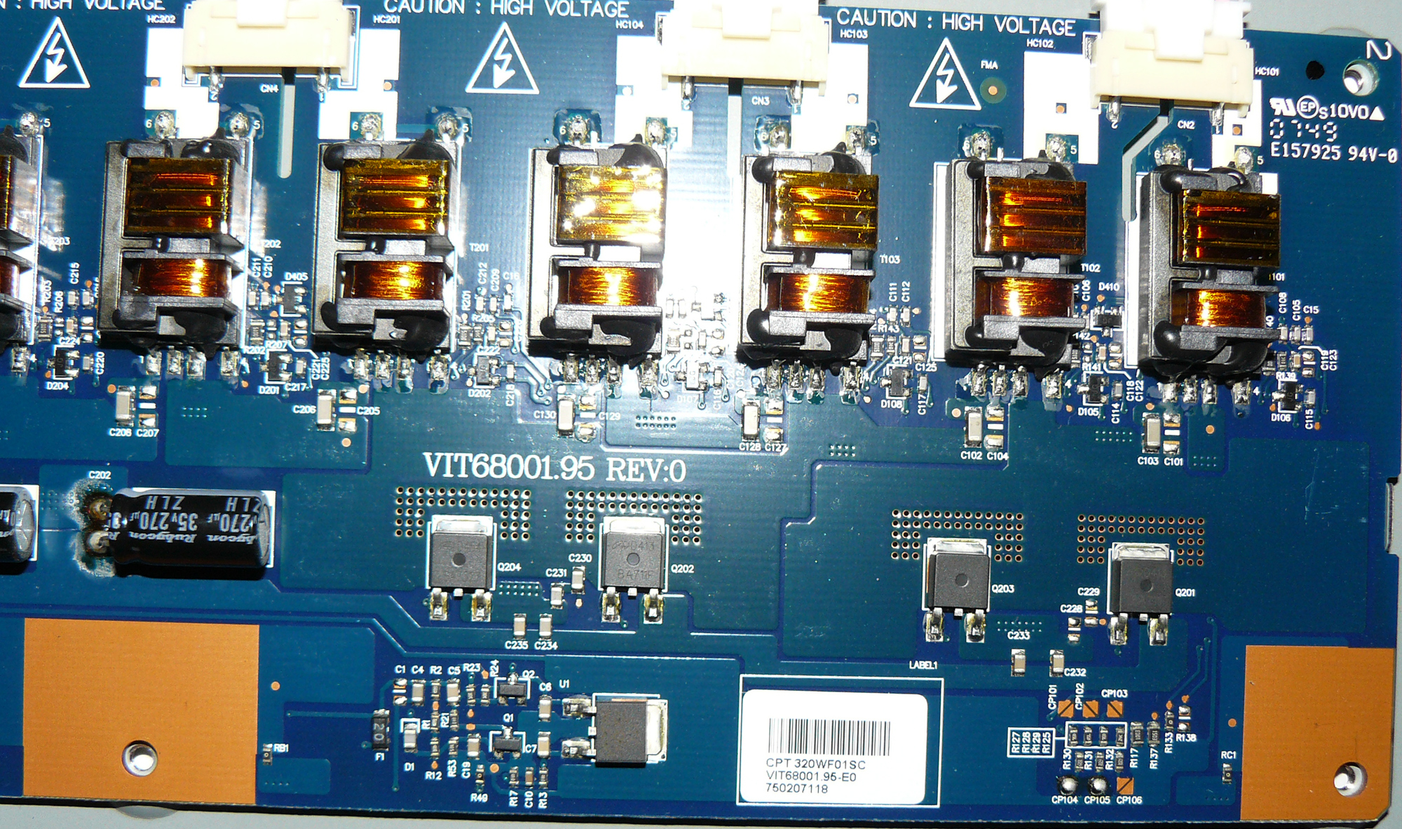

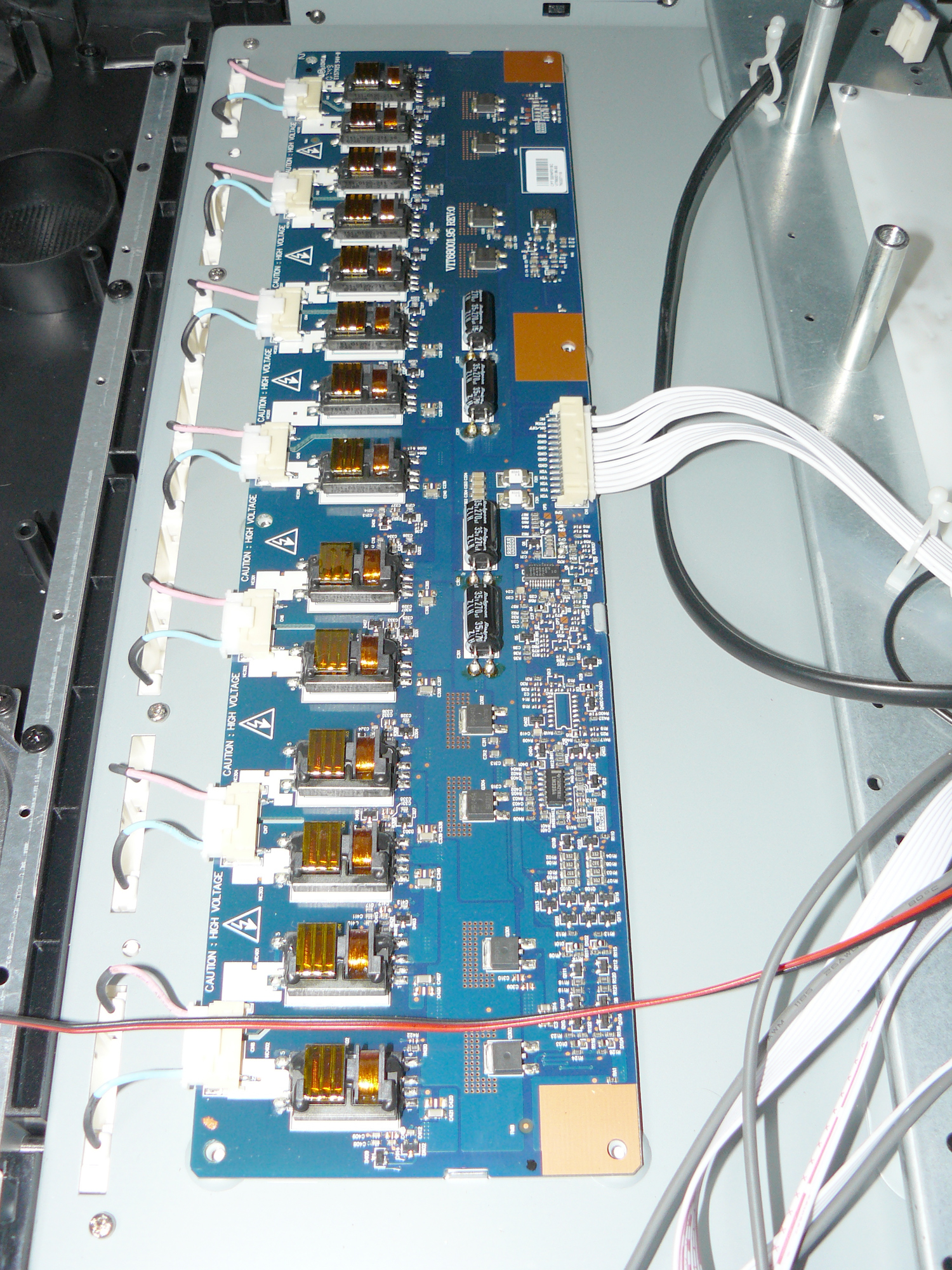

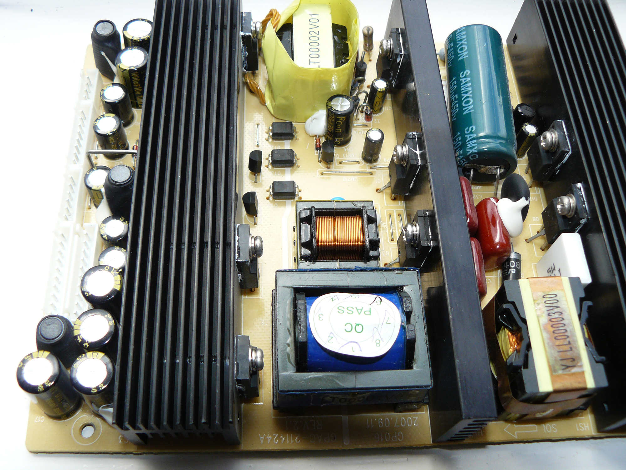

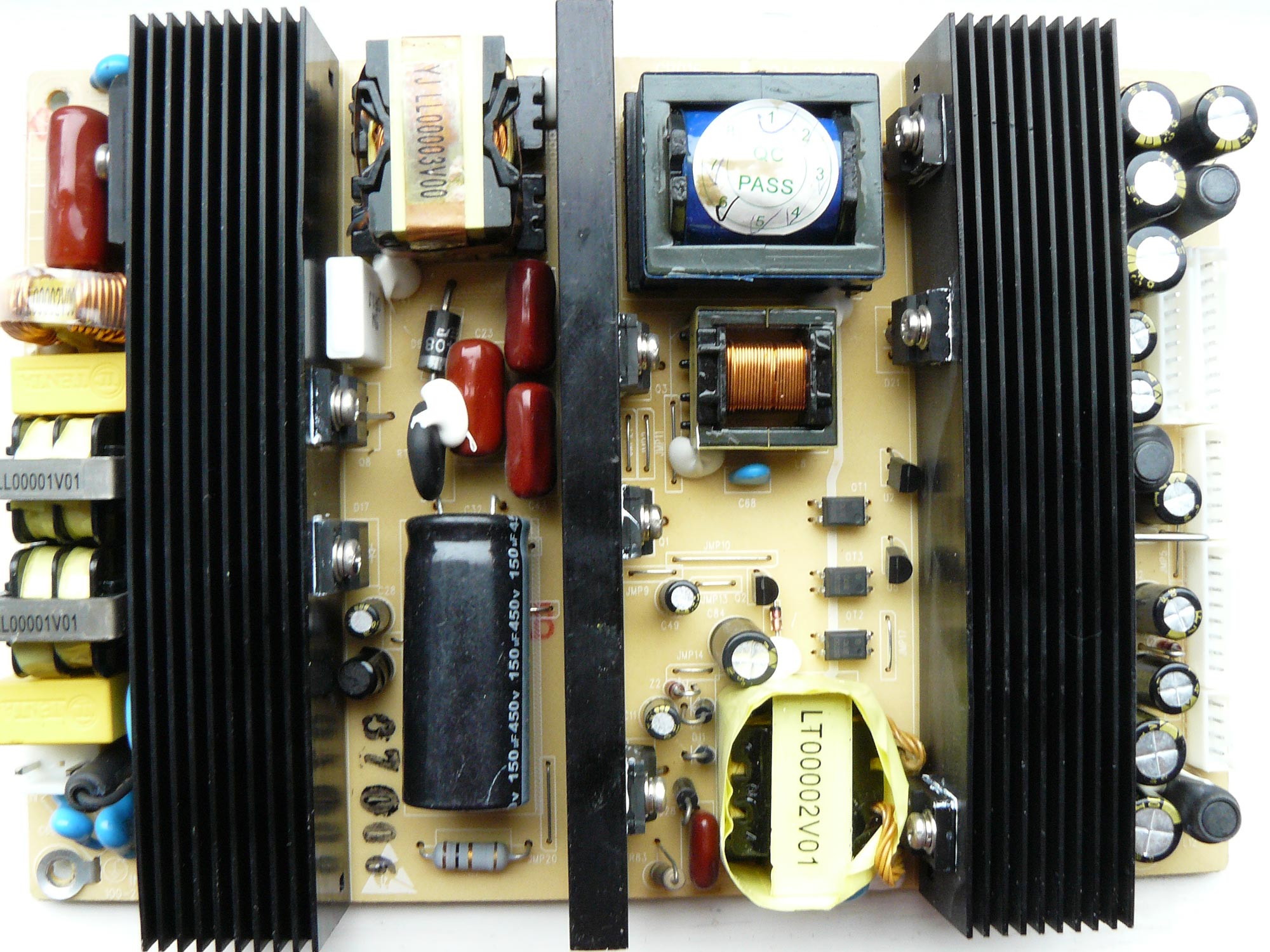

    After successfully replacing inverter caps on my Acer monitor last year thanks to info found on this forum, I've now acquired a 'broken' Vistron 32" LCD TV.
    When powered on, the screen "strobes" rapidly as if the back light is failing to stay on.
    This time I suspect it might be the power board but then again, I'm a complete novice.
    After inspecting the caps on all the boards, the only one with anything of note is the large 150uF 450V Samxon on the psu.
    Does anyone have any other ideas??
    Photos attached and as ever, thanks in advance for any assistance!
    David
    Re: Rapid flashing screen Vistron LCD TV - PSU or Inverter or?
    That primary cap could be the issue. There have been reported cases of that cap going bad in LCD monitors and causing rapid or occasional flickering.

      When the set is on and flickering see if the voltage on the Big cap fluctuates.
      I was going to suggest looking at the caps on the inverter board but they are Rubycon so should be good. What is the part number of the voltage regulator on that board Cant make it out but may a U designation its near the white barcoded label

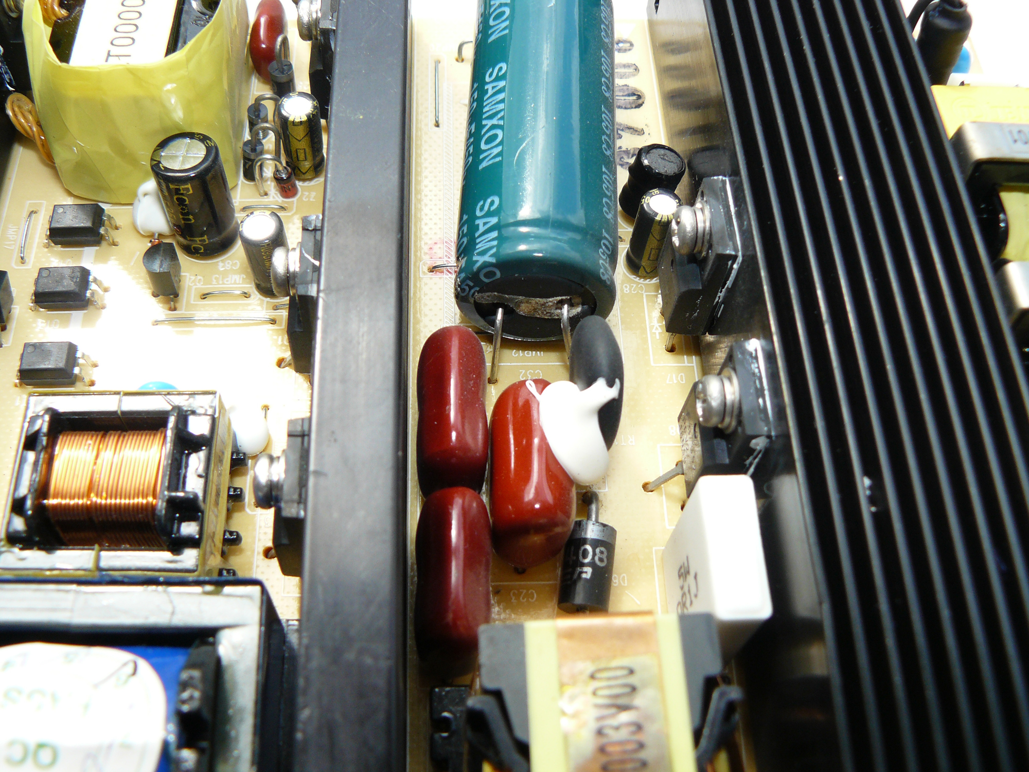

        It looks like something leaked out or it is some sort of corrision?

          Electrolyte is leaking out, I bet if you set your DMM (True RMS) to AC mode and measure the AC ripple voltage on the that cap, you will see quite big AC voltage reading on that cap.

            selldoor - have taken an addition photo close up although no sure if it is what you wanted!

                    Just a quick update to this thread.
                    Received the new capacitor and replaced the suspected faulty one on the power board.
                    TV is now working 100% again - great result and thanks to all who offered advice!

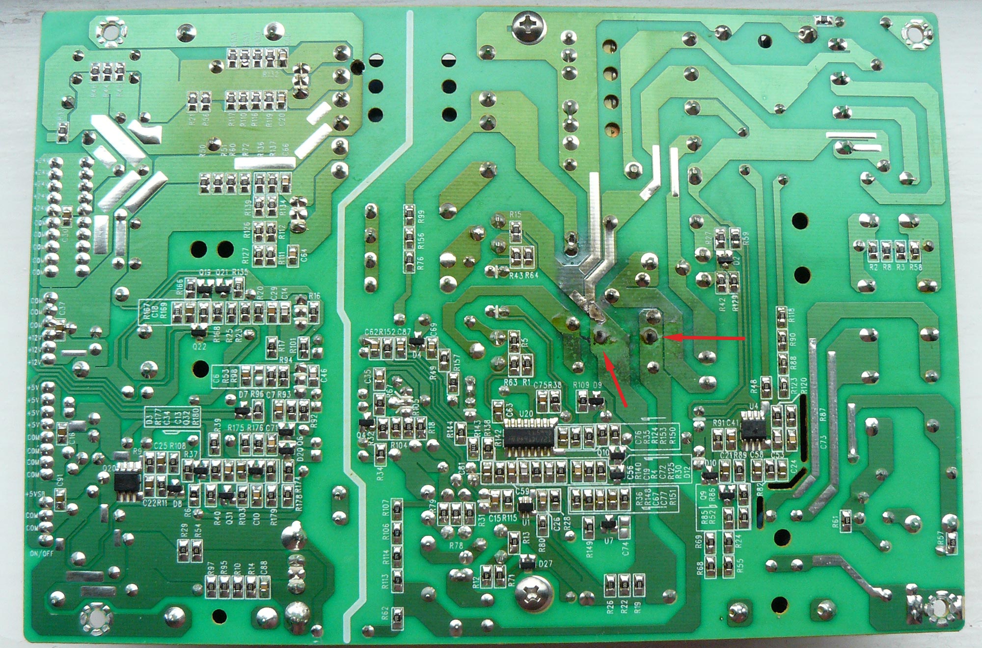

                                Hmm... plug fuse (5A) has blown.
                                Removing the power board shows major problem... its cooked!!
                                I can't see how I have managed to mess this up so badly. I was certain I kept the polarities matching the old cap...?
                                All the heat damage is around the replaced cap so what did I do??
                                For amusement only, photos attached as requested. Cap pins indicated with arrows.
                                A replacement power board is only £30 but is it likely that the other boards will now be wrecked too?
                                Thanks,
                                David

                                  could there of been a lot of flux from your solder on to the new capacitor joints maybe worth cleaning the area up on the back of the board with some cleaner to remove the flux if there is any as it could of shorted out as above the left arrow it looks like a spark has arked across 2 points?
                                    That the blown ground trace which is part of the Source pin high current ground return, I think yOUR MOSFET is shorted.
