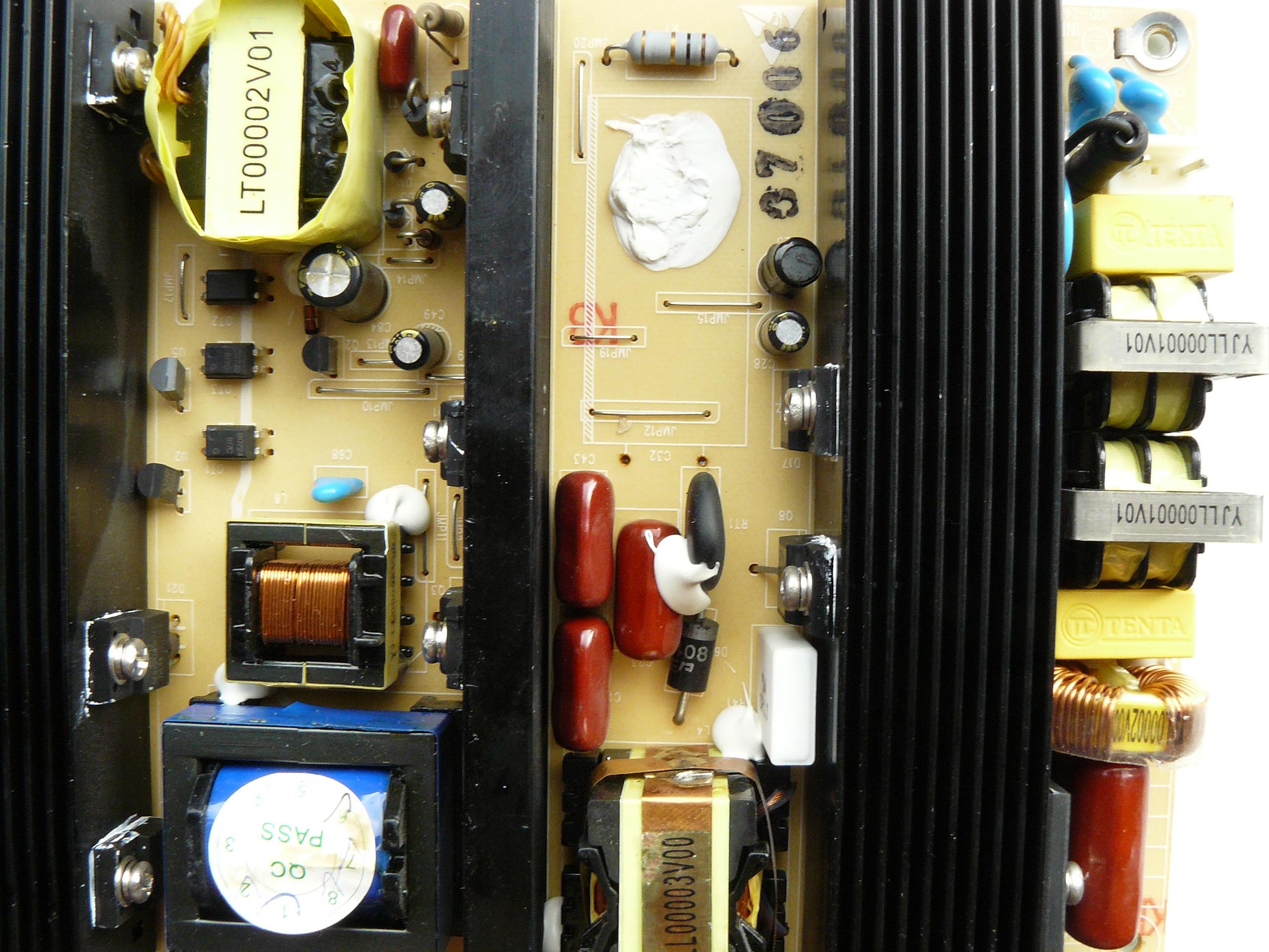

        Ok, have removed the cap and tested as best I can... connected to DMM at 2000k ohms setting and resistance rises. Then tested voltage across terminals after 30 seconds or so and it read 0.2V
        Photo attached shows top of board where cap was located. No obvious signs of damage here.
        Did notice a tell tale "sizzle" as I de-soldered suggesting I had left flux on the terminals.

          It does look repairable, its around now I wished I'd made my usual request for pictures
          of both sides of the boards early on. What is the part number of the board ?

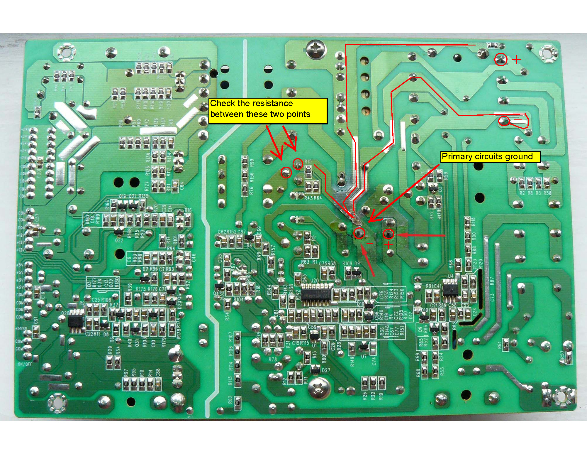

          Clean up the area with some isopropyl alcohol and take another close up of the damage zone. Just by the mains socket on the board is a black encased fuse - can you check it.
          Dont need another pic - Budm has marked the traces out.

            budm - tested as per your pic and is reading open circuit. I get a resistance of 8.36 at 20k setting between the vertical upper and lower leg of what I guess is the MOSFET.

                No - see edit - Budm has marked out the traces so if it needs wires to mend the traces we can see where they should go. Do Budms resistance check and post result

                    selldoor - sorry, I did check the resistance as per the image from budm and posted it (#25)
                    It read as an open circuit. Am guessing the cap removed makes no difference to this.

                        You need to use jumper wire to fix that blown trace. Since the MOSFET check open, I still would like you to look at the body of the MOSFET to make sure there is no sign of damage on the body, it could have blown so bad that it went open circuits. For the copper trace to blow and took out 5A fuse, something shorted badly to cause that kind of damage.

                            I hadn't read the dim bulb idea before I put the main capacitor back in place and soldered in a wire to jump the damaged trace.
                            Plugged in and switched on and the TV works again... (!!)
                            Does the jumper wire need to be particularly large in diameter? At present, I've used wire comparible to the other existing wire jumpers as per my image on post #23
                            I also remembered to give the soldered areas a good clean off this time too as I'm pretty sure it was excess flux that did the damage.
                                Should be ok trace is only thin even if wide. If you can get at it when the tv is on check to see if you can see it overheating - BUT remember dont touch it until the big caps has discharged. Invest in a good name cap as Tom says.
