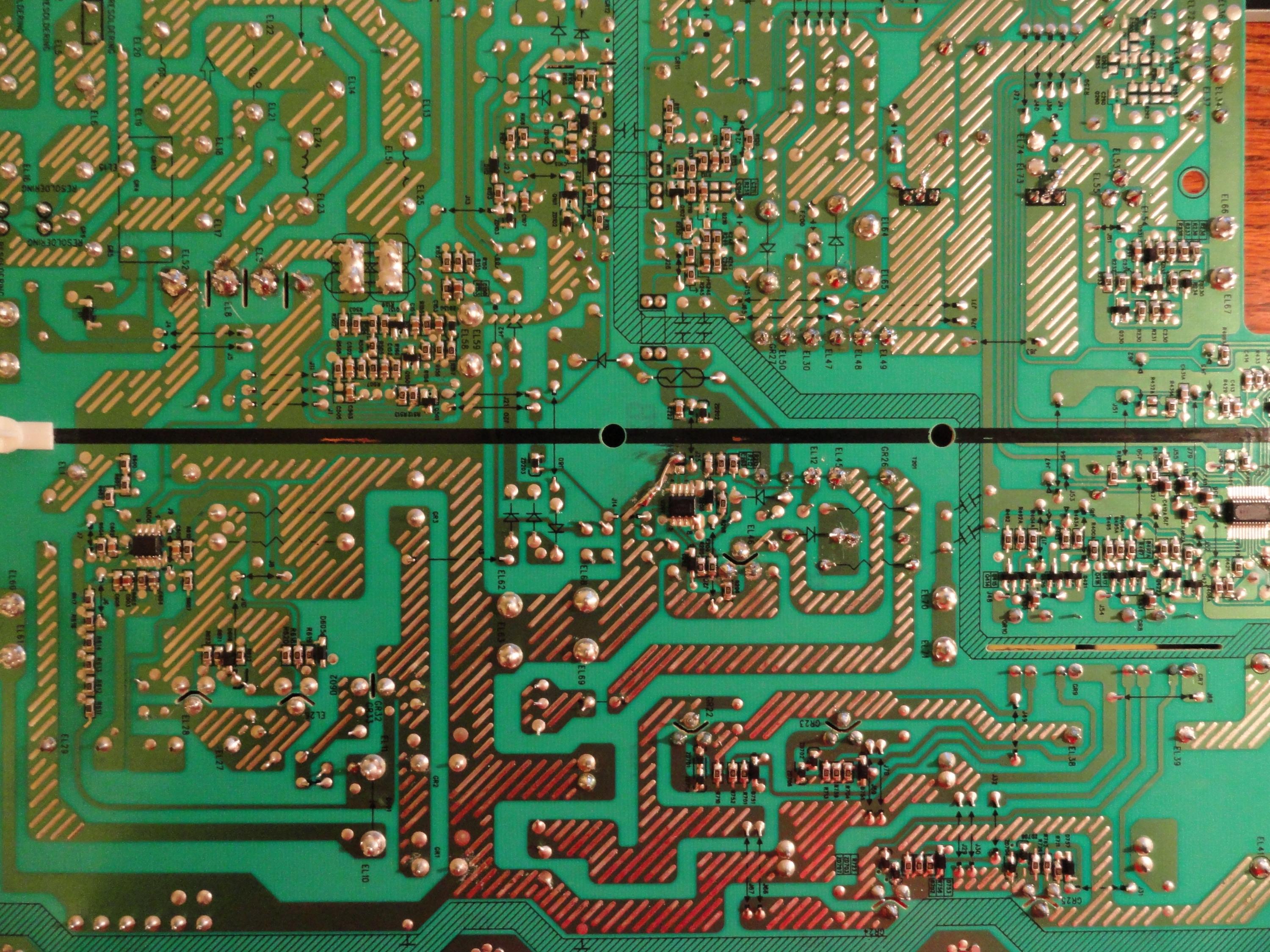

    Meant to say can we have a better picture of the bottom of the power supply.
    Next time it is together and switched on I am thinking a bit of random looking for voltages is in order. Meter on vDC black pin on the ground screw just probe the Cold Secondary side of the board with the red probe jumper wires are easiest I suppose.
    But you could check each side of various components. Do not touch the heatsinks or stray into the hot side

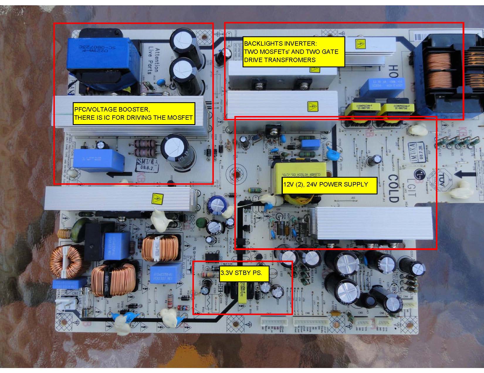

      OK, from what I see in the picture, there are PFC/VOLTAGE booster, 12/24V PS, 3.3VSTBY PS, BACKLIGHTS INVERTER.
      You have indicated that you had replaced the MOSFET and recitifier, are they in the PFC section, the IC may be damaged when MOSFET failed.
      Are you getting about 400VDC on the 450VDC cap when you turn on the TV?

        The mosfet I replaced is Q201 which is the one located in the red block you highlighted in the 12V and 24V power supply.I pulled most of the capacitors in the 12v and 24v section as well as some in the primary, they all checked outgood regarding capacitance.as to the voltage on the cap I did not check but I will after I solder the caps back on.

              So the Standby signal is working because the PFC dose turn on, this same STBY signal is also used to turn on the 12/24v PS. So there should be an IC close to that MOSFET for the 12/24V PS. Can you see it? We will need good closed up pictures of the bottom side of the board.

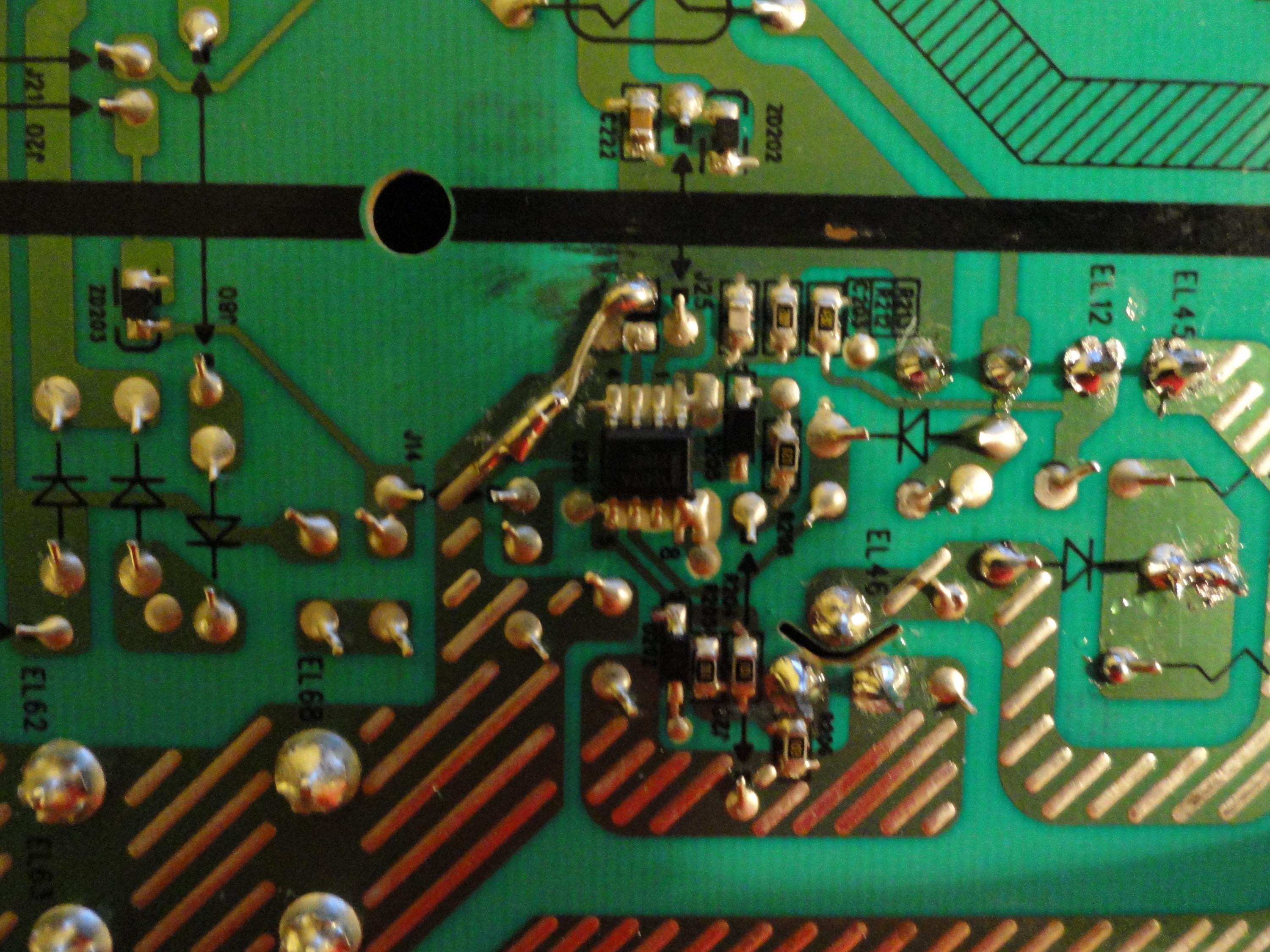

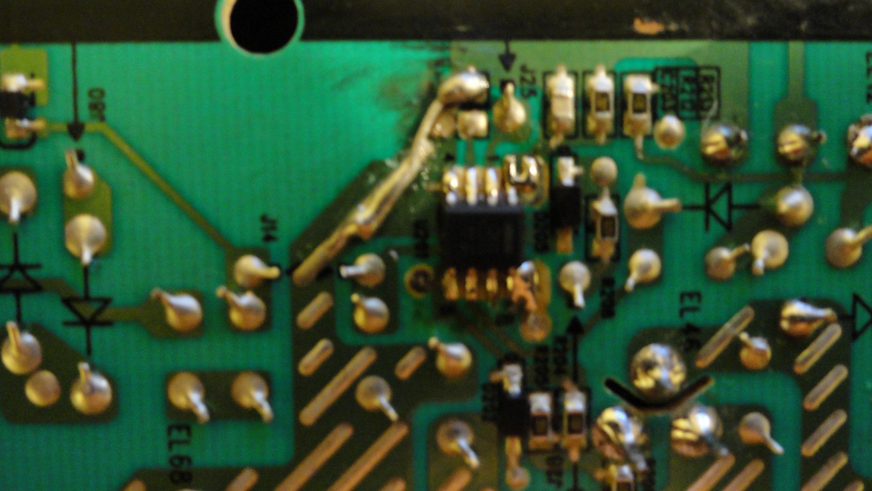

                    Here are the photos for the ic that is in that vicinity. As I mentioned in an earlier post that the trace was blown apart so I repaired it as seen in thephoto. Maybe the ic is shorted? IC has this ID 1207A PHM7( date stamp)

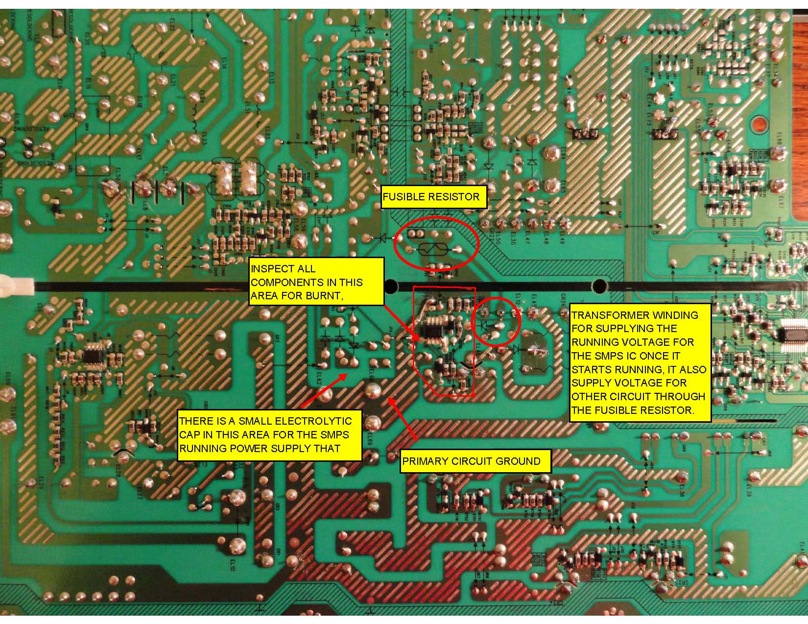

                        If I were you, I would replace the SMPS IC, you are lucky that the IC Gate drive output did not stay in stuck-high out put mode which will blow up your new MOSFET.
                        Please see my marking in the attached pictures, look real close at the components in the SMPS IC section with high magnifying glass to see if you can locate any blown up components.
                        When power MOSFET blows up, it will usually take out the IC and the relate components connected to the Gate pin of the MOSFET.

                                        I would not plug it in until we verify the pin out of the IC, according to spec, with the slant side toward you the left pin will be pin one. I cannot tell from the picture to be able to see anything clearly, it is not in focus. I look at the earlier picture, I can see '8' on the bottom right, and I can see the slant on the top edge of the IC.
