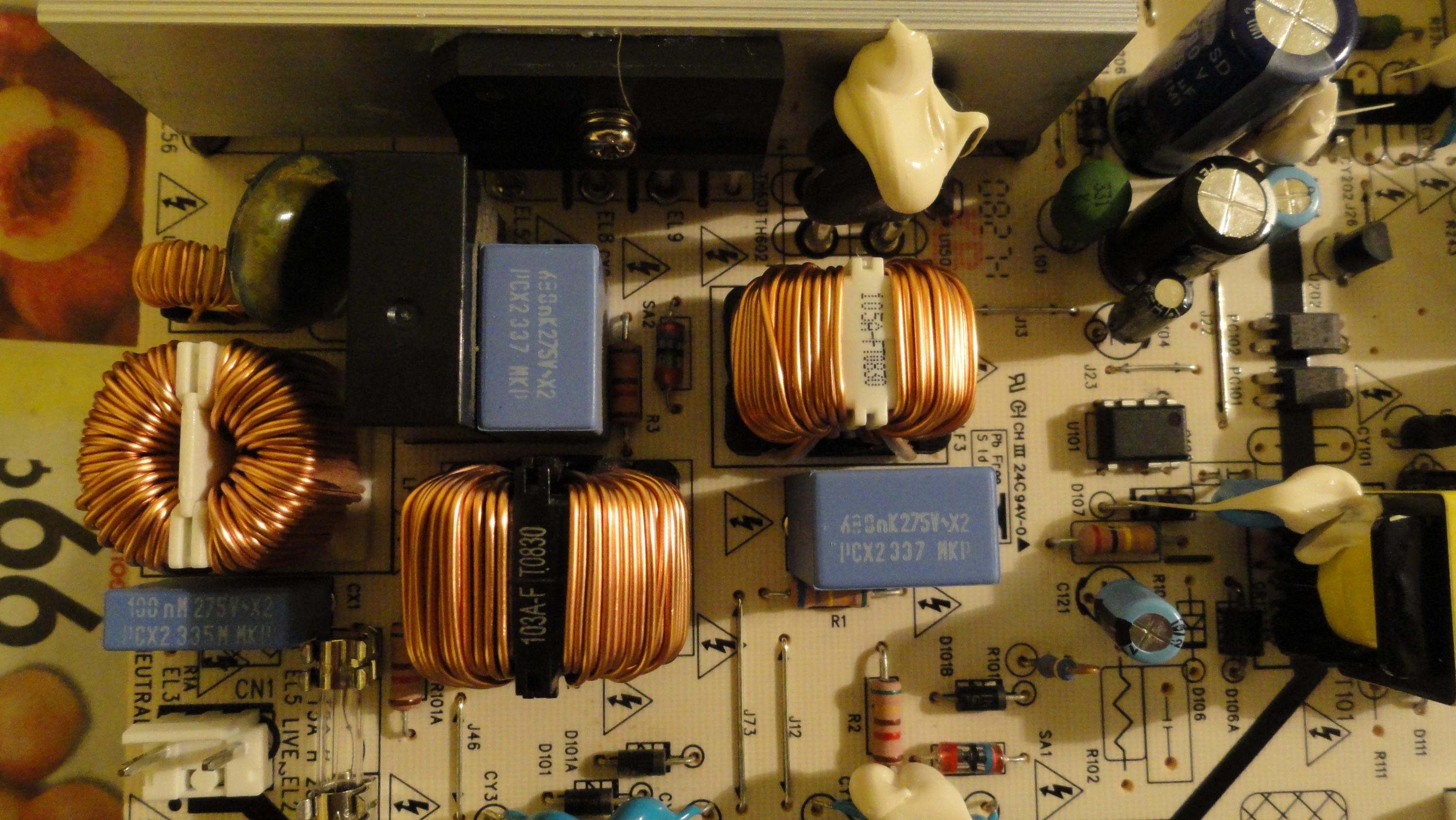

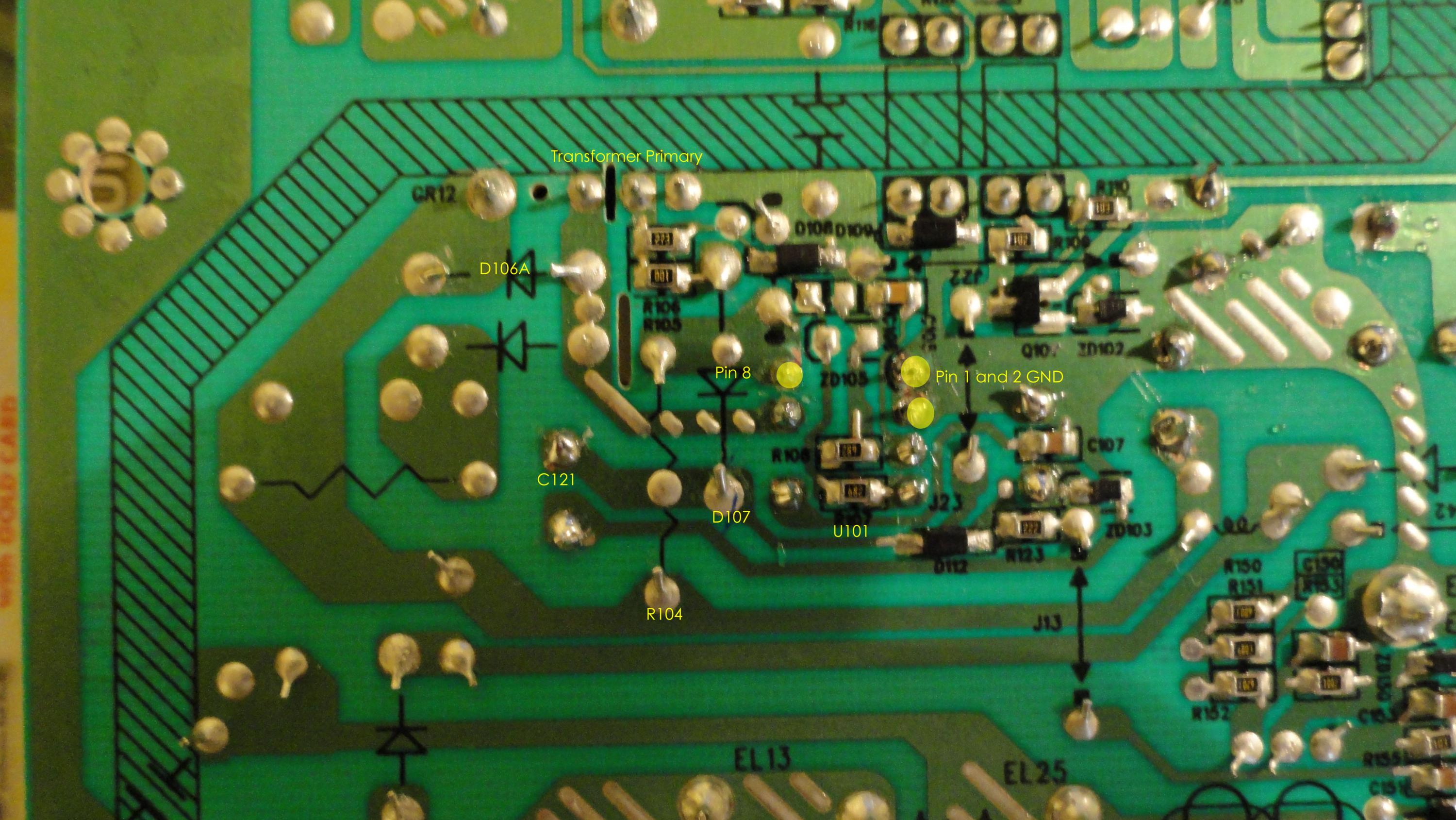

        I more doing more voltage troubleshooting at the primary side of the 3.3v tranformer. The main bridge rectifier does not supply the DC voltage to the 3.3V primary side of the the transformer that is a seperate circuitry which is on when teh board is powered. The voltage is at 168-169VDC. also I have noticed on the primary side of the transformer another voltage of about 16-18VDC. that voltage is dropped out upon the main board being hooked up and the PS is momentarily turned on. There is a 47UF 50v elect capacitor upon measuring the voltage across either the diode or capacitor it is reduced to below 1 VDC. whether this is an issue or not I am not sure.
        On the power supply board in the photos I previosuly posted the diode would be D107 and capacitor C121. Unfortunately I do not have a cap in that size to replace for testing. the resistor between the diode and capcitor has 168VDC on 1 side and the other side is the 16-18V.

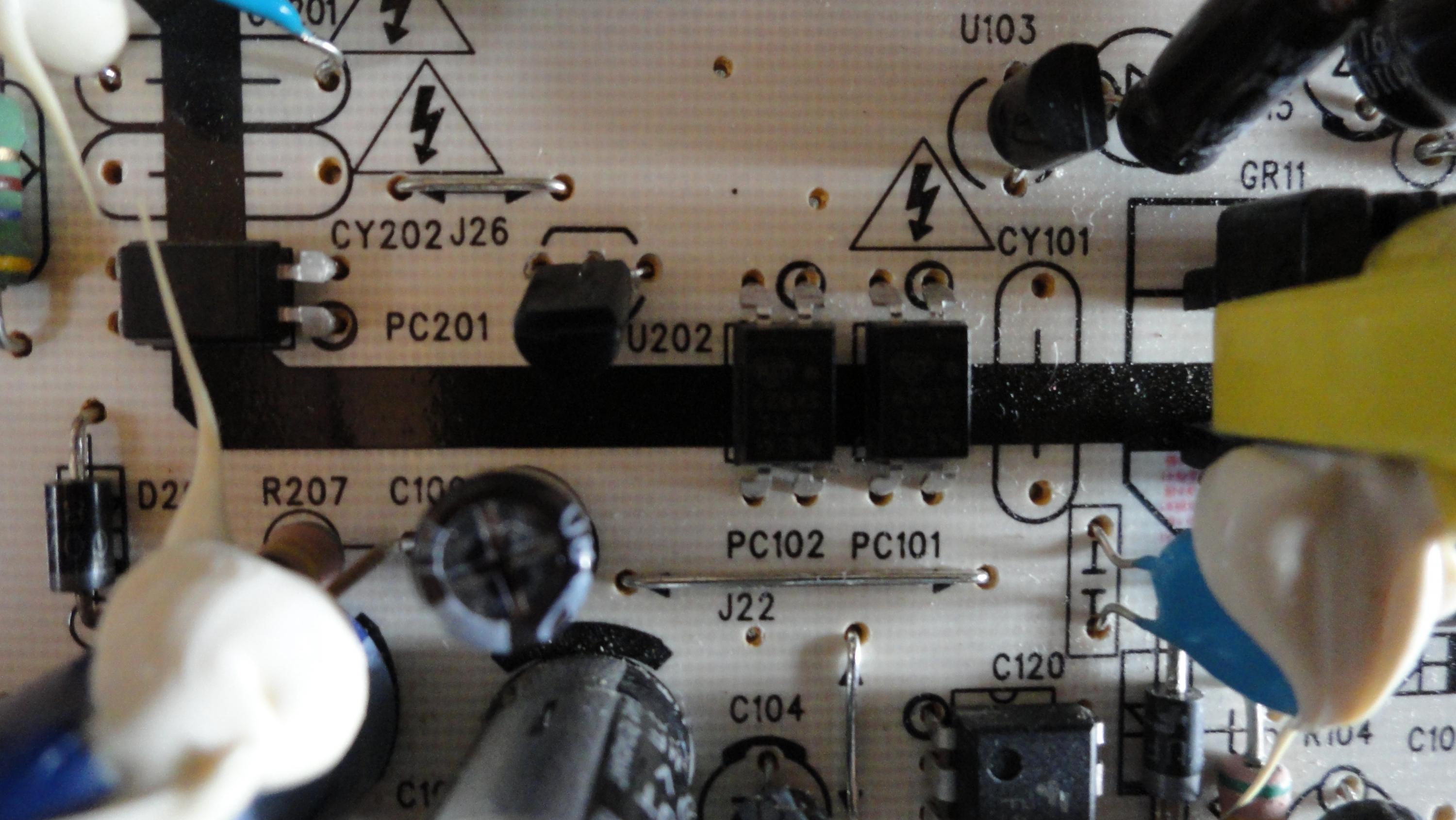

        In addition, one of the legs of PC101 will have this 16-18VDC HOT Side and the cold side is the 3.3VDC but when it drops out the 3.3VDC goes to almost 0...BTW what is the PC102 and PC101 used for....

          Can I see the picture of this PCxx? I think they are Opto couple, they use Opto couple to provide the feedback from the output side which is isolated from the hot primary side. It is power by the output, so if the out go down, there will be no voltage to turn on the Opto.
            #65
            Re: Phillips Magnavox 42MF438B/F7 does not power up
            I took a top and bottom picture view of th opto.

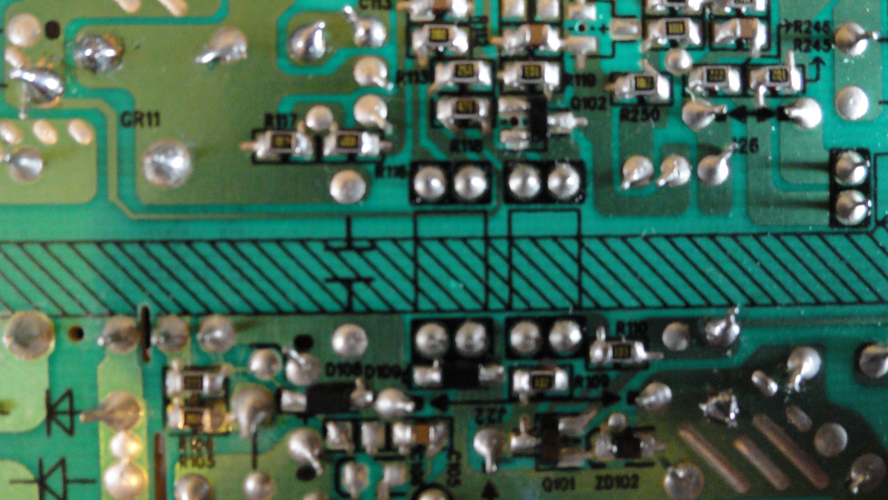

                  I attached the photos of the top and bottom view of the primary side of the 3.3v along with voltage readings at some locations. One of the things I see is the massage drop in voltage across the R104.I did switch out the U101. Let me knwo your thoughts.
