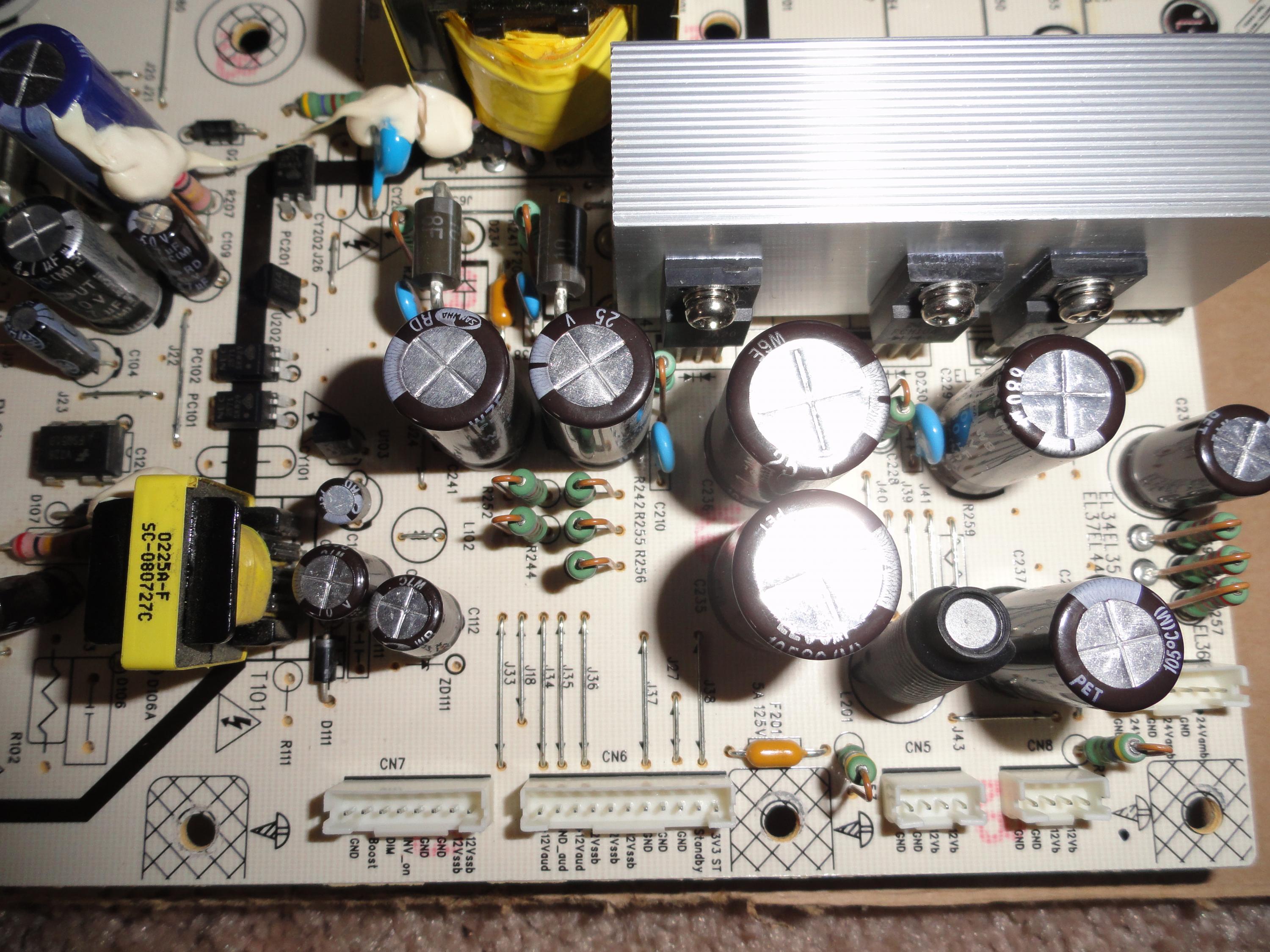

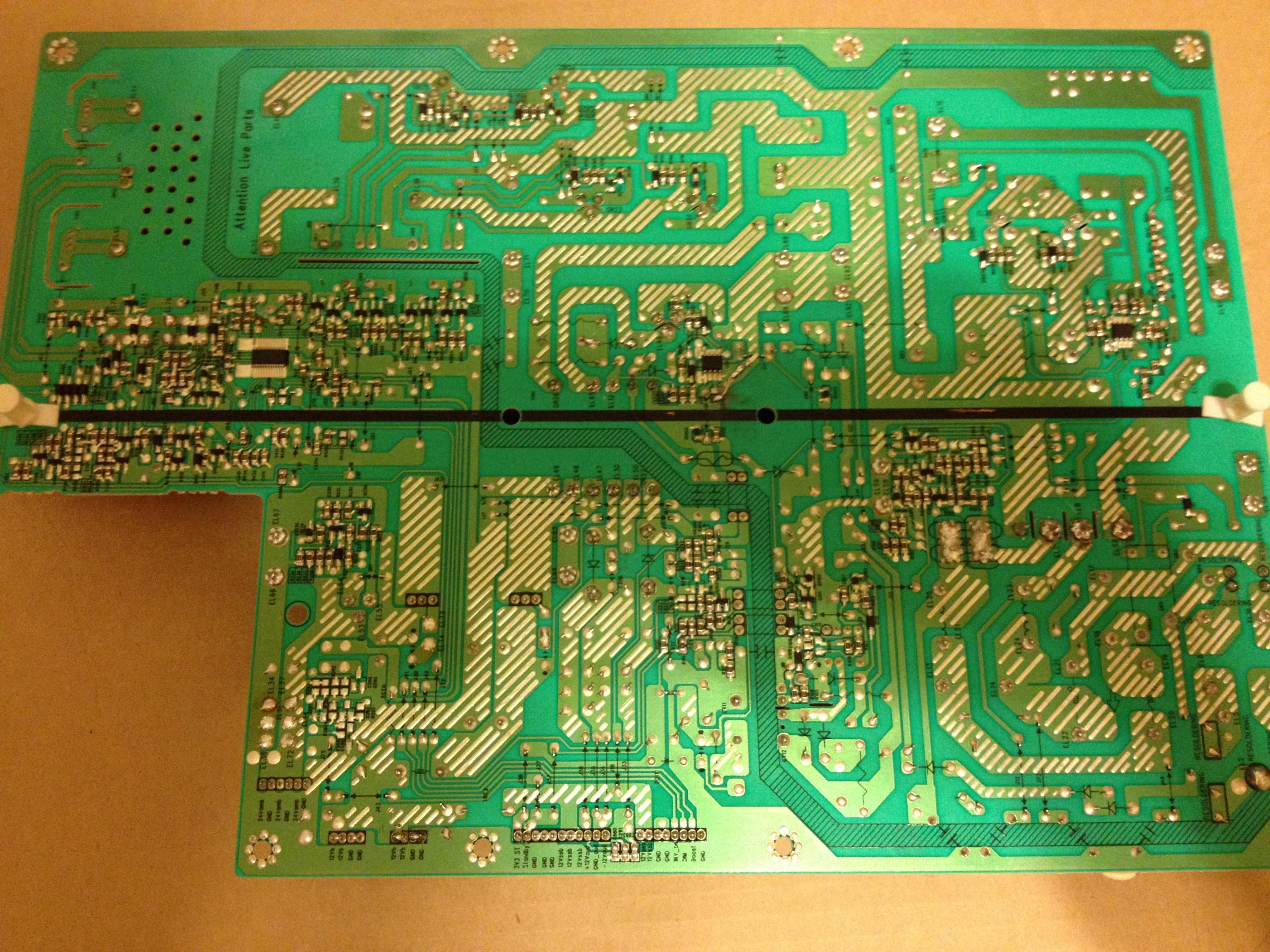

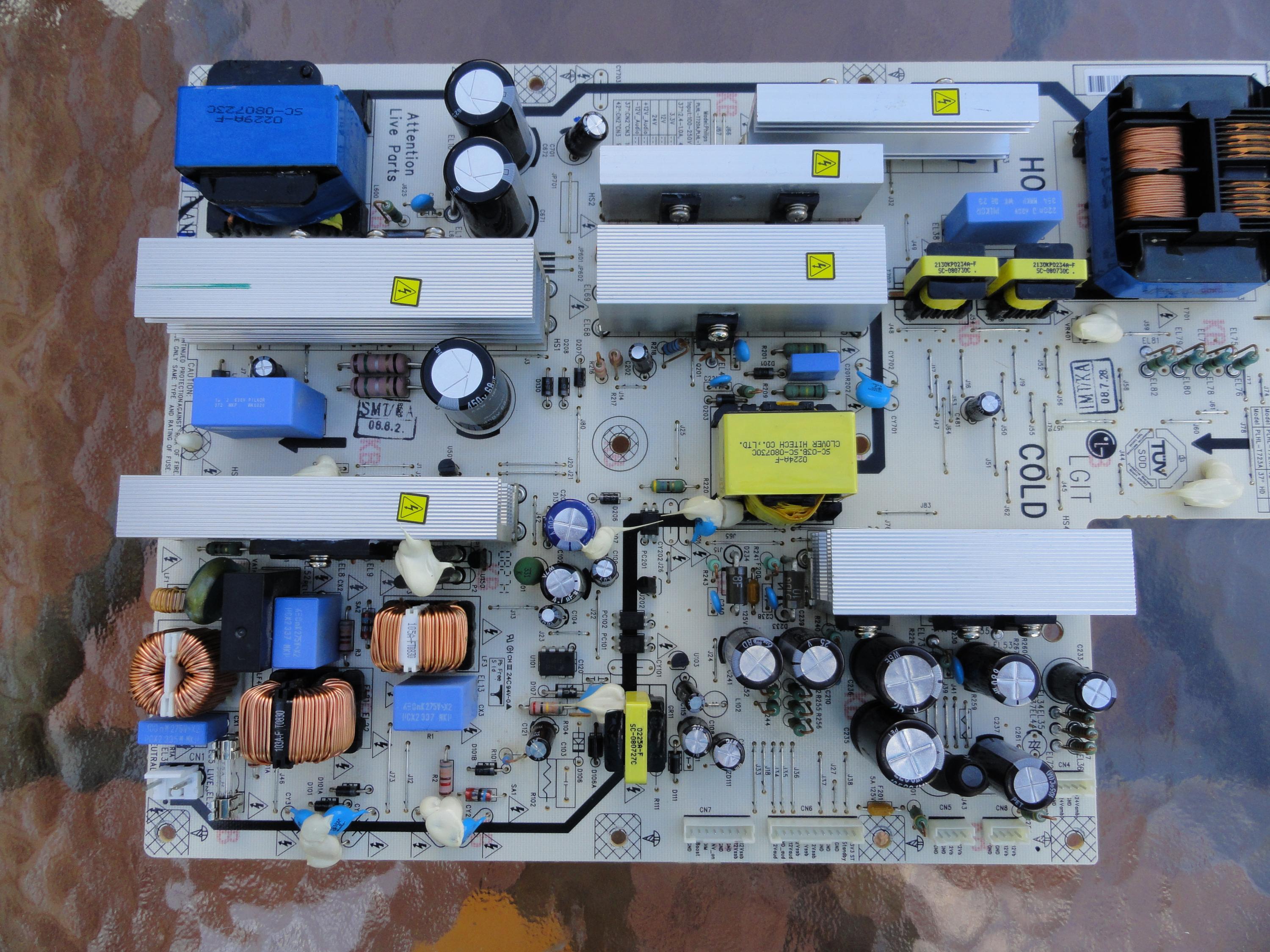

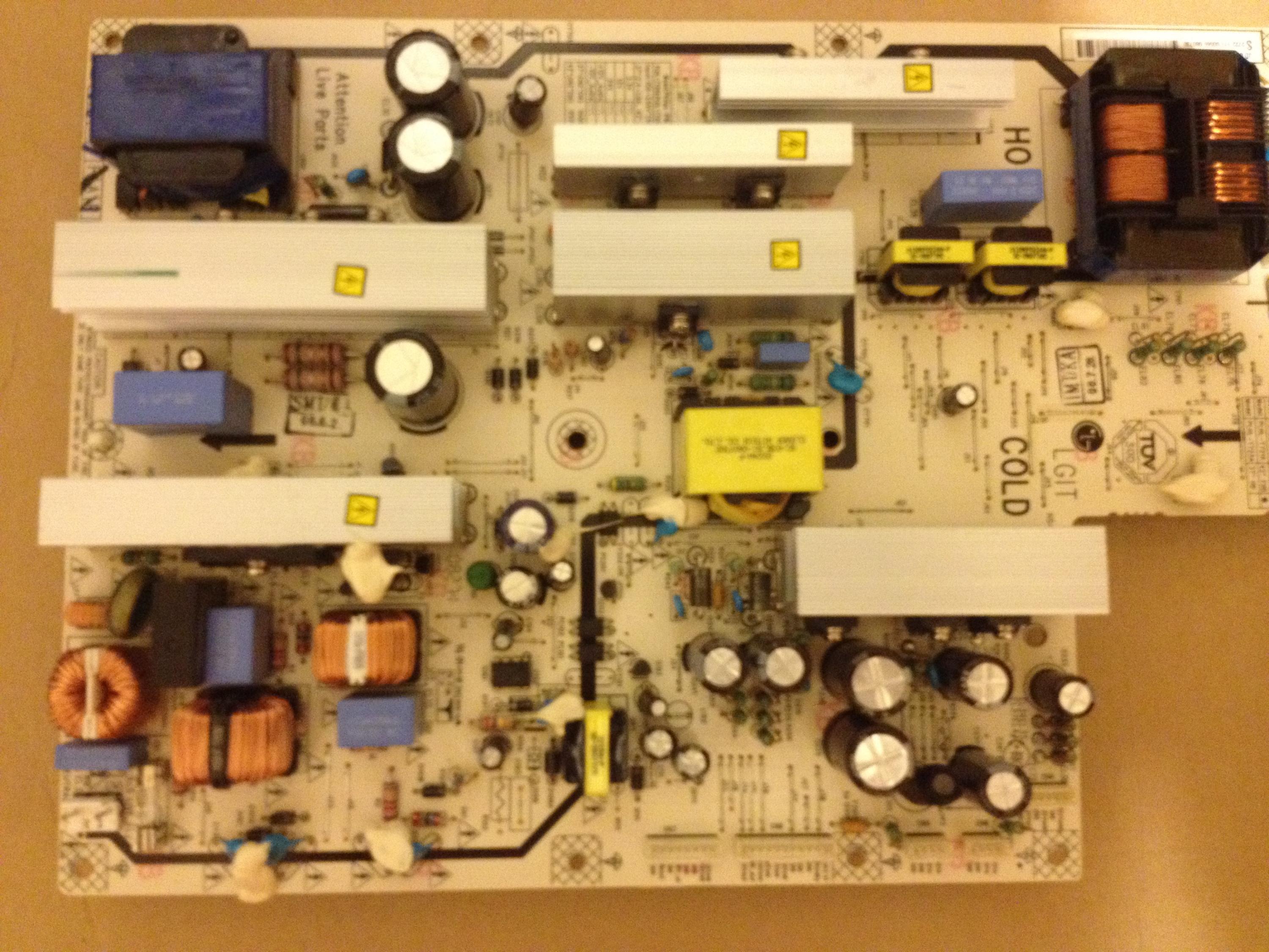

    I recently aquired a Phillips Magnavox 42MF438B/F7 that presently does not power up. When I received the LCD TV it would blow the main board fuse. It appeared that the bridge rectifier and a mofset were blown. I managed to repalce both components and the fuse does not blow anymore. The only voltage I have going to the main board is the 3.3v. I do not have the 12v and 24v. the front LED does not light up no fucntion what so ever. I have been combing the board for any other compents that might have blown but nothign jumps out at me. All other fuses on the board are good.
    Any input would be greatly appreciated. The chasis number is LC8.14LA
    I attached photos of the PS board.

        Re: Phillips Magnavox 42MF438B/F7 does not power up
        Pictures are not really clear enough for trouble shooting
        can you get them a bit sharper - good light is the key.

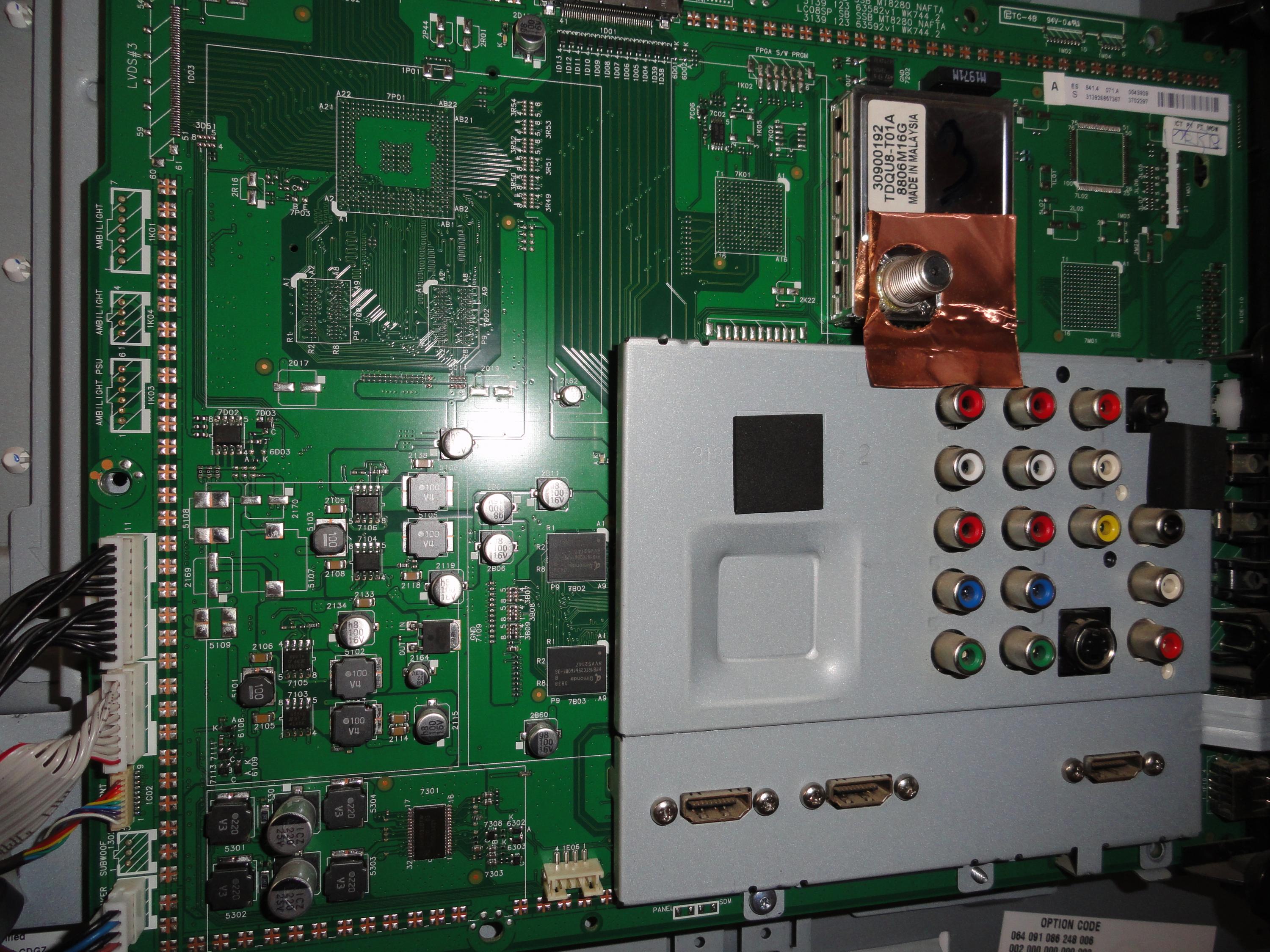

        Need pics of the main board as well.
        On this board top left in your picture there is a half hidden orange component - is it a fuse? does the board designator begin with an F.
        Please can you also update your profile with Country and Mains Voltage

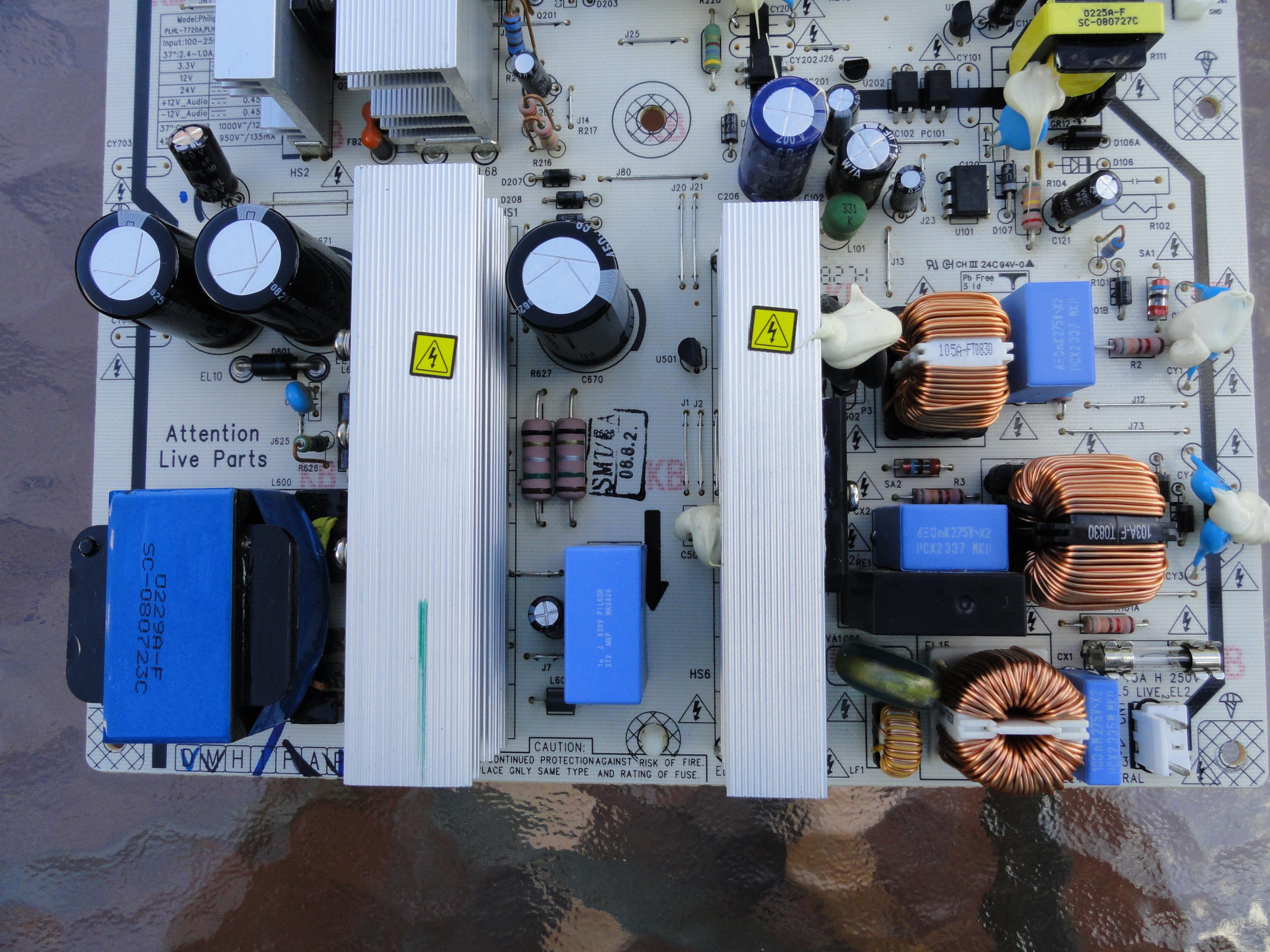

          I will get better photos. I was using my iphone for quick photos. As for the orange component it is a fuse. when measured checks out good.

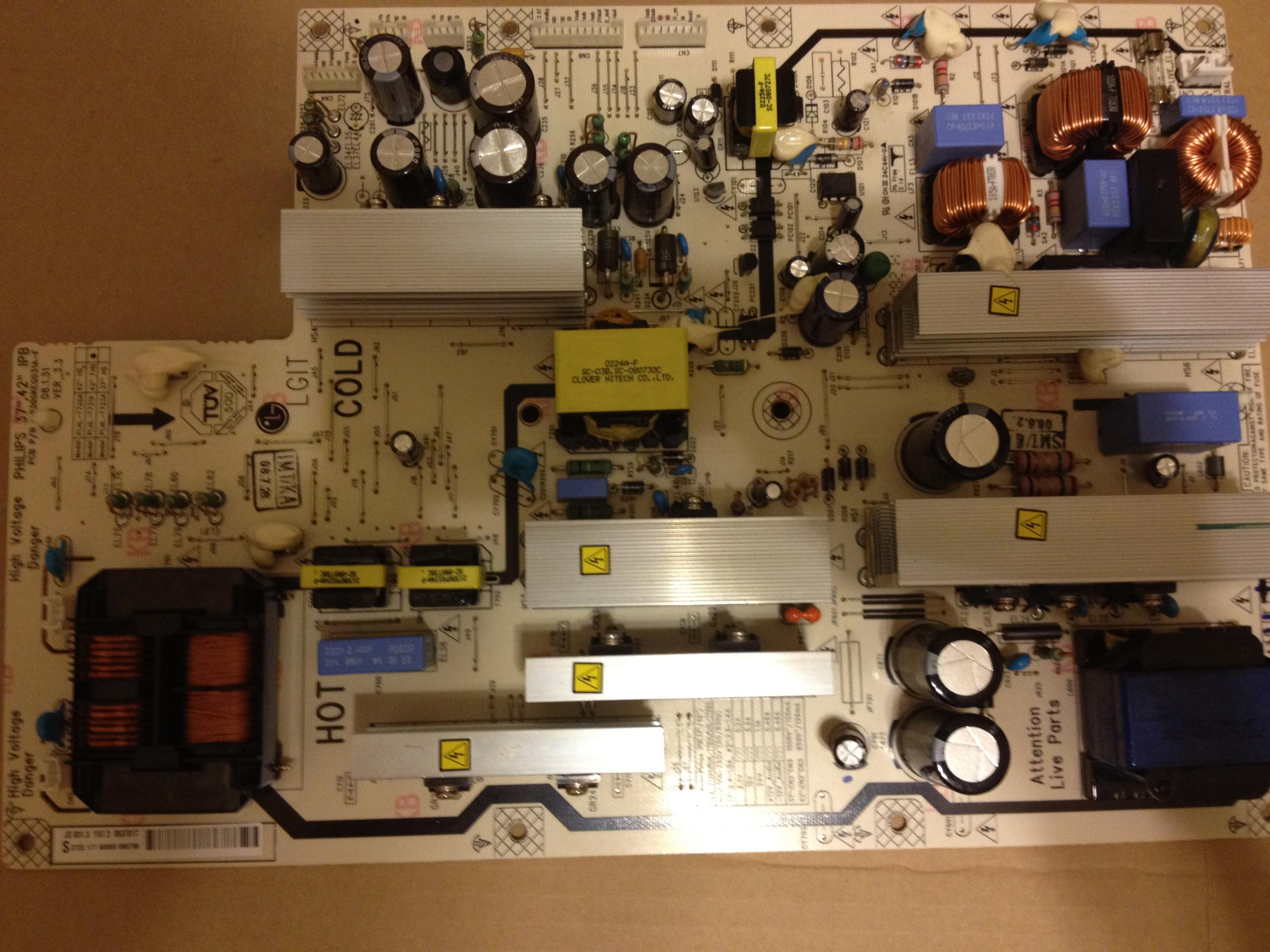

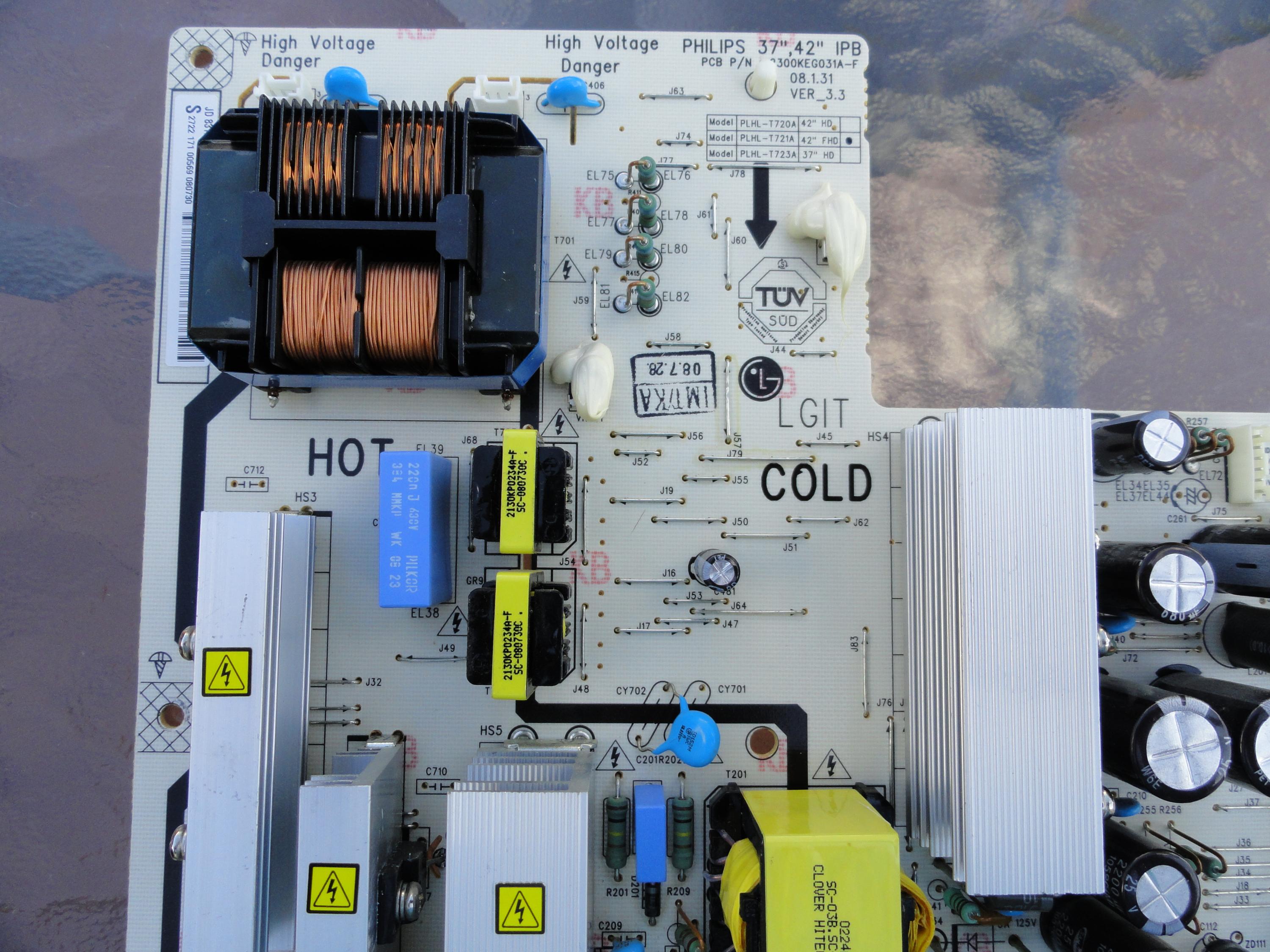

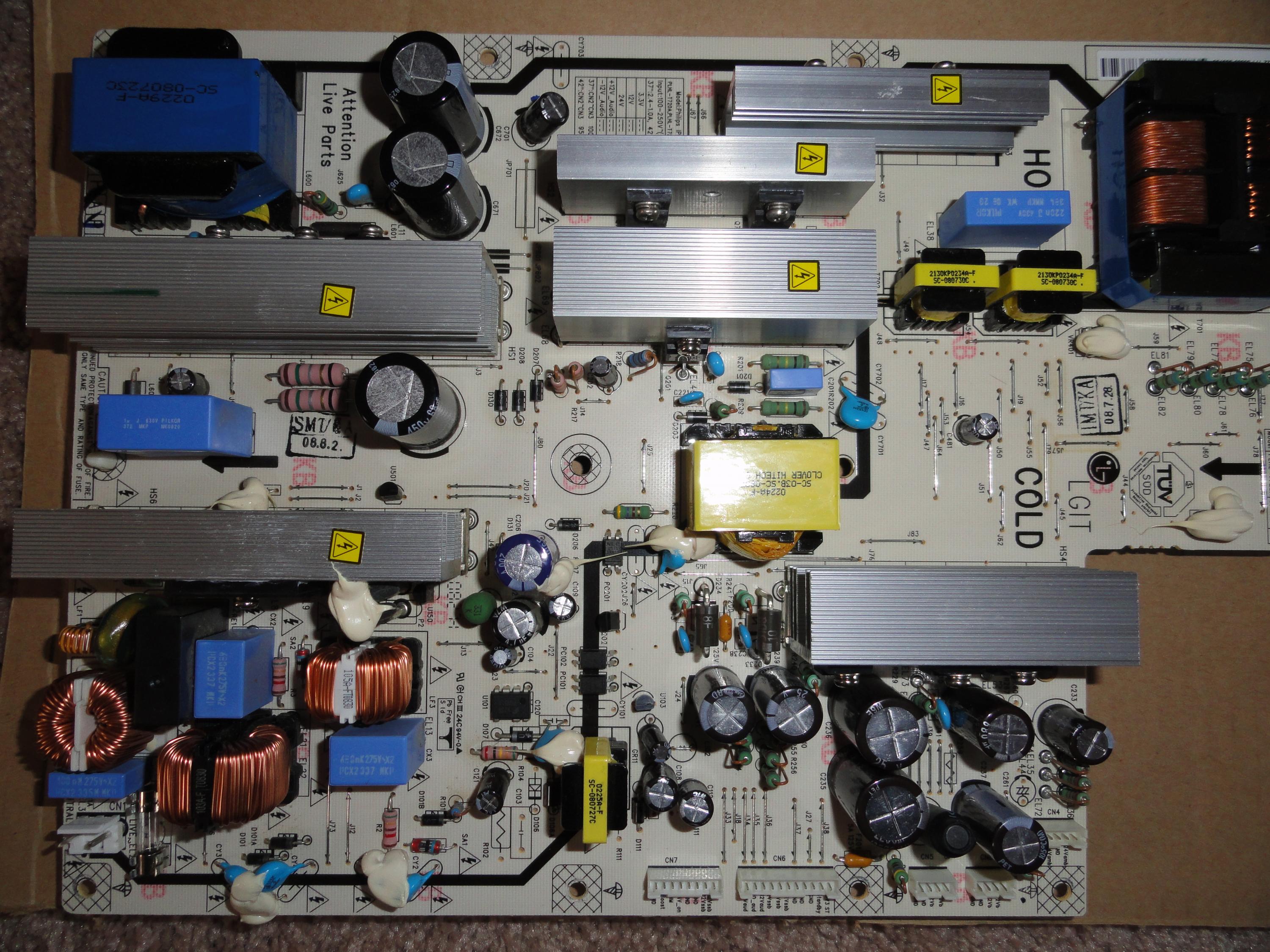

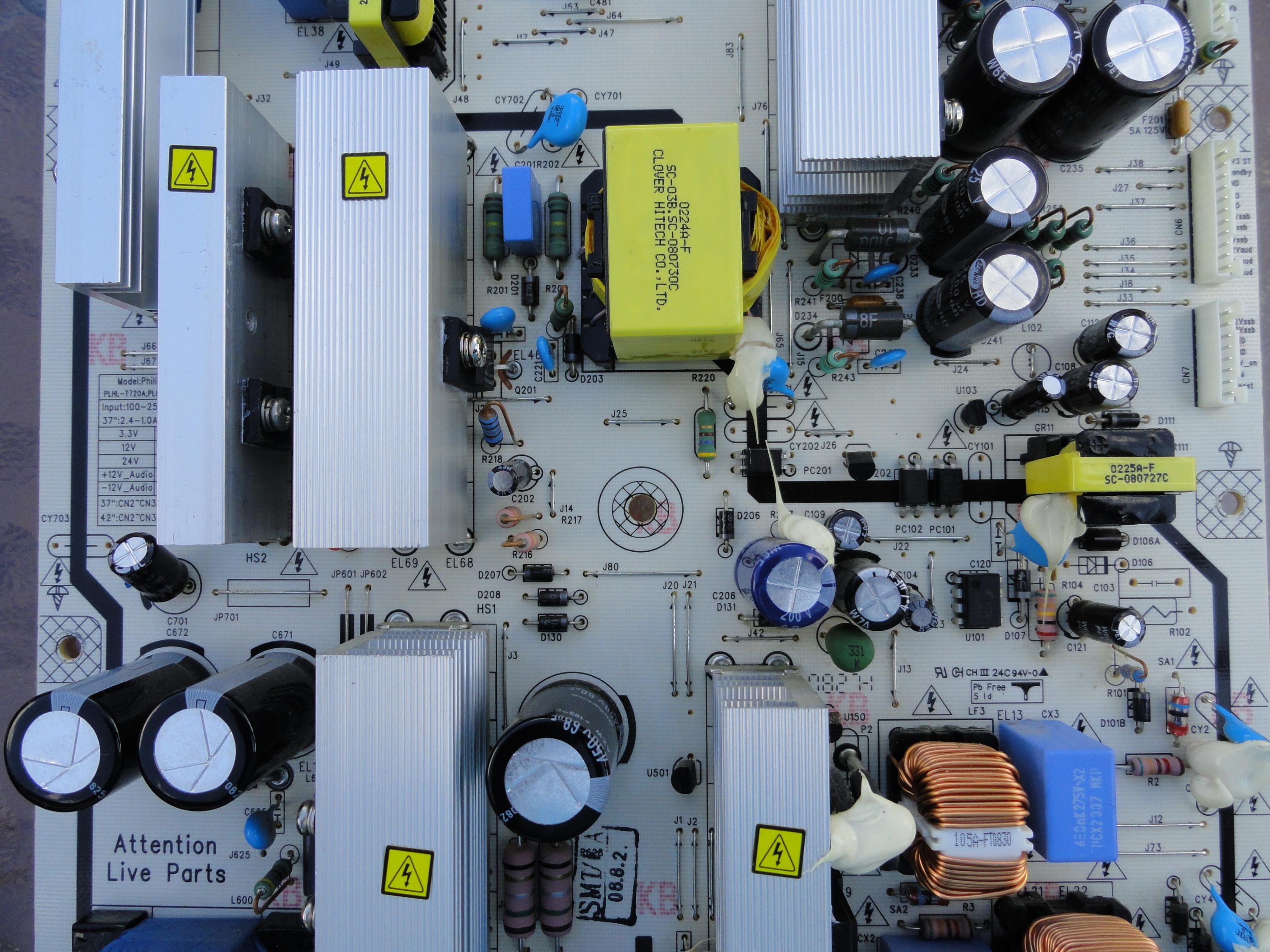

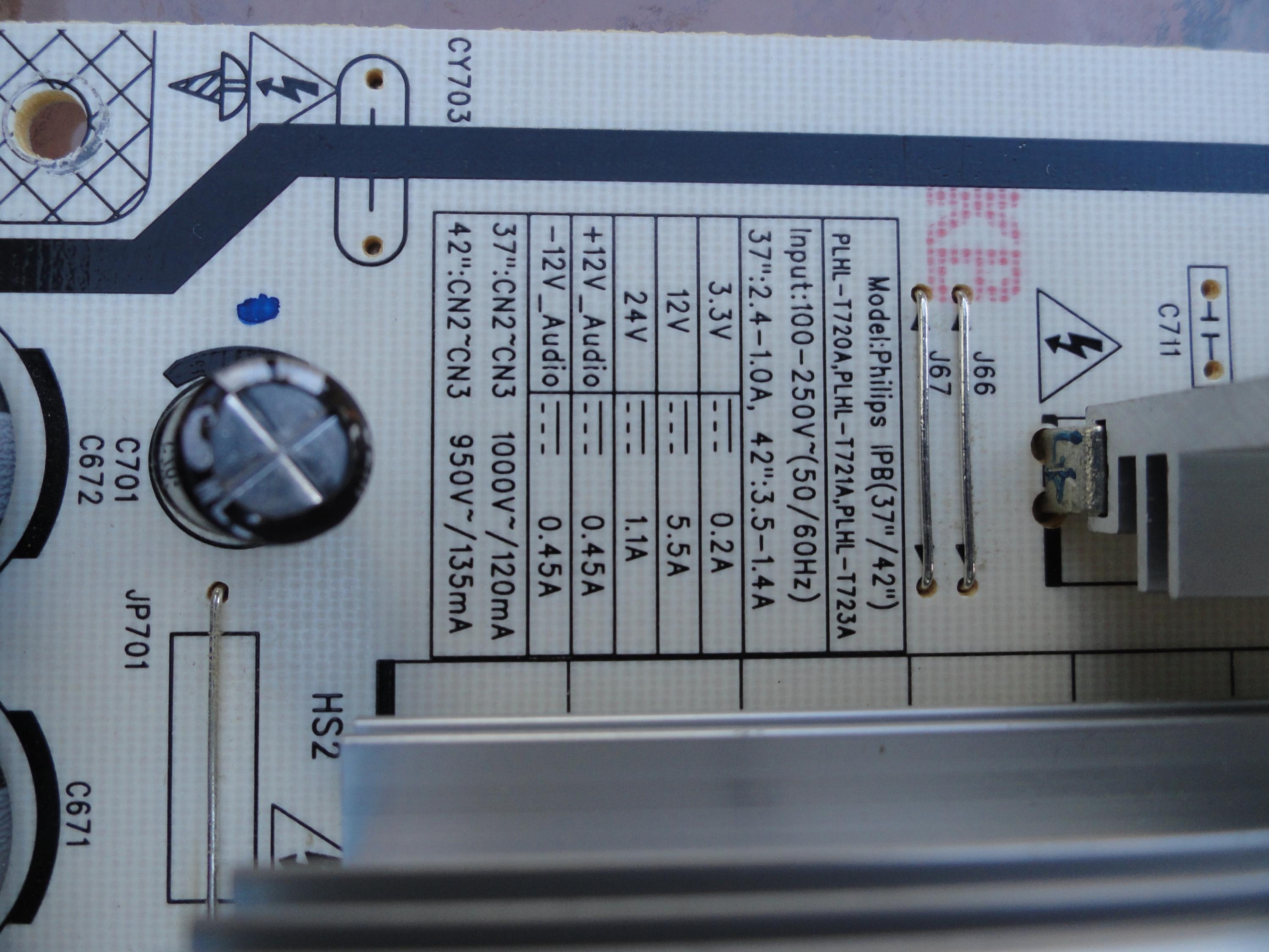

            Hopefully these photos will help. Thanks!
              Okay there is a pin marked "Standby" on the PSU. With boards installed in TV and everything connected up what does this read?
                Busy day tomorrow so off to bed- have just to say im blown away with that first picture. Dont need to check the fuse its so clear we can see the wire. - fantastic
                  with all the components attached to the PS the standby voltage is 0.000V DC.
                  With nothing on the board the voltage measures 2.655V DC
                      Originally posted by mike123333
                      Selldoor - I am not following you...which wire are you referring to??
                      He is just complementing you on the pictures. They are so clear and focused you can see the fuse filament wire intact through the glass casing.
