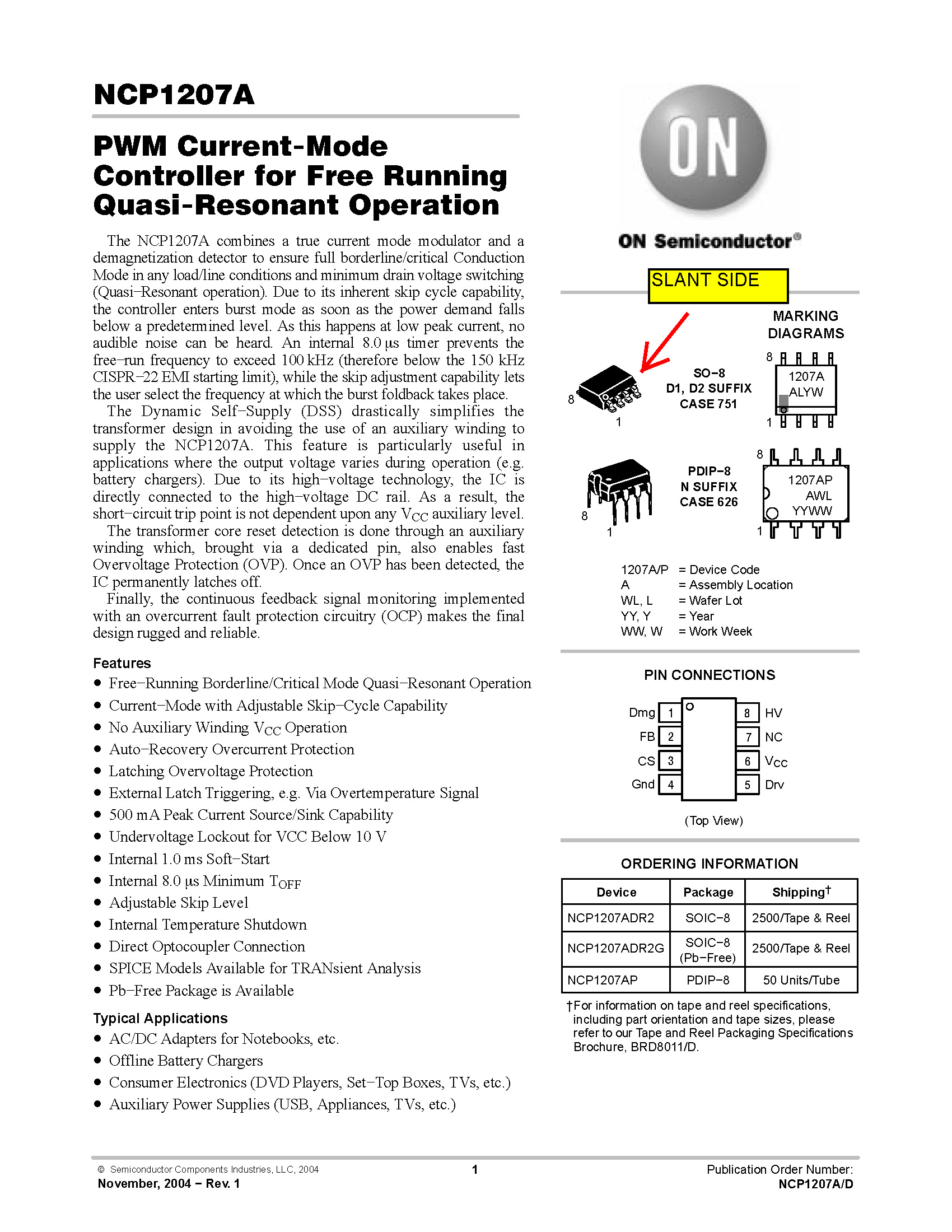

what is the possibility now that the IC is funtioning that there maybe a leaking capacitor with the additional load or attempt to power up the 12v and 24v power supply area.
Re: Phillips Magnavox 42MF438B/F7 does not power up
If you do not have 3.3V for the processor to run, this processor sends the PS_ON signal to turn on the 12/24V power supply section, that is why we have to have the 3.3V working again to see if the new IC fixes the 12/24V section.

I probably will remove the IC chip off the board and see if I get the constant 3.3v and the powering on of the PS.
I removed the IC chip and still the samething, the relay latches on then off adn loss of the 3.3V.. I am wondering now whether I have an issue on the main board. What would be teh obvious things to check for, diodes,regulators??

I did order a power supply board yesterday and it should be in tomorrow. I am baffled at how this thing went from having that voltage to not after the IC swap.. as I was thinking more about what could possibly have changed, soemthign dawned on me aafter I removed the IC chip with my hot air station. I noticed that the board lifted up in that area as though it seperated apart ( underneath the IC chip). could there be a possibility that there is a short or discontinous trace that I did not notice? maybe this may have been a coincidence to what happened.
I think it may be co-incidence because the 3.3V standby power supply is separated from the section you are working on which is the 12/24 power supply section.
