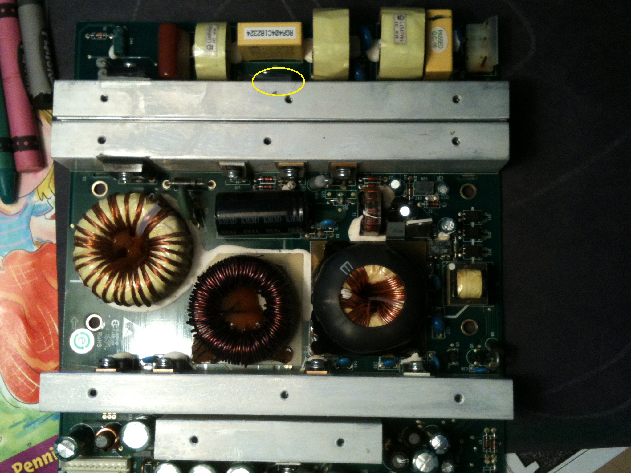

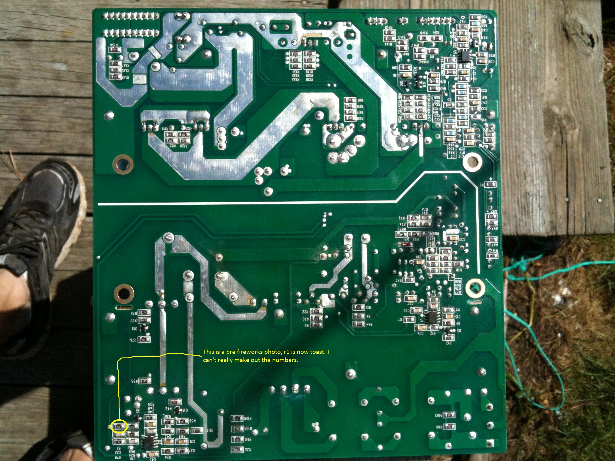

                    Re: 42" Spectrincq no power
                    Ok so I replaced the bridge, replaced bulging caps, and popped a new fuse in. What did I get? Fireworks! Got some sparkage at the main switch and a glowing red light, at least its more than I had the first go around. When I push the power button it flashes 3 times and nothng. I pulled the board and had another look, noticed R1 burned up not sure what the value was cause I can't read it! Anyone wanna jump in?
                      #30
                      Check for 5Vstby, then post a picture of the main board and check the two buck converters on it.

                        #31
                        You might want to try and rig a light bulb in place of the fuse for further tests.
                        http://antiqueradio.org/dimbulb.htm
                        Has R1 totalled or can you clean it at all with isopropyl alcohol
                        -sometimes the color rings are still on the bottom side?
                        Can you post a pic showing where it was on the board?

                          #32
                          R1 is a surface mount on the baskside. I'll mess about with it when I get some coffee in me.

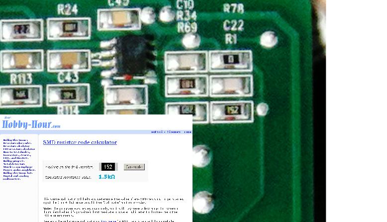

                            #33
                            If its smd that will be more difficult unless it was labeled on both sides
                            I have this, the source is reliable but will depend on whether I asked the
                            correct question so If we can get a second opinion from somewhere.
                            Charles Hyde & Son
                            Hi. If you need any assistance, please feel free to ask me a question.
                            ME
                            Any chance you could advise the vaule of R1 in the KT14 kit for the AD301M24-4N1
                            Charles Hyde & Son
                            We apologize for keeping you waiting. Our operators are busy at the moment, please leave us a message with your email address and we'll get back to you shortly.
                            You are currently being served by
                            xxx - CHS
                            xxx - CHS
                            wait
                            Hi, please wait, we are dealing with your request
                            dave
                            my email is xxx
                            XXX - CHS
                            R1 = 1.5k
                            ME
                            Thankyou very much
                            XXX - CHS
                            Thank you for using our on-line chat

                              #34
                              Selldoor, you are a rockstar! I included a pic of the location of r1. What would cause it to go?

                                #35
                                Didnt really need the second opinion - this is one of the reasons we ask for
                                good clear pictures.

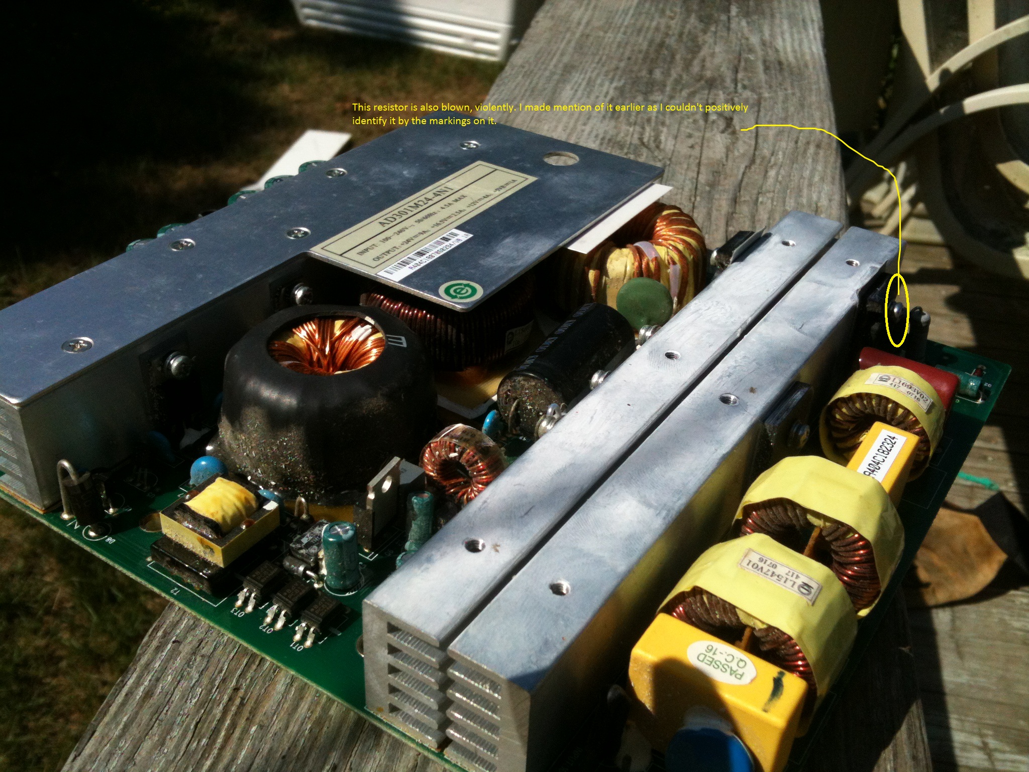

                                    #37
                                    Caps are in the right way, I did not replace all of them, just the noticeably bad ones. Here's some more damage I just noticed, one of the 2 resistors I asked about originally popped. I can't tell if they are resistors or fusibles since they tested like fusibles.

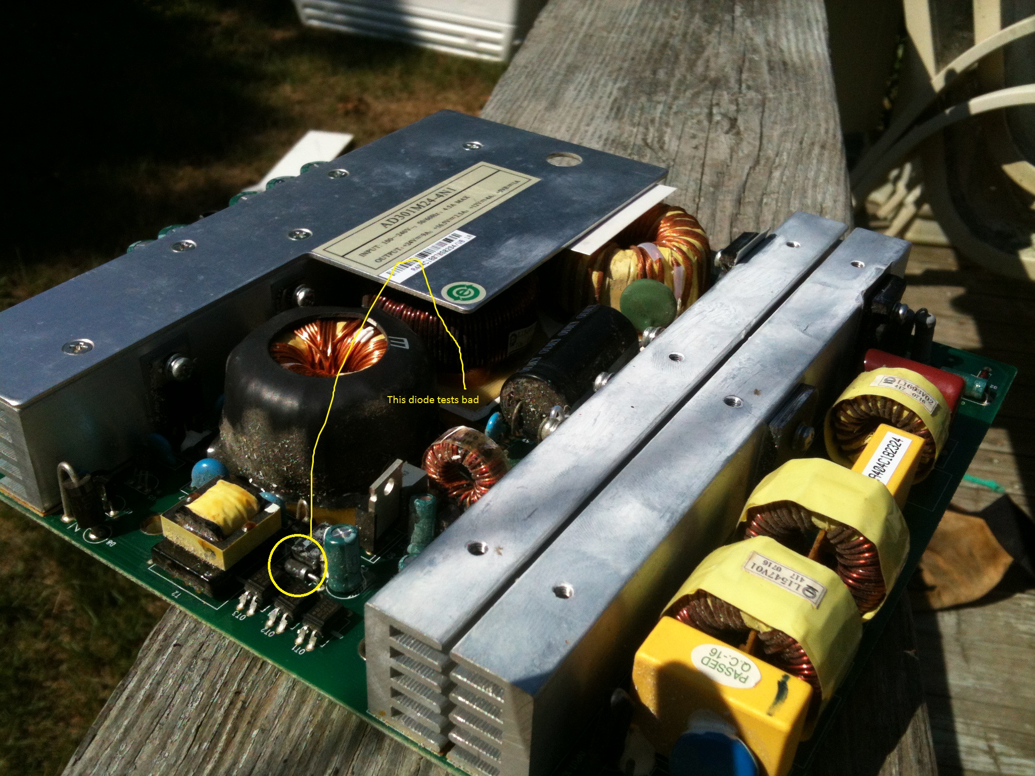

                                      #38
                                      I hope you guys haven't jumped ship on me! I also found this diode to be bad. Is this likely a symptom or a cause? Also can someone please tell me what these resistors are? Thanks
                                        #39
                                        What is the P/N of that IC by the bad resistor as shown in post34?
                                        • avaktech
                                          • Jan 2012
                                          • 68
                                          • US
                                          #40
                                          tny266pn, any easy tests for it? It had a tiny heatsink that popped off.
