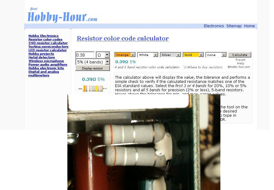

      Also found these two resistors both look fully closed, does anyone wanna chime in on the value for these?

      Resistor values - why not look them up yourself?
      Type hobby hour resistor into your search engine.
      avaktech
      Join Date: Jan 2012[
      Posts: 18
      I noticed the tv repair threads and decided to move over there. Not trying to be pushy, sorry. And yes I did look up the colors on multiple charts and calculators but none of the showed silver or gold in the positions of the ones I pictured. I am guessing they are just fusibles but dont really know.
      Dont look like fusibles.
      OK see attached - please can you update profile with country and mains voltage

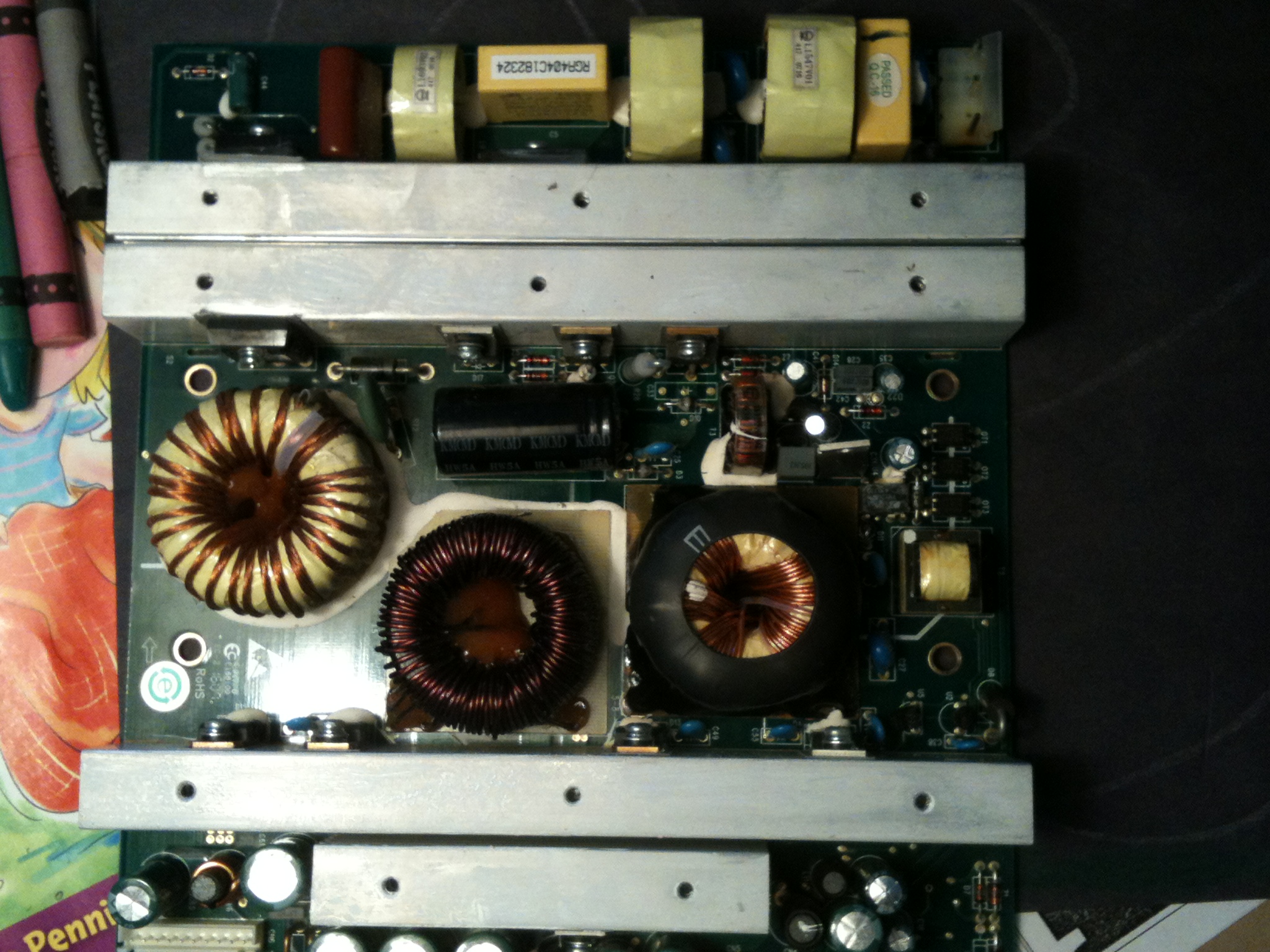

              Alright guys here's some pics, not the greatest

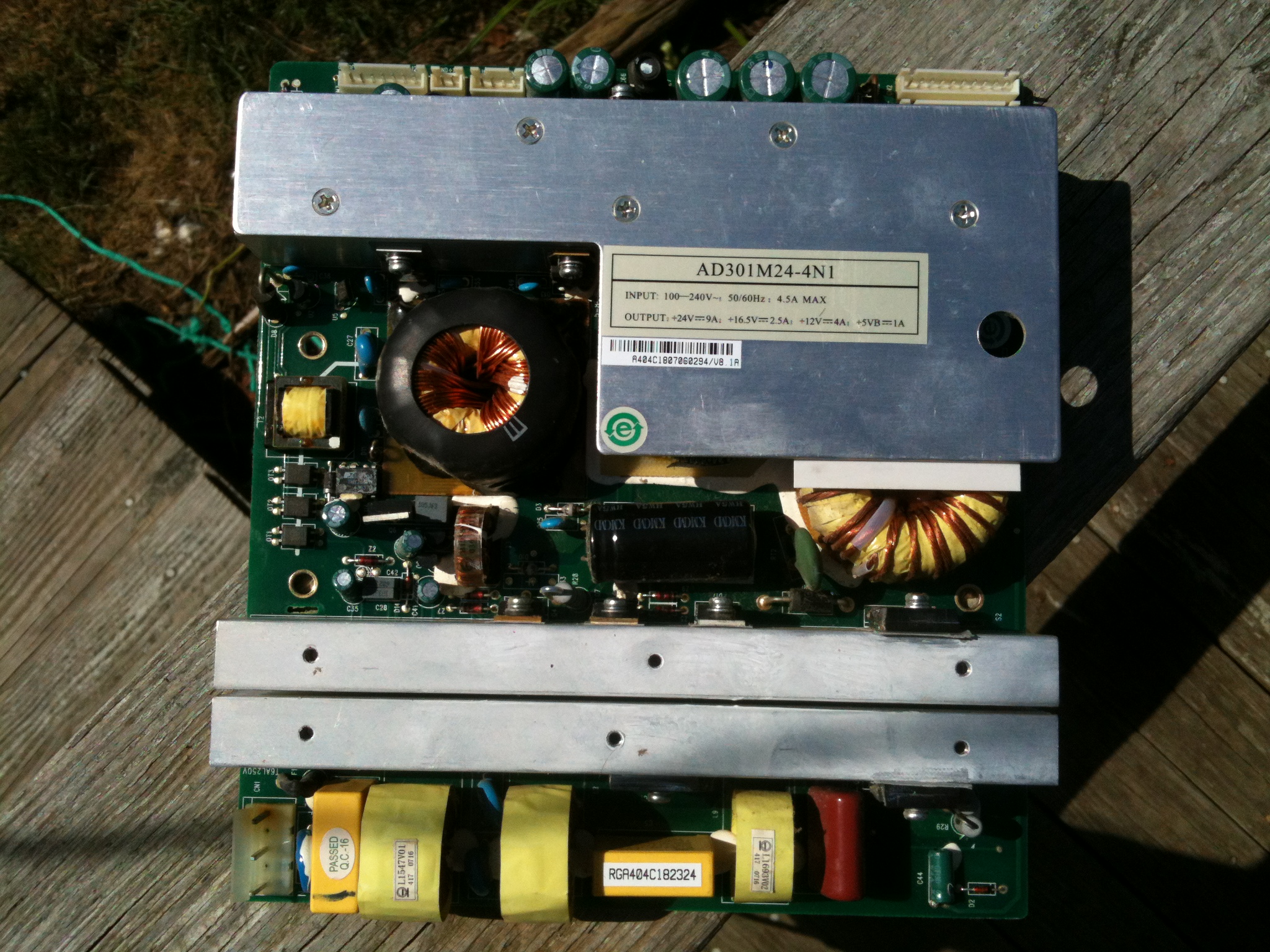

                Re: 42" Spectrincq no power
                Here's another with the other sink cover removed, I'm having a hard time getting the lighting right.
                  I can see some caps with domed tops. This power supply looks familiar, I think TOM have seen this before in VESTEL?
                      Ok good pics - looks like c64 is bulged and possibly the Big cap? may be just the camera angle.
                      Can you locate and test the bridge rectifier, I think I see it in Pic 2 on the heatsink
                      behind the yellow box with RGA404C182324 on it.

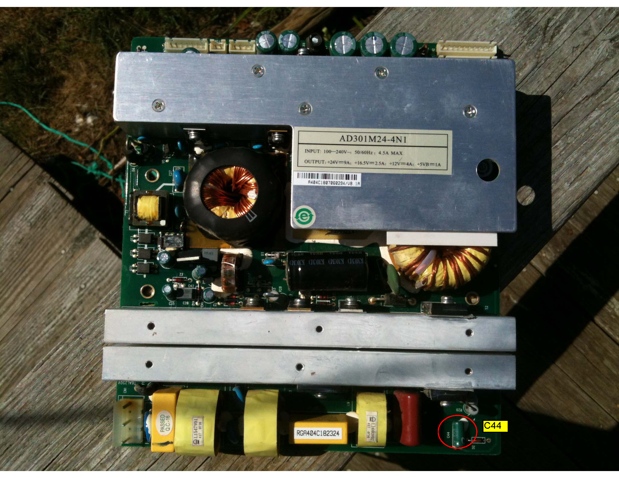

                              Foil cap is bottom right on pic 238.
                              On the left you can see on the 120 connector one of the pins got burned up a bit.

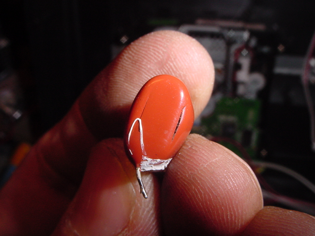

                                That green cap C44? Do you have the value as printed on the body? It is used for snubber circuits and they do go bad due to exposing to high kick back voltage from the transformer, if it goes out, the MOSFET that drive the transformer will be damaged and it can take out the SMPS IC with it also. May be that is why the fuse blown due to BACK EMF of the transformer. You should remove it from the board and see if the body has crack or bulging out to the side. You should also see if it has leakage resistance.
                                See example:
                                http://s807.photobucket.com/albums/y...nt=badcap1.jpg

                                      Budm where you asking about the foil cap at c3? above c44? If thats the case it has nearly no resistance. It looks just like the one in your pic but its a different color. I think its a 105j400v
                                        No, C44 is the green polyester cap at the bottom right corner of the board as you have said in pic238, see post 15. Isn't that c44 you are talking about?
                                        in post1 " Only thing possibly fishy is a closed 400v polyester foil capacitor"
