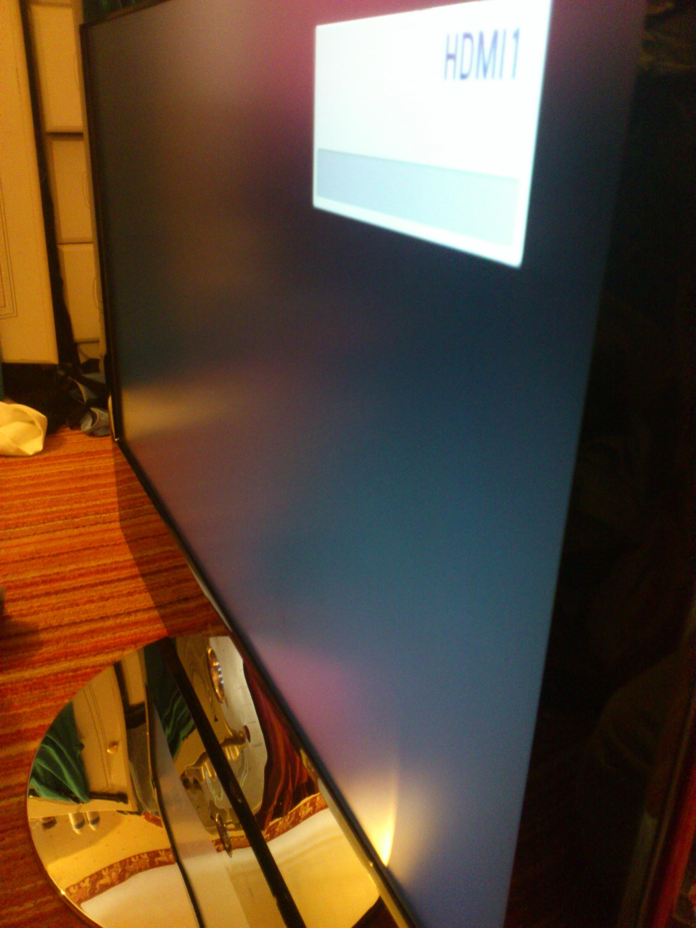

    just retested and i can use the remote for about 2 seconds as the back light comes on and also the buttons, the white led goes from bright white to dim then it doesnt do anything, ive tried putting aerial in and a scart input and that does nothing either, and there isnt enough time to change the input to check if a picture shows up
    i have included 2 more pics, as you can see the menu comes up, but then freezes after a couple of seconds on start up, ill will check the voltage regulators tonight to see if there ok
    first picture is when switched on, then other pic is me pressing the input button on start up, i tried the power button thing....nothing happened...
      Re: 37LG6000 replaced fuse but now cant change input or use remote
      Might be corrupted firmware. Does TV have USB?
        yes it does but i cant find a firmware update or instructions from LG website
        i have managed to get it to tune DTV but it froze just after it got to 100%, so gonna try and get to factory reset settings if i can
        i have seen some firmware updates available to download but not from LG so wasnt sure if i should download it?
          LG service menu - Try pressing "OK" on remote while pressing "OK" on TV.
