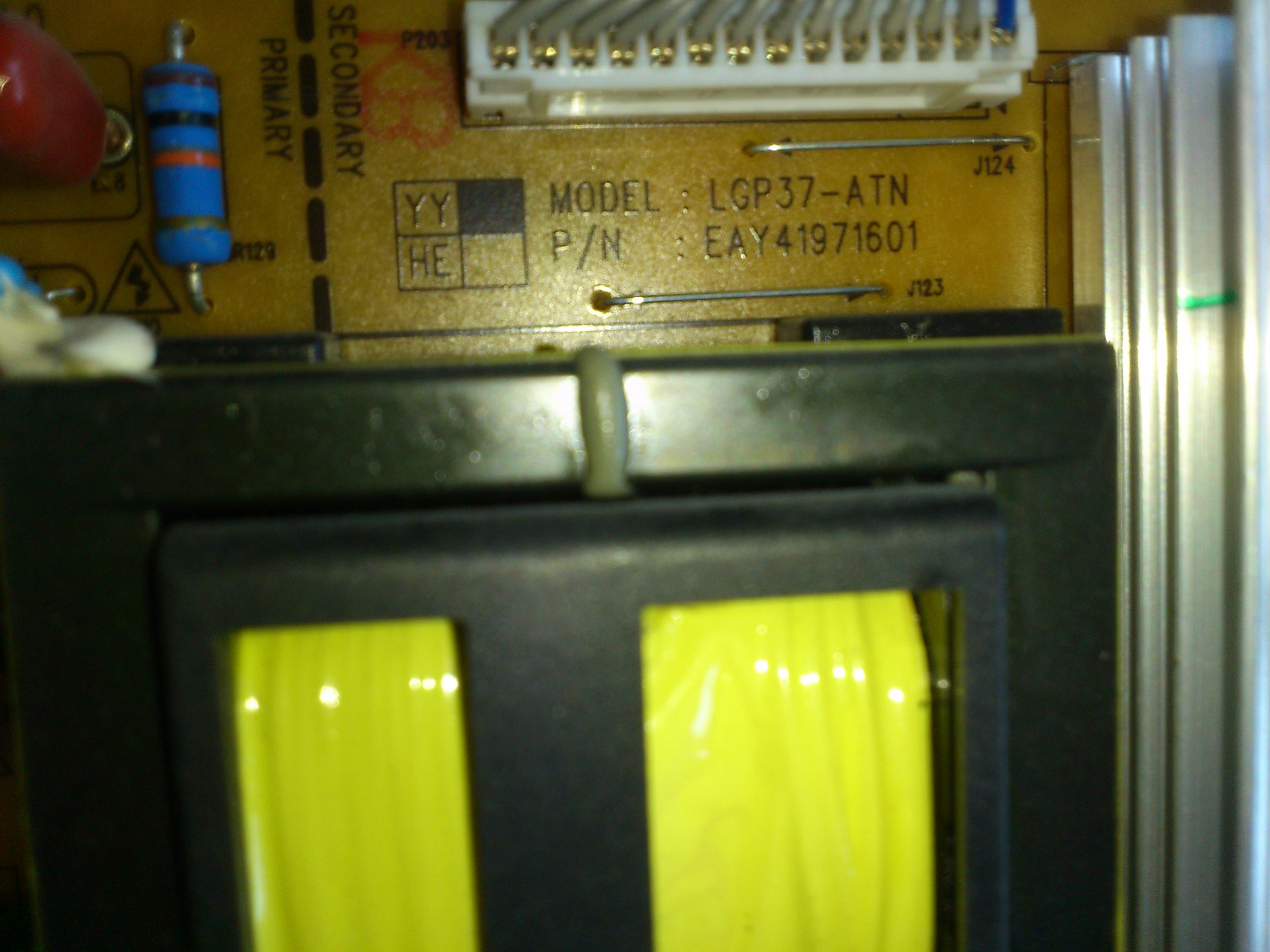

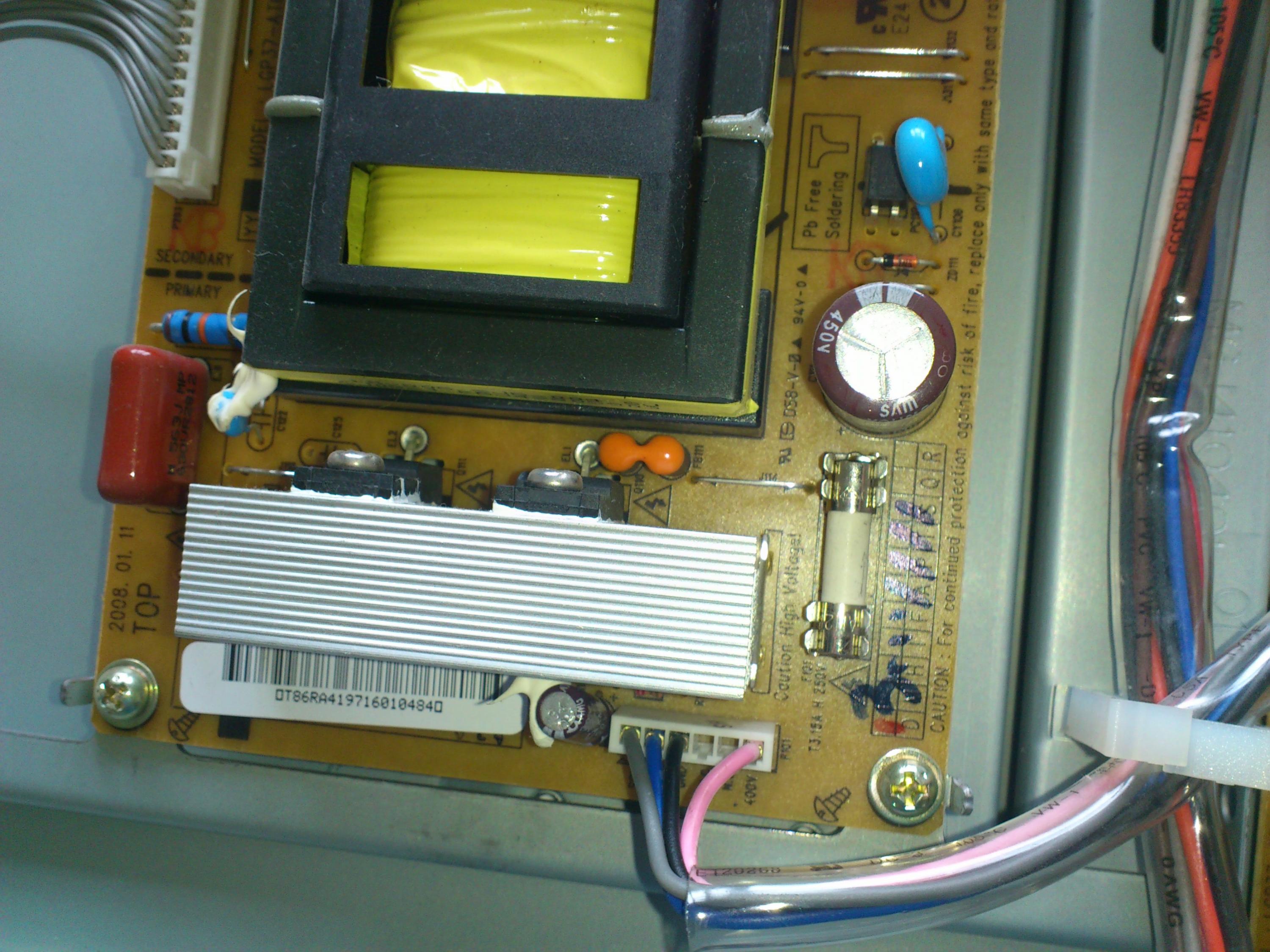

    changed a fuse in the power supply everything else looks fine tested for shorts and was fine, so powered back up and i get HDMI1 comes up in the corner and thats it no input through it, the side buttons dont work either and the remote turns the tv on and thats it, any ideas guys?
    will post some pics of main board tomorrow, but is there some kind of reset i can do with the remote or buttons or anything?

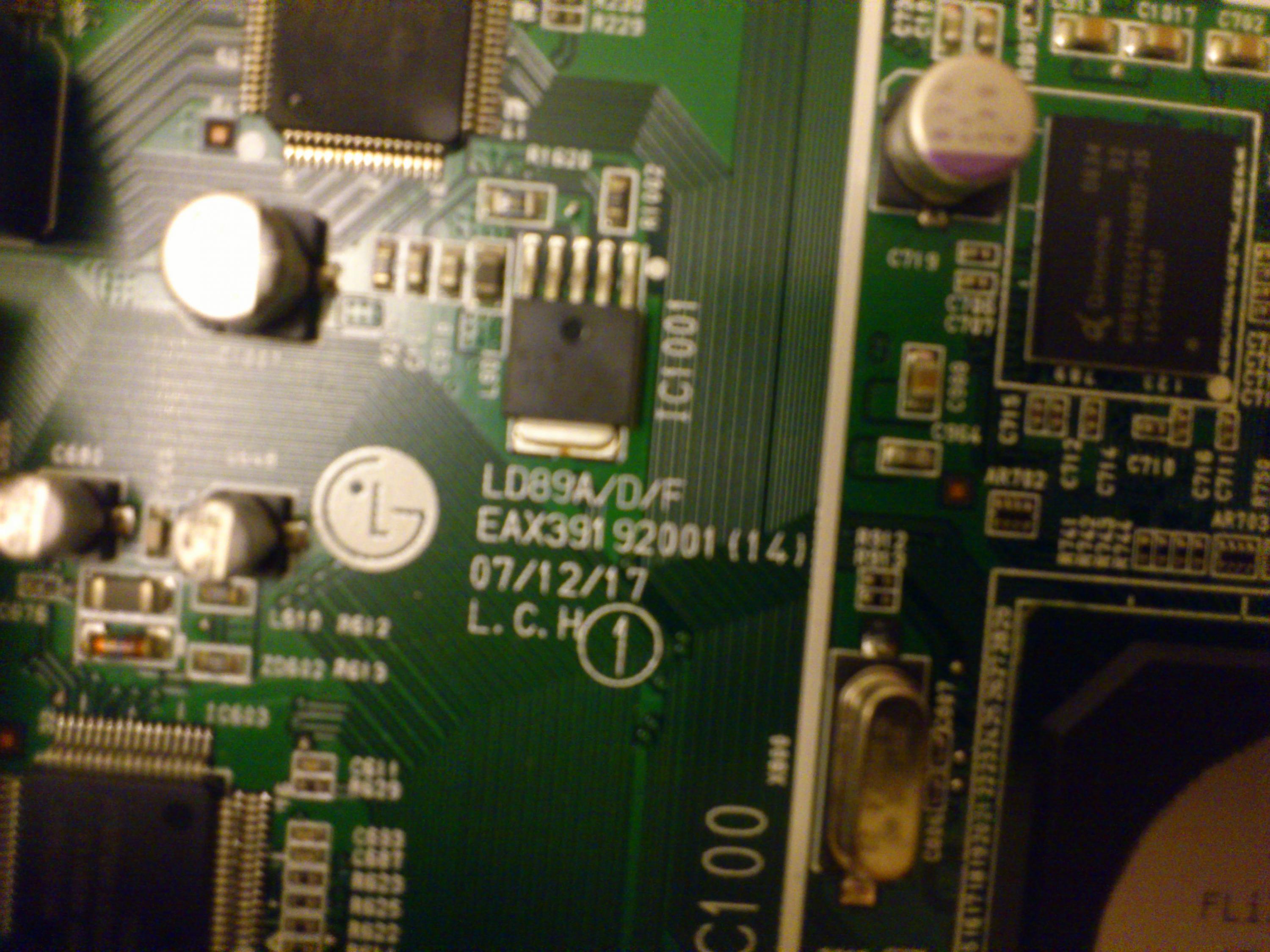

    Check 3.3V regulator on main board, 3.4V from PSU. Had similar issue with LG 37LC2D.

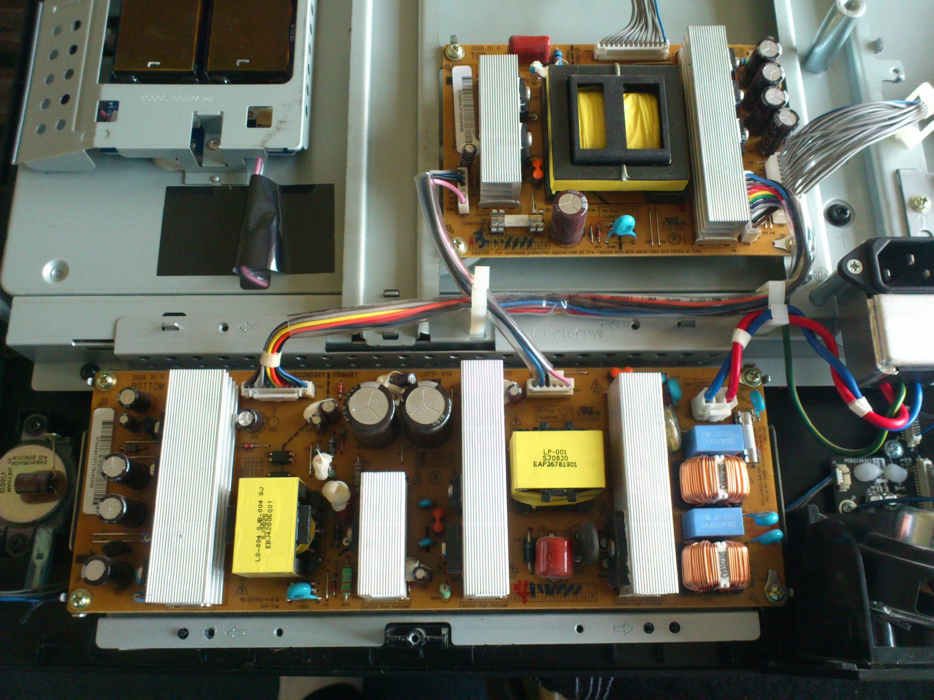

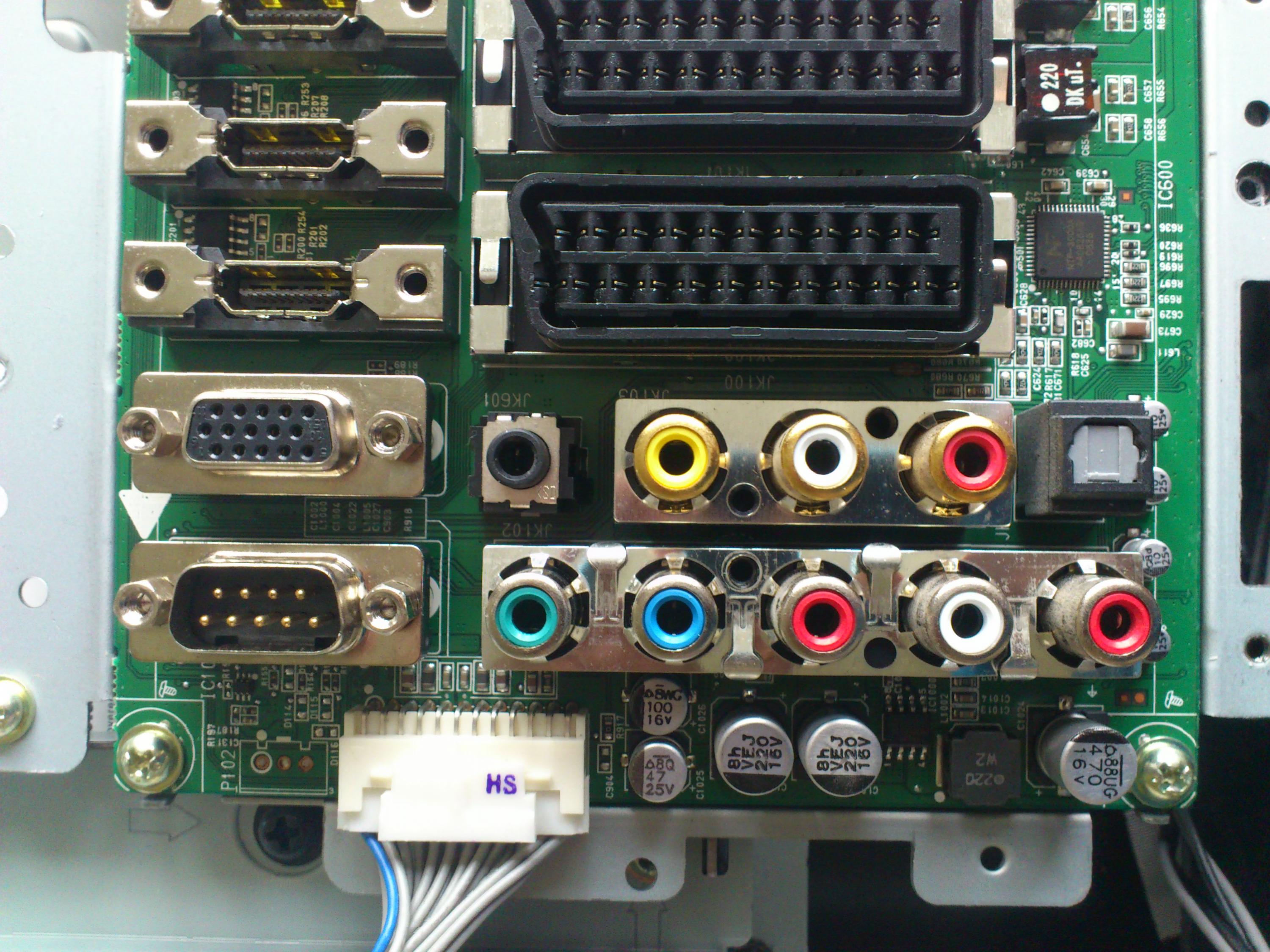

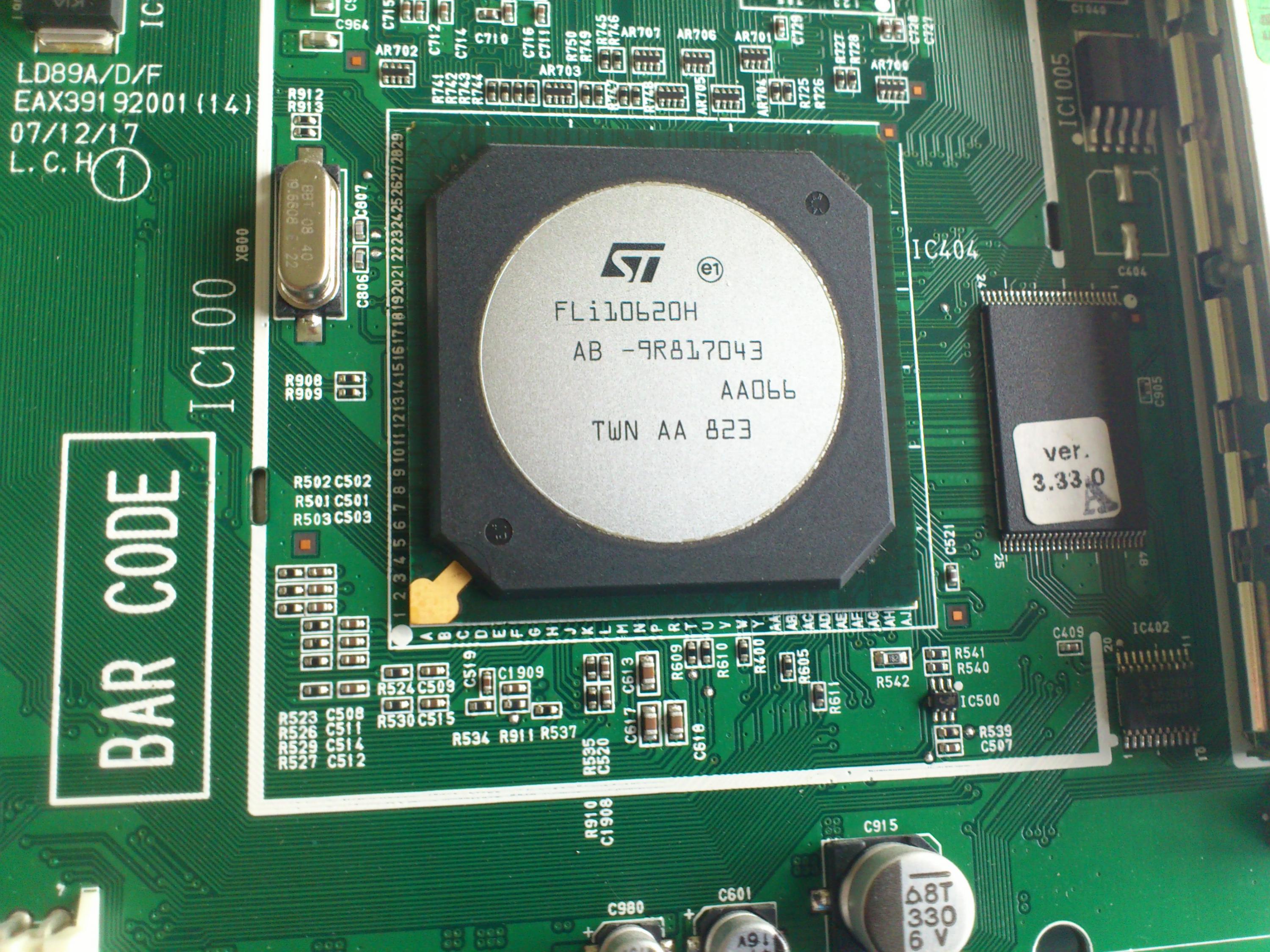

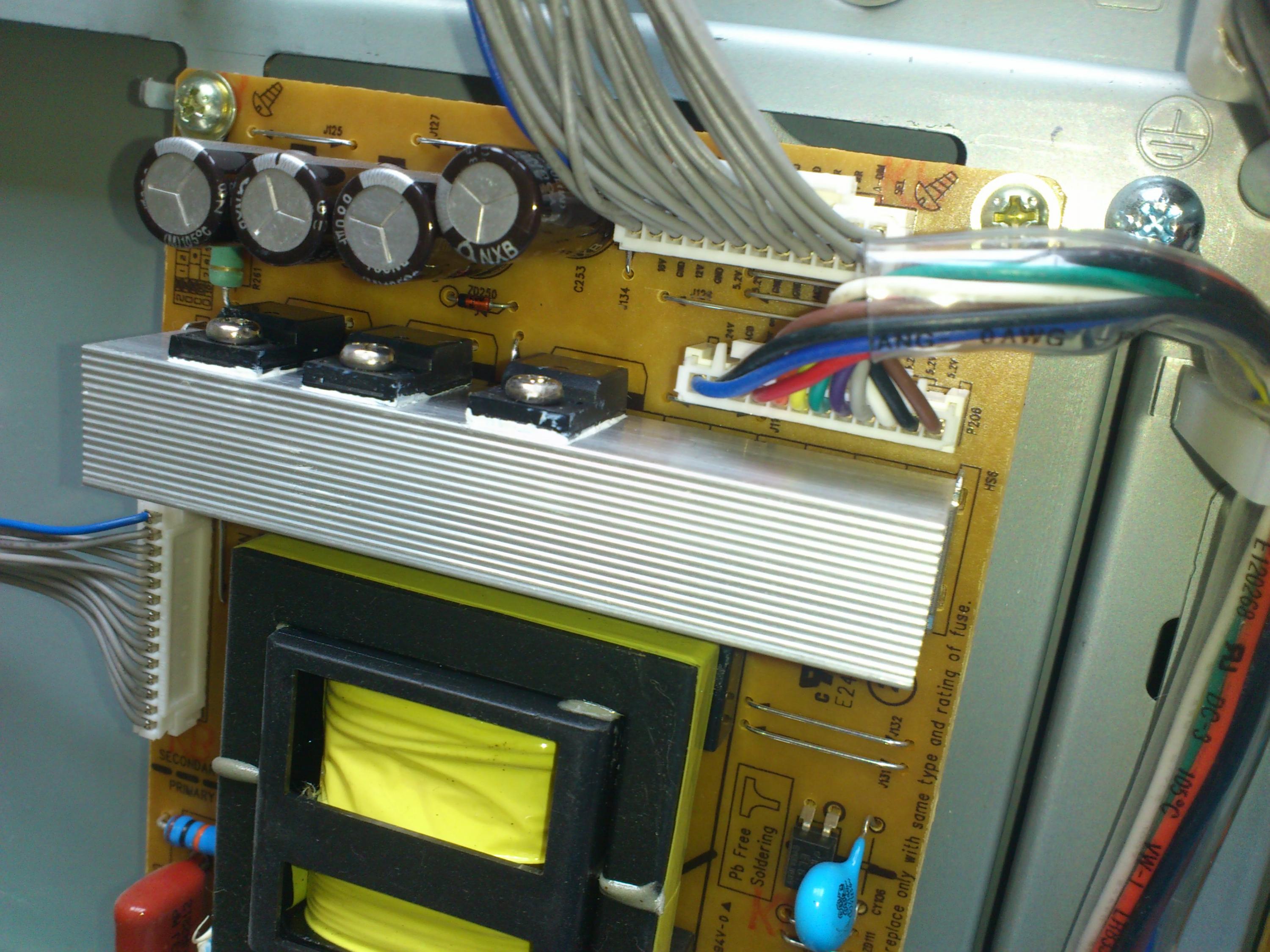

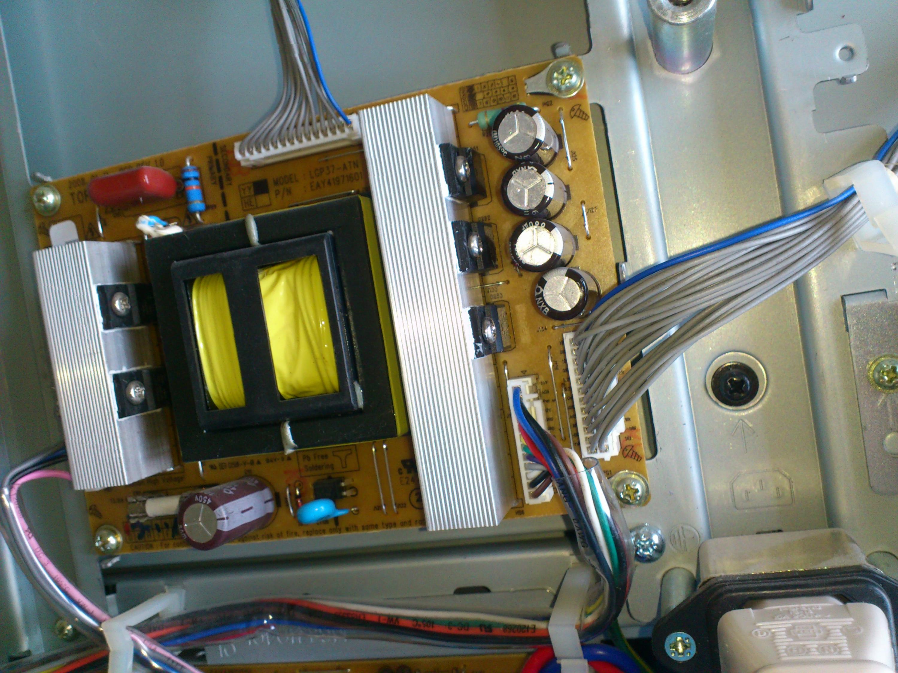

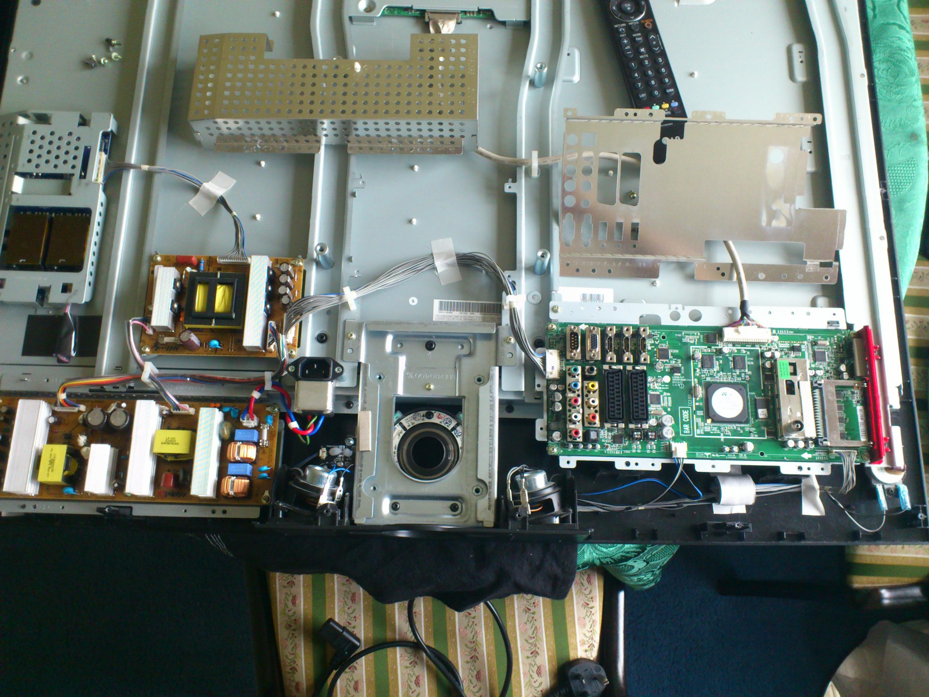

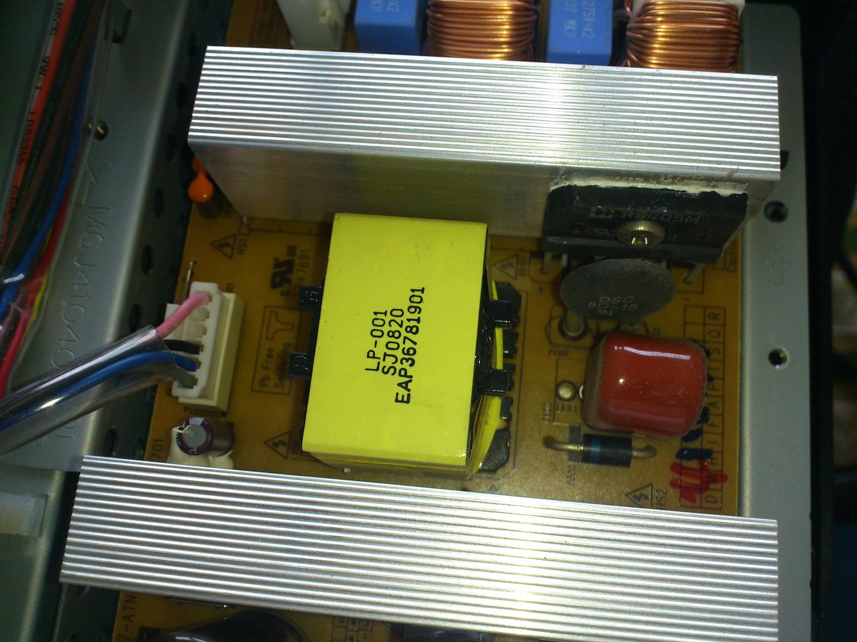

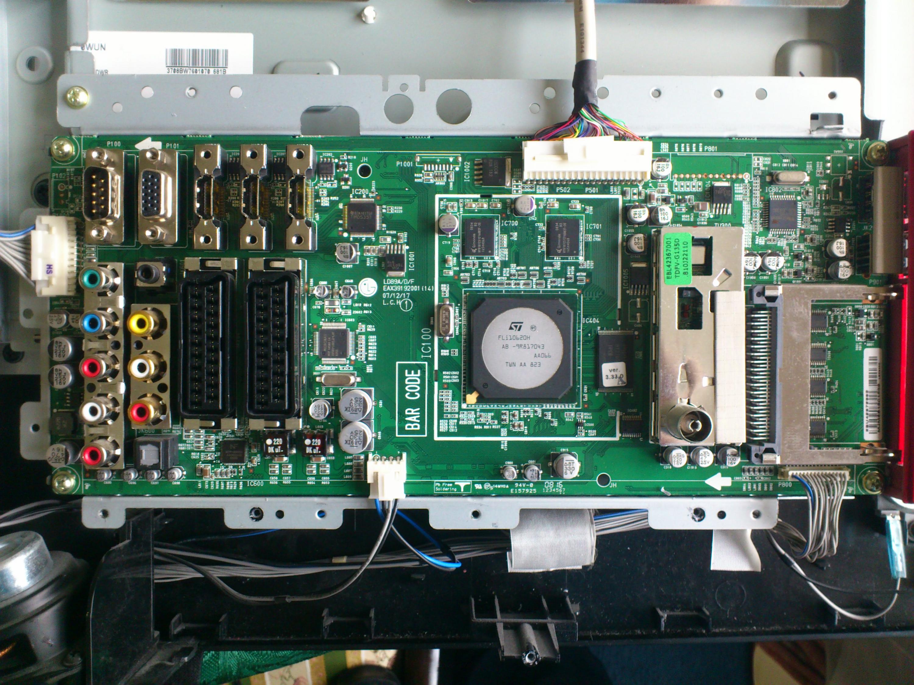

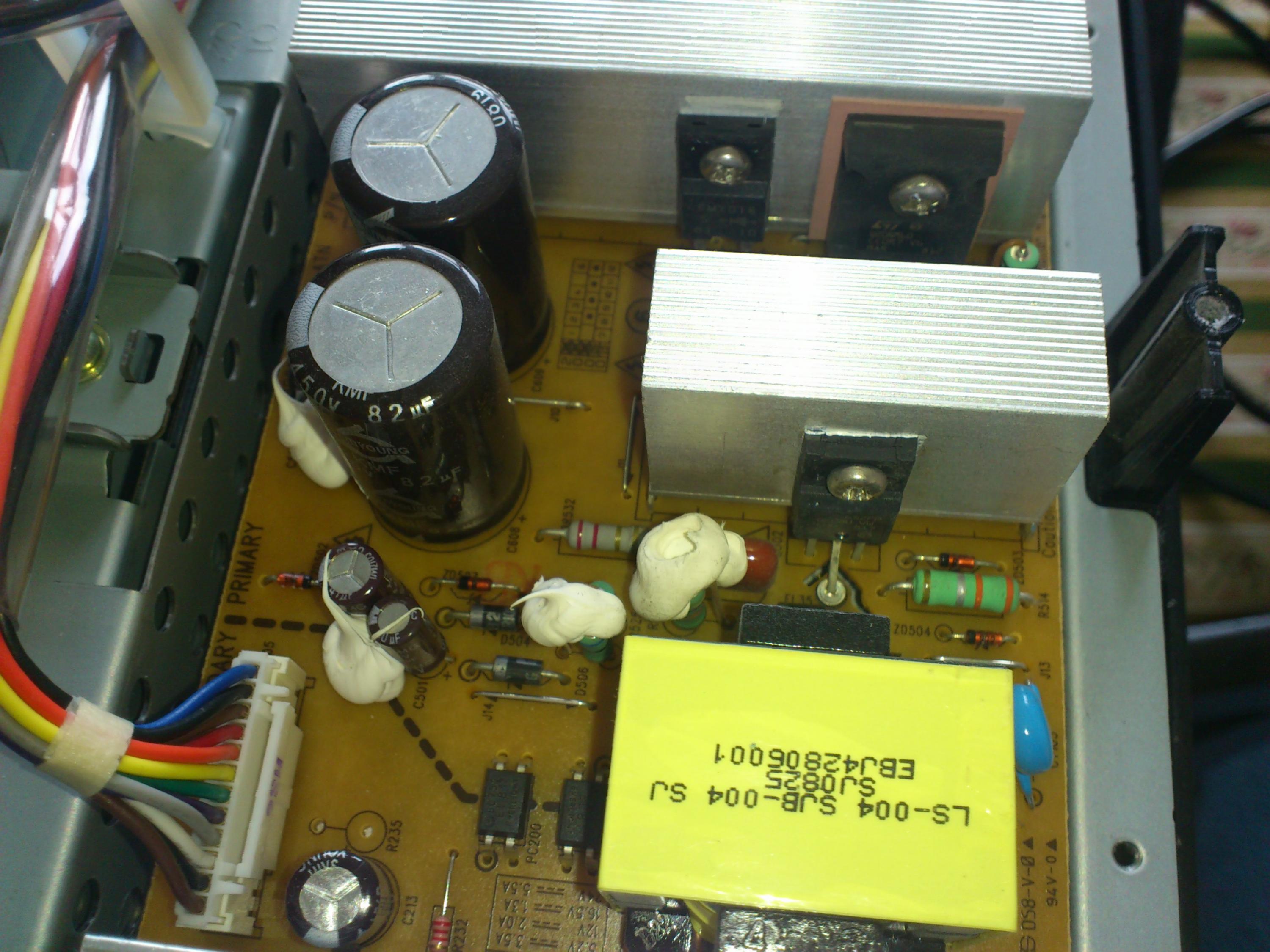

        finally got the computer to connect to my phone...so here are the pics...
        there is no 3.3v, how ever there is 3v for PWR that goes from power supply to other power supply board then goes to the main board, all other voltages are correct 5.2v 12v 16v
        cant find the voltage regulator that you speak of?

              Re: 37LG6000 replaced fuse but now cant change input or use remote
              Right in the middle of Picture 4? IC1001
                will check it tomorrow night, thanks selldoor, is this a common fault? and is that the likely cause of the fuse on the power board being blown?
                  Three others on this forum have reported it with 37LC2D - but all have been regarding the 37LC2D and not 37LG6000 which is completely different.
                  Probably not, possibly another fault.

                    with all the voltages being correct on the power supply and the tv powering up and screen coming on i was thinking it would be a main board fault especially with the remote and the buttons not working correctly as well, so the only cause would be a power surge or a blown component and if a component was faulty i would of thought the fuse would have blown again when i replaced it?
                    i will test IC1001 tomorrow and report back
                    i have looked for a main board for this and so far havent found one, so fingers crossed its that IC and hopefully i can replace that with a bit of precision soldering and a lot of praying ;-)
