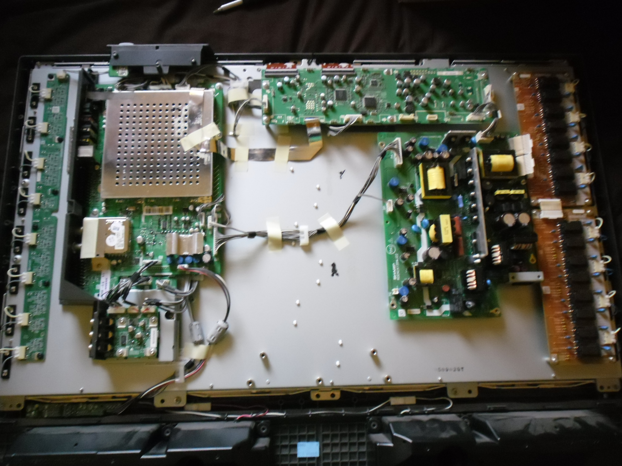

    The tv is stuck in standby mode so i've been told.
    Green led flashes 1 or 2 times on front, also the red opc led flashes 1 or 2 times.

    Does the relay in the PSU make clicking noises? If so there might be a short circuit which could be preventing the power supply from starting up.

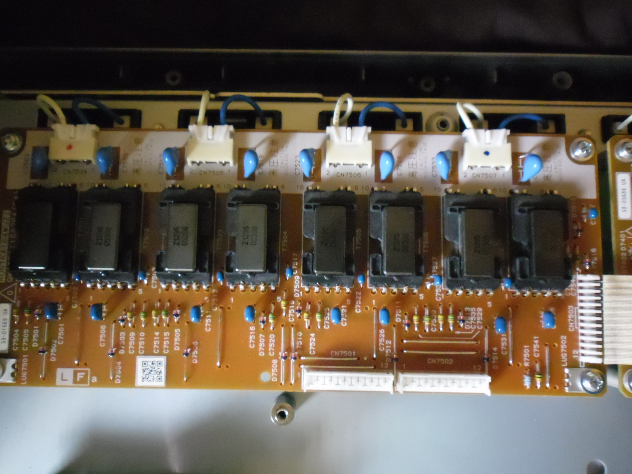

    Try un-plugging the inverter boards. If the set turns on ok (won't have any backlight thought), one of the inverter boards has a fault. If not, then there is a problem on either the PSU, the A/V board or t-con.

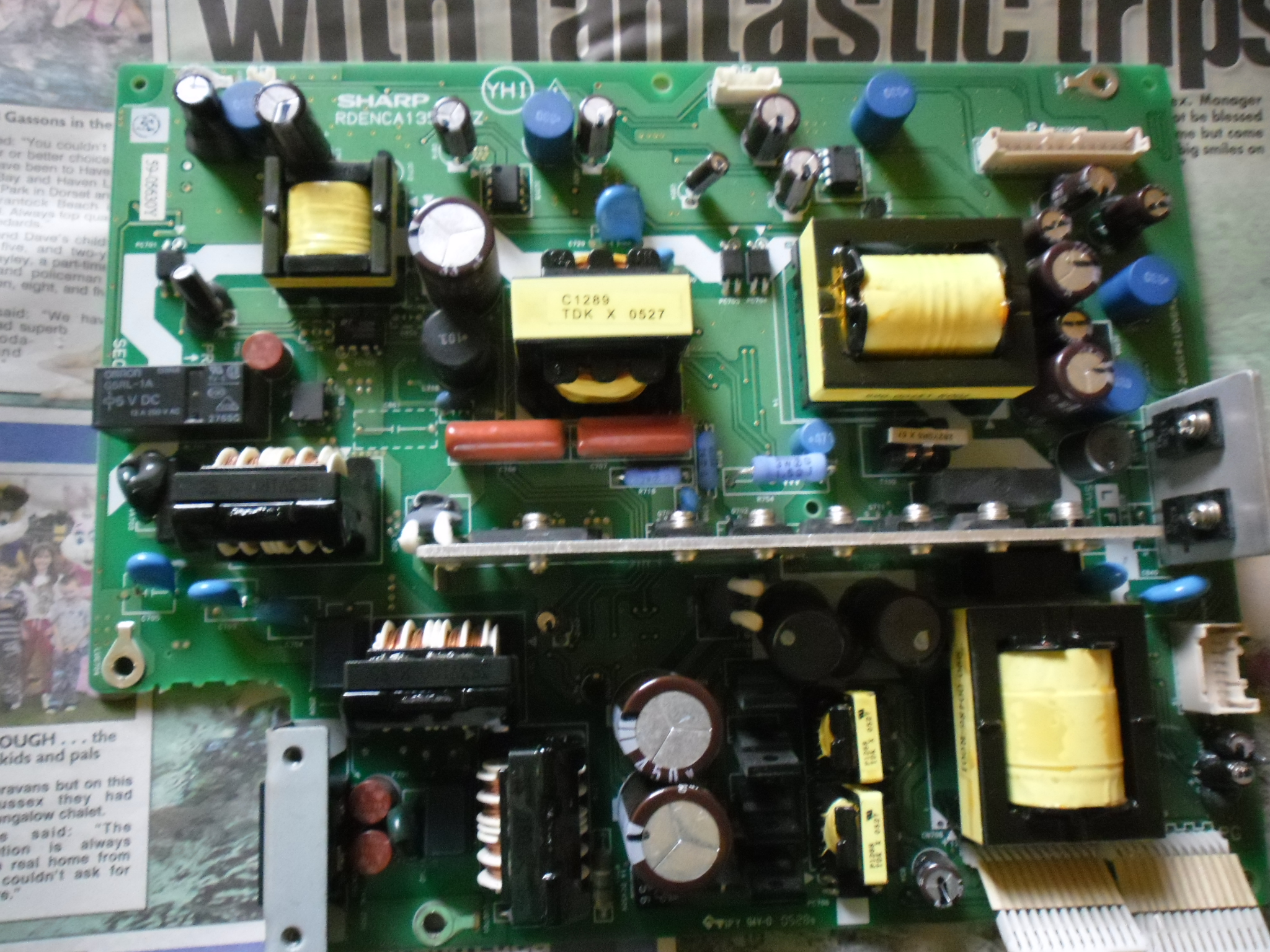

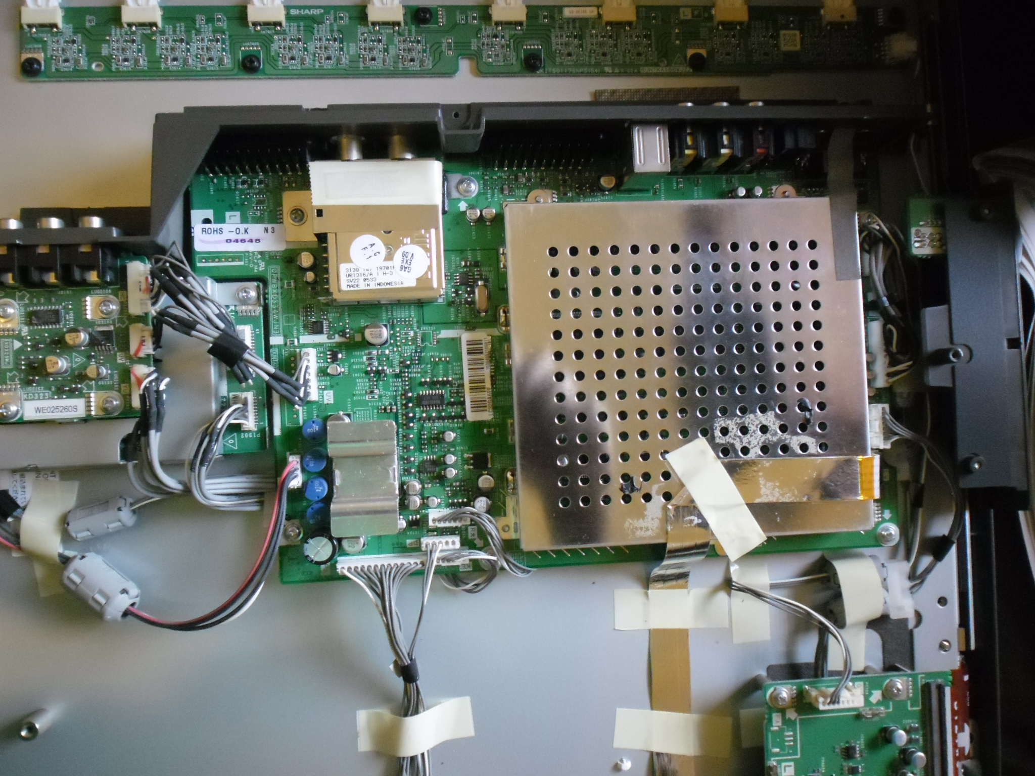

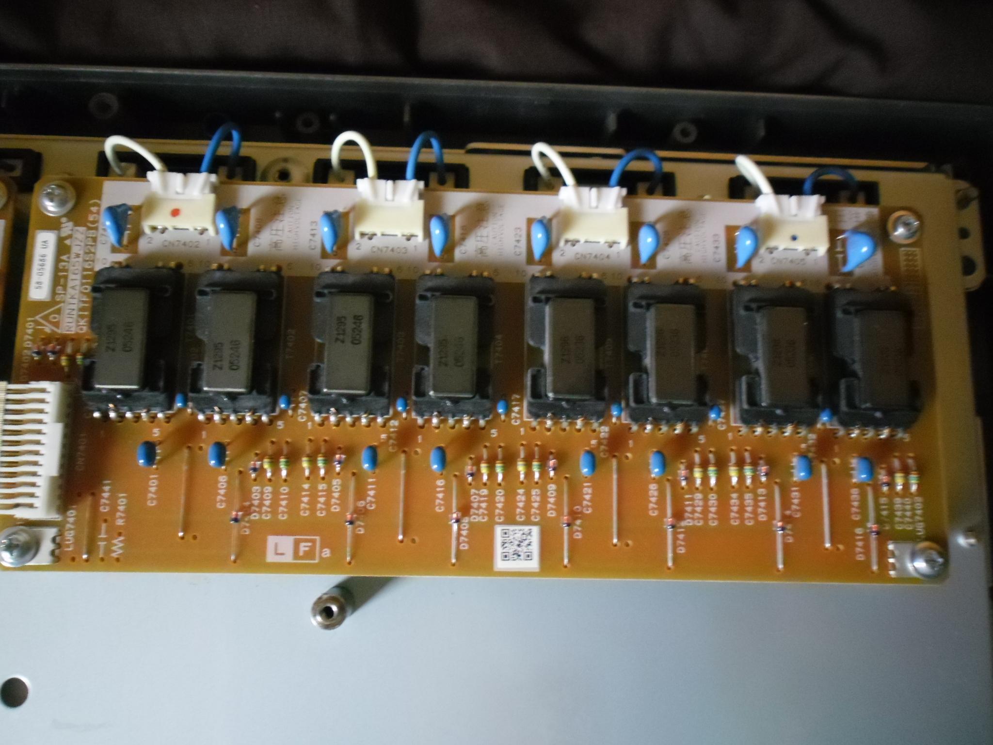

      Hi- Pic s are a bit better this time. Cant spot anything adrift.
      There are 3 red barrel fuses on the power board - should be ok
      but perhaps you can check them. Cant see any on the inverter board
      but there are components labelled FL which I think may mean they are fusible links. I can see 2 but may be more. You can check them as if it were a fuse.
      Next time it is on record exactly how many times each light flashes
      and if there is a sequence - it may be an error code.

        I was just thinking the backlight inverter may be shorted, so he could check it and rule it out

            you need to be checking output voltages on the psu,is there a standby voltage? ,most prob marked 5V-STB or 3.3V-STB ? if it is missing then the tv wont power up.
            its either a shaky camera hand or dodgy light,but just too the right of the large wiring harness ,there looks to be a cap that looks bulged?

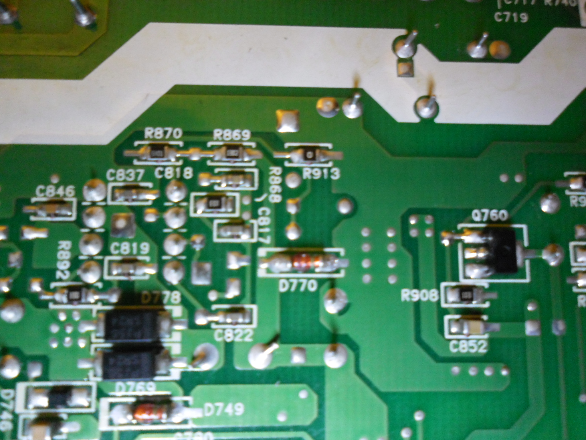

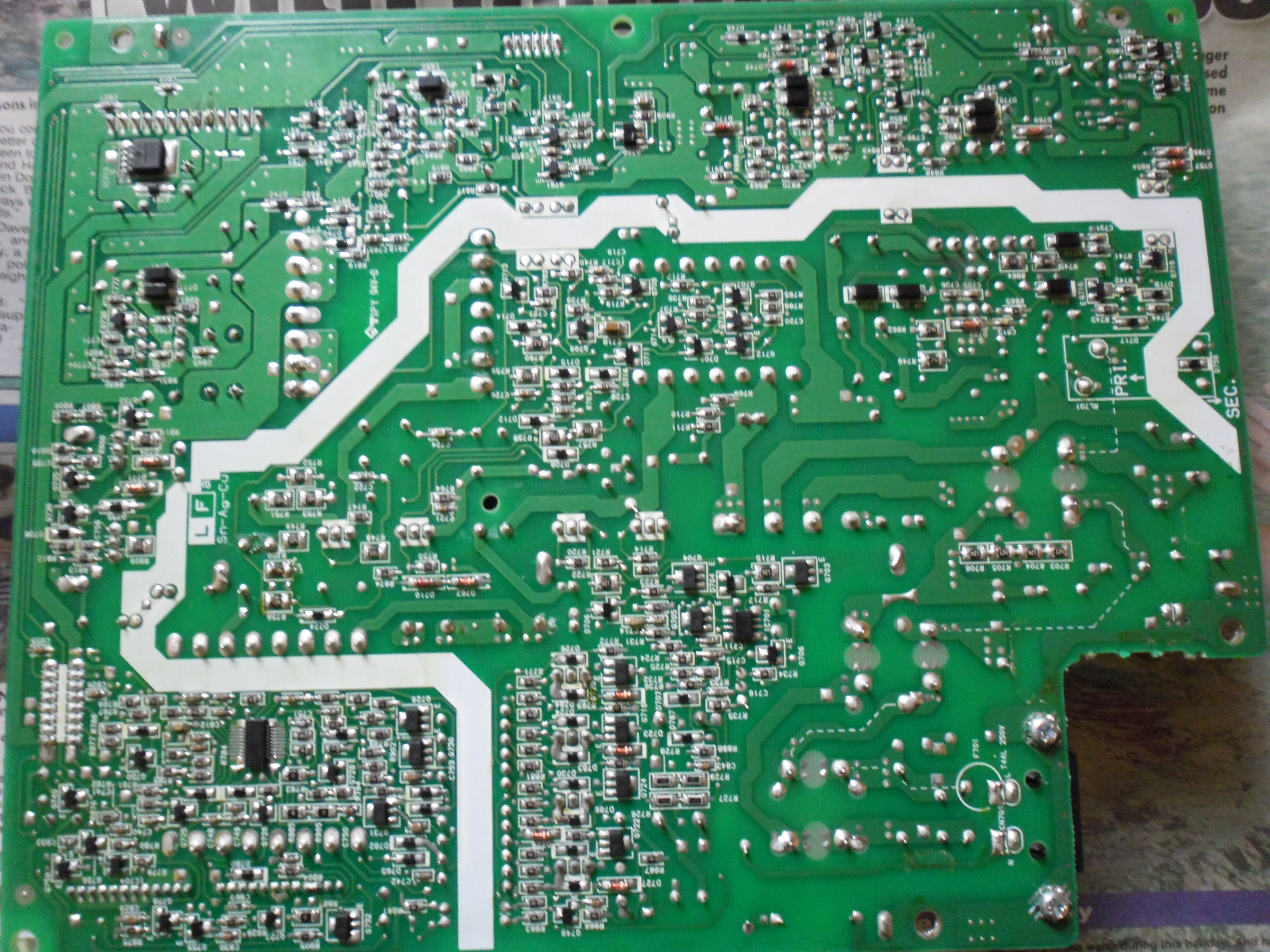

                        Tom66 the rail with 6 mosfets running down the middle of PSU, i got a plastic comb and just starting tapping it, backlight come on. its been on for like 10 mins now.
                        Ive connect now freeview box, but i dont know how to get the tv too see it. the radio is working tho.
                        The tv has never been setup on freeview before. so its still got the analogue settings bbc1,bbc2 etc.
                        tho i could just plug it in and it should see the freeview box?
                            Yeah sounds like cold joints there, take the PSU out and reflow all the joints on large heatsinked components with a soldering iron.
                            Try using the input or source select button to select the freeview source, or refer to the user manual.

                                Sorted i will never try repairing tvs when ive drunk 2 bottles of Bulmers Vintage Cider again.
                                Guess whot i done, i plug the lead from the back of the freeview into this tv, also the aerial connector.
                                When i should of tooken the leads from the back of my tv.
                                Sense ive tap those mosfets its been working, so yea look at soldering all that area in the morrows.

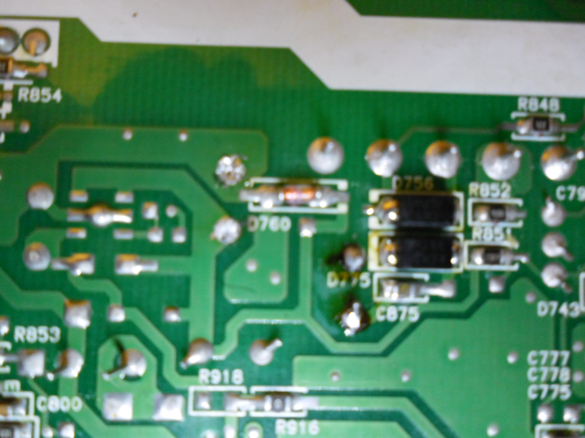

                                        Thought i had solved the problem, had a few mixed results, unplugged tv left for few minutes, tv came back on but only for a minute or so. That was sunday morning tried and tried still didnt come back on, led to the front is solid green, it dont go into standby mode which the led to front should be red.
                                        Tried yesday monday tv still didnt work, so today i tried go more indepth.
                                        On the back of the PSU Board theirs 2 diodes (D770) (D760)(i think their diodes label as D*** in clear glass type with red stripes) probes correct way give me .145 also if i reverse probes on (D770) readings kinda races up to "OL"
                                        On the D760 diode probes correct way gives me .145, reverse it stops on 1.646.
