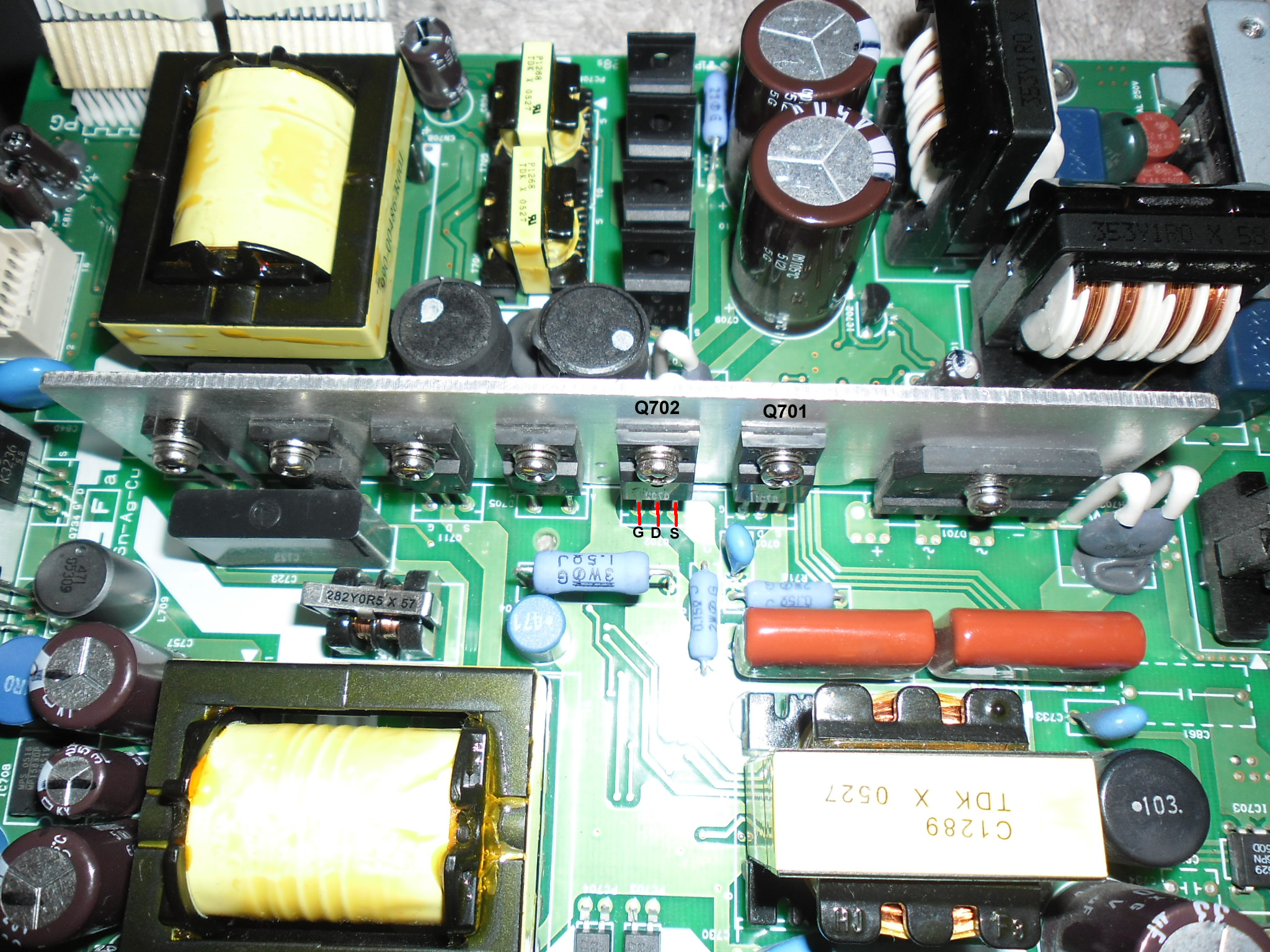

      Need a little help does these readings sound correct?
      Meter set to diode
      Q701 reads:-
      Black probe on G, Red probe on D = OL
      Black probe on G, Red probe on S = 1.267
      Black probe on D, Red probe on S = .476
      RED probe on G, BLACK probe on D = OL
      RED probe on G, BLACK probe on S = 1.164
      RED probe on D, BLACK probe on S = OL
      Q702 reads:-
      Black probe on G, Red probe on S = 1.272
      Black probe on D, Red probe on S = .475
      RED probe on G, BLACK probe on S = 1.153
      Are they ok?

        Those readings look good.
        I suspect a bad cap in here, especially with the random on/off issues it is having.

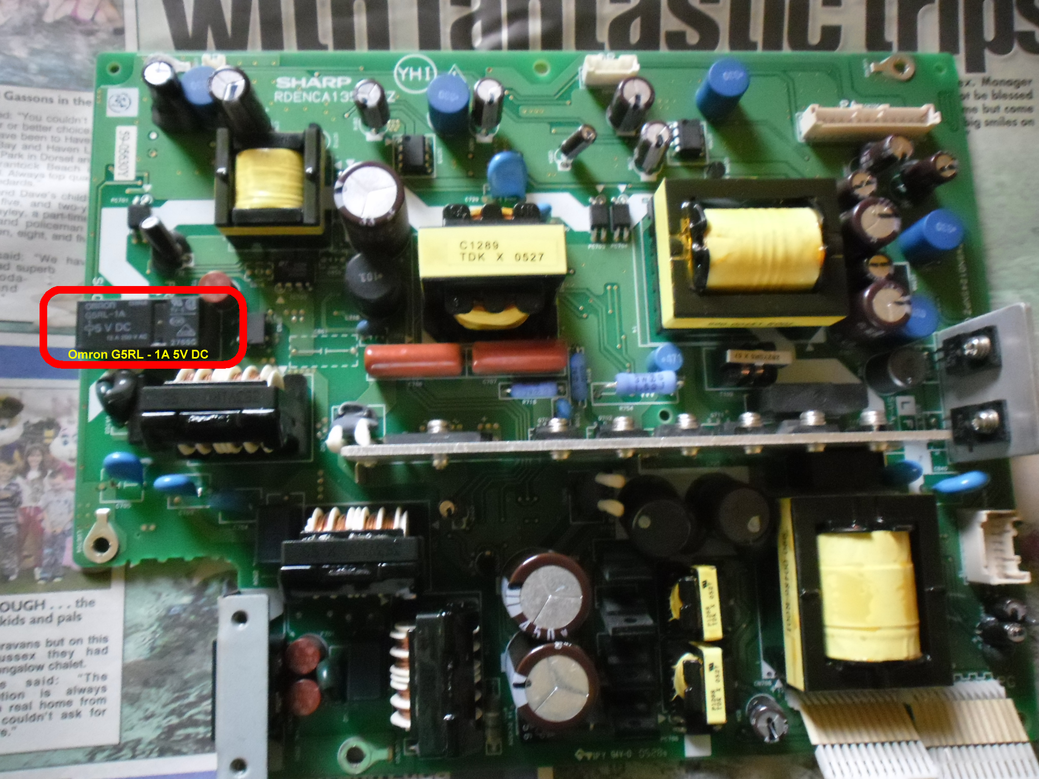

            Still no joy, the whining sound is coming from this relay, i recapped nearly the whole board yesday apart from the large caps.
            Can anyone piont me what directions i should take next.

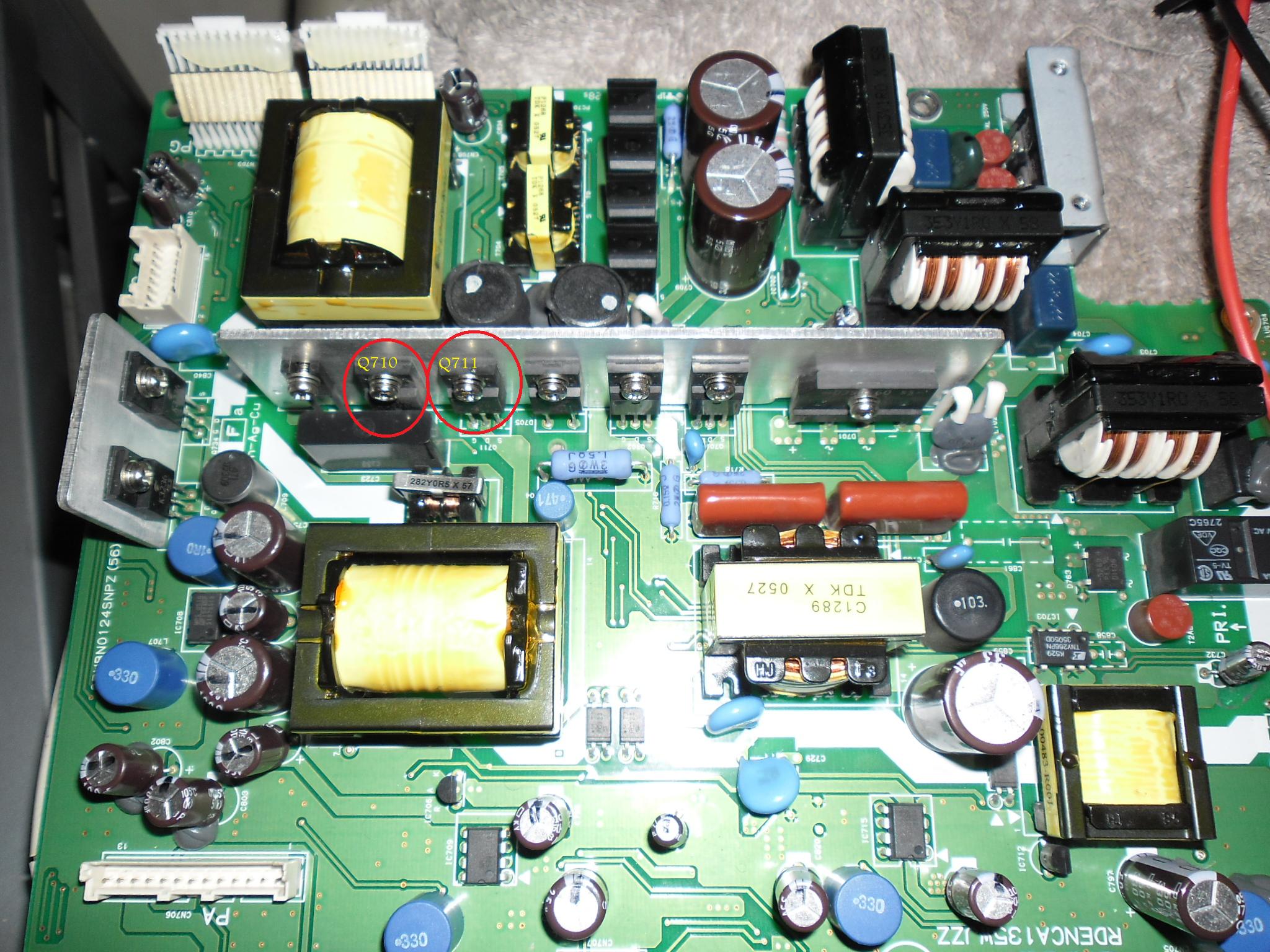

                    Sorry just a quick heads up, are theses readings correct
                    DMM set to 2k diode:>
                    Q710:
                    Red probe on G - Black probe on S = .322
                    Black probe on G - Red probe on S = .322
                    Red probe on G - Black probe on D = .913
                    Black probe on G - Red probe on D = 1.
                    Red probe on D - Black probe on S = 1.
                    Black probe on D - Red probe on S = .524
                    Q711:
                    Red probe on G - Black probe on S = 1.
                    Black probe on G - Red probe on S = 1.094
                    Red probe on G - Black probe on D = 1.
                    Black probe on D - Red probe on S = .523

                          I don't see anything obviously wrong with your readings.
                          Does the board still whine?
