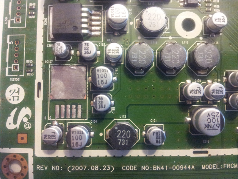

                      1) There are 4 caps around IC107. Which one or ones (using the positive leg) have continuity to pin 4?
                      2) Can we get a close up picture of that area (IC107)? Front and backside.

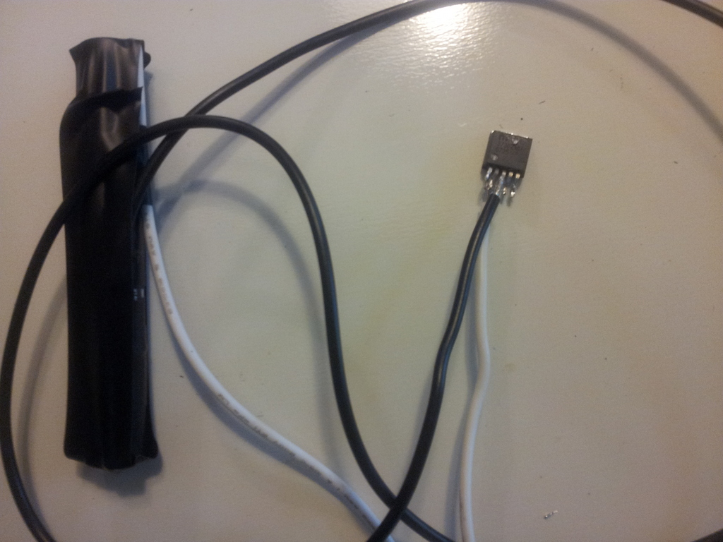

                        I setup the battery test on the old voltage regulator and I'm not seeing any voltage on pin 4.
                        C104 has continuity to pin 4 on the regulator.

                            I'm not really an expert with linear regulators like budm and retiredcaps are, so I can't say if that regulator is bad or not. However, I was wondering if the problem could be possibly caused by something else. Particularly, have a look at this picture again on page 1:
                            https://www.badcaps.net/forum/attach...6&d=1341687191
                            On the lower right corner, there are a bunch of SMD ferrite beads that look very charred. Or perhaps that is dirt/flux - I can't tell for sure.
                            My suggestion would be to try and clean that part of the board with isopropyl alcohol and retake another picture of the area. Also, check all of the ferrite beads with your multimeter - those are the components labeled with BDxxx (where xxx is a number). Personally, I've never seen one go bad, but it should take just a few minutes so might as well do it. To test those ferrite beads, set your multimeter to measure resistance (if you're using a manual multimeter, set to the lowest resistance scale - usually 200 Ohms) and check the resistance across the bead - it should read very low Ohms or ideally zero ohms and not "1" on the left side of the screen or "OL".
                            Also, there's quite a bit of discoloration on the board from those linear voltage regulators. Just FYI, about 2 weeks ago I bought a TV on craigslist in "as-is" condition. TV would power but display lots of random colored pixels on the screen. As it warmed up, the random colored pixels would slowly disapear and the picture would go back to normal. I found the problem to be bad BGA joints on a RAM chip caused by excessive heat from nearby linear voltage regulators (they were actually right under the RAM chip, just on the other side of the board). Whoever designed that main board is either a moron or a planned obsolescence design genius.

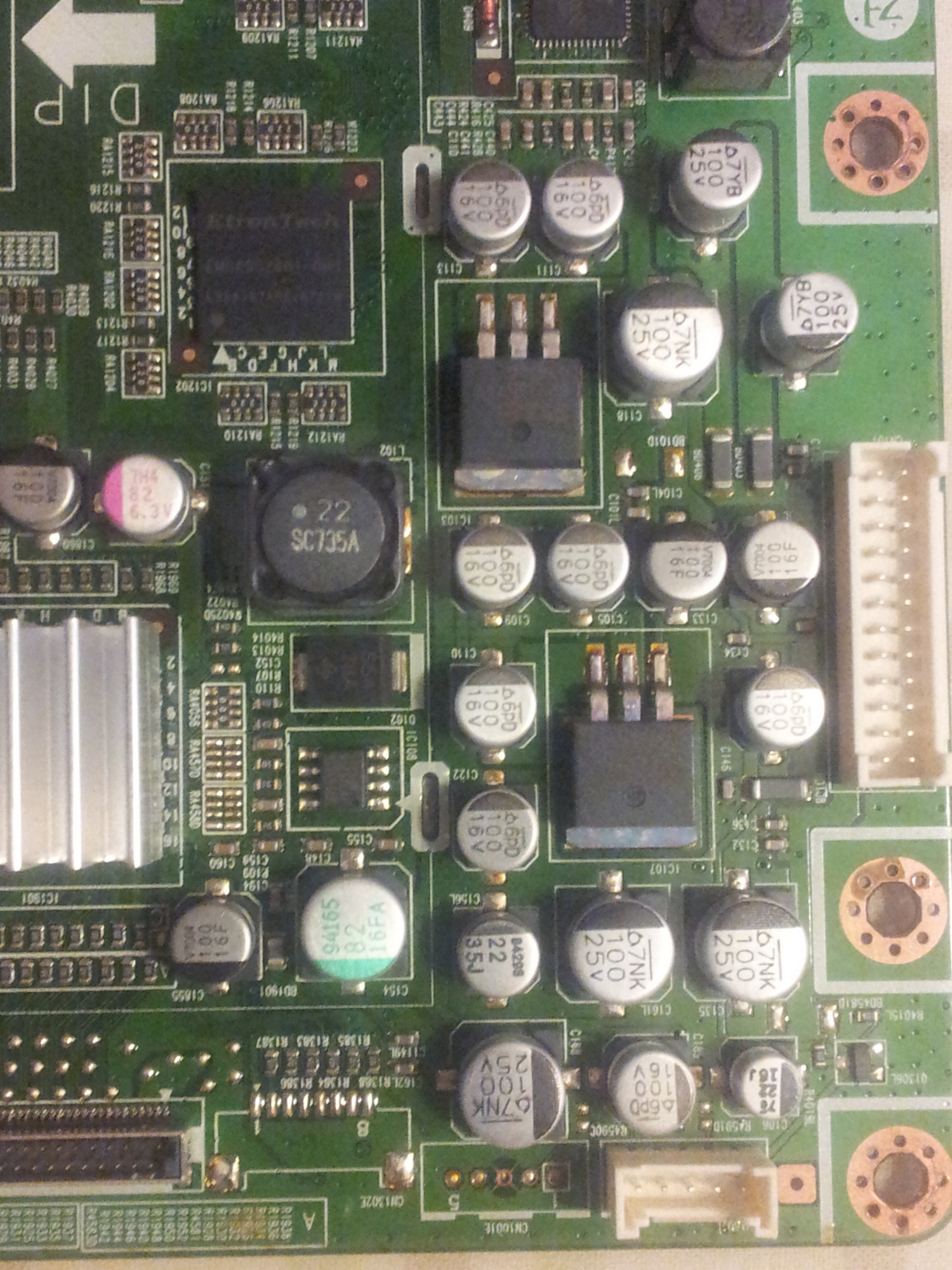

                            With that said, I think your problem could also be cracked BGA joints. Looking at this picture,
                            https://www.badcaps.net/forum/attach...5&d=1341687191
                            it seems there are 3 BGA chips in the upper right corner of the board (one is under a small heat sink). If nothing seems to fix the board, you could try reflowing those BGA chips. Oven reflow method may not work due to all of the caps on the board, but hot air (mostly from the underside and then a bit on the top side) may work.
                            The last thing I can think of is if some of those caps next to those voltage regulators have gone bad due to the excessive heat. But for that you'll need to have an ESR meter to check them with.

                              I'm not understanding you. I assume you are refering to the testing of the voltage regulator.
                              Battery + =pin2
                              Battery - =pin3 (ground)
                              Measure voltage from pin4 to pin3(ground) to test
                              Where is the on/off pin?
