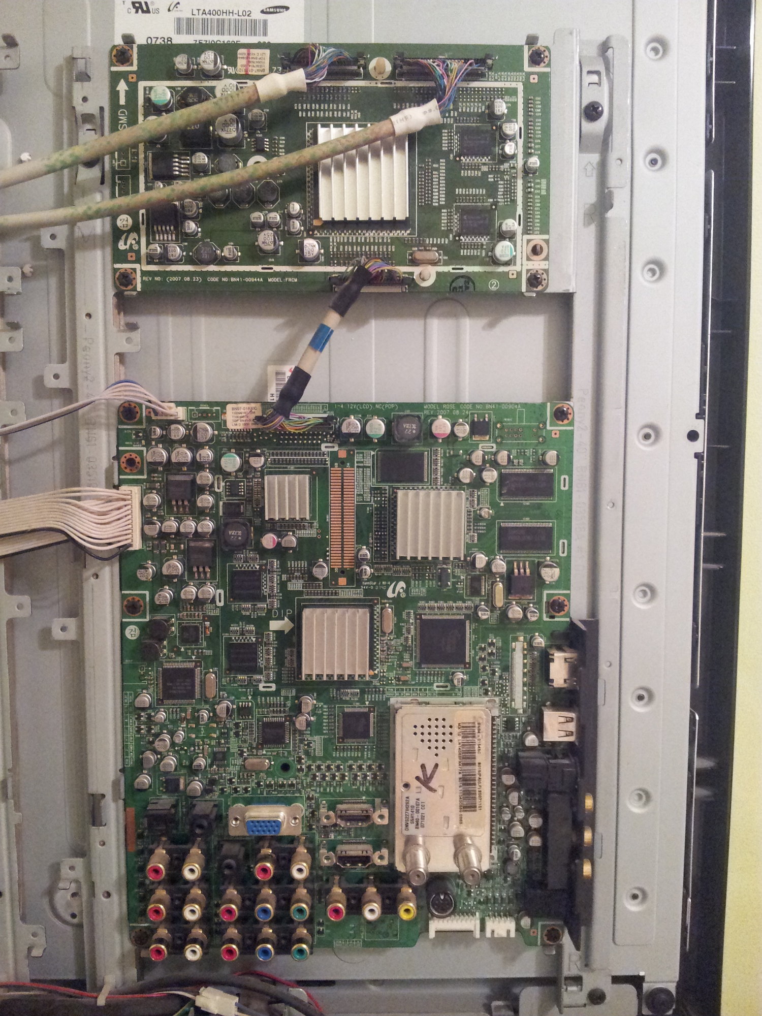

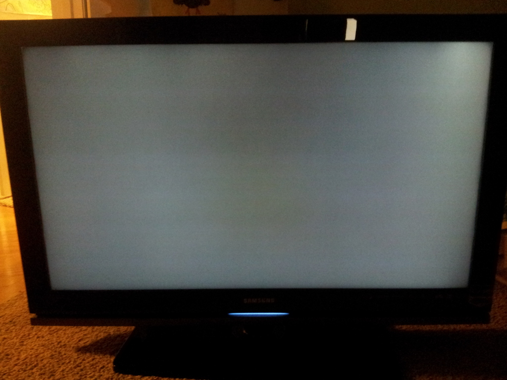

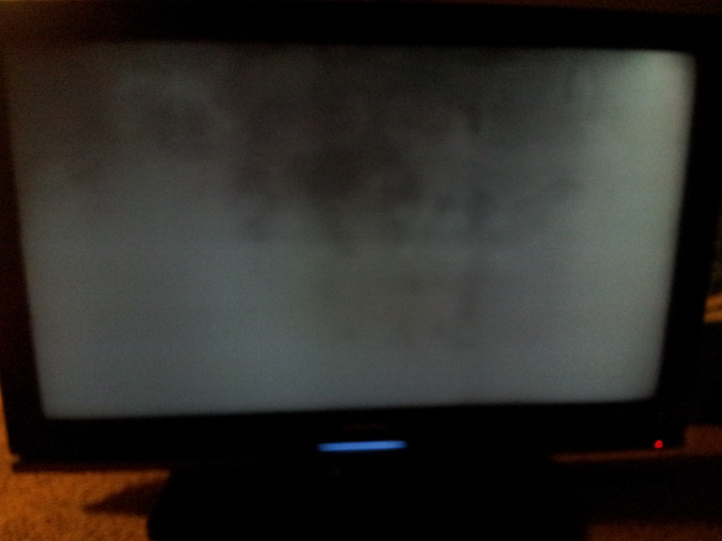

    The set will power on and has sound, but no picture. For a period of time if the set warmed up for a bit you could power cycle it and get a picture. The power light flashes.
    The power board has been recapped and the tconn board has been replaced. I would appreciate some guidance on this one.

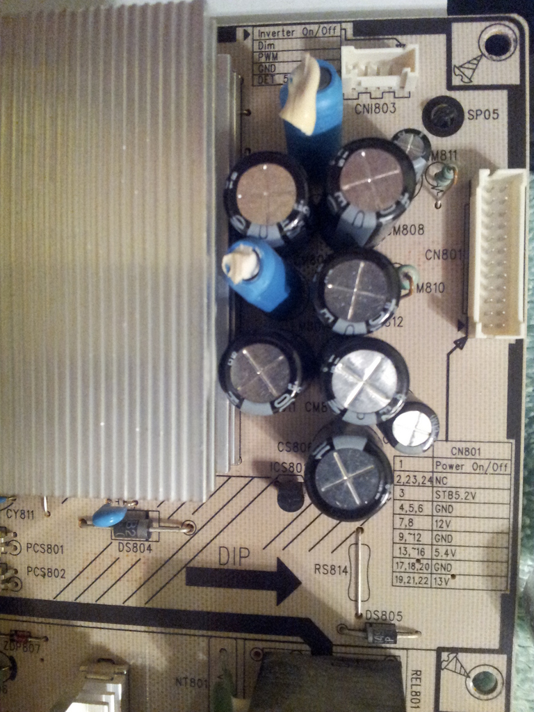

      I'm only seeing power on pin 3
      PIN Exp. Actual
      3 STB5.2V 5.22V
      7,8 12V 0V
      13,16 5.4V 0V
      19,21,22 13V 0V

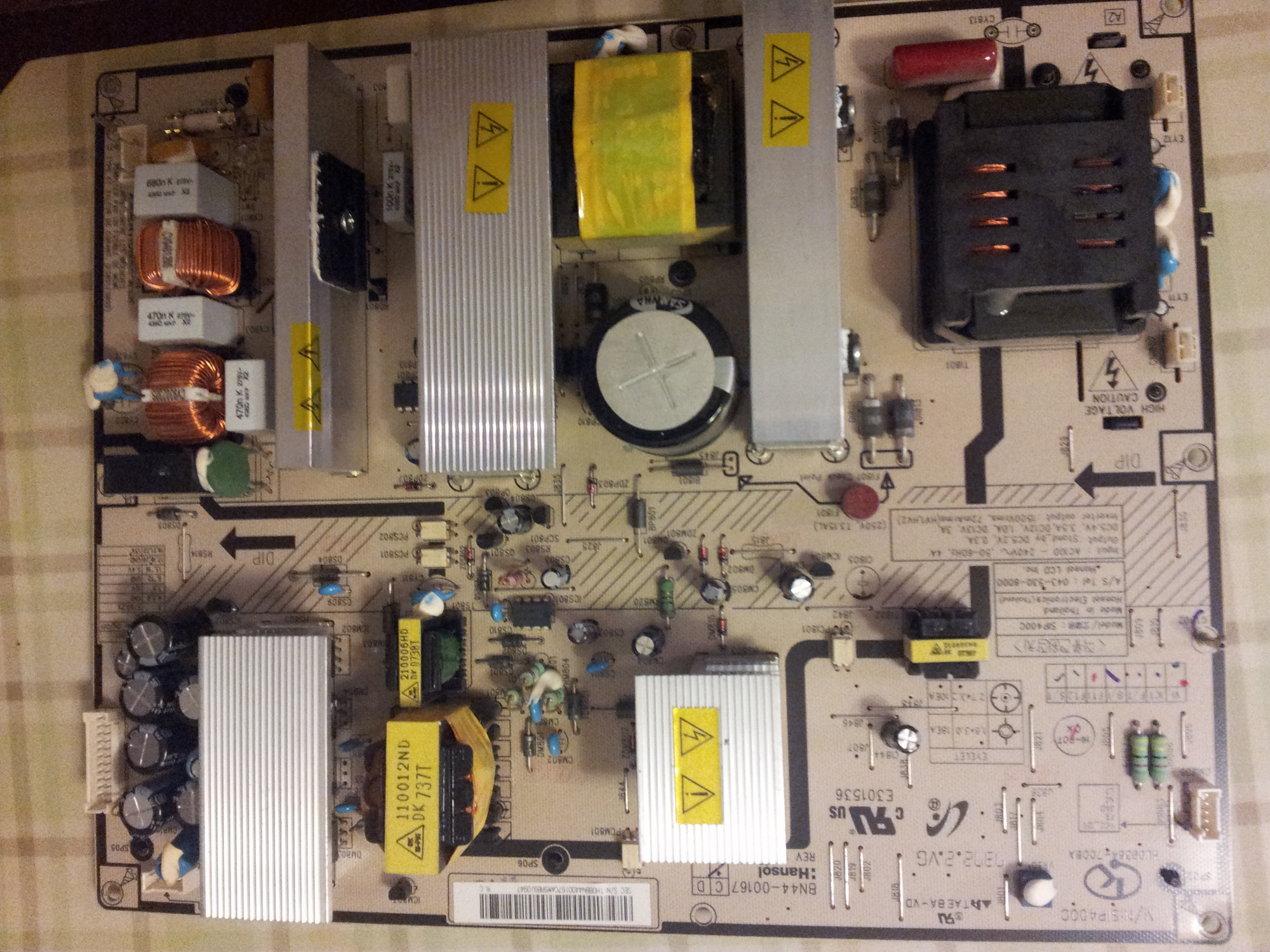

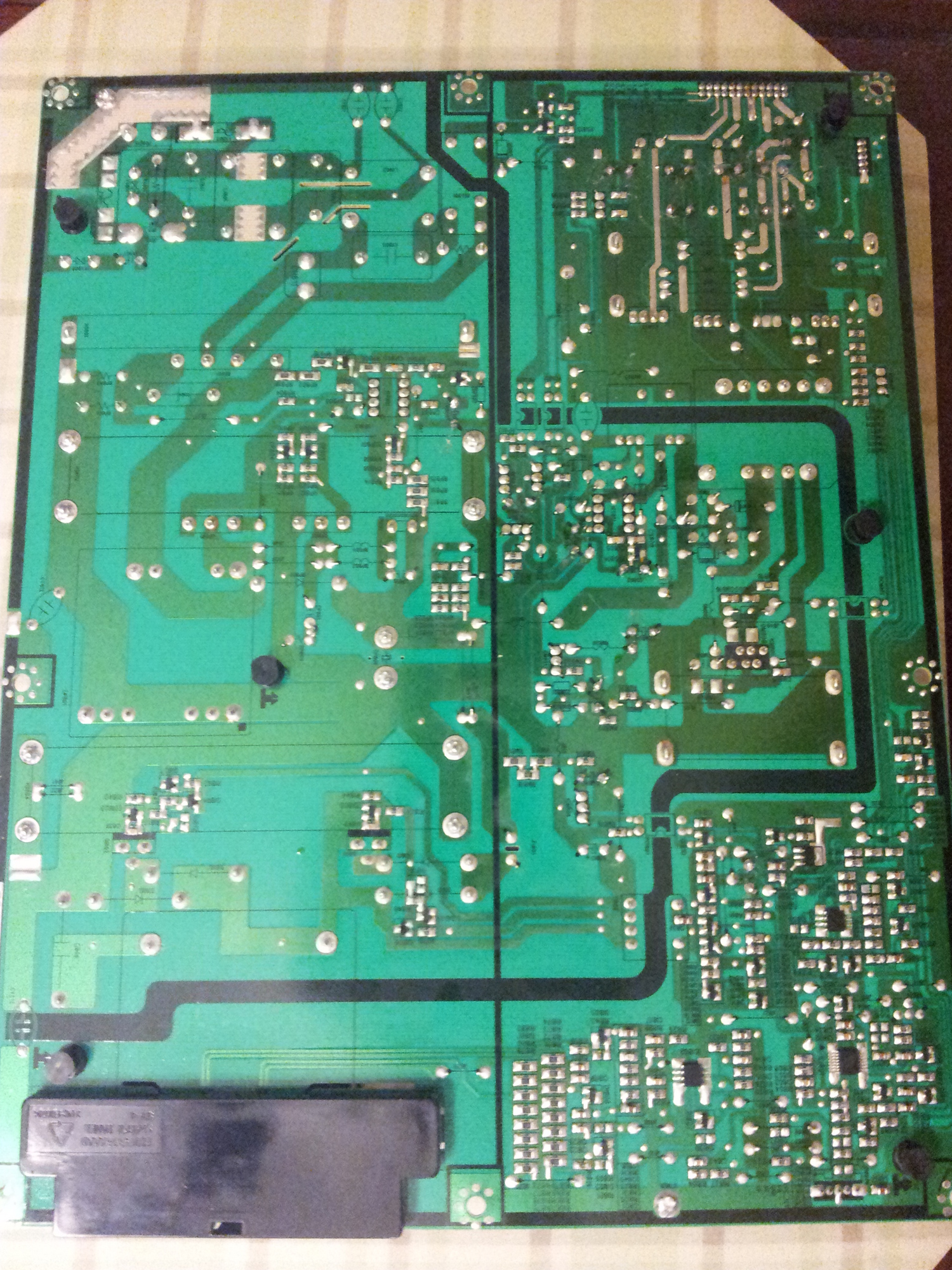

        Re: Samsung LNT4069FX/XAA no picture with sound

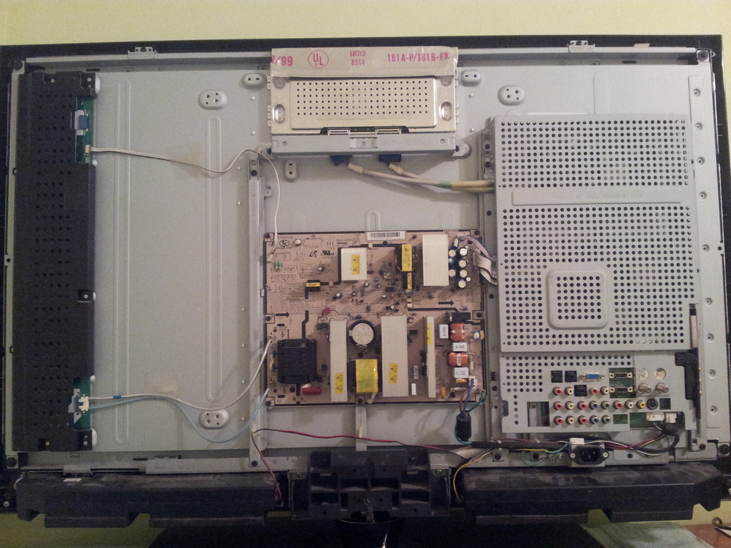

        OK, you power supply board is a combo power supply and backlights inverter board.
        You have backlights (your pictures show glowing screen), so inverter is working. You indicated that you do have sound, that does not make sense since the Audio amplifiers are running off either 12V or 13V power supply, but both of them are dead, no outputs as you have indicated. Can you please verify that again?
          That was a duh moment. I had to have all the cables attached and power the set on before taking the measurements
          PIN Exp. Actual
          3 STB5.2V 5.22V
          7,8 12V 12V
          13,16 5.4V 5.35V
          19,21,22 13V 12.73V

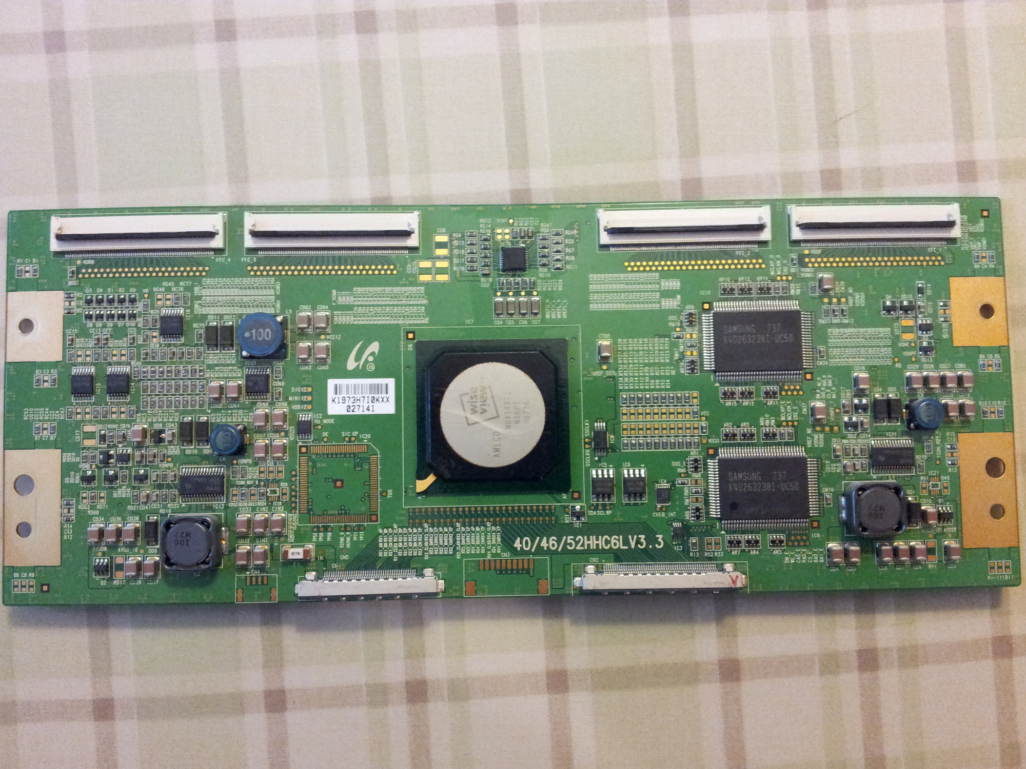

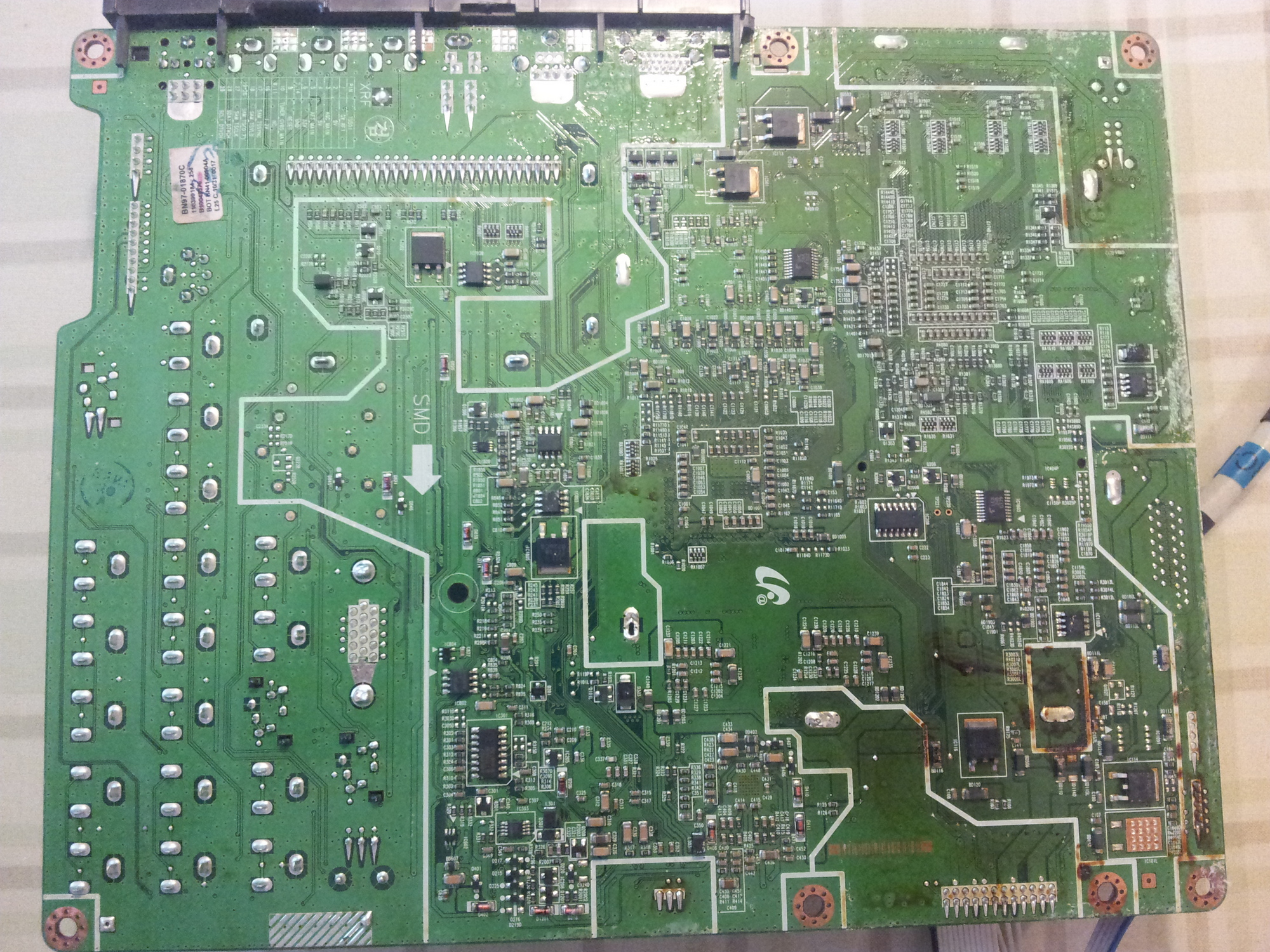

                I'm not seeing any voltages listed on the t-conn or the FRC board. The main board has some and they are not what they should be.
                Pin Expected V Actual V
                2 9v 2.05v
                4 5v 0.04v
                6 33v 0.04v
                16 1.2v 1.24v
                I don't see a surface mount fuse anywhere on these board. I saw a picture of one in your troubleshooting guide.

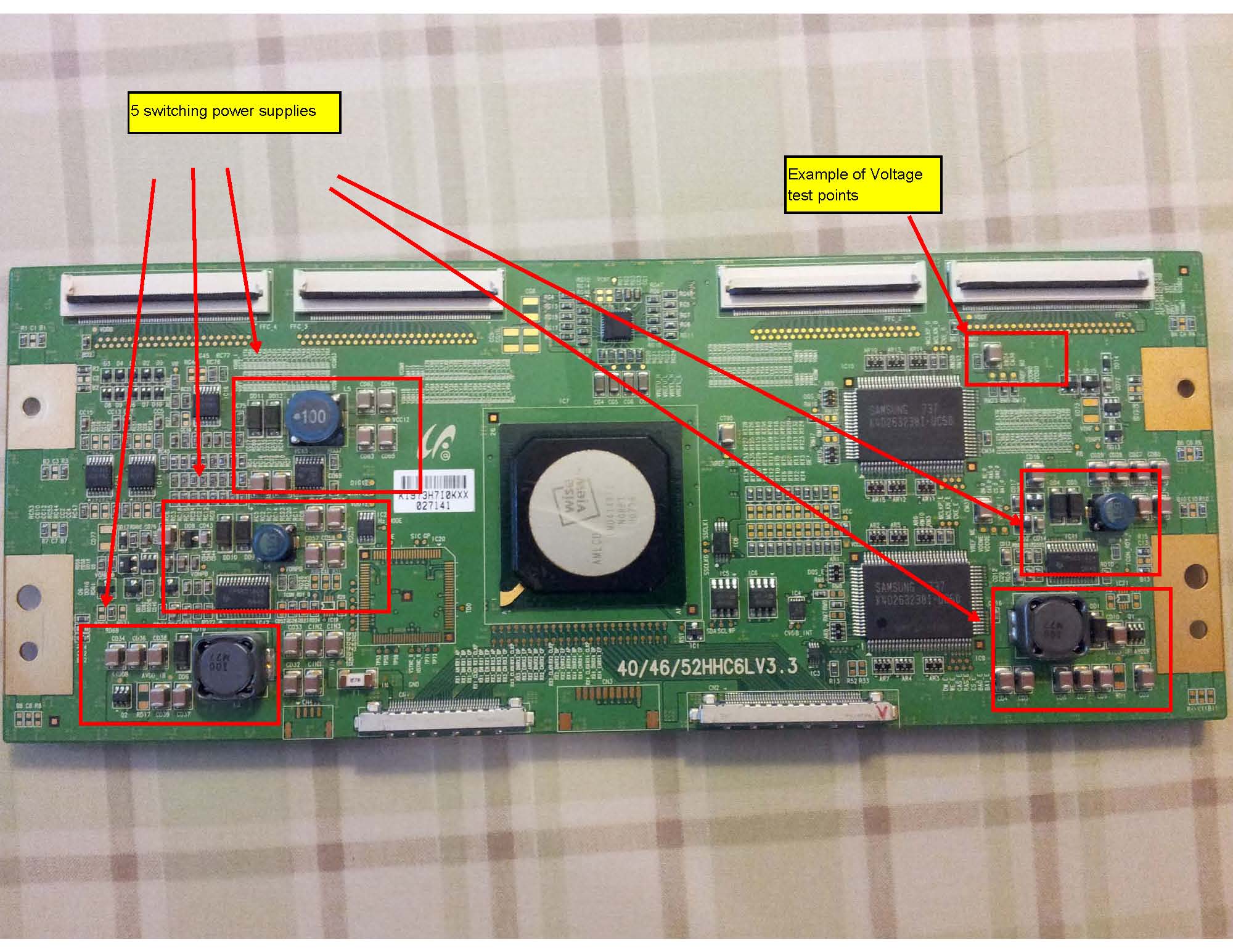

                          OK, there are voltage regulators and switching power supplies on the T-CON board, we will need good clear pictures of the board so we can tell you which one to check.
                          This still does not make sense since you have indicated that you had already replaced the T-CON board. Do you still have the old one, and what was the original problem with the TV?

                            I do have the original t-conn board and I placed it in the set today and it produces the same result as the replacement board. With both t-conn boards I do observe a flicker every 4 seconds.
                            The issue with the TV was that it would show the cloudy screen and after it warmed up you could power cycle it and get a picture. My parents would leave the TV on all day since it was a pain to get going. They tell me at times the set would go off (they would hear the power cycle tones this set makes) and you would get the cloudy screen again.

                              Your T-CON has a lot of switching power supplies, you can also see voltage test points on the board. Common failures are due to shorted out caps, failed regulator, blown fuse.
                              MOMAKA is an expert at T-CON, he may be able to tell you what voltage you should see at those test points.

                                Here are the voltages on the T-CON test points.
                                new T-CON
                                VREF 2.387v
                                VDOMO 2.519v
                                VDOQO 2.521v
                                old T-CON
                                VREF 2.396v
                                VDOMO 2.528v
                                VDOQO 2.530v
                                As of now, I'm not seeing the power cycle problem, just a white screen with sound.

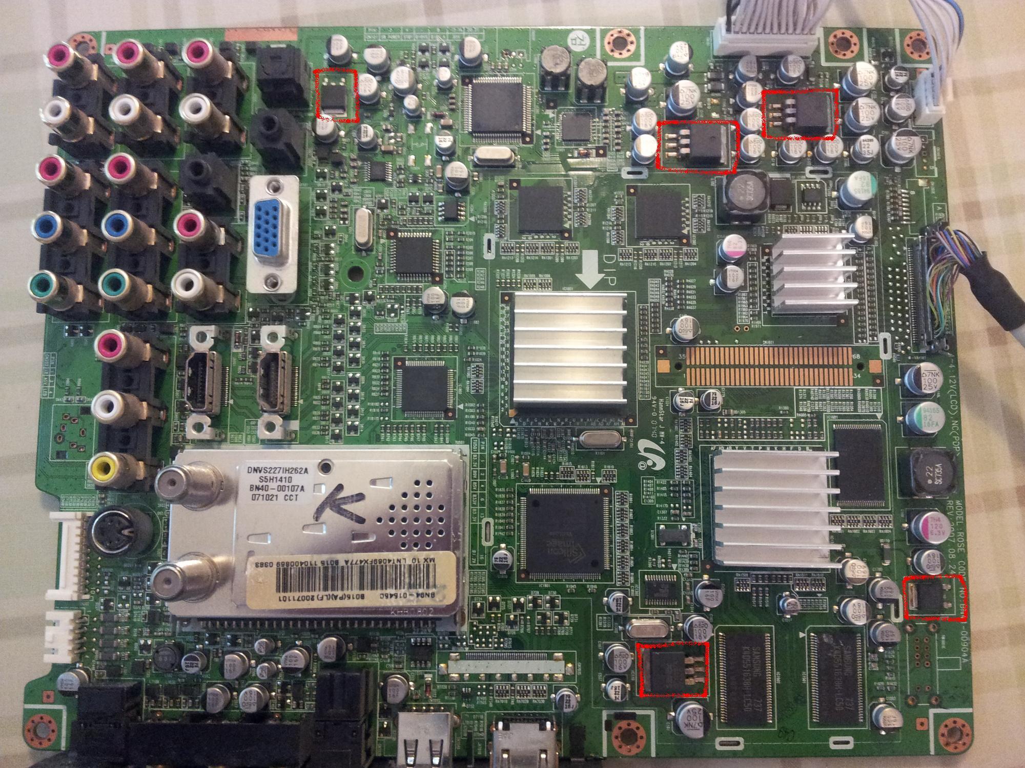

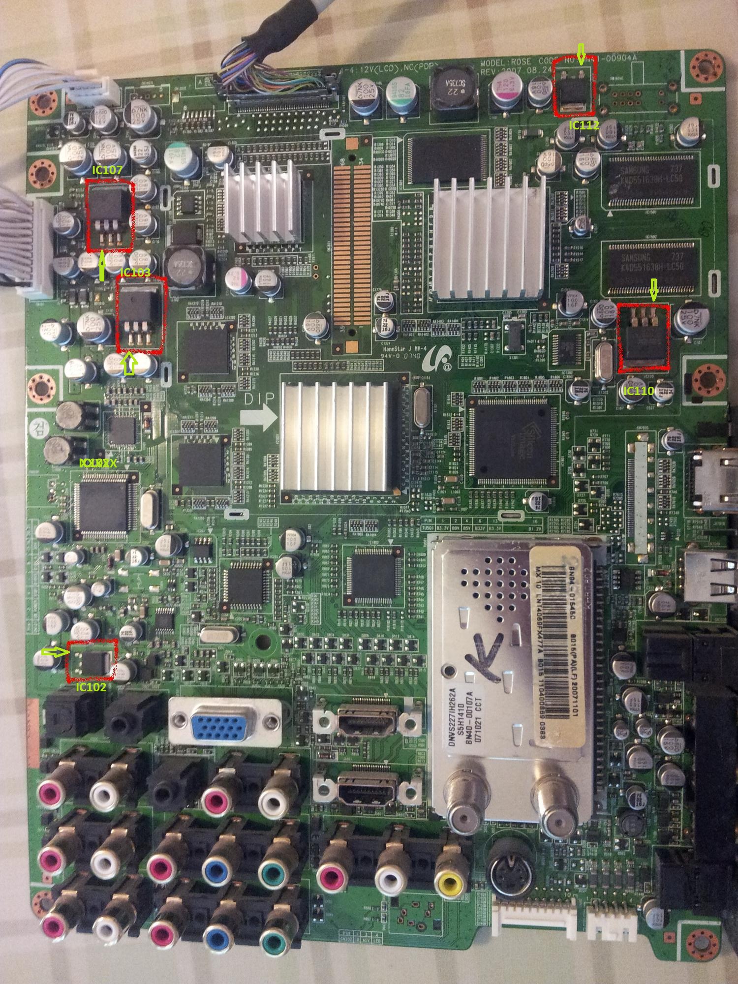

                                  There are several voltage regulator and/or DC/DC converters circled in red.
                                  To test a voltage regulator, plug in your device and power on.
                                  1) Set your multimeter (if manual range) to 20V DC.
                                  2) Put your black probe on a ground screw. Leave it there the entire time. This is your ground.
                                  3) Put your red probe on each of the pins including the "cut" pin, but ignore the "fat" tab. The fat tab is "up" or "north". Number the pins left to right.
                                  4) Report them like so along with the part number (include all lines on the IC) of the IC.

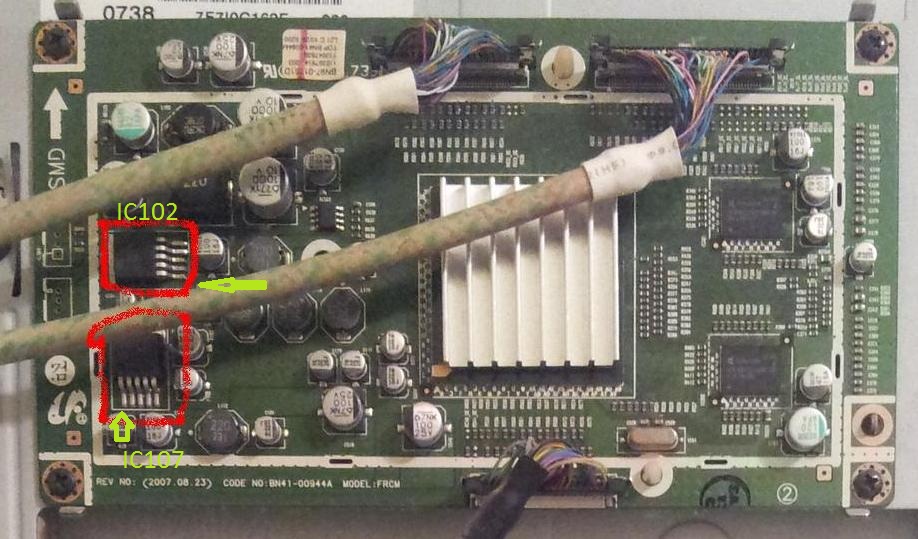

                                  • ceconomon
                                    • Oct 2011
                                    • 67
                                    I've labeled the picture for reference (arrow to pin1) and below are the results.
                                    location -IC103
                                    SPX1587AT
                                    0741LC
                                    pin 1= 1.284
                                    pin 2= 2.535
                                    pin 3= 5.31
                                    location -IC107
                                    SPX1587AT
                                    0741LC
                                    pin 1= 2.046
                                    pin 2= 3.298
                                    pin 3= 5.31
                                    location -IC110
                                    SPX1587AT
                                    0741LC
                                    pin 1= 0.0
                                    pin 2= 1.25
                                    pin 3= 3.277
                                    location -IC112
                                    17-25
                                    0739AG
                                    pin 1= 0.0
                                    pin 2= 2.504
                                    pin 3= 5.29
                                    location -IC102
                                    17-33
                                    0739BG
                                    pin 1= 0.0
                                    pin 2= 3.284
                                    pin 3= 5.17
                                    location -IC102 FRC board
                                    37302WU
                                    0735

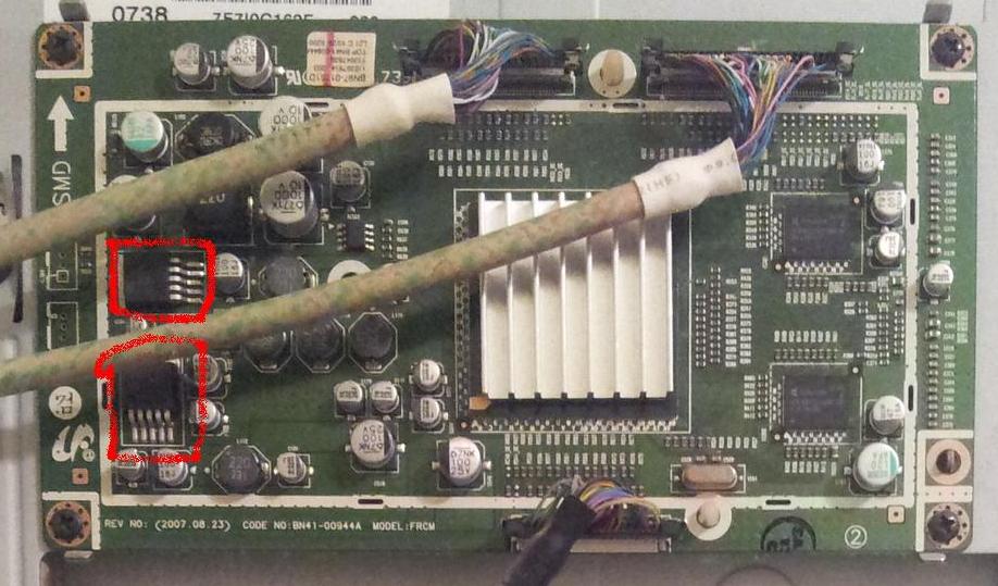

                                    pin 1= 3.422
                                    pin 2= 3.423
                                    pin 3= 0.0
                                    pin 4= 2.478
                                    pin 5= 1.24
                                    37302WU
                                    0735
                                    pin 1= 3.421
                                    pin 2= 3.421
                                    pin 3= 0.0
                                    pin 4= 1.836
                                    pin 5= 1.262
                                    • retiredcaps
                                      • Apr 2010
                                      • 9271
                                      37302WU
                                      0735
                                      pin 1= 3.421
                                      pin 2= 3.421
                                      pin 3= 0.0
                                      pin 4= 1.836
                                      pin 5= 1.262
                                      You have IC102 listed twice. Whatever the above is, I suspect pin 4 is too low.
                                      According to
                                      http://datasheetz.com/data/Integrate...atasheetz.html
                                      If the above is an adjustable regulator, it should be pin 5 + 1.25V or 1.262 + 1.25 = 2.512V DC for output. At 1.836V, pin 4 is too low.
                                      Now if the part number for the above indicates it is a fixed 1.8V regulator, then it is good.
                                      So doublecheck IC102 and IC107 as to which is which and redo the measurements

                                      • ceconomon
                                        • Oct 2011
                                        • 67
                                        I double checked the measurements and corrected the location.
                                        37302WU
                                        0735
                                        pin 1= 3.417
                                        pin 2= 3.417
                                        pin 3= 0.0
                                        pin 4= 2.478
                                        pin 5= 1.241
                                        location -IC107 FRC board
                                        37302WU
                                        0735
                                        pin 1= 3.415
                                        pin 2= 3.415
                                        pin 3= 0.0
                                        pin 4= 1.847
                                        pin 5= 1.265
                                        Base on your analysis, it looks like I should be ordering the following part:
                                        http://www.digikey.com/product-detai...6-5-ND/1029402
