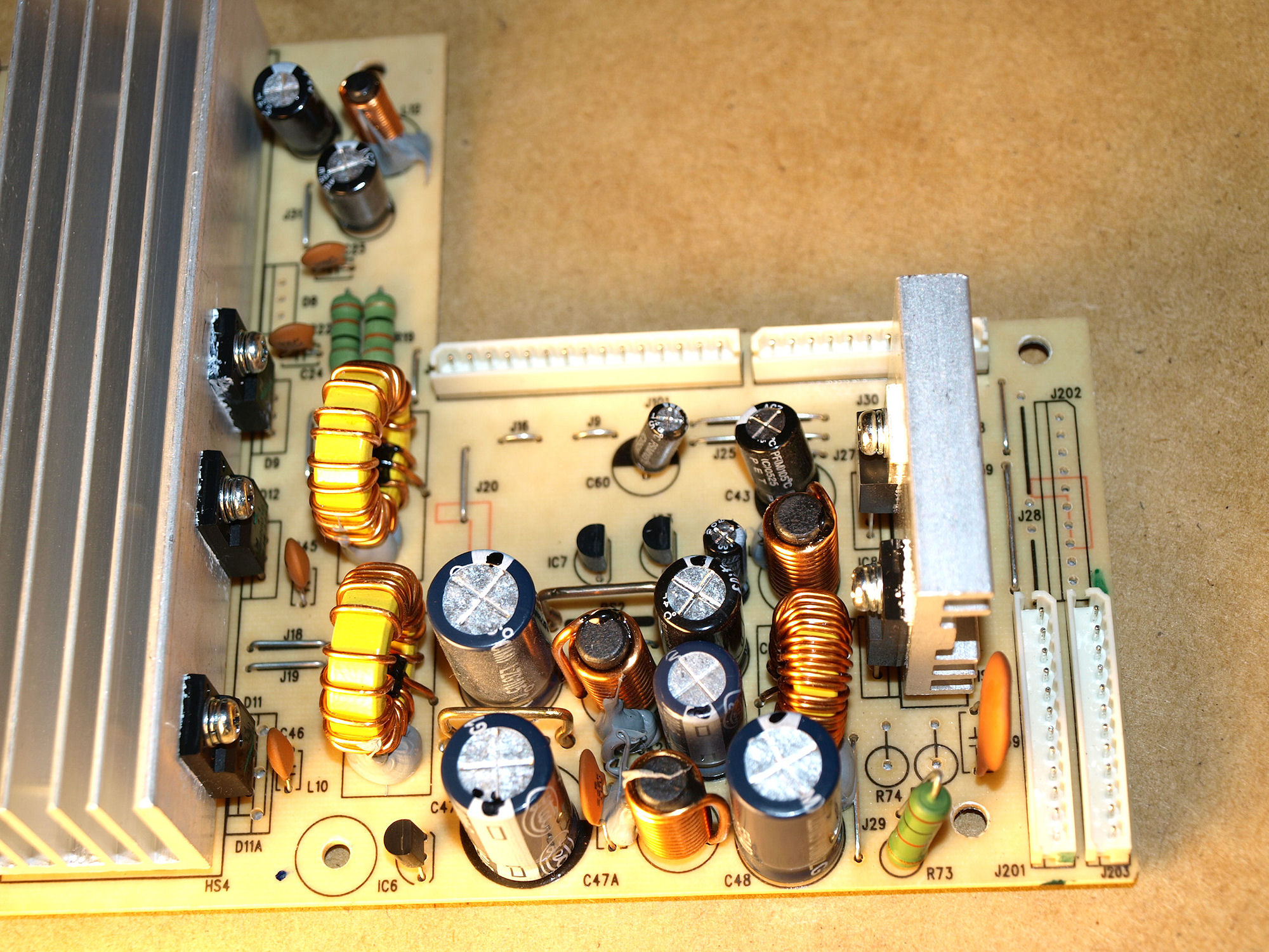

    Greetings.
    I have an Olevia LCD HDTV model LT37HVS. Set turns on and works for 20 to 60 minutes then makes a bit of a crackling sound and goes dead. No sound, no picture, no blue logo light on front. If unplugged for 30 seconds, then plugged back in, it again works perfect for 20 to 60 minutes and the cycle repeats itself. Since it goes completely dead as opposed to just losing sound or picture I suspect the problem lies in the power supply. During my research I've found a lot of information that bad capacitors can cause nasty problems. I'm wondering if this sounds like it could be capacitors in the power supply (Arestech AEP001-24 REV:1)? To my completely untrained brain it seem to be something very early in the power supply like a transformer since when it goes out EVERYthing goes dead.
    Thank you in advance for your time, attention and insight. It is much appreciated.

    Re: Olevia LT37HVS - power prolems, caps related?
    You need to take the back off the set and establish where the crackle comes from.
    Welcome to the forum-
    We can help a lot more if you please post good clear pictures of the whole chassis, and then pictures of each board, front and back and close up of connectors, (max resolution 2000x2000 and 2MB) using the manage attachments button, which is found by clicking "go advanced" under quick reply.
      Hello selldoor and thank you for the quick reply.
      The crackle sound comes through the speakers. I have already tore into the set and pulled the power supply so I'm too late to listen if there is an actual crackle coming from a particular area of the set. I think it's just static from whatever it is that's knocking out the power. I can take photos of the power supply which I'm pretty sure is the culprit since everything goes dead at once. I'll do that after I finish with work
      While I do not have much experience with TV's, I have worked with computers (desk tops & laptops) since the 80's. Upgrading ram, modems, replacing LCD screens - who knew they cracked so easily - and such. Basically I'm 1/2 too cheap to pay someone else to do it, and 1/2 to interested in ripping it apart and seeing what makes it tick. I have a basement full of tools though my wife keeps "cleaning up" and I can't find them most of the time. I pretty much have no fear of ripping something apart. Which is both a blessing and a curse....

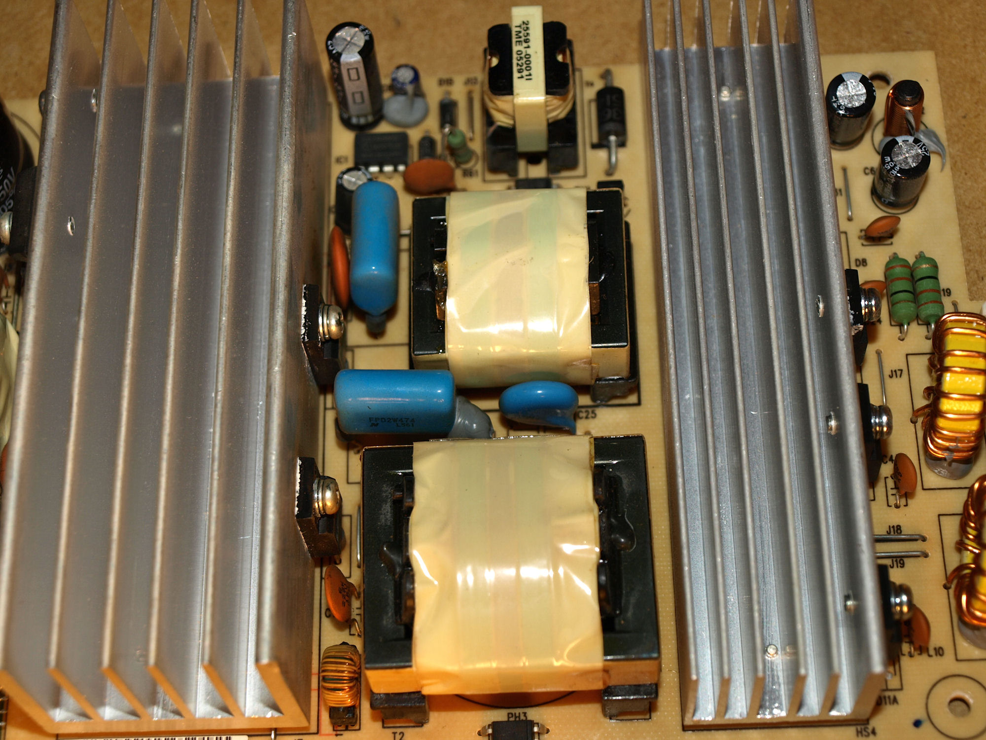

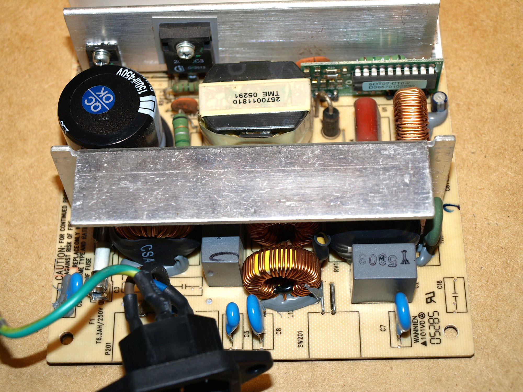

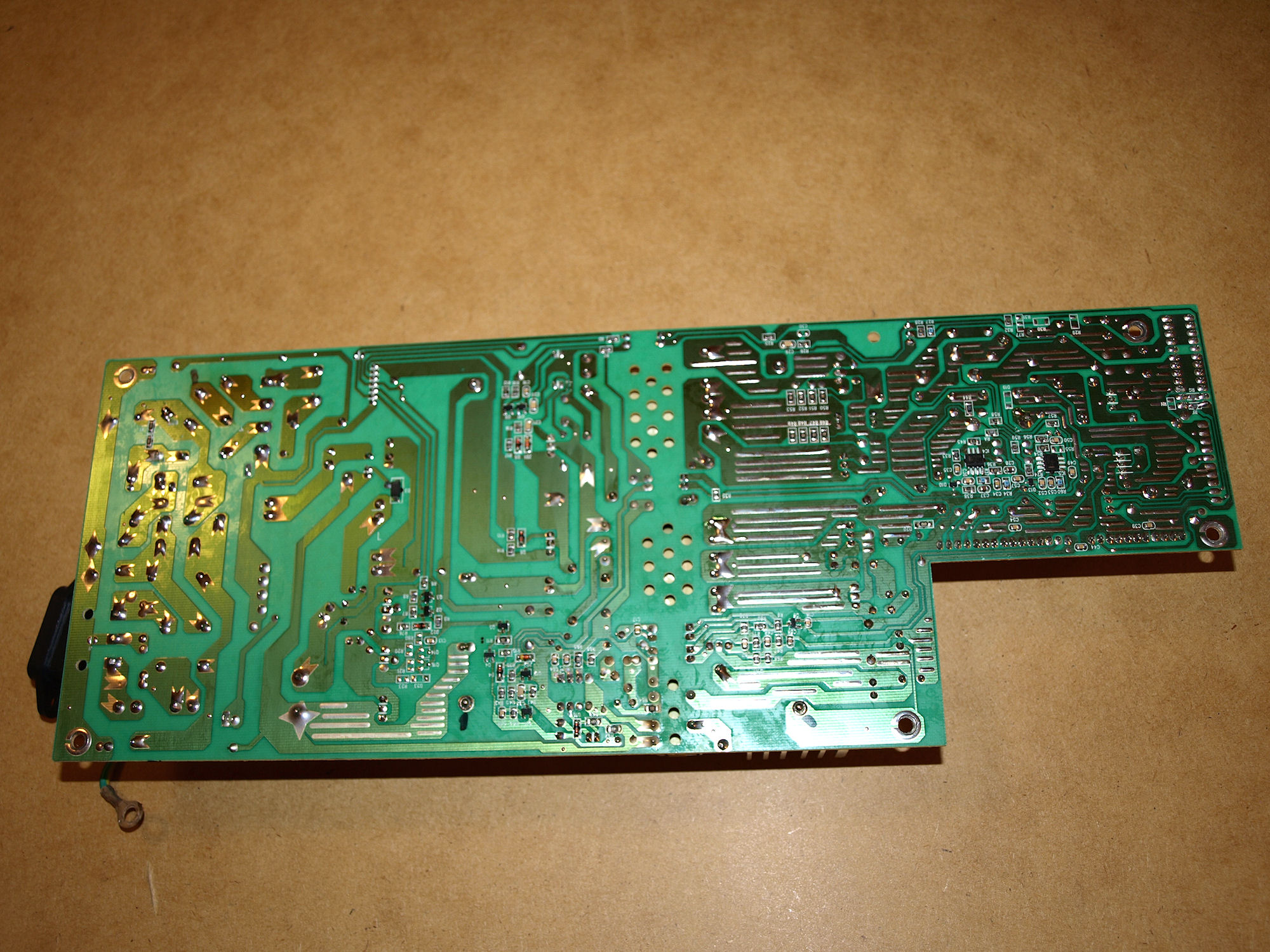

        Ok... I've attempted to photograph the power supply board. Due to it's size I did the front in 3 sections. I've looked it over quite carefully on both sides and see nothing out of the ordinary. All the caps look good, no bloating or leaking. Nothing looks to have ever been hot. I don't see any "smoking" guns, at least to my untrained eye. Since everything goes dead it seems to me it's power supply related. I suppose there could be another board causing a problem that in turn kicks out the power supply, I just don't know. I can get a new power supply for $40 or change out the caps for $15. But I just don't have any confidence that either will cure the problem.
        Small Caps are: elite brand
        Mid size Caps are: Ltec brand
        If you see anything I didn't or have any suggestions I'd love to hear them.
            Does the logic board have solid-state or electrolytic caps?
              This power supply has PFC circuits (in the third picture), 5v standby (picture #2 top section small transformer), switched 12 or18V power supply (middle section transformer), switched 24V power supply (bottom transformer).
              So right now you are not getting any indicator lights on the front of the TV at all, if that is the case, the standby power supply may be bad or the main board is completely dead.
              Check the DC voltage at that 450Vdc DC main filter cap (this is the Line voltage primary circuits so be real careful), it should have about 170Vdc (if the AC in put is 120Vac) WITHOUT the TV ON, if it does, then check and see you do have the 5Vdc from the 5V standby power supply section.
              Just make sure NOT TO TOUCH any parts of the Primary circuits, you should have this TV plugged into GFI outlet to protect yourself.
