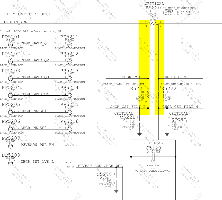

                                  Remove all power. Meter in resistance mode. What is the resistance between C5221 and C5222? This is the current sense path of the input rail that feeds into U7000. You should have ~2 ohms here.
                                  • Stephen
                                    Meow Meow MEOW!
                                    • Apr 2020
                                    • 674
                                    C5221 and C5222 is 24k OHMS.
                                    sigpic
                                    MEOWING IN THE IMPOSSIBLE UNIVERSE!
                                    • mon2
                                      • Dec 2019
                                      • 14547

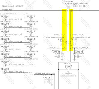

                                      Be sure that one meter probe is on C5221 and the other probe on C5222 = total resistance = ~2 ohms. Not measuring to ground.
                                      Something is wrong here. Likely a broken PCB trace or missing part in the path.
                                      Trace from C5221 and go north and continue to make a clockwise batch of measurements. Compare each to the schematic. The full path should have been ~2 ohms.
                                      Click image for larger version  Name:	resistor_path.png Views:	0 Size:	190.1 KB ID:	3574174
                                      • Stephen
                                        Meow Meow MEOW!
                                        • Apr 2020
                                        • 674
                                        sorry I read that wrong, I am getting 2 OHMS across both CAPS.

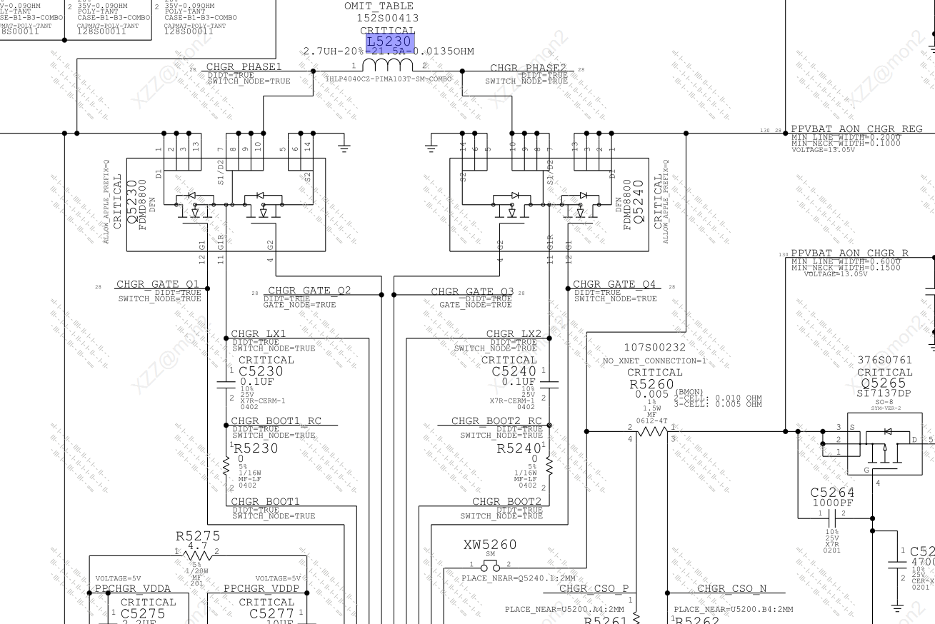

                                          What is the voltage to ground of L5230 (either side) with the power adapter?
                                          The mosfets linked to U7000 are suspects. Using surrounding parts for probing, you can check the resistance of these mosfets.
                                          Measure:
                                          source / drain
                                          source / gate
                                          gate / drain
                                          Review the schematic and probe using other parts that mate with the pins of interest. Each measurement must be hundreds of k ohms or higher else the mosfet may be defective.
