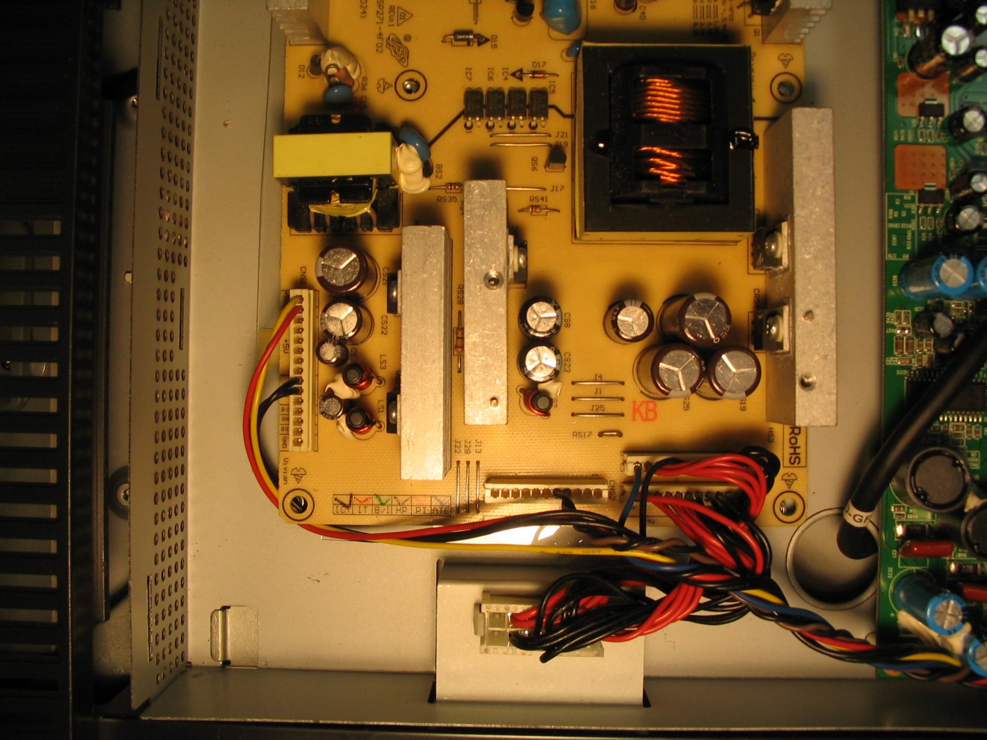

    with active inputs to vid2, svid & YPbPr2, powering the tv gets the standby ring to go red. but pushing power or any other button on tv (i dont have remote) changes nothing - red ring, no audio or video. a flashlight has no effect on the screen (no menu or anything). so i popped off the back cover to have a look.
    all the caps look good/flat & i didnt see any evidence of leakage or burning. fuse F1 on power supply tested good, with power on have 120v thru the fuse.
    i took voltage readings from the p/s - pic 1 (my multimeter battery is a bit weak, not sure of any effect):
    cns1 - yellow 5v - red 4.6v (0/F)
    cns2 - brown 11.8v (18v)
    cns3 - blue & red 24v
    cns4 - red 24v
    hopefully the low reading @ 18v will lead to a simple solution. i dont have tech beyond a multimeter to test components. so i guess i'm a tinkerer, not anything more, and hoping your ideas will bring some alternatives for a solution. pics 2 & 3 are of the mainboard.

            Re: Memorex MLT4221P stuck in standby
            I don't have schematic for this power supply so I'm guessing based on your picture.
            If CN2 is the middle connector, then I'm guessing that the dual diode is mounted onto the heat sink just to the left.
            If correct, try measuring the output from the diode and see if it is 18V. The two caps just to the right of the diode may be on the 18V rail. If yes, see if the voltage across those two caps (which might be 25V or 35V rated caps) are 18V or not.

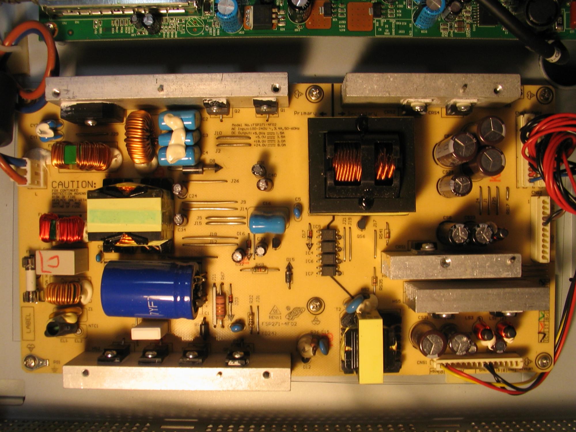

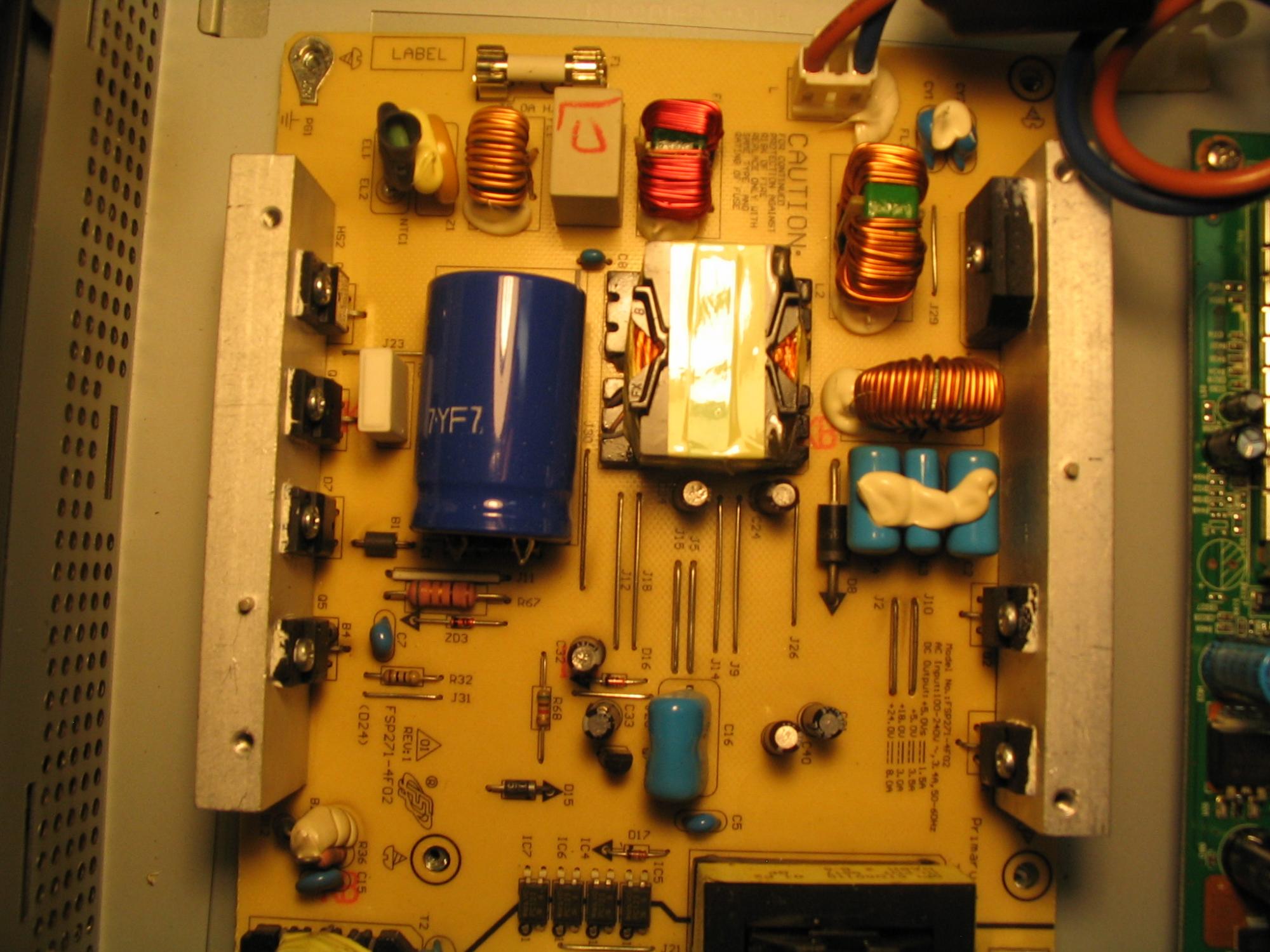

                  Spec:
                  http://www.fspgroupusa.com/fsp2714f02/p/764.html
                  Looks like we are going to need good clear pictures of the bottom side of the board to look at the area of the 18Vdc section.

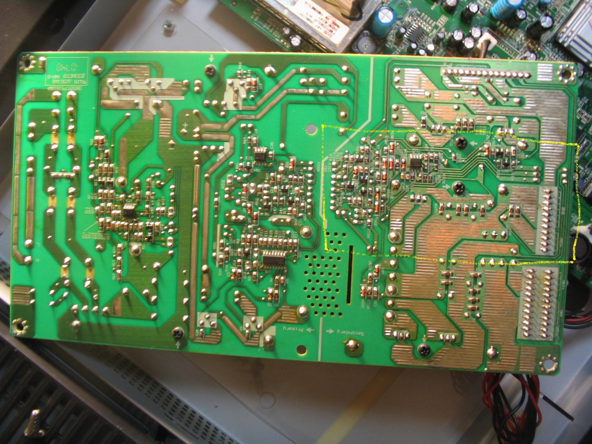

                    let me know if the pics posted above are clear enough, thanks

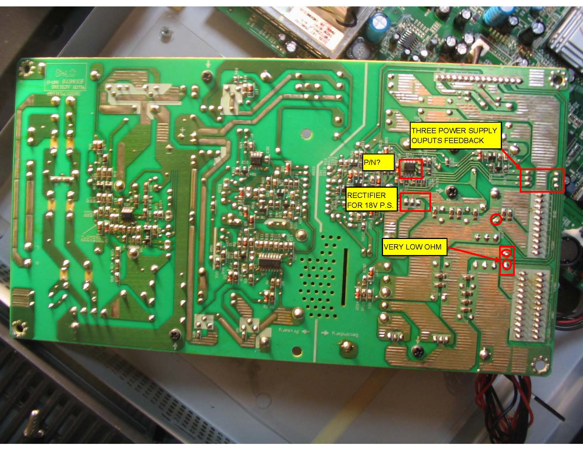

                      Originally posted by gb77
                      let me know if the one posted above is clear enough, thanks
                      I think we need a clear shot of the section in yellow.
                      --- begin sig file ---
                      --- end sig file ---
                        From what I can see, there 3 feedback signals in the 18/24VDC outputs that are used to regulated the output, since I do not have the diagram for this power supply, I would try replacing the rectifier for the 18V section, the whole thing does not clear yet why it is regulating the 24Vdc OK but not the 18Vdc, one possibility is that the 24Vdc is not loaded due to the backlights are not running, it may drop under load.
                        What happen if you remove the 18V connector so it will not have the load? Do you get 18v?

                          i got a bunch of blurry pics - any suggestions for getting clear shots by hand? the pic in that other thread is accurate
                            Wait until tomorrow when the sun comes out. Take the board to a window ledge and put your camera on macro mode with no flash.
                              What is the part number of that 8 pin IC in budm's marked up diagram where it says P/N?

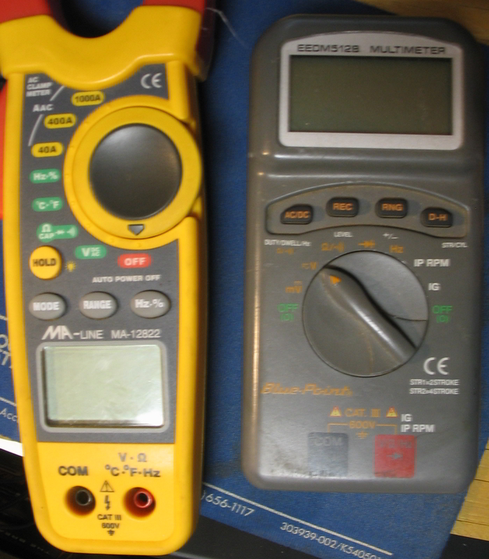

                                (don't know if my cheap multimeter is giving good readings
                                Post a picture of it for one retiredcaps' bonus point.

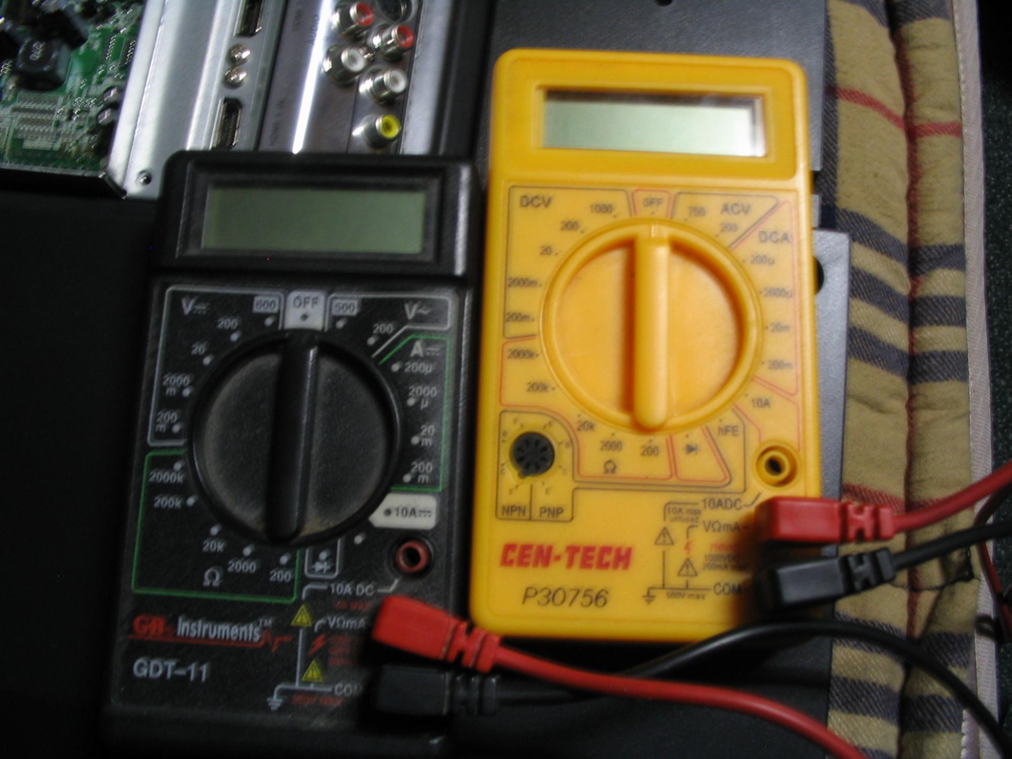

                                  • gb77
                                    curious
                                    • Aug 2011
                                    • 76
                                    P/N
                                    ICS1
                                    AS358M-E1
                                    739R84
                                    2 MMs for the price of 1 - the black has a new(er) batt, yellow is older.
                                      OK, it is a dual Op-amp: http://pdf1.alldatasheet.com/datashe...AS358M-E1.html
                                      Probably used for comparator circuits of some sort.
                                        the 2 9v batts i have measure each other as 9.03v / 8.92v
                                        have a couple MMs left by old roommate - no leads, no battery (9v) so don't know if they even work. if one might be useful, can you point me to some generic manual on how to use it? thanks.
