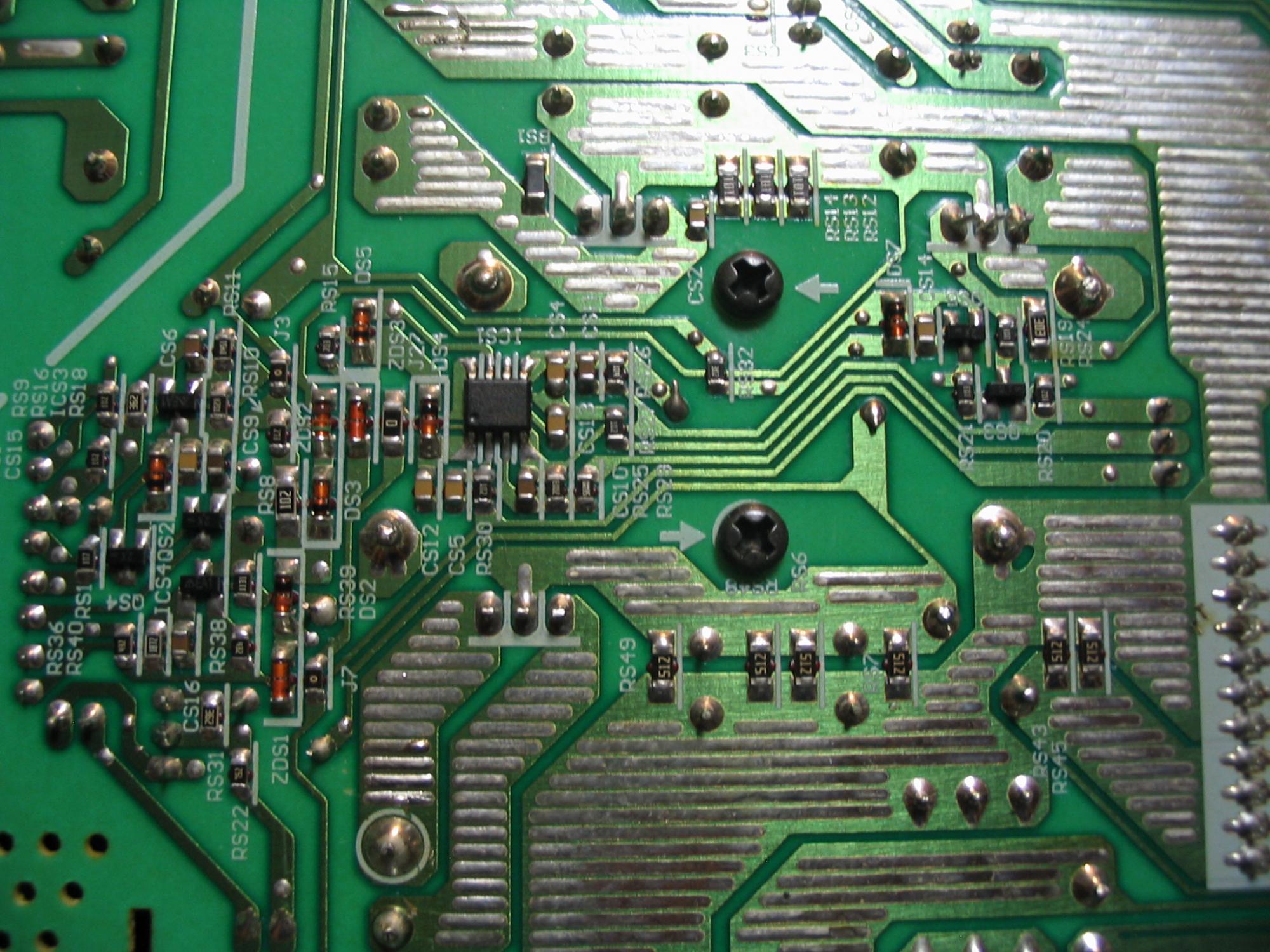

      Re: Memorex MLT4221P stuck in standby
      budm - the rectifier you suggest to change is an ON MBR2045CTG - is it possible that is the only problem? it's about $1 ..
      http://www.mouser.com/Semiconductors...0A+45V&FS=True
      got a decent pic of the 18v area on back of p/s.
      retiredcaps - when i took readings, i used a jumper from the board's ground clip/screw hole to the ground strap screw the power cord plug is grounded to. i'll put it back in and try your suggestion. any ideas for creating leads for the bluepoint?
        got hopeful results from MMs - black (GB) & yellow (MA - used 14ga copper loop into leads) - the bluepoint measure a couple 9v batts same as GB, but fried when attached to leads from C1 with p/s under load.
        MA . . . . . . GB
        164.7 . . . . 164.8-165 . . no load
        407 . . . . . .405-407 . . . load (5,18 & 24v leads connected to p/s)
        so it seems the GB is getting good reads where the peak value is closer to reality. is it worth remeasuring IC2 with MA?

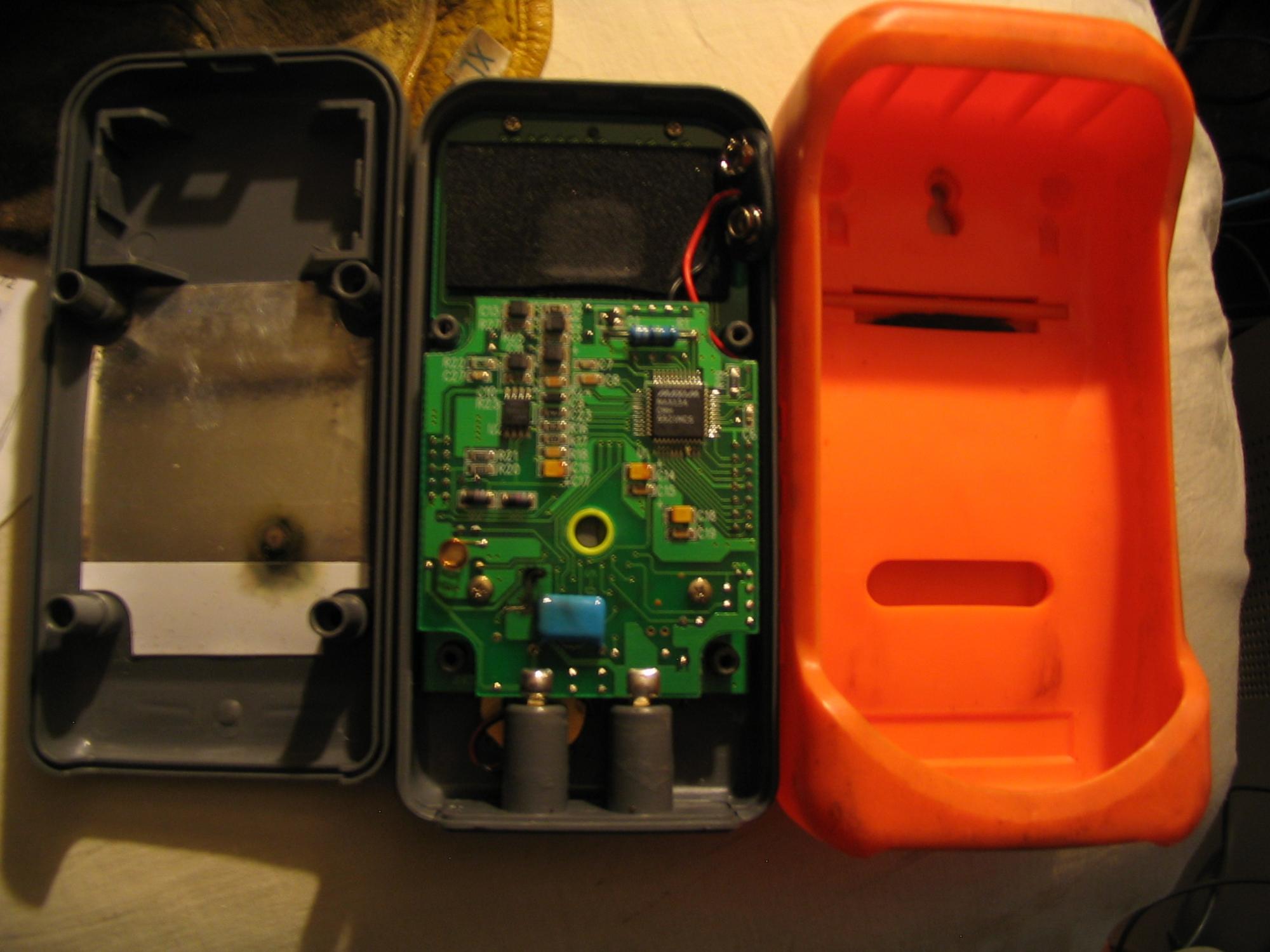

          • gb77
            curious
            • Aug 2011
            • 76
            fried the BluePoint = something popped & burned/scorched its pcb. it was a freebie, so i'm not gonna worry about it since the MA seems good.

                  • gb77
                    curious
                    • Aug 2011
                    • 76
                    #29
                    bluePoint got burned
                    enjoy the view

                      • retiredcaps
                        • Apr 2010
                        • 9271
                        #31
                        Re: bluePoint got burned
                        Originally posted by gb77
                        enjoy the view
                        Wow, it looks like one of the tracks peeled completely and you can see the damage on the backside of the case.
                        This multimeter is pretty user friendly too. Only two input sockets so there should be no user error with putting the wrong probe in the wrong socket (i.e into amps socket). It is also CAT III rated to 600V which you can believe unlike a lot of junk found on ebay with fake CAT ratings stamped on the front.
                        Notice those deep ridges on the inside of the case. It is designed to be deep to keep any "explosions" inside the case.
                        This is one reason I always caution people when they are about to measure high voltage components.
