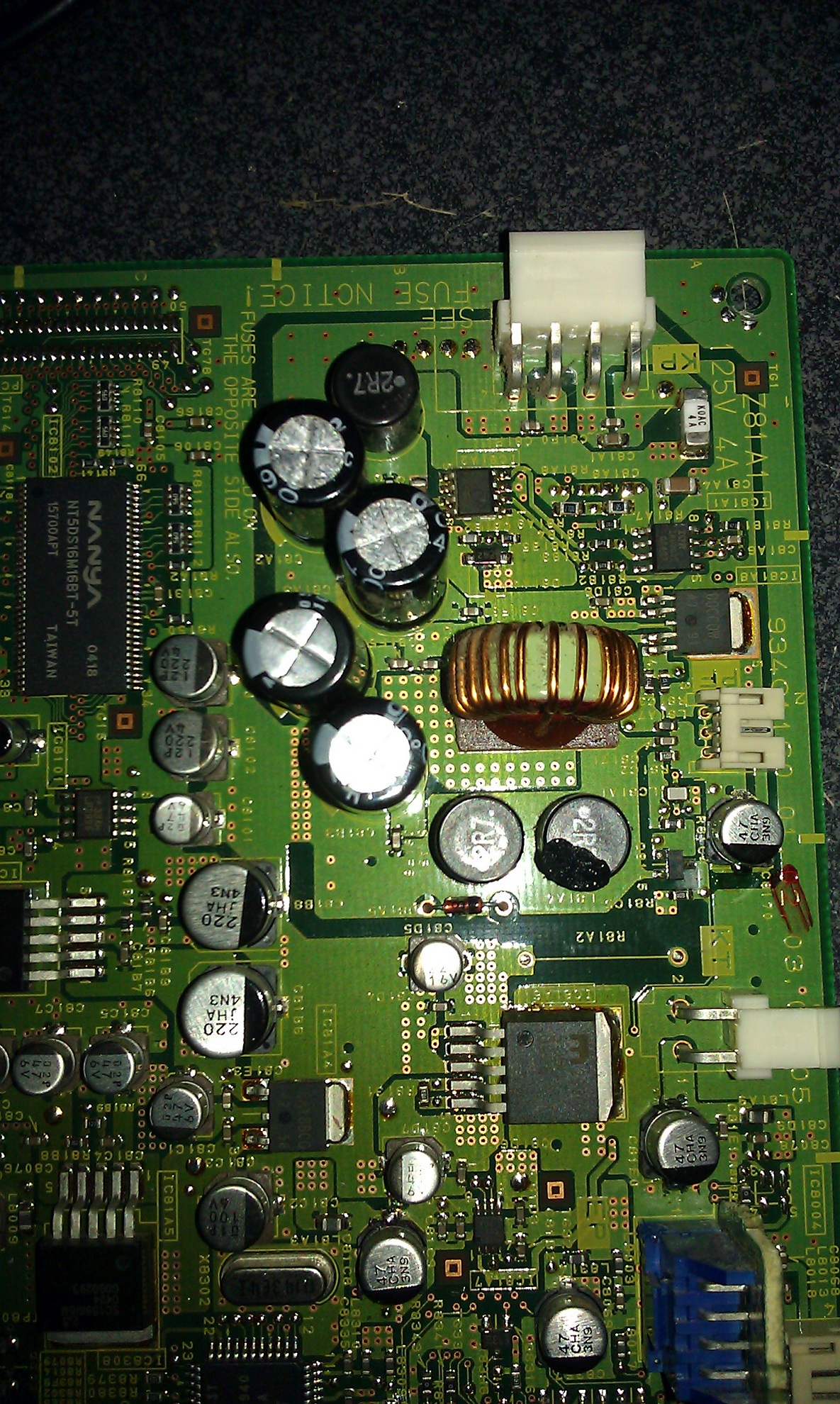

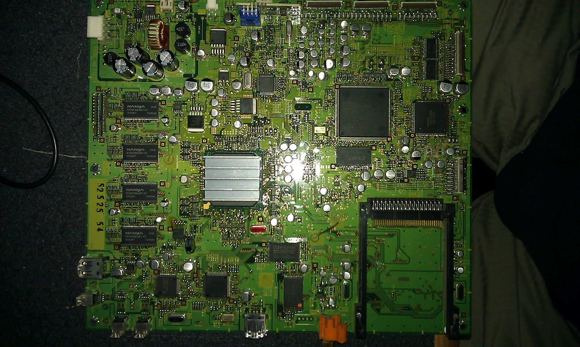

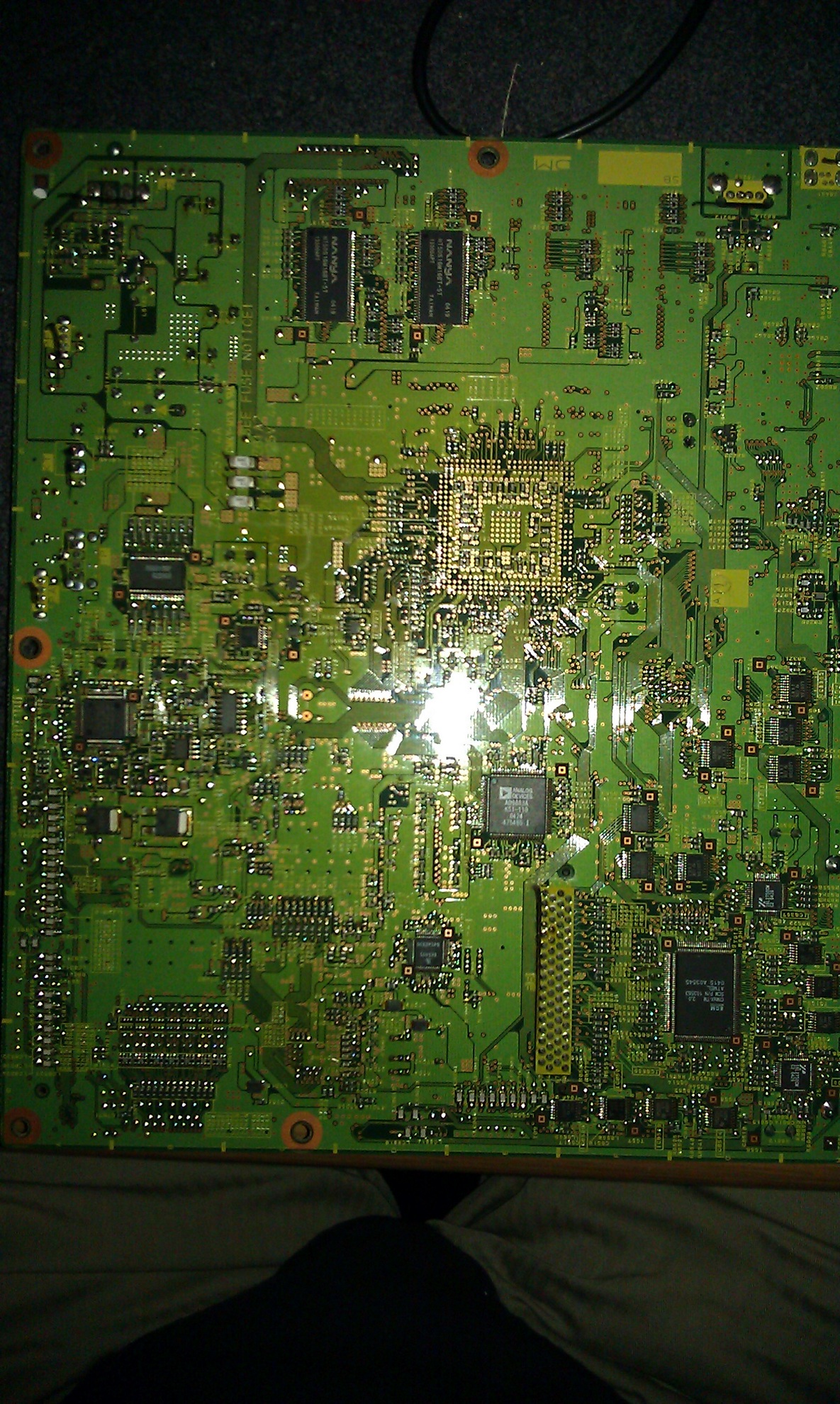

    I have attached a couple of pictures of the DM board. If anybody could offer some assistance, I would appreciate it.

    Here are the pictures of the DM Board.

      The pictures are really not good enough for troubleshooting they should look like this
      Examples of what is needed
      https://www.badcaps.net/forum/attach...1&d=1290283049
      https://www.badcaps.net/forum/attach...7&d=1280167246
      Perhaps try outside for better light.
      It would also be better to list the fuses/components you have tested so that we know for certain that none have been missed.
      In the midddle picture there is a black blob on one of the inductors - is it just glue
      can it be cleaned off?

                I will try to get some better pics for you. The black blob on the inductor was soldering mishap, got a little too close and melted it a little bit. I will also work on a list of tested components for you.

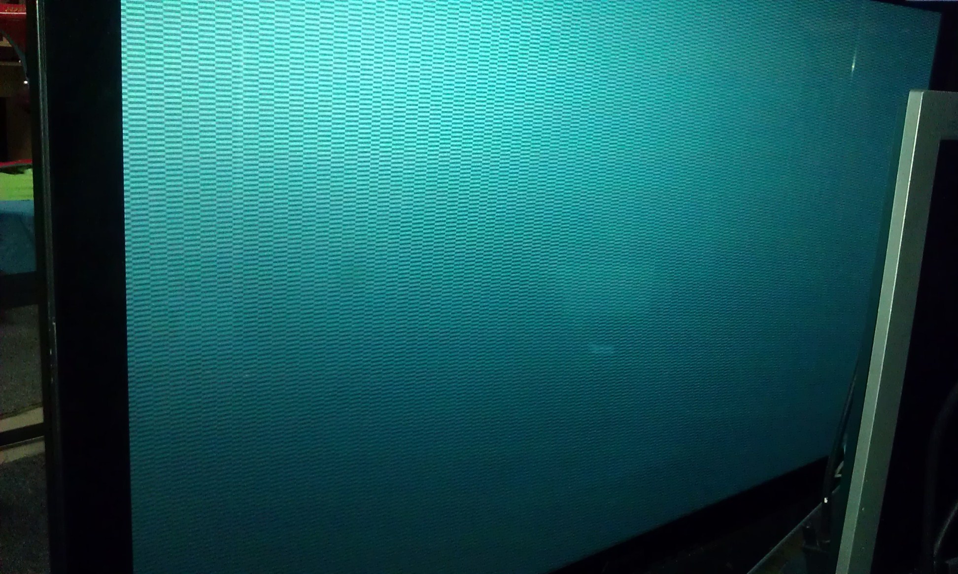

                                  I finally got a DPDT switch. (Been very busy lately). Got it wired up tonight and, Voila! No more GLOD! It actually works.
                                  For the most part anyway. I have a static sound but no picture. Not even a display in the corner telling me the current input. I will have to go back over everything to make sure I have everything connected.
                                  With all of these wire I may have missed reconnecting one of them.
                                  Thank you so much for the help!

                                    check the two ribbon cables going from fmt to dm board

                                      I was thinking maybe one of the ribbon cable since they were a little tricky to get connected and routed through the dm board mounting plate but they are good.
                                      I left the tv on for awhile and eventually the tv shut off and now the power light is red indicating that the lamp is blown.
                                      So since there is no way that I know of to test one of these lamps, I will have to order a replacement.

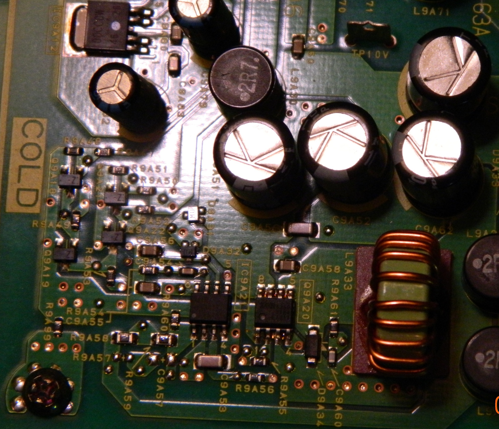

                                        Well, it wasnt the lamp. I had found two connectors unplugged on the power supply that I had forgotten to reconnect.
                                        Once I had those reconnected and followed the power-up procedure the lamp came on. However, now the screen has a checkerboard pattern of black and green rectangles.
                                        I did a little searching and found that there are two smd diodes and two smd capacitors that are known to cause this. D8f00 & D8f01 and C8f26 & C8f29 are the components. After interpreting the code on the diodes, I was able to find replacements at www.digikey.com (http://www.digikey.com/product-detai...SCT-ND/2120681) and (http://www.digikey.com/scripts/DKSea...68972178096415).
                                        There are no markings on the capacitors, and I do not have the schematic for this tv. Doing some searching, it appears that it is a 1uf 25v cap.
                                        There are places that sell the kits for $20 + shipping but I can get the parts at digikey for less than $5 total. So now I just have to wait for the snail-mail.
