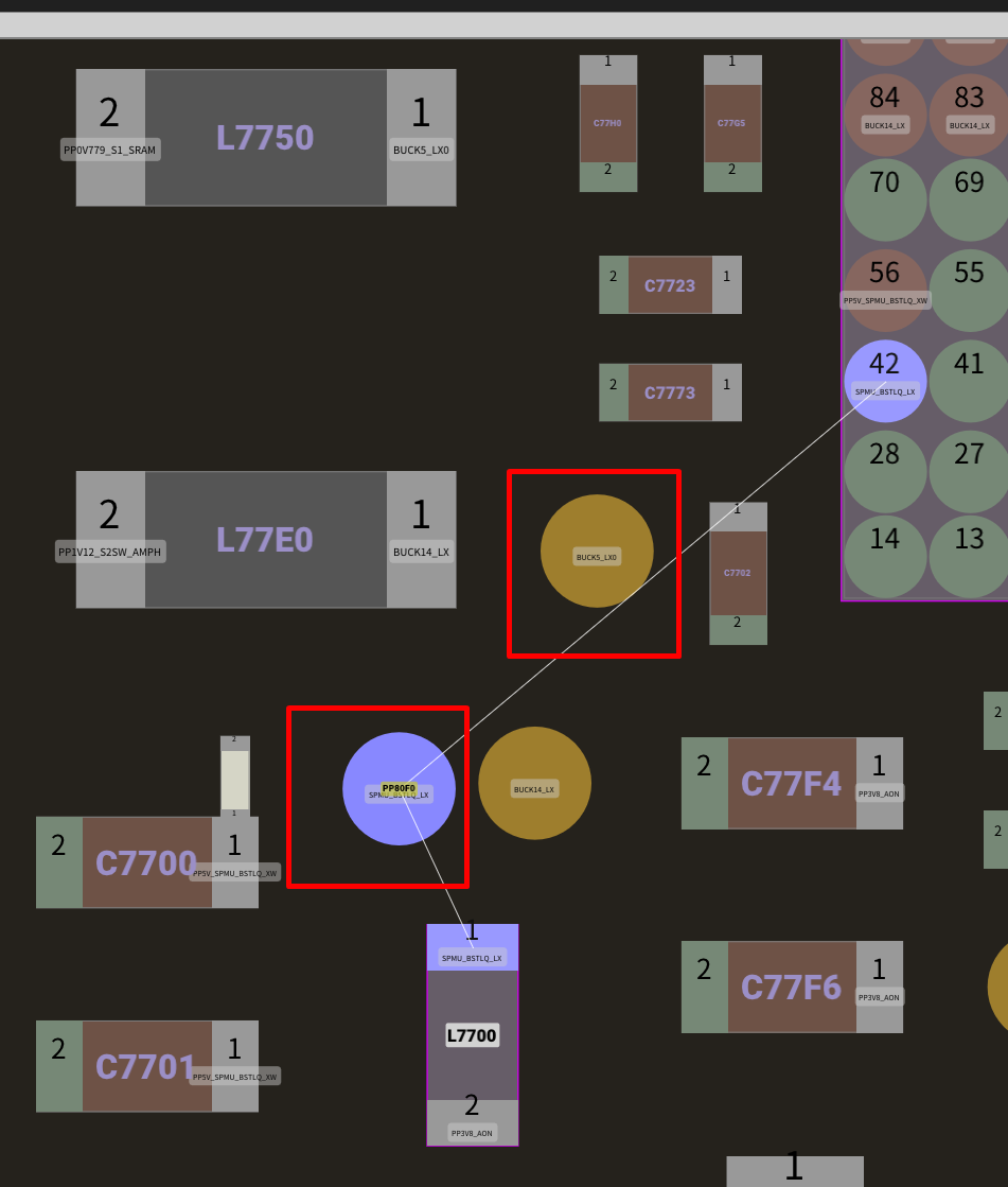

    Hello every one, i have bought macbook air M2 but not power on,
    try shift + option + control + power -> the webcam green light is on but not thing happen.
    anyone have ideas of this ?

    update
    Cap C83B1 is shorted to ground and all the caps on that area, so the caps are not blown, the area in question is PP1V05_S2SW_VDD2H,
    voltage to ground of PPBUS_AON is 12V

      What is the exact resistance to ground in ohms of PP1V05_S2SW_VDD2H? No power to the board during resistance checks.

        resistance to ground in ohms of PP1V05_S2SW_VDD2H is 14.2 Ohm

          To me, this rail does not look to be shorted.
          Measure the resistance to ground of all other inductors on the board. Compare the inductors to their voltage values shown in the schematics. If there is too low of a resistance, that rail is a suspect for the root cause of this board not powering up.

            just give up but here i check
            now it shot in below when check L7700 and L7750 Click image for larger version
