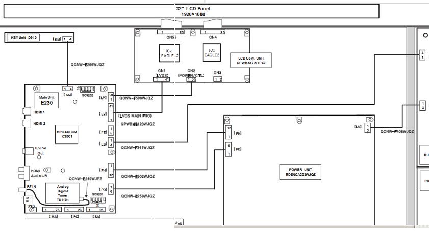

                                  Re: Sharp Aquos
                                  Tom- not sure what you want to know - I have pieced together a block diagram
                                  from the SM the leads go the Broadcom Tuner/Source.
