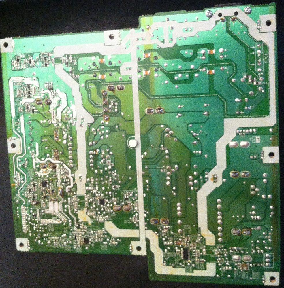

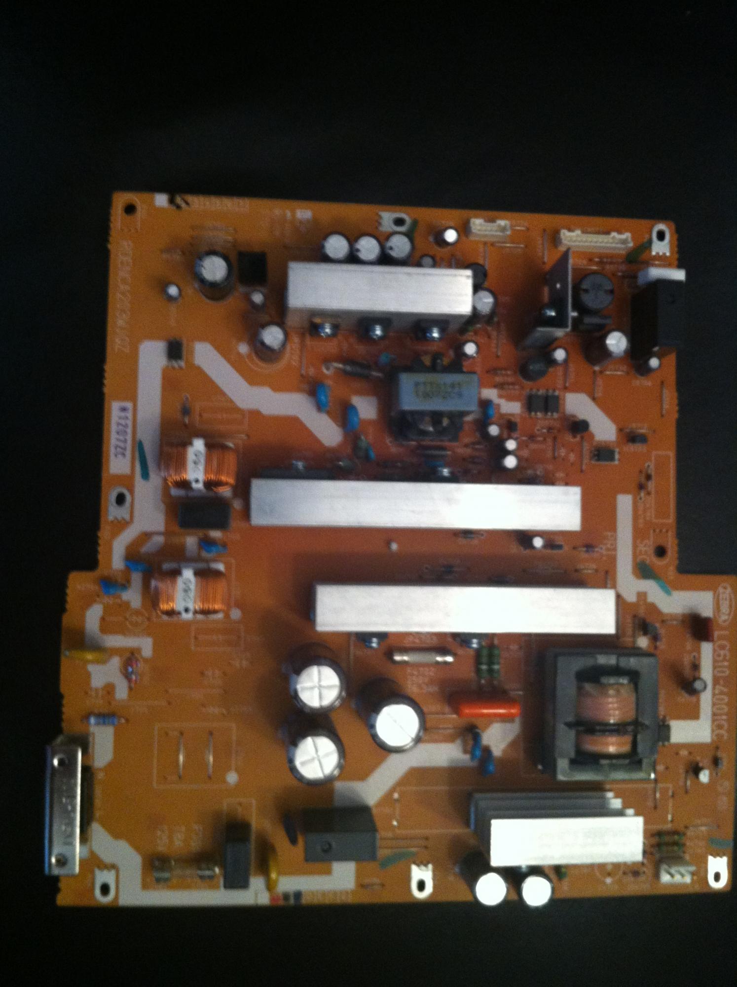

    The power board? I didn't see anything when I had it out.
    Wish I hadn't messed with the main board if I had known earlier about the power failure.

      I am afraid your pictures are not really clear enough for troubleshooting the fo
      following is what I normally advise newcomers.
      Welcome to the forum-
      We can help a lot more if you please post good clear pictures of the whole chassis, and then pictures of each board, front and back and close up of connectors, (max resolution 2000x2000 and 2MB) using the manage attachments button, which is found by clicking "go advanced" under quick reply.
      Examples of what is needed
      https://www.badcaps.net/forum/attach...1&d=1290283049
      https://www.badcaps.net/forum/attach...7&d=1280167246

        Sorry,
        I have taken new photos (this is the best I can do at the moment)
        Power Board:
        Front:
        Back:

          Too grainy... looks like flash reflection too.
          Best bet is to turn flash off, and get some good natural light - outside often works well....

            Its just the light I had on for more lighting, I can't do much better because I'm using my cell phone for the pics (but they should be better...)
            If when I connect the TV back up, and Im still getting the same message, is it safe to say I haven't done more damage?
            So the OPC and POWER flash twice and they are still doing the same thing, if I were to get a new power board would that get the tv back to working condition, or no there could be more?
